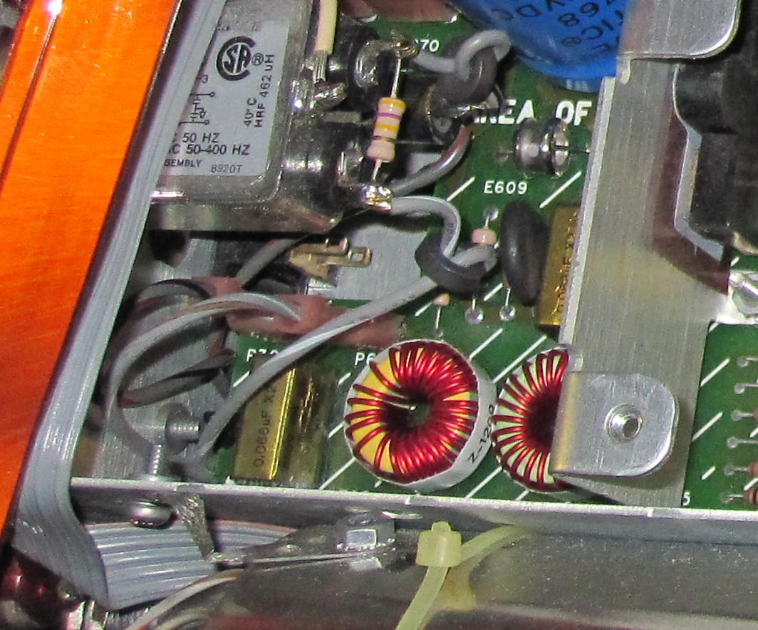

                                Speaking about those RIFAs, supposedly there's a year they stopped being "bad"... or not?
                                Have to assume that any with a cracked case are bad and need replacement... I have a piece of 1988-1989 equipment that has a cracked RIFA so unless they used NOS, it was still an issue then?

                                  #56
                                  Re: "Unapproved" input filtering
                                  No. They'll be bad after time, even if power was never applied.
                                  That's almost as bad as audiophools selling used paper/wax caps on ebay, under the guise of "improving" the sound in old tube amps.
                                  Those 6L6s will "sound" real good when DC from the previous stage biases the grid positive, and they redplate. The output (and power?) transformer will also "sound good" after a while- "sounds" like money!
                                  You need a "cased" safety cap, something that does not use just the epoxy as the case. Got one of those Rifas for display purposes. Has the cracks but didn't blow up when I pulled it years ago. Makes an excellent "this is why we don't use these anymore" presentation- visual and immediate.

                                    • eccerr0r
                                      Solder Sloth
                                      • Nov 2012
                                      • 8711
                                      #58
                                      Of course, that's what I meant, NOS does not mean immunity from cracking. I don't know how much of, or if Tek had a whole stockpile of the bad RIFAs and kept using them, and if they did I should expect the same failures if they were used in 1980 even if RIFA changed formulations.
                                      But I can't tell what code the RIFAs Tek used, as far as I can tell they were indeed from the batch of bad ones (is there a date code? Unfortunately I would have to pull the PSU to be able to look at it carefully, but it *is* cracked and I should replace it, regardless.). Again it would be nice to know when RIFA changed their formulation to one that won't crack.
                                      There's them RIFAs
                                      Bad RIFAs since early 1980s, why did Tek still use them in 1988?

                                        • 31287
                                        #59
                                        it's not a bad batch, it's a bad design.
                                        dont use the clear ones - simple as that.
                                        boxed and potted only!

                                          #60
                                          That would be a good rule of thumb I guess. But I thought RIFA was still making the clear pots, why would they still be making them if they are known bad? I'd imagine they should have fixed the problem else they would not still be in business... or perhaps these clear ones are NOS?
                                          Let's buy clear RIFAs from Digikey!
