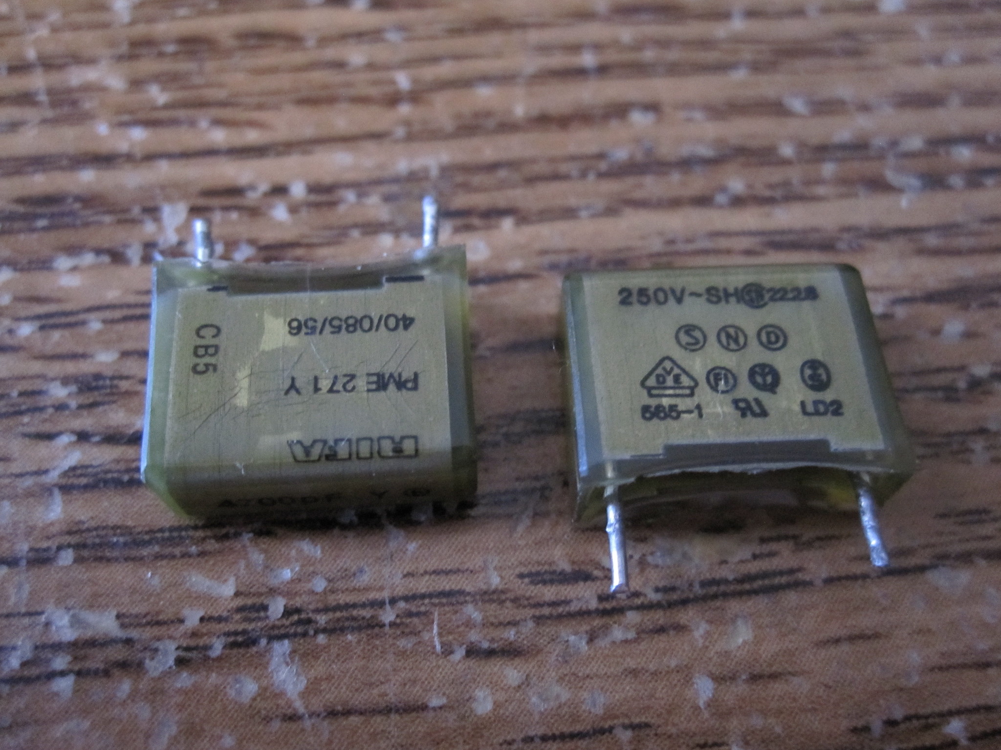

    well rifa was taken over by Kemet - so any rifa branded stuff is old.
    that said, it looks like they are still making some like that!
    http://www.kemet.com/Film_Capacitors
    • eccerr0r
      Solder Sloth
      • Nov 2012
      • 8701
      #62
      Re: "Unapproved" input filtering
      So avoid these like the plague too?
      I would imagine people would be gunshy using these by now due to their bad history, yet that link I have at Digikey, that should be New-new stock and is commanding a huge price premium too... $4 for a 0.1uF 660V X2 is a little pricey! Tell me about cheaping out but I'm buying the 50 cent potted Panasonics.
        • 31185
        #63
        looking at the kemet site, the X2 rated stuff is boxed and potted from the bottom.
        (top-left)
        the clear stuff may just be non-critical use now.
        • eccerr0r
          Solder Sloth
          • Nov 2012
          • 8701
          #64
          So, replacing a RIFA with a RIFA = critical or non-critical?
          • eccerr0r
            Solder Sloth
            • Nov 2012
            • 8701
            #65
            Took a sampling of a few X2's that I need to get for my scopes:
            http://www.digikey.com/product-searc...rt=732-5746-ND
            Which should I get, is cheaper really better?
              • 31185
              #66
              well kemet do 2, one is the same price as the panasonic.
              it looks like the premium price is because it's paper and not plastic-film.
              i dont know why? - fuck it - get the plastic film from kemet or pana.
              • eccerr0r
                Solder Sloth
                • Nov 2012
                • 8701
                #67
                Yeah, that's why I don't get it... how could an inferior product command a higher price?
                Any ideas about Wurth?
                  • 31185
                  #68
                  no idea, but i use their poly's sometimes.
                  • eccerr0r
                    Solder Sloth
                    • Nov 2012
                    • 8701
                    #69
                    I just found two RIFA Y-caps in my junk box (I think... PME 271 Y, 4700pF) ... I should be very afraid... and they belong in the round file...
                    pre-explosion Y RIFAs for your daily frightfest:
