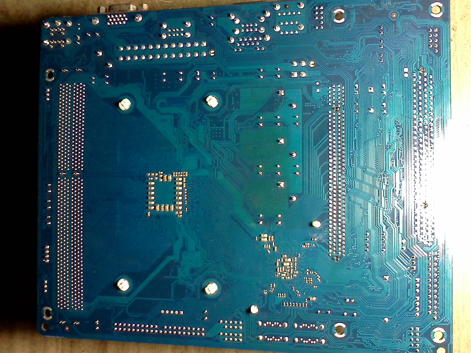

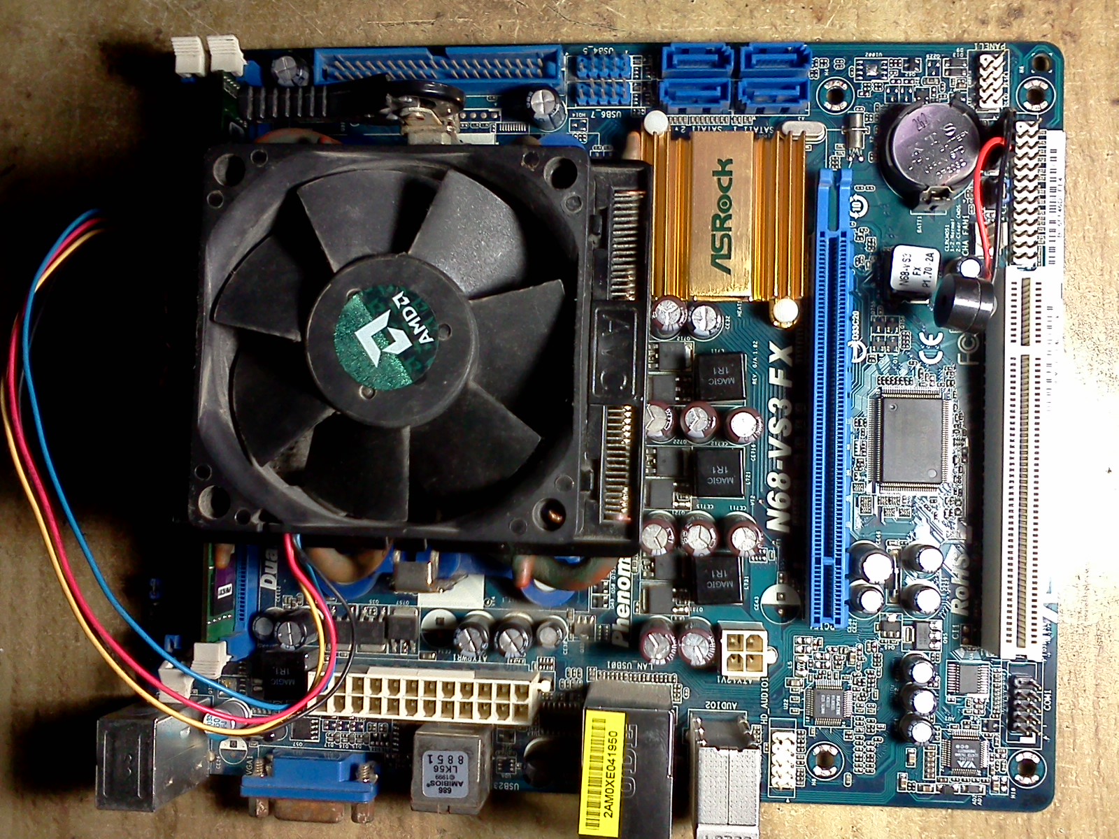

            It's a somewhat long story, but in short I'm not sure if the shutdowns were trigered by P/S or motherboard because the CPU VRM of the board was cooked badly for 6 months. 20A rectifier? IIRC it was a crappy 16A fast.
            Edit: It's the sme model as this one : https://www.badcaps.net/forum/showth...251#post189251 so must be a 16A fast.

              Originally posted by SIDMX
              ...because the CPU VRM of the board was cooked badly for 6 months.
              You shouldn't expect anything less from ASUS
              You are probably wondering, "ASUS? What is this guy talking about, this is AsRock"... but look again at the caps on the motherboard, or in particular, their orientation relative to the shaded semi-circle on the board .

                Re: "Unapproved" input filtering
                Yeah I don't like Asus boards (bad experiences in the past) but my friend just learned that in the past year , about the Asus/ASRock thing I'm aware that Asus established ASRock to compete in lowend market or someting like that I can't recall exactly but thanks nonetheless.
