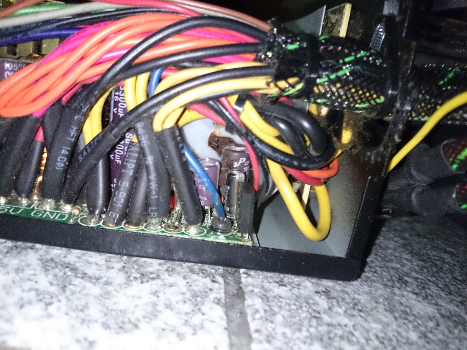

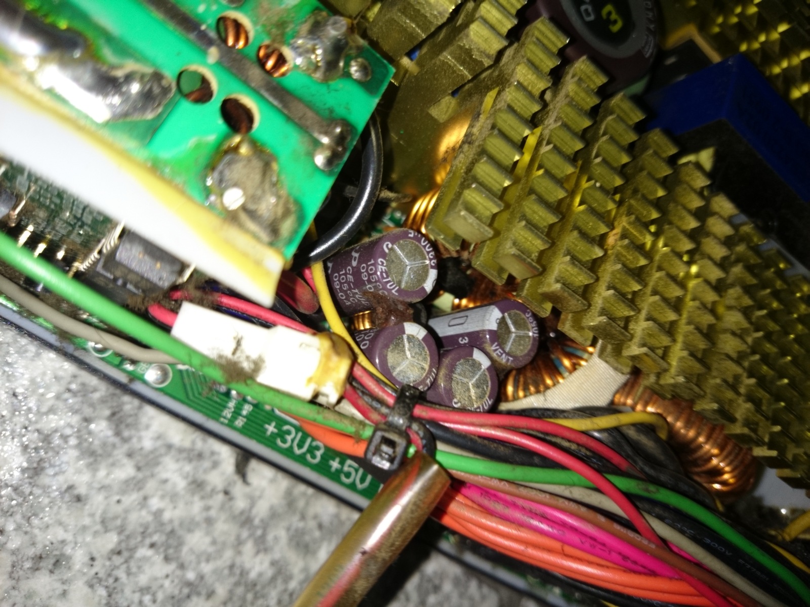

    Now, the voltages are looking BAD.
    I don't know how much time ago it started to be in this state... btw, it's strange. I've already seen things like those on other people's PCs, but they were using 20 euros PSUs.. and anyway, I usually see PSUs LOSING voltage (meaning erogating less than 12V on the 12V rail, less than 5V on the 5V rail, less than 3.3 on the 3.3 rail).
    Fact is, my PSU started to give HIGHER VOLTAGES instead of lower, so... do I need to recap it?!?

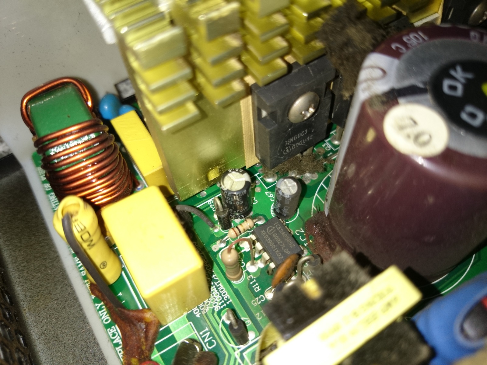

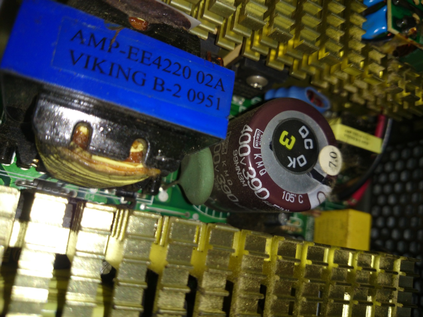

    Phew, I was almost forgetting. I've opened my PSU and I found some CapXon capacitors, some other CE-TUR and just one (or two?) VENT.
    On the primary it has got a Nippon ChemiCon cap (YAY good!), I can read it's 400v 390uF, and the code is "99MN3M", so I think it's just fine.
    I've verified the voltages with a digital multimeter, and I've detected EXACTLY (or well, 0.01V tolerance) the same my mainboard is detecting (just saying, ASUS ROG Maximus VII Ranger).. and I can remember it wasn't like that.
    Here's what I'm detecting:
    +12V - 12.288V (rarely 12.3)
    +5V - 5.20V (rarely 5.25)
    +3.3V - 3.456V
    Now, I know that the ATX spec gives a +/-5% tolerance over voltages and 12V looks fine (even if at the beginning it was giving 12.10V).
    What looks bad IMHO are 5V and 3.3V: calculating a +5%, I'm really REALLY near to the out-of-spec situation.
    I actually don't know if I should really recap because, repeating, I've always recapped PSUs that were giving lower voltages.
    Anyway, just for the sake of science, I've actually ordered Panasonic FR caps (and one Nichicon solid cap, because I couldn't find that pana).
    Oh, visually, the caps are looking fine!
    So... what should I do?
    To recap or not to recap. This is the question. :P

        • 31246
        Re: NOX Krypton 800W - Higher voltages, need recap?
        re-cap it,
        more importantly, get rid of all the brown glue.
        FR would be nice, but i doubt you can use just FR.
        often you cant get FR in the right size and have to use FK.

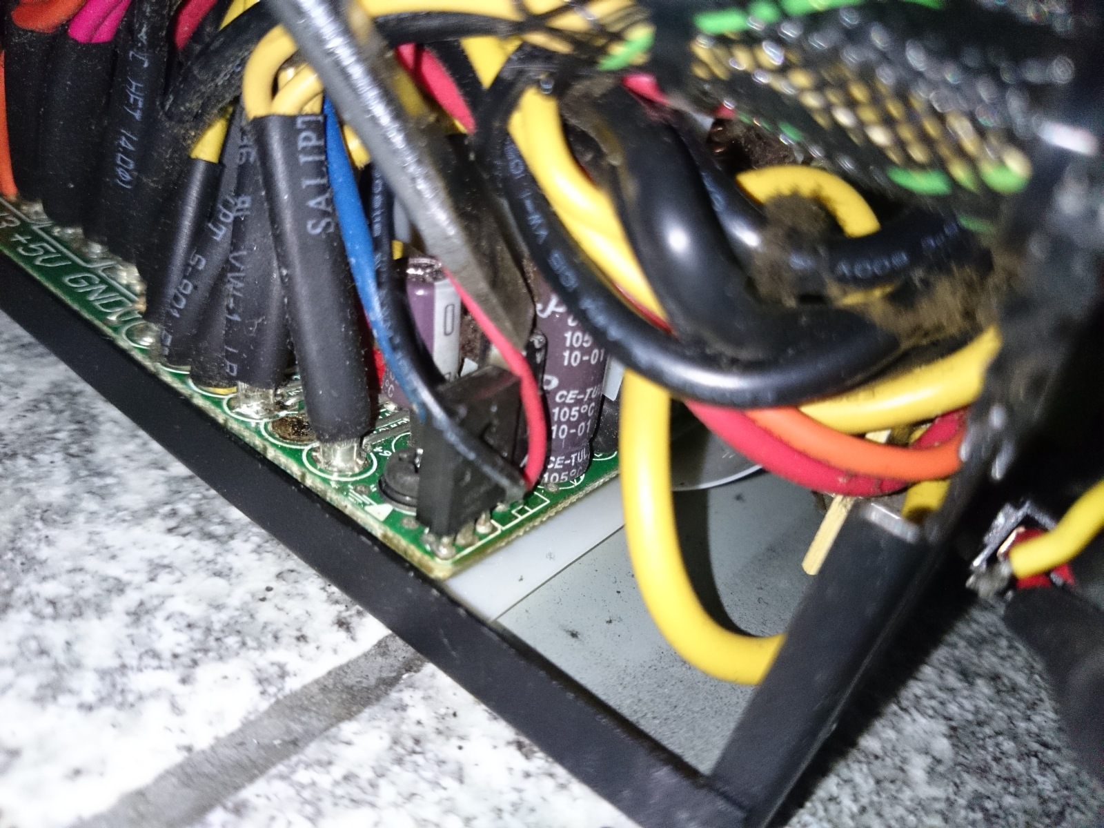

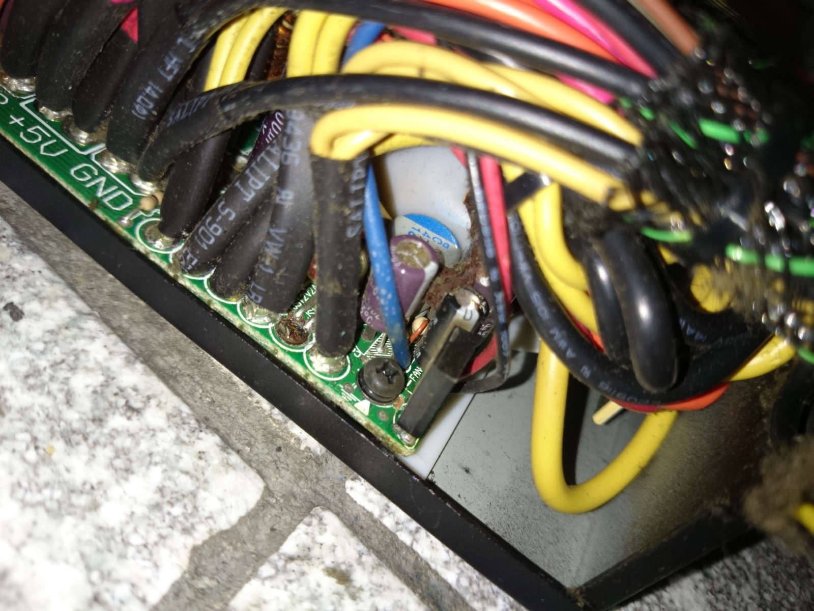

                        From what I know, I should only replace the >100uF... but well, I bought everything I could find, so I'm going to also replace the 22, 68 and 47uf caps. The 22uf one is 50V, it should be on the primary circuit, but well.. from what I've read on this community, CapXon is total crap.
                        What makes me somehow both happy and sad is that I've actually got a solid cap (470uf 16V) on there and I'm going to replace it with a normal electrolytic Panasonic FR cap.
                        Instead, the 22uF I've ordered are solid caps Nichicon LV PLV1J220MCL1, with low-but-not-really-low ESR.
                        What I REALLY can't find is that 400V 390uF capacitor. I mean, I can find packs of 10 to 1000 of 'em, or otherwise I can only find CRAP.. I really don't know where can I buy one of these, but well.. I really HOPE that my current cap is still perfectly good. I've heard that those high voltage caps are hard to die.
                        I've also seen that some people are replacing those primary caps with higher capacitance ones. I'm curious... what's the reason for doing this?
                          You should always replace the small caps in powersupplies, many times they are critical for it's operation.
                          And if they go out of specification the 5vsb can, depending on it's design go high and kill the mainboard!
                          What brand & model is the original capacitor?
                          Maybe you don't need to replace it if it's a good brand...
                          If you have an ESR meter you can measure it to see if it's still ok... (Out of circuit)
                          The primary cap is probably fine, as you wrote in your first post.

                            I don't know which brand is it.

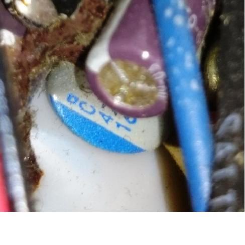

                            The solid cap I'm talking about is visible for half in the third photo, you can see that there's some sort of logo (is it a logo? lol) but I can't really recognize it.
                            Apart from the obvious basic specs, I can read a code on the capacitor: "C01A" (or CO1A)... I tried to google it (really fast) but I can't really get a good search result.
                            I'm trying to search a bit better right now. I'll let you know if I will be able to find it or not.. :°)
                            Ah! Unfortunately, I haven't got any ESR meter here. Just a normal multimeter.
                              Looks like its a 16v 470uf what do you think Per

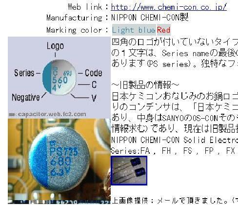

                                I can't see the logo enough, would need a better photo showing the whole capacitor.
                                kholk: here is a great site for identifying solid capacitors: http://capacitor.web.fc2.com/solidcapacitor.html

                                    Oh, I forgot to say that, yes, it's a 16V 470uF capacitor... I've already taken the cap values (that was pretty obvious since I ordered the new ones).
                                    So it is a Nippon ChemiCon capacitor? That sounds really good!
                                    I paid a lot of money for that PSU when I bought it years ago.. though, this is just one of the two good caps in there. The other good one (also nippon chemicon) is the 400V cap.
                                    Hmm.. well, I've already ordered a Panasonic FR replacement for it that, obviously, isn't a solid cap. What do you think, should I replace that too or not?
                                    That PSU has been operative for at least 4 years and sometimes I've left the PC running overnight (let's say, 25% of the PSU usage was 24/7, on a system drawing ~300-350W constantly).
                                    Also, there have been lots of peaks in wattage consuption, as compiling the whole Linux userspace and Android are actually maxing the power consumption of a system (heavy usage of CPU, RAM and HDDs, so also chipset drawing max current.)
                                    EDIT: YAY Maybe I've found it. It should be a NPCAP PSC series. The image from the datasheet looks like it.
                                    Here's the boy:

                                      You can't just replace a capacitor in a PSU with something that does not have similar ratings.
                                      If you do you will cause more ripple than what you have now.
                                      Leave the solid capacitor unless you can find out via the links provided that your replacement has the same ESR & ripple current.
                                      • kholk
                                        • Jul 2014
                                        • 21
                                        • Italy
                                        Oh, CRAP I'd say.
                                        Just seen that the Panasonic FR replacement (fuck, wasted money) has got an higher ESR.
                                        ChemiCon -> 10mOhm ESR, 6,100 mA rms
                                        Panasonic -> 41mOhm ESR, "1240" mA rms
                                        Now, what about that comma on the ChemiCon sheet?
                                        Should I interpret it as comma or as number separator? :\
