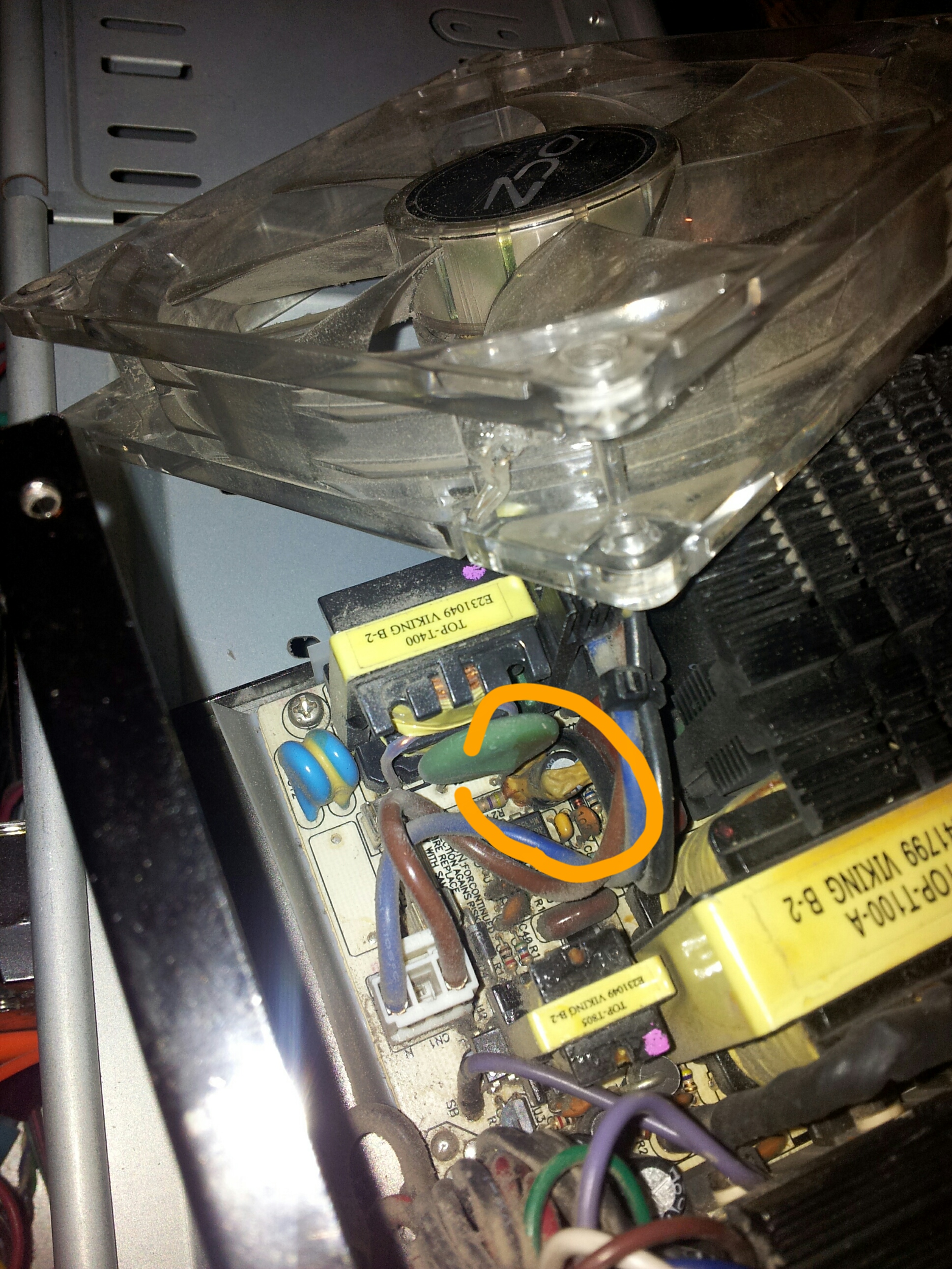

                Hi every1,
                I need pls every1 who could tell what cap is cuz this little busterd is glued and i dont want 2 scrapted him now
                Tnx 4 the help:-)
                • selldoor
                  Slow Learner
                  • Dec 2010
                  • 7870
                  Re: ocz 420 u12 swollen caps
                  You will still need to get the glue off the resistor at the side of it. The glue goes conductive with time and may short it out . Sometimes the glue will soften slightly with repeat coats of IPA.
                  If you put shiney tinfoil down the side at an angle your camera may capture a mirror image of the detail on the side of the cap?

                    #29
                    Tnx 4 the advice on the glue and amazing idea with tinfoil
