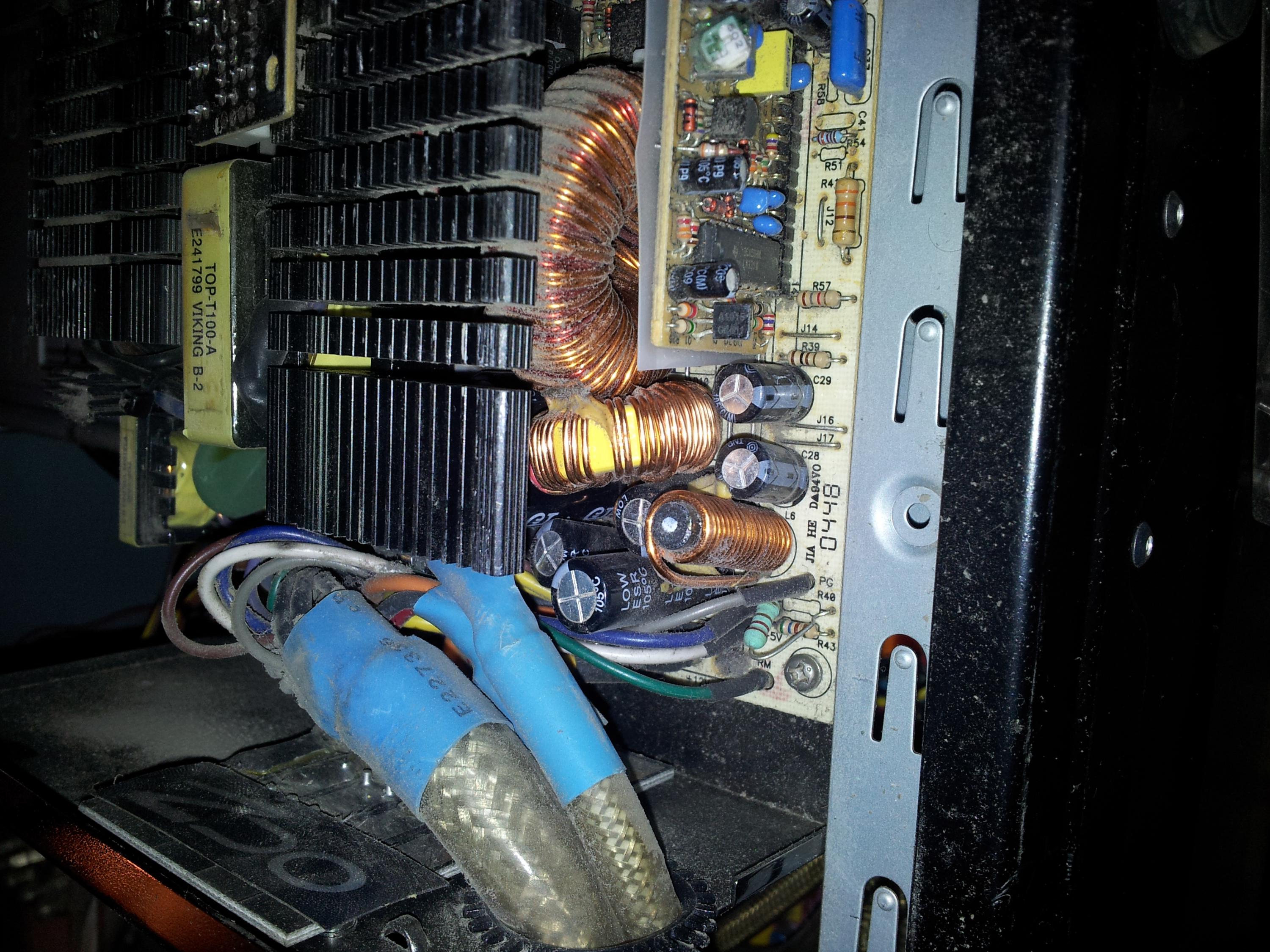

    I just opened my PSU and found 4 caps swallon and one of them even with ”the juice” on top, but why i opened it cuz every time shouted of the computer n tried to start it, it comes on but not fully on u hear the fans ane led but no display no keyboard or mouse but if i repeate the shoutdown and power on it finaly comes on after like 2 to 5+-.
    The weird thing is the comp work pretty fine.
    My Q is i want to recap it but i dont know what cap should i put?
    The caps inside is 2* 2200[uf] 10[v] and 2*4700[uf] 10[v] low esr bouth.
    The caps that i want to put is:
    Panasonic FC & Rubycon ZLH
    But i dont the thing with the ”ripple current”?
    Thx very mush 4 ur help,

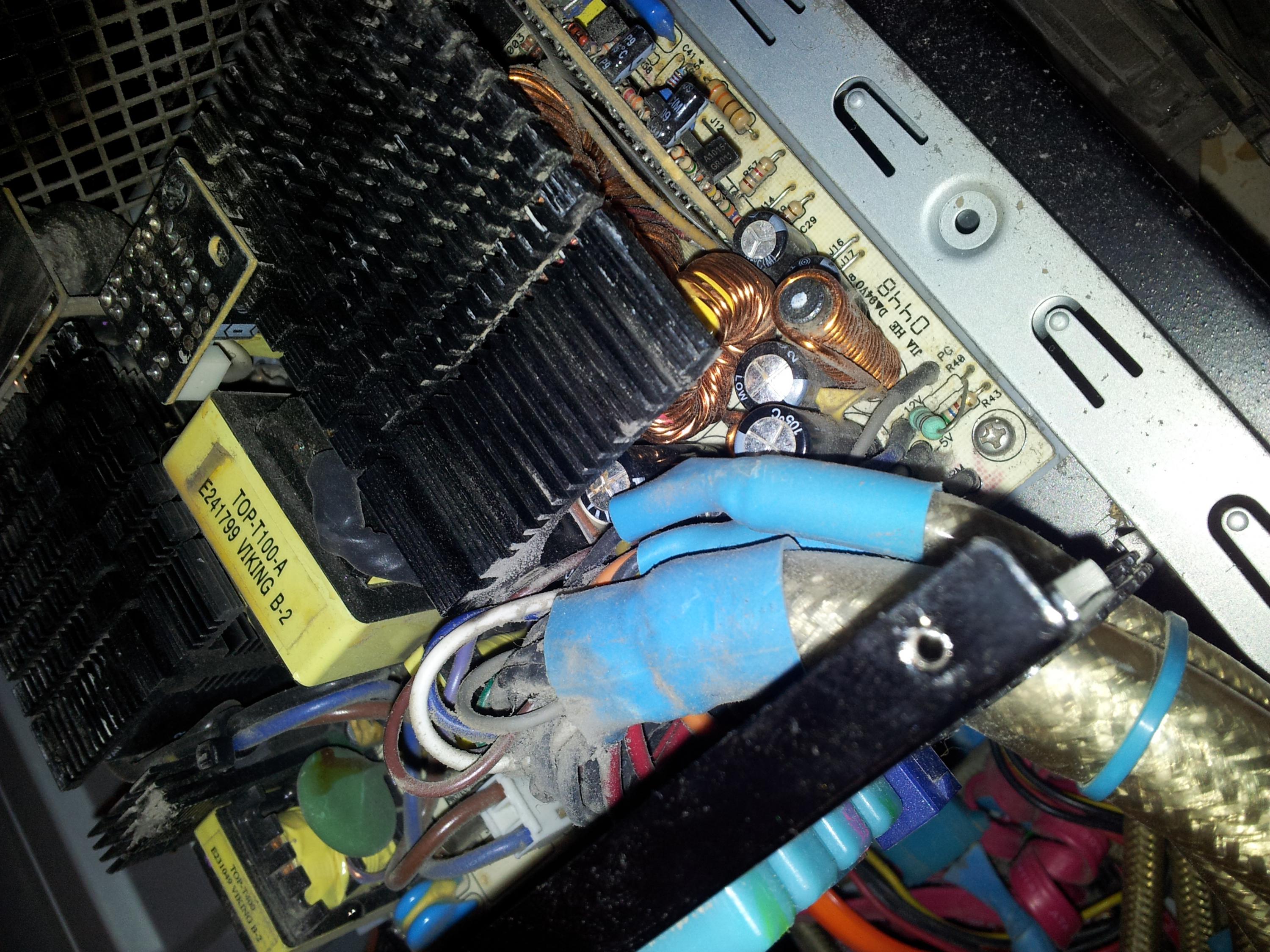

            Here a pics of the PSU of mine:-)
            Ill b happy if some1 please can recommend on good but not the best caps 4 this PSU:-)
            I need:
            2* - 2200[uf] 10[v] LOW ESR
            2* - 4700[uf] 10[v] LOW ESR
              • 31044
              Re: ocz 420 u12 swollen caps
              you need 7 caps not 4.
              you need to change the ones under the edge of the heatsink too.
              the ones with the 3way vent are mad by fuckyu - they are probably the worst caps ever made!

                    This is an old Topower design, but very solid. It's going to be extremely difficult to replace the caps on the secondary without removing the heatsink. There are caps back there that you can't see until you remove the heatsink. I've worked on a few of these, it's a long project but these are very well performing PSU's, and run very silent. Replace ALL of the little caps too, in the few I've worked on, some were completely failed, as in 30Ω+ ESR on the <10uF caps. Also, check the oil in the fan bearings, they're usually dry. Depending on which revision you got, it may have weak 12V rectifiers. I've seen one with two 10A ultra fast in parallel, one with 16A ultra fast in parallel, and one with 20A ultra fast in parallel
                      • 31044
                      the ones with 3way star vent have a logo visible on them.
                      and the ones under the edge of the sink will take the most heat - so be more effected by age.
                      when you recap a psu - it's best to do all at the same time.

                                        Try this fella - http://stores.ebay.com.au/PC-MotherB...pacitors-Store
                                        His caps are all NOS, but they should work OK. Topcat here doesn't have much in the way of PSU caps.
                                        I see two 470uF 16V caps (the Fuhjyyus). They can get replaced by these (http://www.ebay.com.au/itm/6-Rubycon...item43c09e20c5)
                                        2200uF 10V caps can get replaced by these (http://www.ebay.com.au/itm/8-pcs-Rub...item43c0209c72)
                                        4700uF 10V caps can be replaced by these (http://www.ebay.com.au/itm/4-NCC-KZE...item43a7c69012). And yes, using 6.3V caps in place of 10V caps is fine on the output
