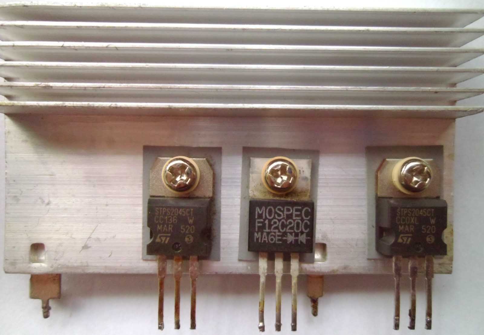

                  Originally posted by stj
                  check the diodes on the other heatsink for shorts.
                  Here's pics
                  For all three ICs, just a quick beep but no continuous beep from centre leg to either left or right leg, or from left to right leg, with my Fluke 77 meter in Diode Test / Continuity mode
                  But there is a continuous beep if I test equivalent solder points on the PCB
                  Does this mean the problem is further down the food chain ?
                  better to keep quiet and be thought a fool, than to open your mouth and remove all doubt
                    Re: PT-A450W repair failure
                    The middle device is the Common Cathode (middle pin) Diode, the two anodes (two outer pins) are tied together so the two diodes are connected in parallel. Is that the one that shows continuity on the copper pads?
                          Using Diode Test/Continuity setting, with Ground probe on PCB pad for centre leg of middle IC, got continuous beep to all other pads but one
                          Exception was one side pad for middle IC, which gave just a quick beep
                          If these results don't make sense, I may not have been thorough enough - pursuing a wild goose chase instead
                          Found two of the 470uf 16v caps which were canted over, were doing so because they were bulging out from the bottom, not because they were assembled that way
                          So I replaced them, resoldered the heatsink & associated ICs to the PCB, reassembled it all and hoped for the best

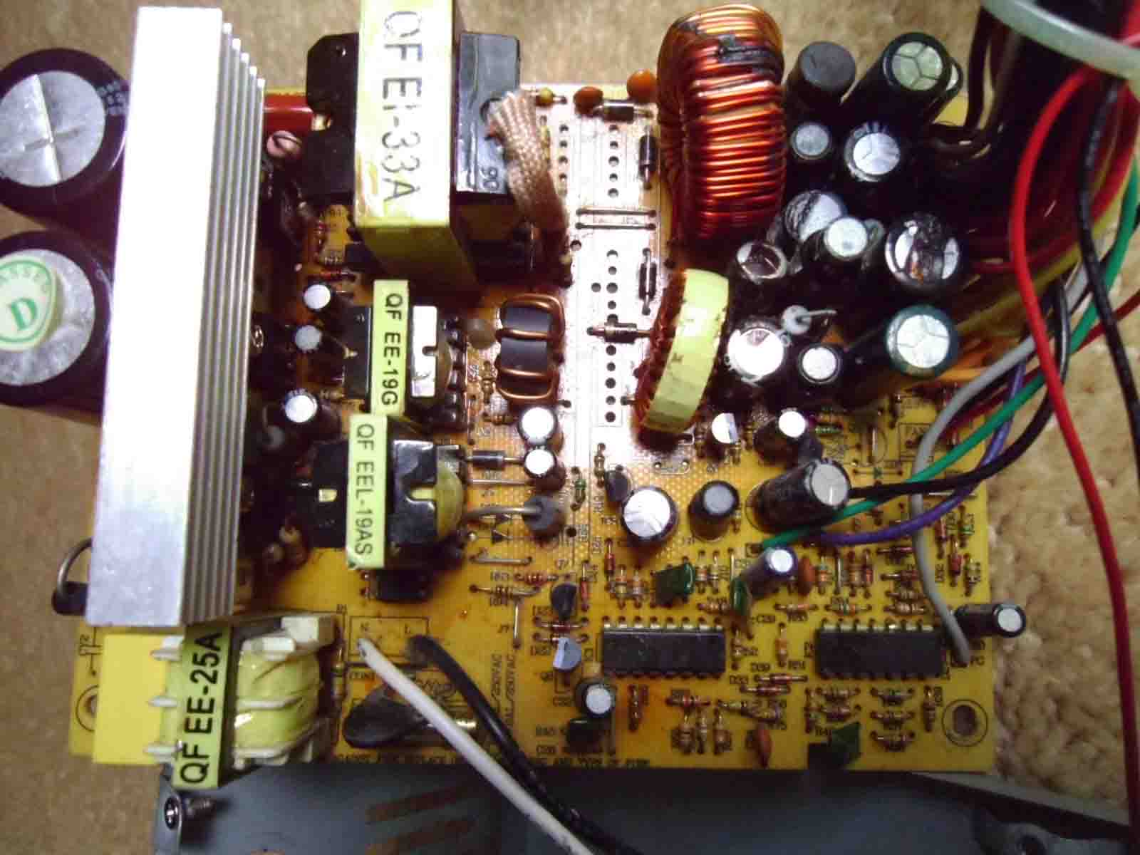

                              Originally posted by pfrcom
                              Please help me ascertain which ones they are
                              See this picture:
                              https://www.badcaps.net/forum/attach...4&d=1403929078
                              There are three small electrolytic caps next to the primary heatsink. Two of them are for the BJT base drive circuitry - usually 1 uF to 10 uF and rated for 50V. They should both have the same value. The last one, closest to the 5VSB transformer (the small transformer on the bottom of the three), is the critical cap. Usually 10 uF to 47 uF, and 25V to 50V.
                              I'm guessing you still haven't checked the BJT drive circuitry too. Above those small electrolytic caps on the primary side (particularly, the two identical ones), you'll see some diodes and resistors. Make sure those are okay too - that is, check the resistors for open-circuit and the diodes for short-circuit.
                              As for the BJT drive transistors on the secondary, my guess is (based on that picture above, again) that they are located in front of that 3.3V torroid. Not sure, however, so either you will need to provide a good picture of the bottom side of the PSU or trace them yourself. They are normally a pair of C945's. At least one of their pins should be connected to the middle transformer. Probably will have to remove them out of circuit to check them. Make sure they don't have any short-circuit between any of their pins out of circuit.

                                  Originally posted by momaka
                                  What rails were these caps connected to?
                                  The 12V, I think
                                  There were two identical 22uf 50V, and one 47uf 50V
                                  Replaced the 22uf with ones recycled (probably from a deceased motherboard) - the replacements measured ~1.2 on Dick Smith ESR meter, compared to both originals ~60
                                  The original 47uf measured ~1.6 so I put it back in
                                  Not good practice, but I begrudge spending a cent on this P.O.S.
                                  Reassembled yet again, switched on power, and nothing
                                  Found one C945 with continuity beep between E & C, so I replaced it with a recycled H945
