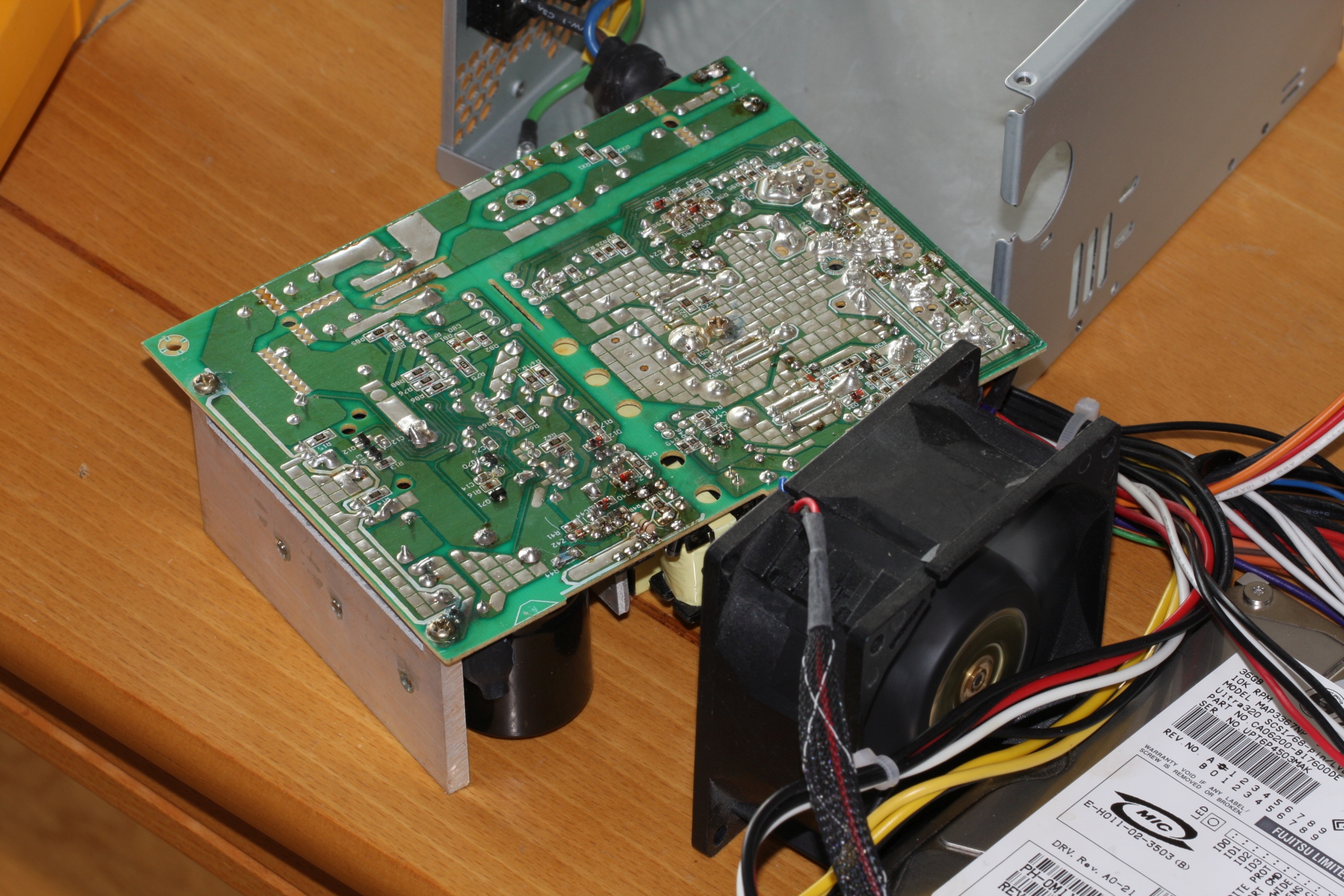

                                  Greetings, friends! So long since I was here last that the birthday greetings stopped arriving. But have recommended many.
                                  Hope this is the right location for another FSP400-60GLN problem? If not, please can moderator re-locate - thank you.
                                  Had this beast for ~2yrs during which flawless and silent performance. Suddenly it stopped (whist ON). Hard reset runs for about 20s. before everything cuts out, ie during main OS loading and eqpmnt detection. Off load, all voltages OK. Can load 5V and 12V lines with 10ohm, but the 3.3V goes down and stays down with anything less than ~30ohms. Recovers after off for ~1min.
                                  Clean as a whistle inside (at least, it is now!). No bad caps apparent, nothing burnt, nothing splattered around. Looking for assistance, please.
                                  Although I've no formal electronics training, have fixed many PSUs for blown fuses, bad caps, blown varistors, blown bridge rectifiers, a very few blown MOSFETs and their associated components. It's these partial faults that really show up my lack of detailed knowledge. Can trace circuits but, whilst appreciating the hazards, limited ability with live PWM-switched mode devices! No longer possess signal generator or 'scope.
                                  Thank you for any suggestions.

                                    #97
                                    Re: FSP400-60GLN worth fixing?
                                    Greetings.
                                    You said that the other 2 outputs seam to work fine under load, so knowing that all 3 main outputs draw their power from the same transformer, logic dictates that the problem could ( or rather should ) be located at the 3.3V output. It cannot be a lack of power because that would reflect on all the main outputs, so, one can conclude that it could be the under voltage protection that comes in, for some reason the voltage on the 3.3V output drops under load too much, so the superviser detects that and steps in. Now about the reason the voltage drops under load, that could be down to a failed capacitor ( or more than one ), and you should know that failed caps do not always have visible damage, sometimes the only way to determine their state is to measure them, check both the capacitance and the esr, you could find one or both of theese parameters out of order, and if so, than change it.
                                    Another reason could be down to a problem on some other component of the mag-amp for the 3.3V, but i think that should be quite vissible, so the caps remain the most probable culprit. My advice is to change all the electrolytic capacitors ( and i do mean all of them ) with new ones, that is in my book always the first and main step on reconditioning a psu.
                                    PS: You could always check for any cold solder, you might get lucky that way

                                        #99
                                        Thanks, guys. Will work on it this week as time permits. Cap changing I can do blindfolded! [Can't we all!]
                                        Later: - as you were. Closer inspection of the underside with a lens,
                                        1) confirms D35 missing
                                        2) very bad soldering around fan lead-thro's with solder bridging
                                        3) serious burning of R92, presently metered as 57ohm but marking erased, of D90, polarisation line erased but giving static diode action on simple meter, and of R93, reading ~17kmarked 2102, all in-circuit, all smc.
                                        Adjacent D92, R9F & R9G somewhat discoloured but giving reasonable static responses, also in-circuit.
                                        Anyone got the circuit diag, please and/or confirm correct value of R92?
                                        O.P. caps mainly TEAPO.
                                        • Elitist
                                          • Apr 2006
                                          • 159
                                          #100
                                          Here's what I've done so far:
                                          -tidied up the soldering
                                          -installed D35
                                          -installed C99 (fan shunt, originally missing).
                                          -swapped 3v CapXon O.P. cap for Teapo
                                          and the result:
                                          -3.3v now stays on with 10ohm load but with 2.3v reduced output!
                                          They say, in research, if you can change something, you're working in the right area! {but only supposed to change one parameter at a time}. The burn marks tells it's the right area, but limited knowledge prevents further progress. It would help to know what value R92 is supposed to be, along with more suggestions, please.
