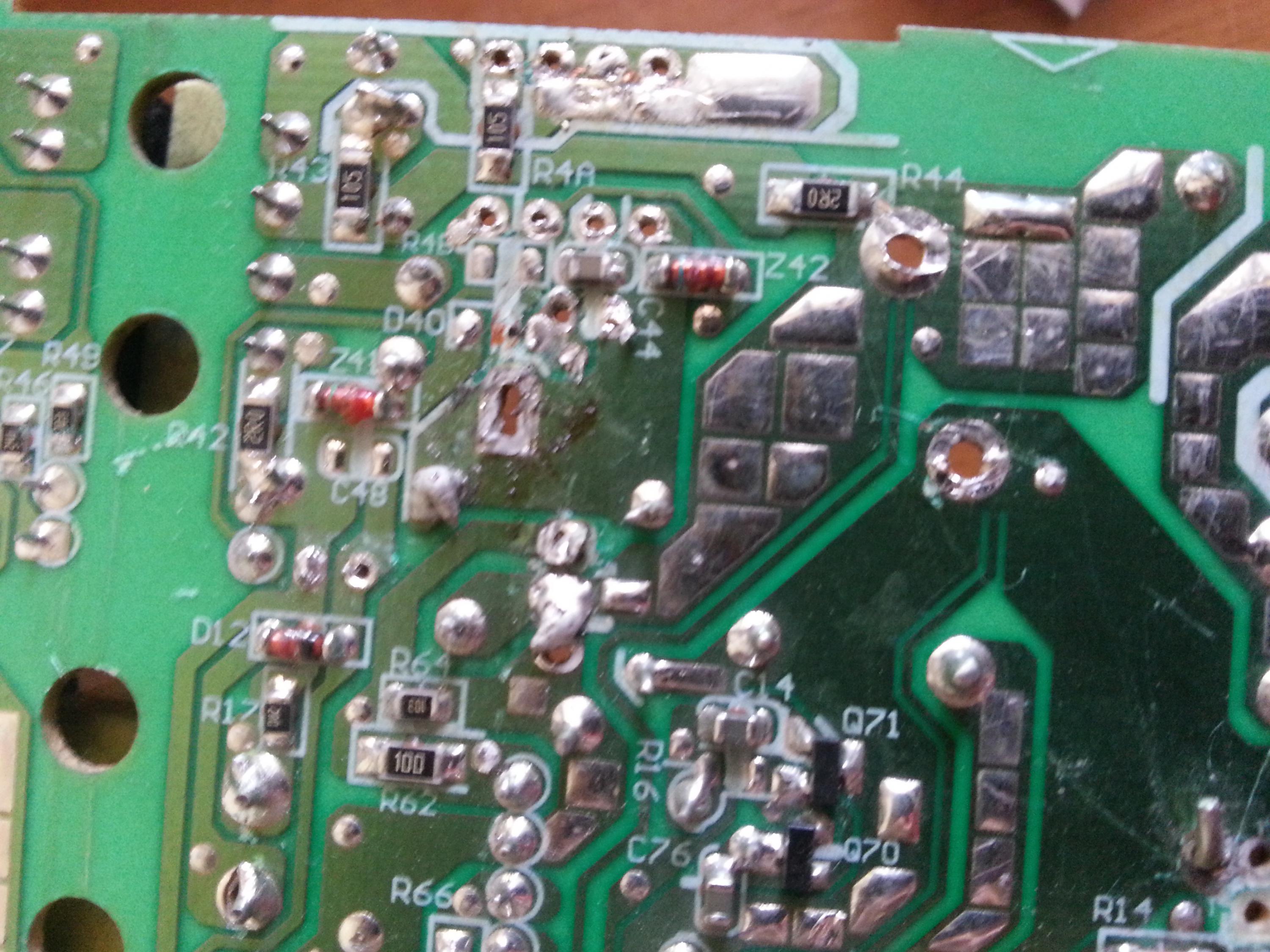

    "So the original fusible resistor has failed open "saving" the DM311." No it is for saving the power supply from more damages due to shorted out DM311, if the resistor was not there when the IC shorted, you can have fire and badly burnt board. We are talking about shunting the >160VDC to ground through the shorted MOSEFT inside that SMPS IC, you can get very nice sparks and fireworks. You should check the RCD snumber network.
    "Then I put in a _regular_ 2Ω resistor: RK73H2BTTD2R00F
    And it blows up more spectacularly since it's not a fusible resistor.
    And the DM311 was already shorted but was now allown to explode since the resistor did not burn up fast enough." Correct.
    I also see some bad solder joints, so you may want to inspect the board real well.

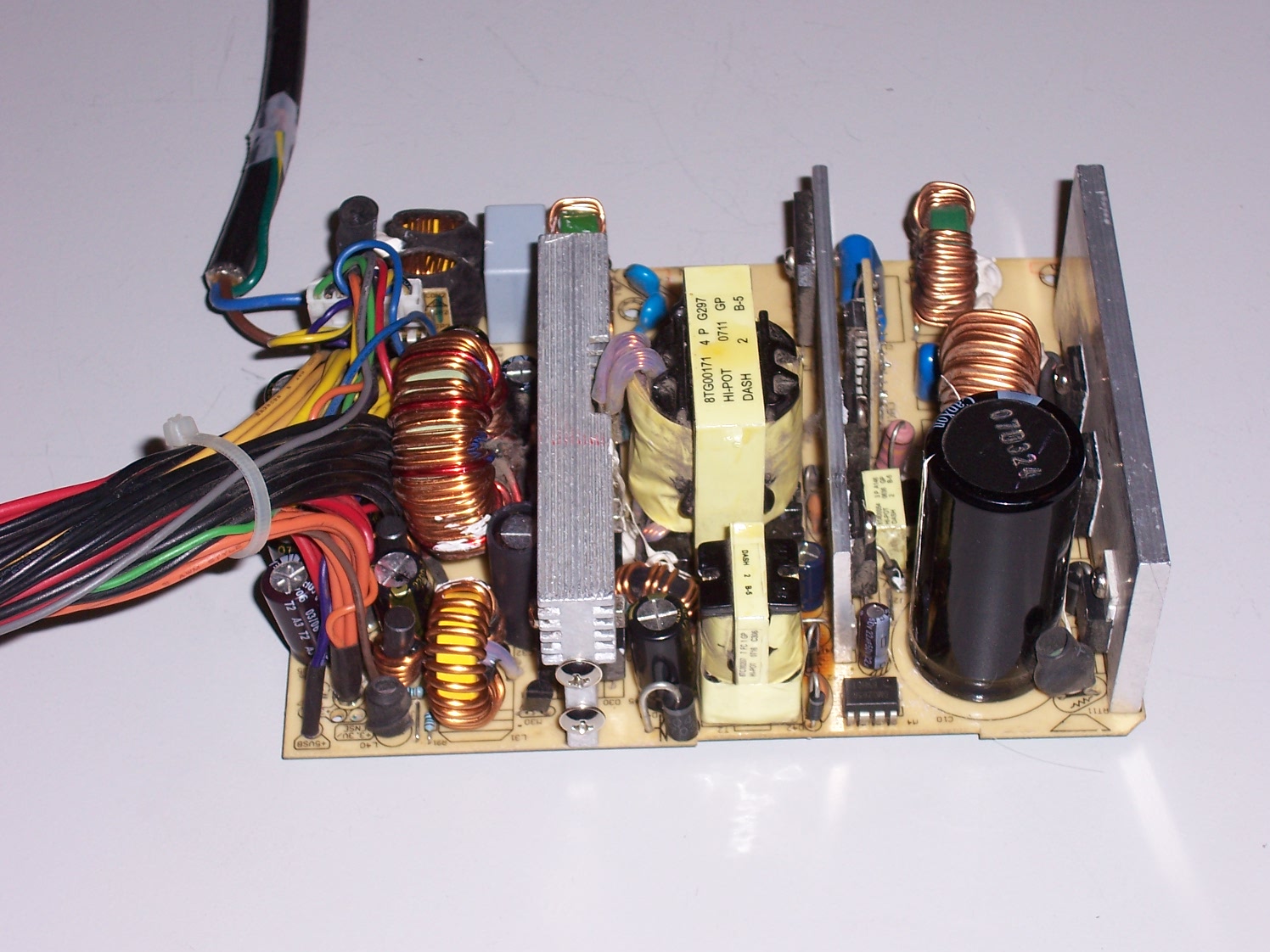

      Originally posted by cxg
      I have 2 of them , with the same problem. The pfc coil is completely burned. The value of R44 is 2ohm marked 2R0
      Interesting that that happened to other FSP PSUs as well...
      Let me guess: around 400W they have, both?

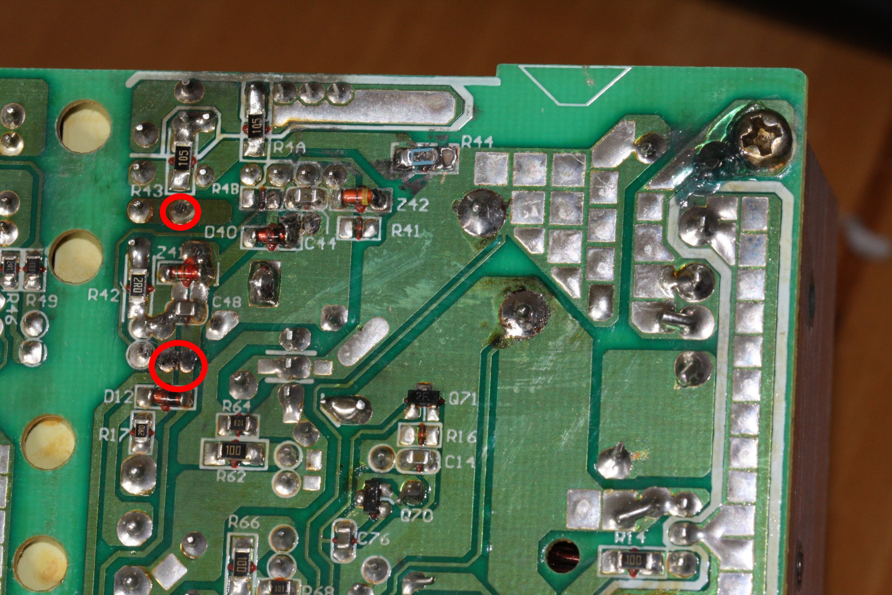

                I have an Antec Basiq BP500U which appears to have the same pc board as the FSP in this post. In looking at the 5vsb circuit, this one has some interesting components. The snubber diode D42 was a 1N4007 1kv diode, but a low frequency general purpose diode. So I replaced it with a MUR2100EG 1kv high speed diode. The feedback voltage diode D41 was also a 1N4007 1kv low frequency general purpose diode. This circuit only produces 12volts to 18 volts. So 1kv seems like overkill, or perhaps they were just using 1N4007 everywhere. So I replaced it with a 1N4935 high speed switching diode. The feedback filter capacitor C15 Teapo 47 uF/50 volts was open. A leaking feedback diode could cause this capacitor to go bad. Perhaps you should check these components on the FSP power supply.

                      The burned area you see is under the feedback voltage diode D41 (1N4007). The filter capacitor for this feedback voltage is C15 the Teapo 47 uF/50 volt. If the diode was leaky due to general purpose diode being used at switching frequency, it could have killed the capacitor. The capacitor measured about 40 nF and esr beyond 99 on my blue esr meter. This feedback voltage provides the power to operate the DM311 chip. Whether the diode can't handle the frequency and killed the capacitor.....or the capacitor went bad and caused high current in the diode.....either way the power source to the DM311 was obviously causing problems. Thankfully I found and corrected this problem before applying power, and the 5vsb now works.

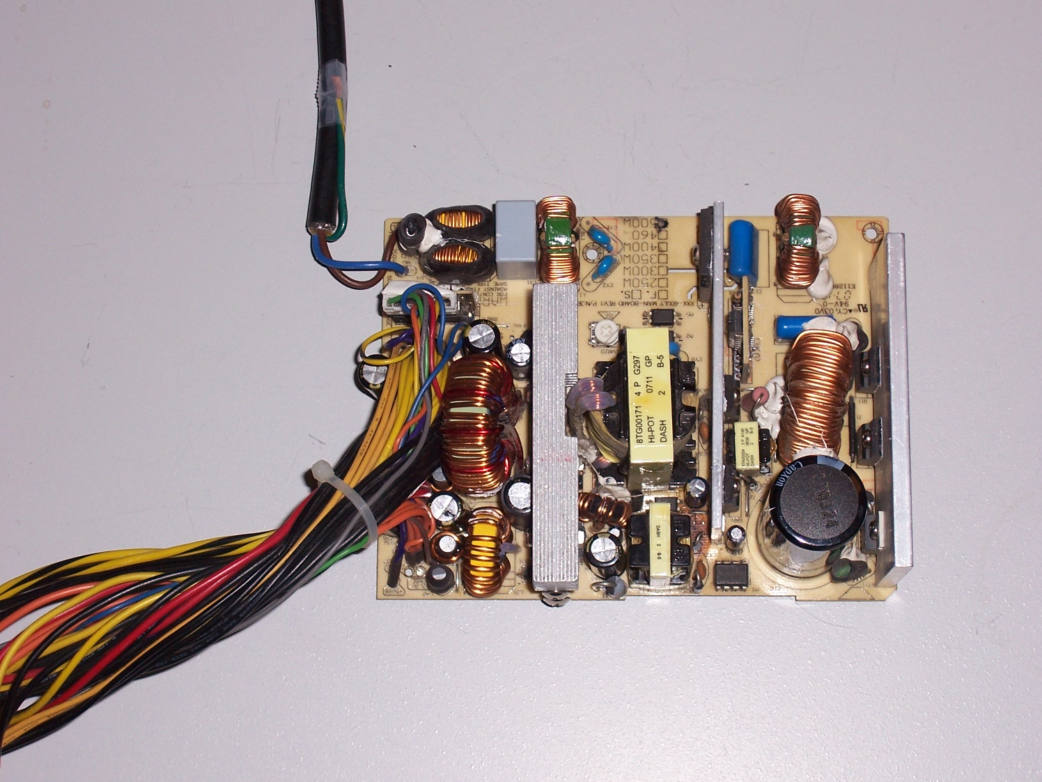

                          Stefan Payne: Pentium4 wrote a few posts down that it's normal, even brand new the coil has this color...
                          I think he is correct as I can see that the core in mine is not darkened...
                          Don't be sure about that.
                          I've heard that with some FSP PSUs around 2006 or 7 there were problems with the PFC coil due to manufacturing errors...
                          And those problems were mostly around 400W (-100W/+150W)...

                              Pretty much all of those GLNs have the same problem. But good I finally know where exactly it is. I just thought the diode is overloaded and having huge losses - clearly the problem was connected with +5 V SB power as some PSUs I've seen were good, some not as some PSUs were loaded more, some less.
                              But anyway, the worst problem is the diode heats too much, this si what kills the caps. Usually all caps on +5 V SB are bloated, often other caps in the PSU are bad too. Crapxons mostly.

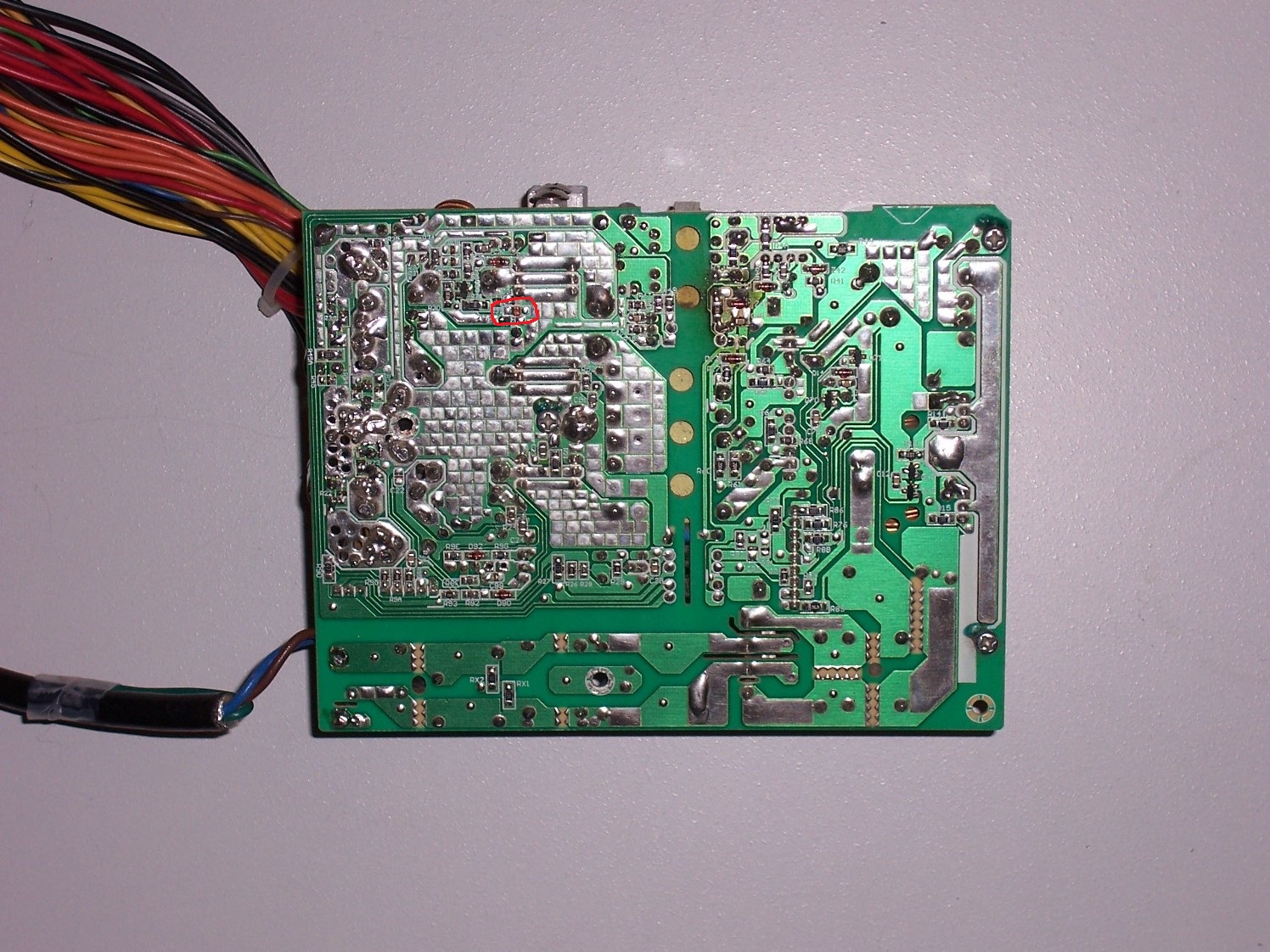

                                  Re: FSP400-60GLN worth fixing?
                                  Dear Per Hansson
                                  Im sorry for what happened to your power supply board but the value of the resistor is right. Im posting you a picture of that part of the circut and you can see yourself.
                                    Yeah I ca confirm 2 ohm, got a 350W version right here with all caps (but primary) bloated.

                                      cxg: It's all ok, I just did not understand that it needs to be a fusible resistor, and not a standard resistor...
                                      The DM311 was most likely as deduced by others shorted before I started.
                                      So when I replaced the fusible resistor with a normal resistor it was pretty much like bypassing a fuse in your house.
                                      Lots of fireworks
                                      Of course if the DM311 had been fine it would have worked with the normal 2ohm resistor I put in...
