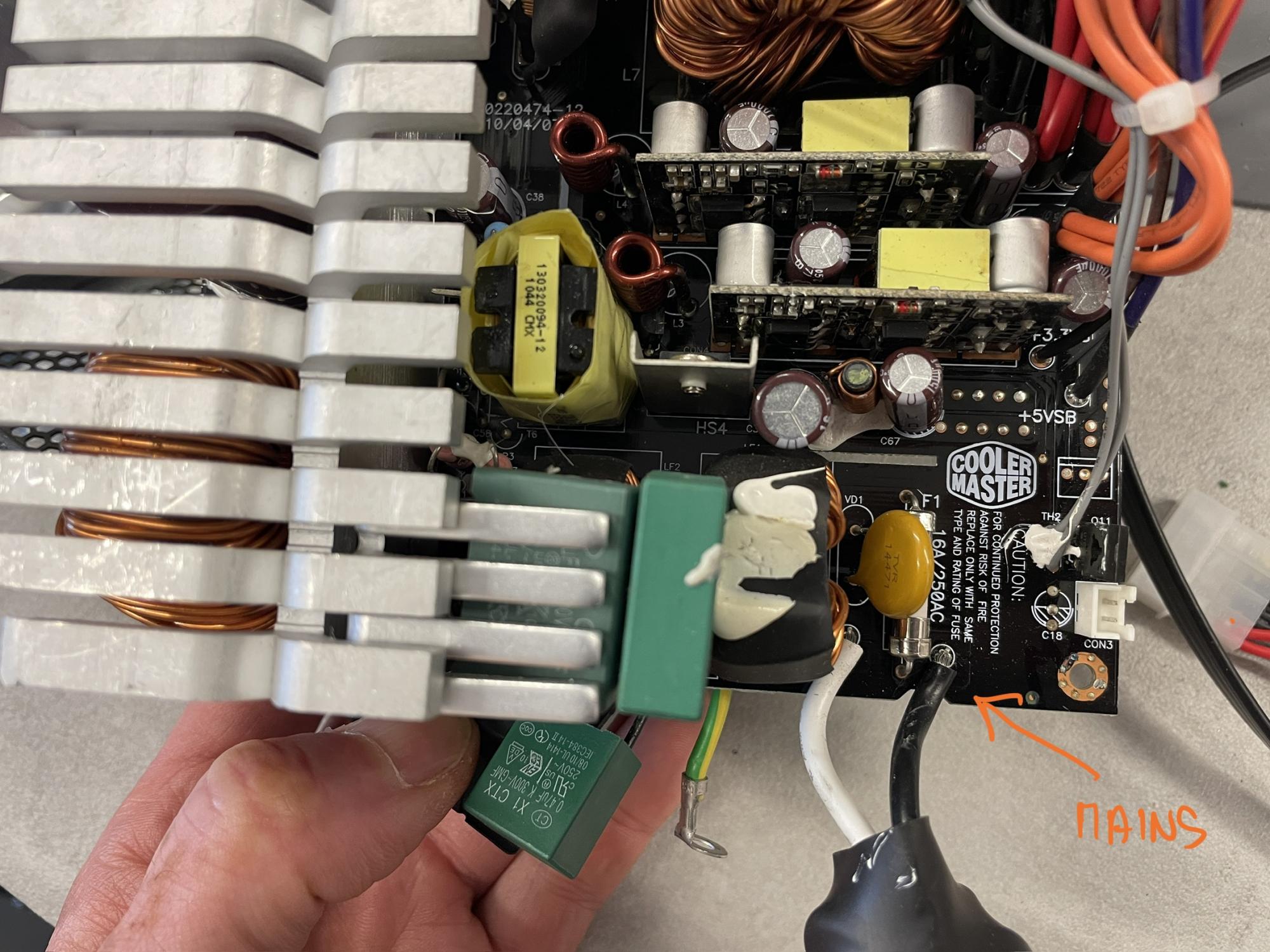

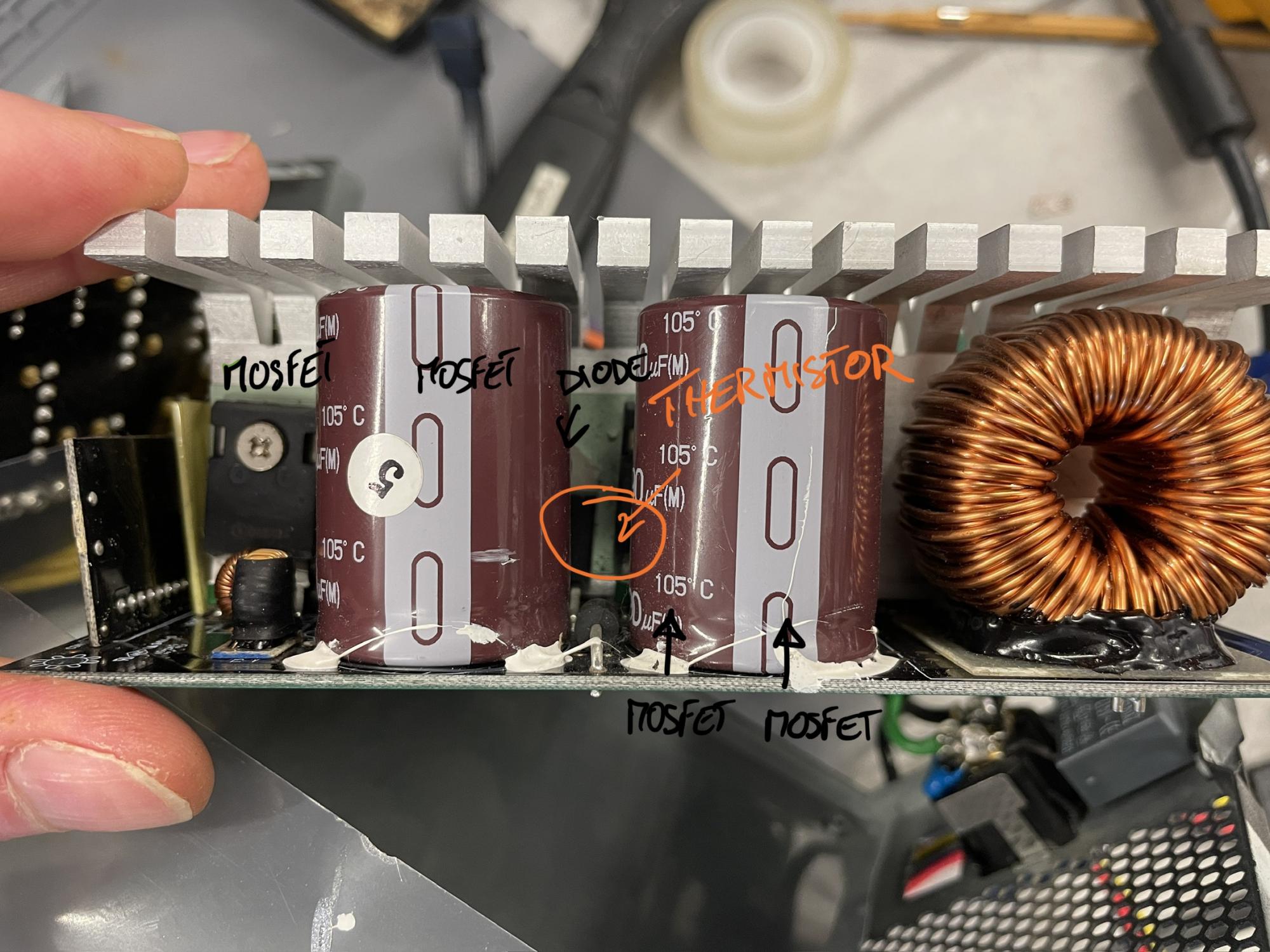

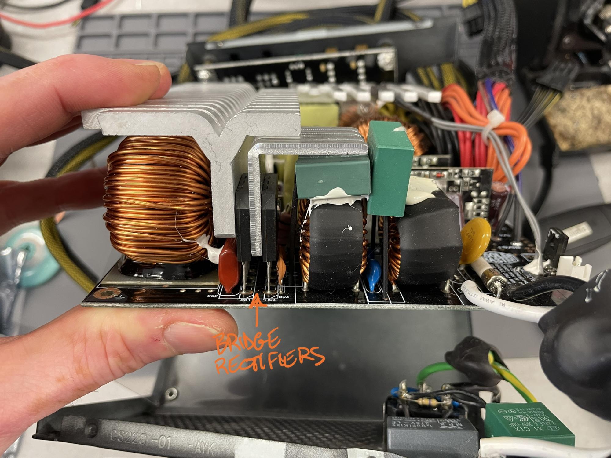

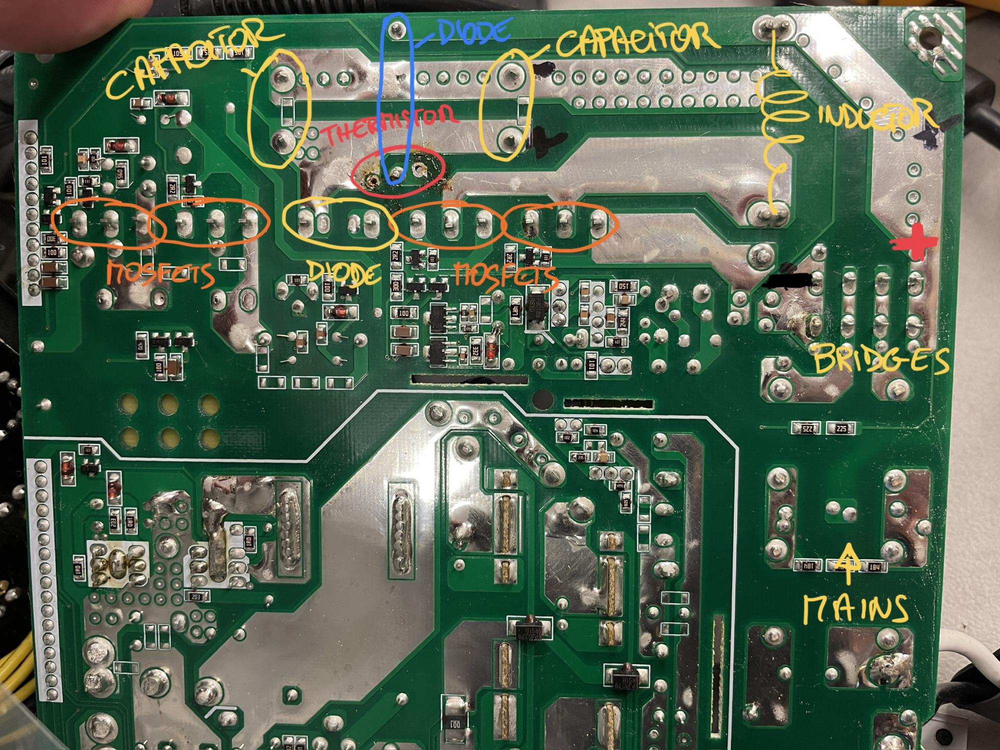

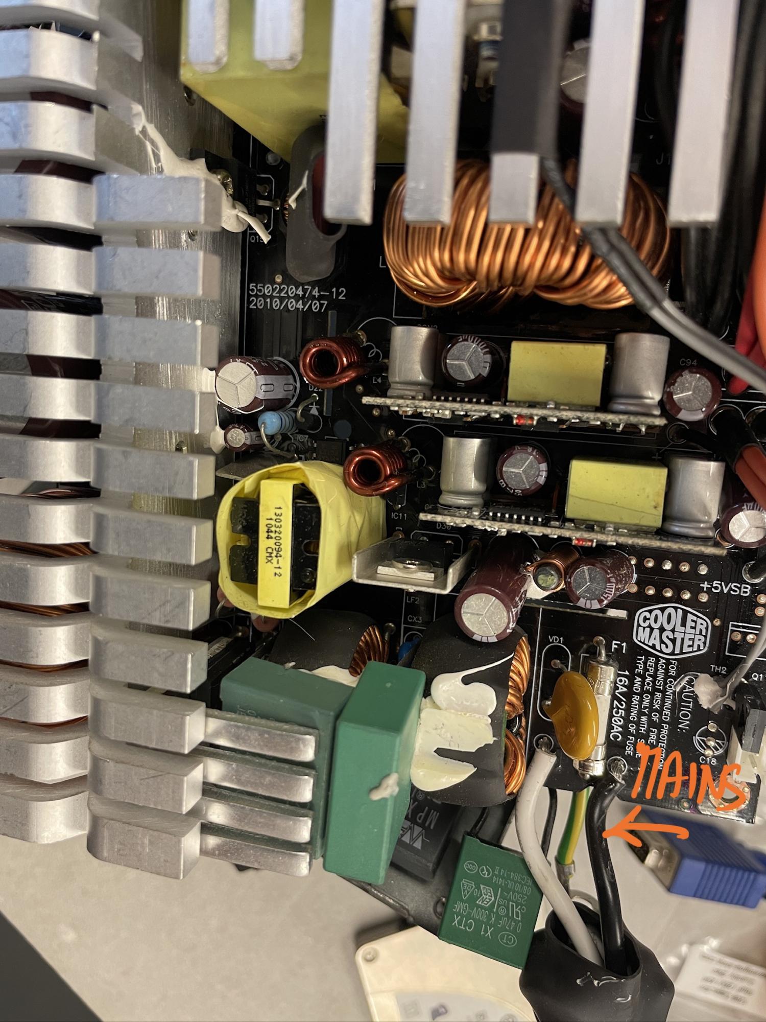

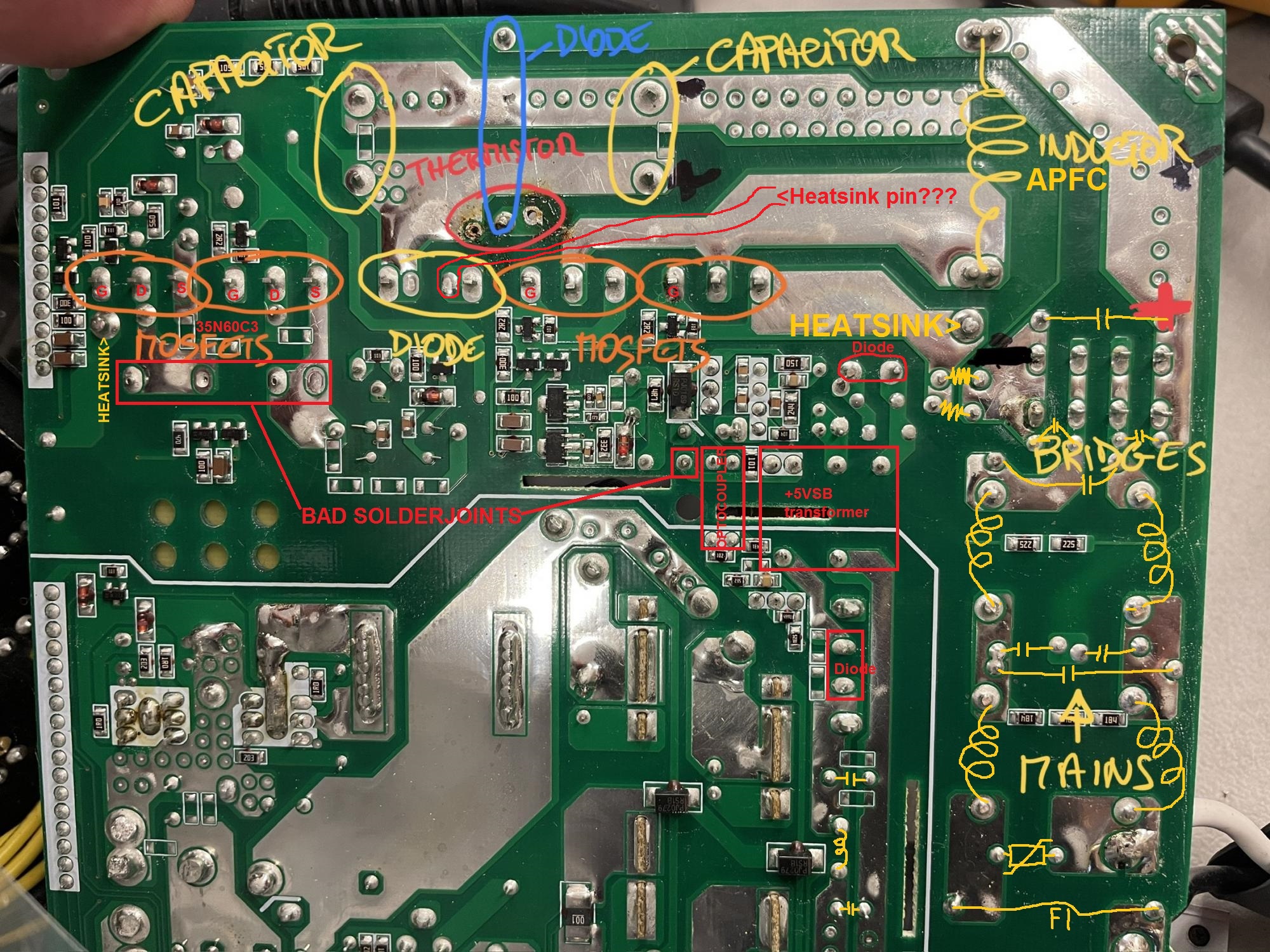

            Adding some pictures with some description to help.
            On those pictures I've removed a small thermistor which would normally sit in between the capacitors.
            I'm trying to find out what soft-start topology this PSU has. I was looking for a thyristor but I couldn't find one. That thermistor could be the one but it's only 8 ohm when cold and max 4A. This is a 1200W PSU so there must be something else bypassing it when the caps are charged.
            Any pointers, please shout! And thanks!
            • Per Hansson
              • Jul 2005
              • 5895
              • Sweden
              Re: Cooler Master 1200W Silent Pro Gold - Bad power switch
              You have drawn the rough path up, to confirm you did not miss anything just do a resistance check from the mains to the bridge rectifiers input.
              And then from the bridge rectifiers output to the capacitors.
              If there is nothing there then the answer is that there is nothing there.

                    I was kind of implying the thing has no soft-start, but of course just follow the traces to confirm that.
                    Most can be seen directly from the underside, just follow the traces and see what components are on the other side.
                    To give this thing a proper soft start you could replace the thermistor with say something 20 to 100ohm.
                    And then in parallel with that put a 5VDC relay that shorts it out.
                    Connect the relays coil to the 5VSB and you will have a pretty elegant soft-start.

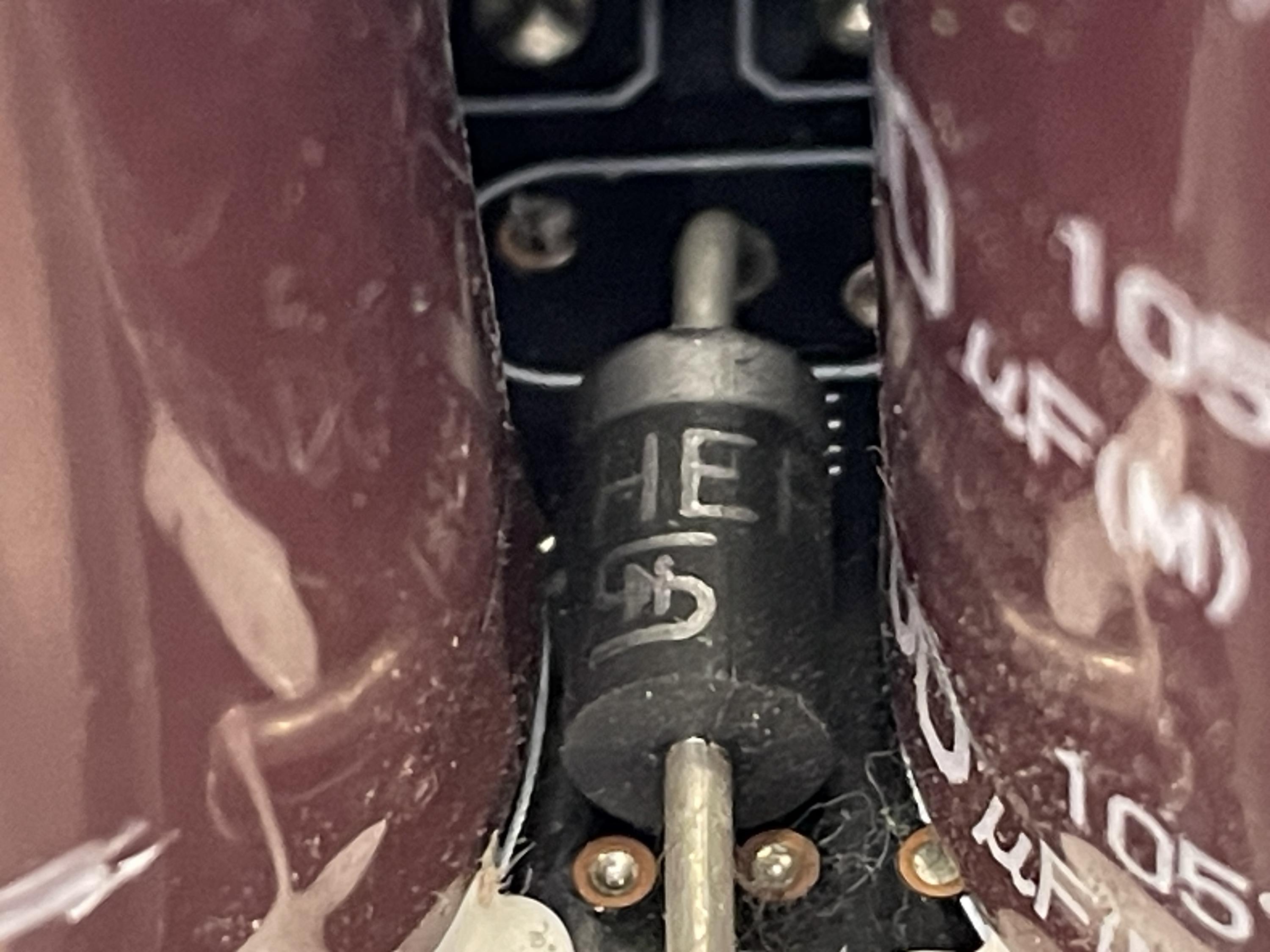

                    But there is very little room so seems hard, btw are you sure the diode you drawn before the thermistor is really a diode? I don't understand what purpose it would have...

                      The diode looks like a diode to me (attached) but I'd be ready to be proven wrong!
                      I've measured continuity between the positive of the bridge and the positive of the capacitor and no, there is no continuity. I can measure the junction of the diode of course or megaohms when in resistance mode.
                      So it's not directly connected as suspected. It's also very difficult to work on that PCB as the output PCB cannot be unscrewed as they soldered the bolts in place...

                        Ok, I was guessing it was just a wire with an insulator around it from the previous pictures but it is obvious from this picture that it actually is a diode.
                        That diode is for the Active PFC (APFC) large inductor on the edge of the PCB, it prevents the boosted voltage (390VDC or so) to backfeed into the lower voltage at the bridge rectifiers when the main power supply starts.
                        Anyway that does not matter, to fix the switch you could just bridge it or leave it on and just unplug the power cord instead.
                        Or build a proper soft start

                                I think it is better if we take a step back and look at the whole picture:
                                240VAC (or 115VAC in the US) comes in through the black and white cables.
                                They go through a 16A fuse F1 and through two common mode rejection chokes into two bridge rectifiers.
                                The bridge rectifiers change the voltage to DC at 240VAC x √2 = 340VDC (Or 115VAC x √2 = 163VDC in the US)
                                The positive goes up to the diode we discussed before and through the thermistor that you wrote on Reddit is a SCK-084 and then directly into the bulk filtering capacitors.
                                The negative presumably goes directly to the negative of the bulk filtering capacitors, you can check this with a multimeter please.
                                This completes the standby portion of the power supply, once the voltage reaches something like 150VDC the 5VSB control chip (that I can't see) will start working and after startup it will produce 5VSB via the small transformer.

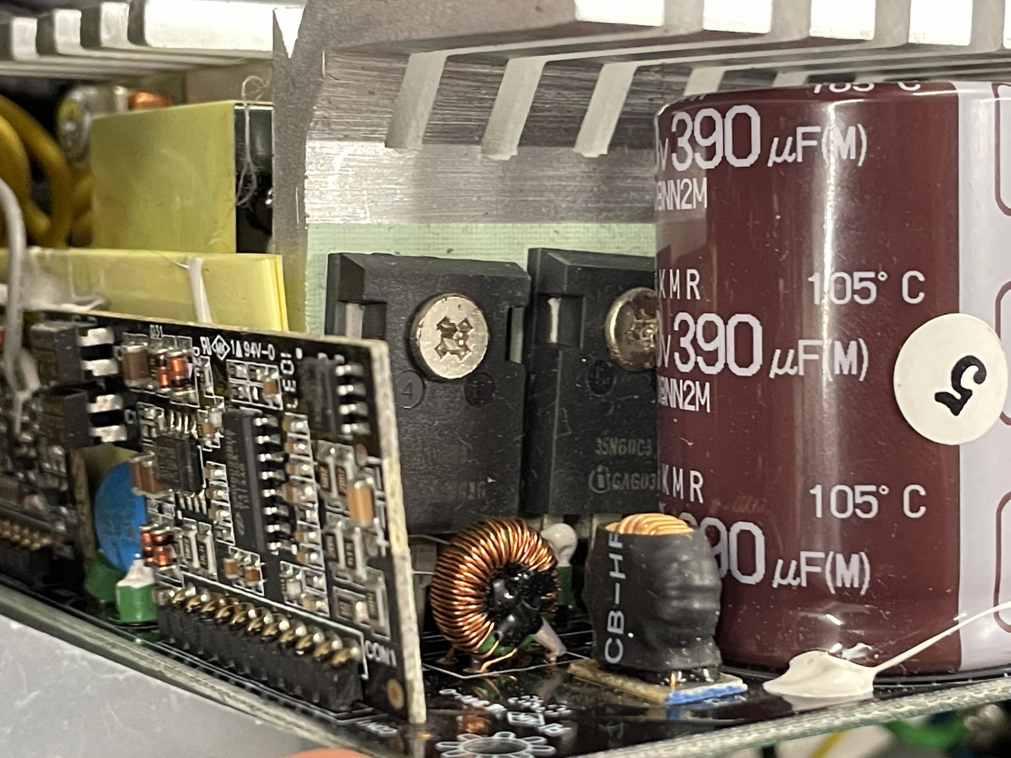

                                When the main power supply is started by taking the green ATX cable PS_ON low the APFC stage in the power supply is activated.
                                This boosts the voltage from 163VDC (in the US) or 340VDC (Europe) up to around 390VDC via the large APFC inductor.
                                This is done with the two MOSFETS closest to that inductor (I was unable to see their part number) and the large diode on the same heatsink.
                                This is where the previously mentioned diode becomes useful: it now prevents the higher DC voltage from feeding back towards the lower DC voltage at the bridge rectifiers.
                                At this stage or rather the same time the other two mosfets 35N60C3 will start pulsing the high voltage DC through the large transformer on the left (check it's soldering in attached photo!)
                                This is what produces the 12VDC in the power supply, finally on the secondary there are two DC-DC boards that step the 12v down to 5v and 3.3v respectively.
                                Now since your problem is with the switch you can ignore the third paragraph: the inrush only happens when the standby stage starts.
                                As you can see the voltage on the positive side can only go through the thermistor, so there is nothing "wrong" with the soft start. (Unless there is something on the negative side I'm not seeing).
                                The boosted voltage does not go through the thermistor, but instead via the APFC inductor, the two large MOSFETS and then I guess via the heatsink to the big diode on the heatsink.
                                But in any case the DC coming in from mains is still enough to heat the thermistor to somewhere around 60°C to 100°C lowering its resistance to 1 ohm or so. (depending on load on the power supply of course).
                                    I am still not understanding how PFC works but are you saying that once the PFC starts, there is no current flowing into the thermistor as the PFC is doing all the work? So the thermistor should only get to 60-100C when the mains switch is toggled and capacitors are charged?
                                    I have not seen the thermistor put in this position before, it is pretty clever:
                                    Normally it sits directly at the AC input side, and thus has to be rated for the full load of the PSU (i.e. be big and expensive and dissipate allot of heat)
                                    But where they put it that is after the APFC inductor.
                                    So the energy that is in the APFC inductor never has to pass through the thermistor, since it is located after the inductor.
                                    There is still energy passing through it, but just allot less than would be if it was positioned in a more traditional place like directly at the input.
                                    I confirm the negative of the bridges is going straight to the negative of the capacitors.
                                    I have a feeling we are disagreeing on some wording here
                                    What I am trying to say is that it seems the soft-start circuitry might be malfunctioning as the main switch fails every single time.
                                    No we are not disagreeing on wording: I'm saying the only soft start that exists is the thermistor.
                                    In post #11 you checked the positive side and this goes directly to the big capacitors through a diode and the thermistor.
                                    And then in the quote above you confirm that the negative goes directly to the big capacitors.
                                    Inrush protection can only be in series with the capacitors: so you can ignore all other circuitry and thus reach the conclusion that the thermistor is the soft start
                                    This was what I was alluding to in post #7, maybe I should have been more clear.
                                    Thank you for taking the time to guide me through the process, and for marking up the PCB picture, I appreciate it.
                                    You're welcome, can you also please check resistance at the point I marked with red text as "Heatsink Pin???" in the same picture, if that leads to the heatsink or if you can see where it leads in the top of the PCB?
                                    • tony359
                                      • Oct 2018
                                      • 264
                                      • United Kingdom
                                      Then I'm not sure I understand what you mean with
                                      There is nothing wrong with it.
                                      I'm not trying to argue with you of course!
                                      Great. So, since every time I turn the switch on it gets stuck, would you agree that maybe the thermistor has failed - or partially failed?
                                      I confirm those are the heatsink pins.
                                      And thanks for explaining how the soft start works on this unit, pretty clever indeed.
                                      • Per Hansson
                                        • Jul 2005
                                        • 5895
                                        • Sweden
                                        What I meant when I said "There is nothing wrong with it" is that there is no fault per-se, it works as intended.
                                        You should instead ask yourself why did the original switch fail?
                                        Most people never use that switch, so how do you know the original did not fail very quickly also?
                                        And that your replacement switches are much too weak to handle the inrush just like the original was?
                                        I would either just bypass the switch or go all in and attach two wires where the thermistor used to be and connect them up to a relay like this one.
                                        Then I'd crimp a thermistor with a much larger ohm value together with those two wires on to the relay and power the relay from the +5VSB.
