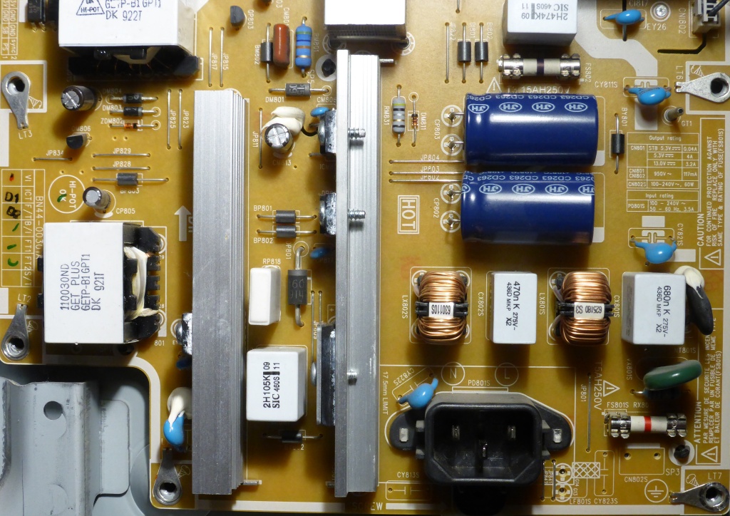

      I uploaded picture from the board.

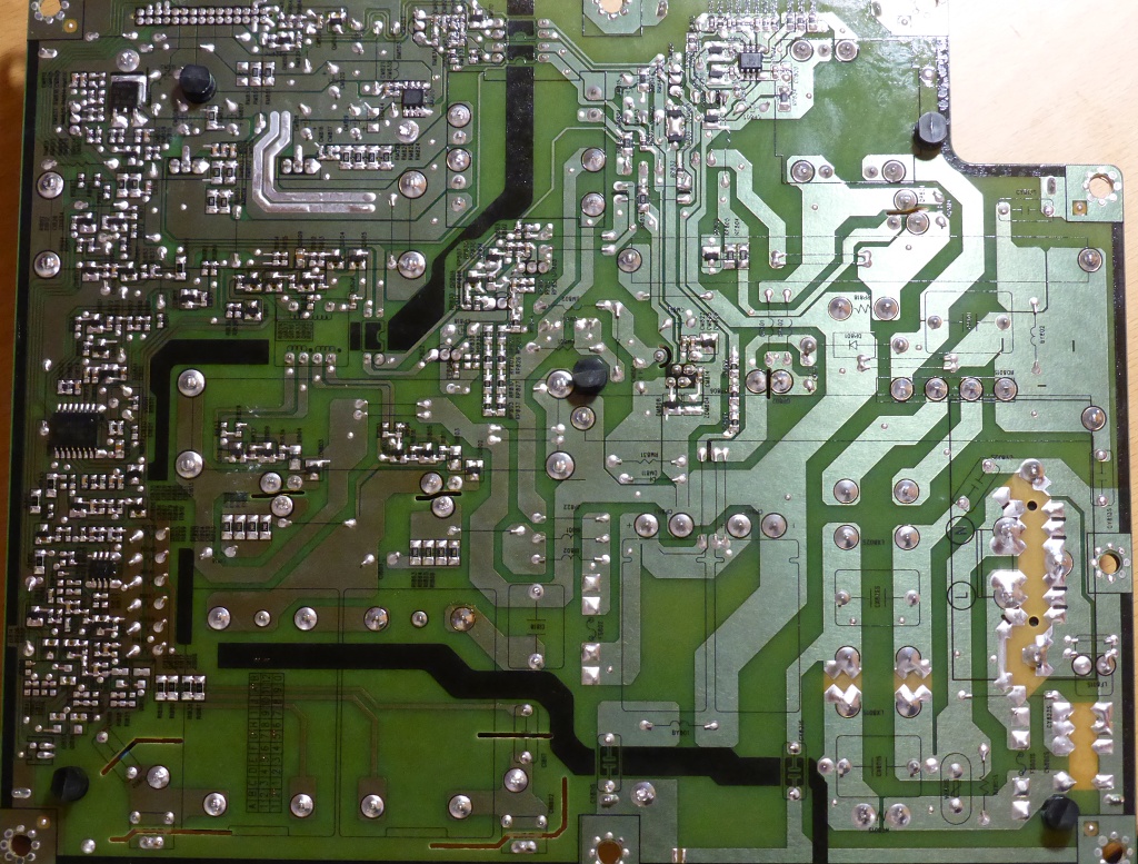

          The PFC Voltage booster circuit is not working, we need good clear pictures of the bottom side of the board to locate the PFC Controller IC to check to see if it has VCC to run IC.
          • Nikolasch
            • Nov 2015
            • 7
            Re: BN44-00301a
            Thanks for you reply,
            I hope the picture will show what you're asking for.
            If you need any other information, pls let me know.
            cheers
            Olaf

              Budm wants a good clear picture of the other side of the board
              • Nikolasch
                • Nov 2015
                • 7
                Re: BN44-00301a
                OK, there you are.
                Cheers
                Olaf
                  Re: BN44-00301a

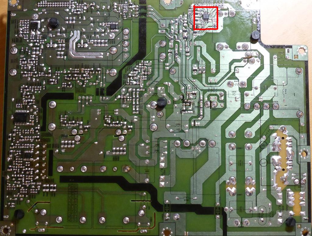

                  We need the P/N of that PFC Controller IC.
                  • Nikolasch
                    • Nov 2015
                    • 7
                    Re: BN44-00301a
                    the device is ICP 801 and it read EK17 FAN7530.
                    Is there any circuit diagram of the PCB available?
                    Cheers
                    Olaf

                      OK, I forget to ask you to check PFC Diode DP801 to make sure it does not conduct in both direction or not, if it is tested OK then check the DCV for the PFC IC.
                      I do not have the diagram. Look up the spec sheet of the FAN7530, then check the DCV between VCC and the GND pin when TV is turned on to see if it its getting any DCV to run.
                      You will be working in the primary deadly side of the circuit so do not touch anything with your hands or body, you should plug the unit into the GFCI outlet for protection.

                            thanks, I got the data sheet and I measured the VCC OK with 13VDC between pin 6 (GND) and 8 (VCC). I suspect the reference at the internal zener diode (pin 5) not alike 6.5V but 0.7V.
                            The diode measures OK.
                            Any idea to that? Right now that bastard shows a nice picture.
                            I think to replace the FAN 7530.
                            Does anyone have reliable source to buy?
                            Cheers
                            Olaf
                              Re: BN44-00301a
                              Cheers
                              Olaf
                              Are you sure you are not getting around 400VDC measured between the two legs of the main filter cap? The Inverter circuit needs that boosted Voltage to function, at 315VDC as you reported the protection circuit will kick in and not allow the backlights inverter circuit to come on.
