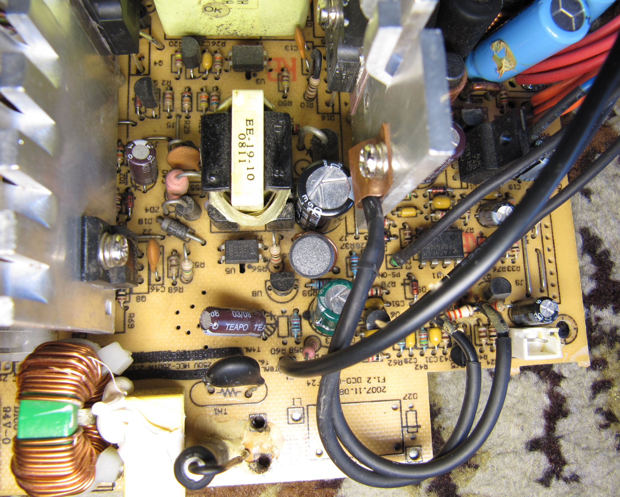

    Fake Teapo 680uF primary caps-470uF real capacity (Arctic A-430BX)

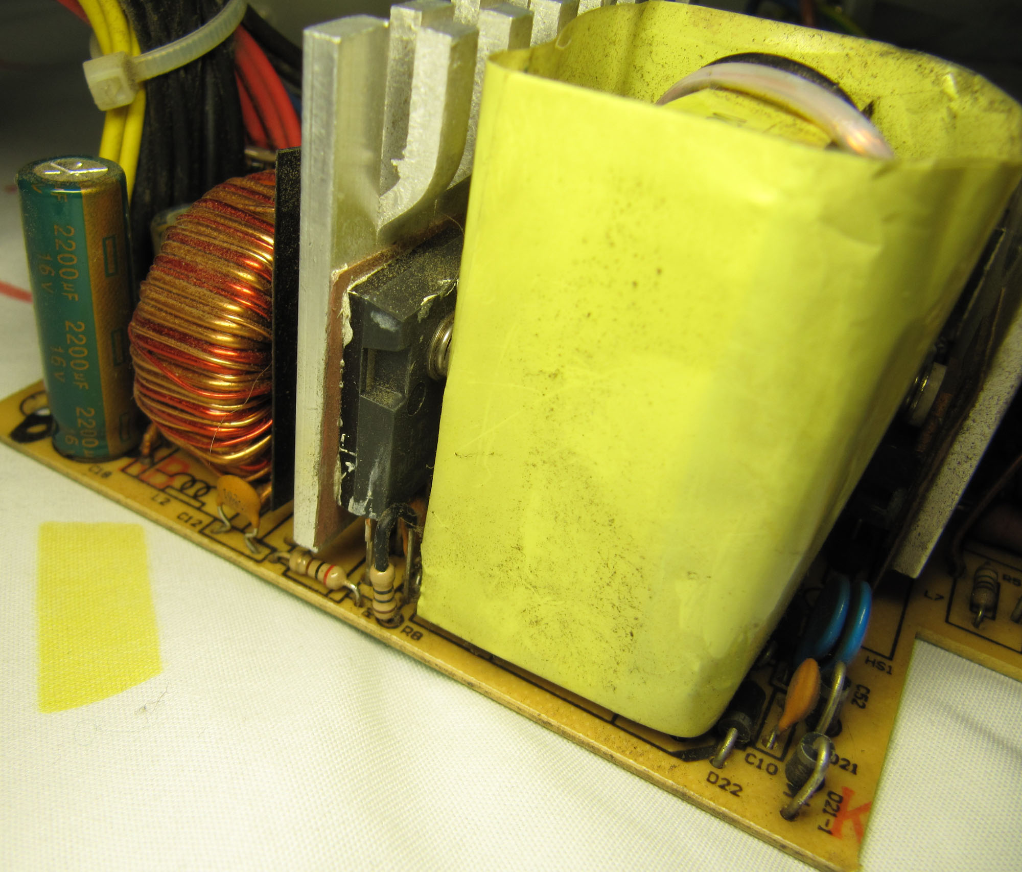

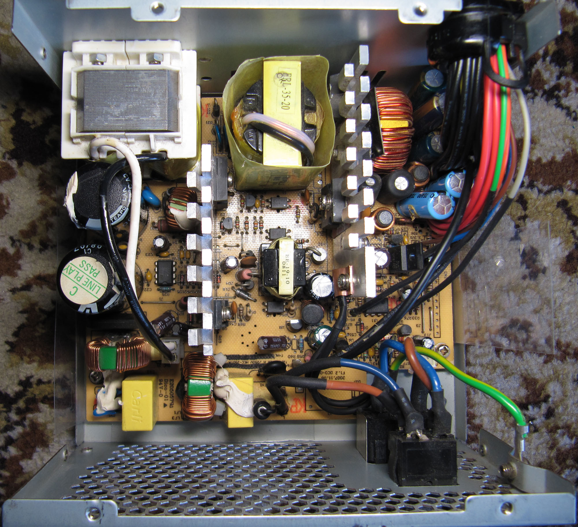

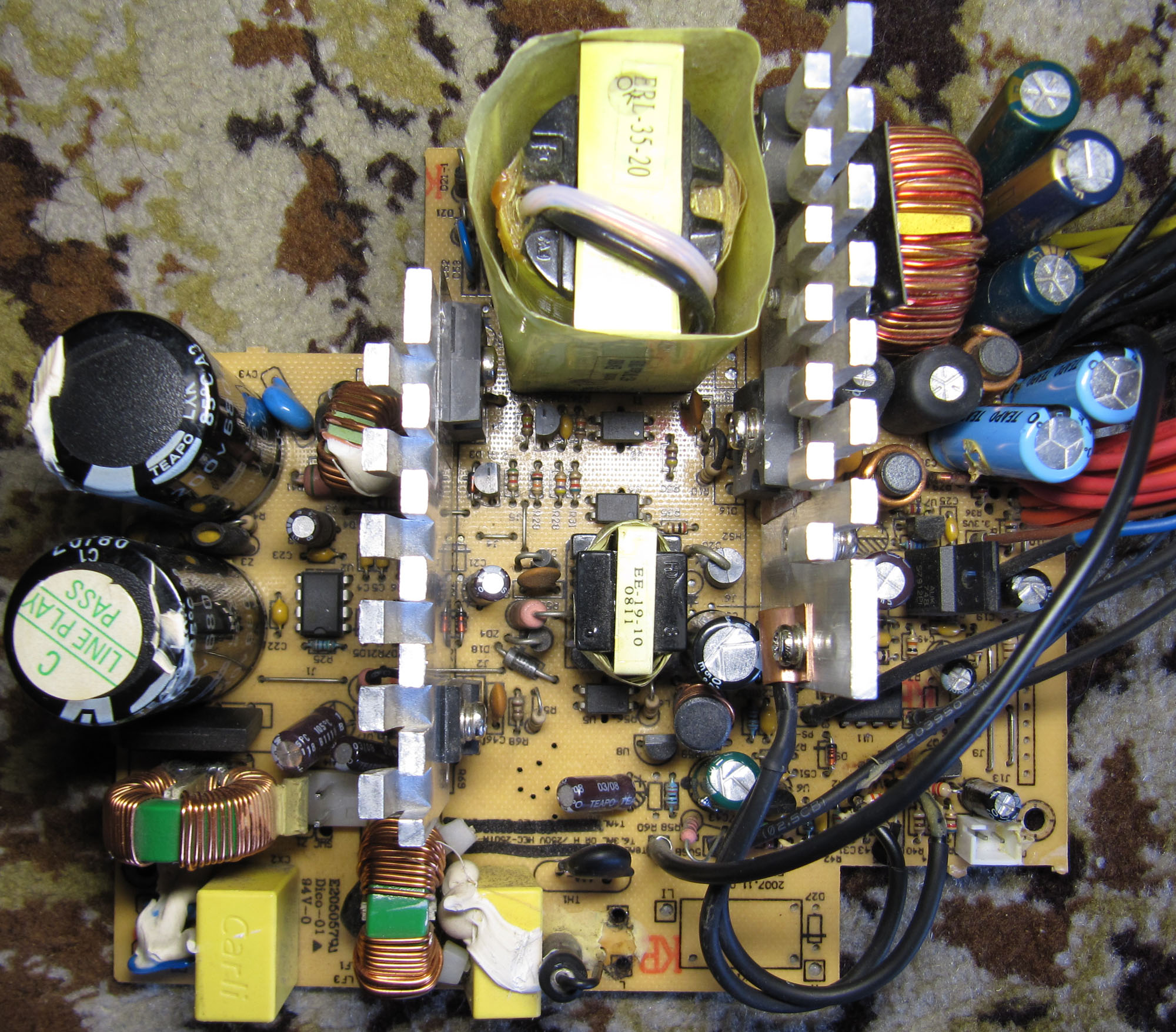

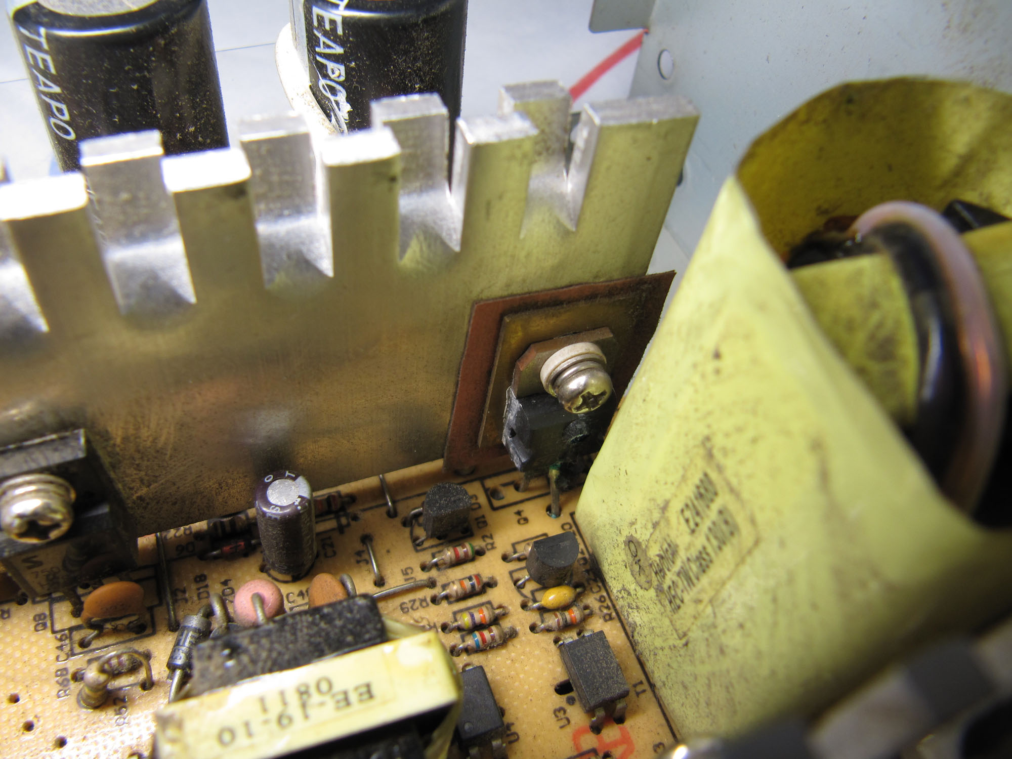

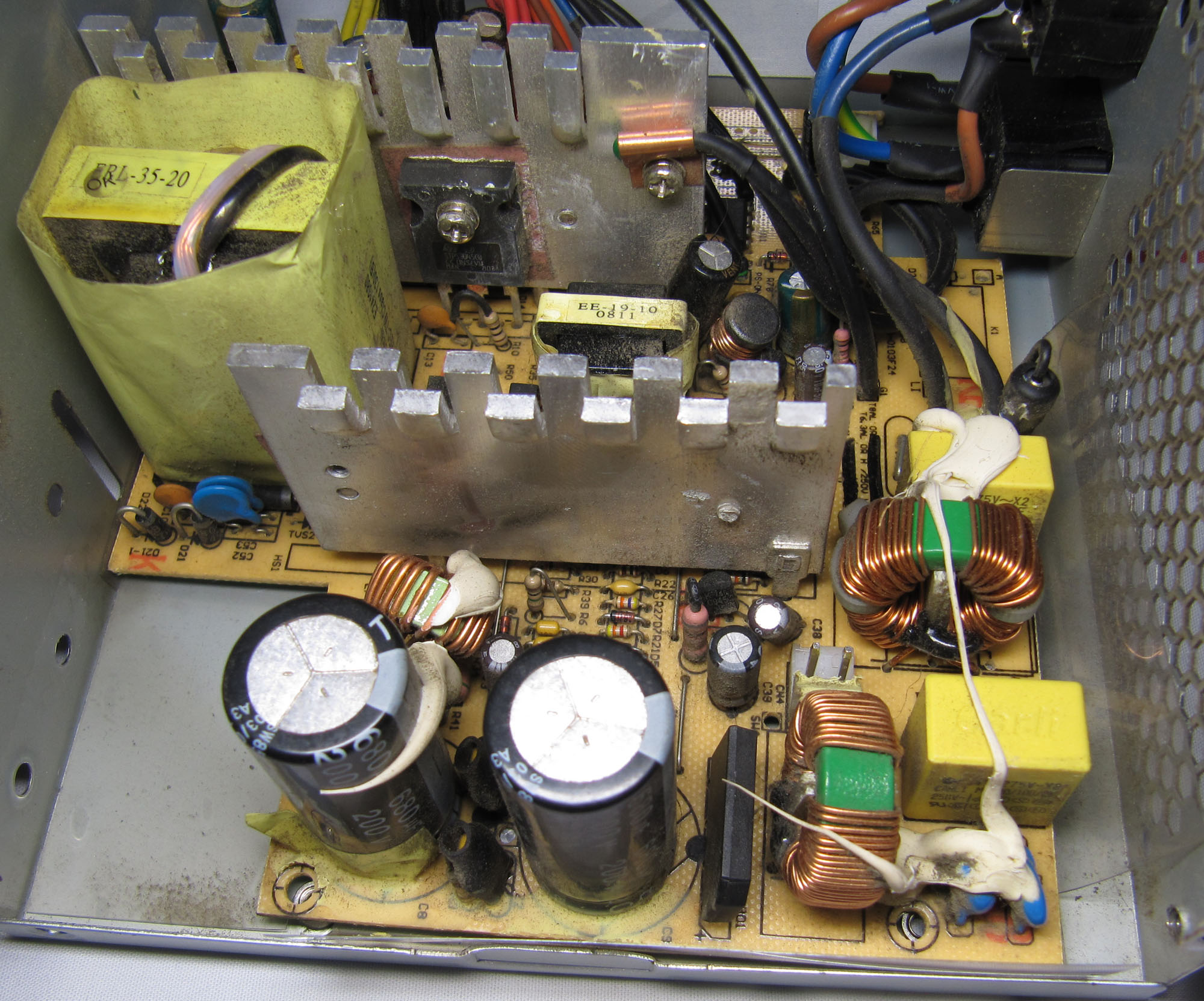

    The label says it is 430W but the pcb says “HEC-250TN”. At least it has a full input filter, only the thermistor is missing. The primary caps real capacitance is 470uF. That makes me wonder if someone did fake Teapos.
    -Passive pfc
    -GBL406 4A bridge rectifier
    -UC3843B PWM controller
    -S2N60 N-Channel MOSFET for 5vsb
    -TPS3510P IC for psu protection
    -heatsinks only good for 350W max provided there is good airflow and high efficiency
    -main transformer is ERL 35 size. Not good for 430W in my opinion.
    -I was unable to read the main mosfet's marking. There is something like green glue attached to it. It is in small package and there is only one there. I bet it can't do more than 350W without blowing up.
    -psu fan is thermally controlled and "Hec" brand.
    -All caps are Teapo, DON and Su'scon
    -1x MBR3060 @ 12V
    -1x STPS3045C @ 5V
    -3.3V: I think current passes through an STPS3045C and then a 09N03LA Power-Transistor, I am not sure, I am not familiar with this design... Could someone explain this to me please?
    -Soldering is ok
    -Of course it is not dual rail as the label states. It is single rail psu.
    What do you think its actually wattage is?
      It looks like the STPS3045C technically outputs the power for the 3.3V, and the 09N03LA acts as a voltage regulator to step the power down from the 5V rail
      350W seems about right.
      Excuse the potentially stupid question: Is that what's called 'single transistor forward' topology?
      Yes
      EDIT: I've seen those fake Teapo's too! https://www.badcaps.net/forum/showpo...6&postcount=51 Are you gonna recap that? It doesn't look bad.

            Re: Fake Teapo 680uF primary caps-470uF real capacity (Arctic A-430BX)
            This is an independent linear 3.3V rail design. With this design, the transformer's 5V tap is taken and rectified (with the STPS3045C, in your case) and filtered. Then this voltage rail (which is separate from the main 5V rail) is stepped down in a linear fashion with a MOSFET (very inefficient at moderate-to-high loads, but very clean and stable voltage output). There's usually another cap after the MOSFET to further smooth power. You can recognize this design by the lack of torroid coils for the 3.3V rail.
            There's also the dependent linear 3.3V rail design. This design is usually found in very cheap PSUs because it uses very few parts (i.e. cheap). It's the same as the design above, except you don't have a rectifier. Rather, the MOSFET is few directly from the main 5V rail of the PSU, and the MOSFET simply steps it down to produce 3.3V. You still get the same clean output voltage, but the downside is that the 5V rectifier needs to be bigger since it is used for providing power to both the 3.3V and 5V rails (so the current rating of the 5V rectifier defines the combined power on 3.3 and 5V rails).
            Both of these designs are referred to as linear 3.3V designs. The other design is the one you're probably more familiar with - a small torroid coil for the magamp regulator and a bigger torroid coil next to the 5V/12V torroid coil.

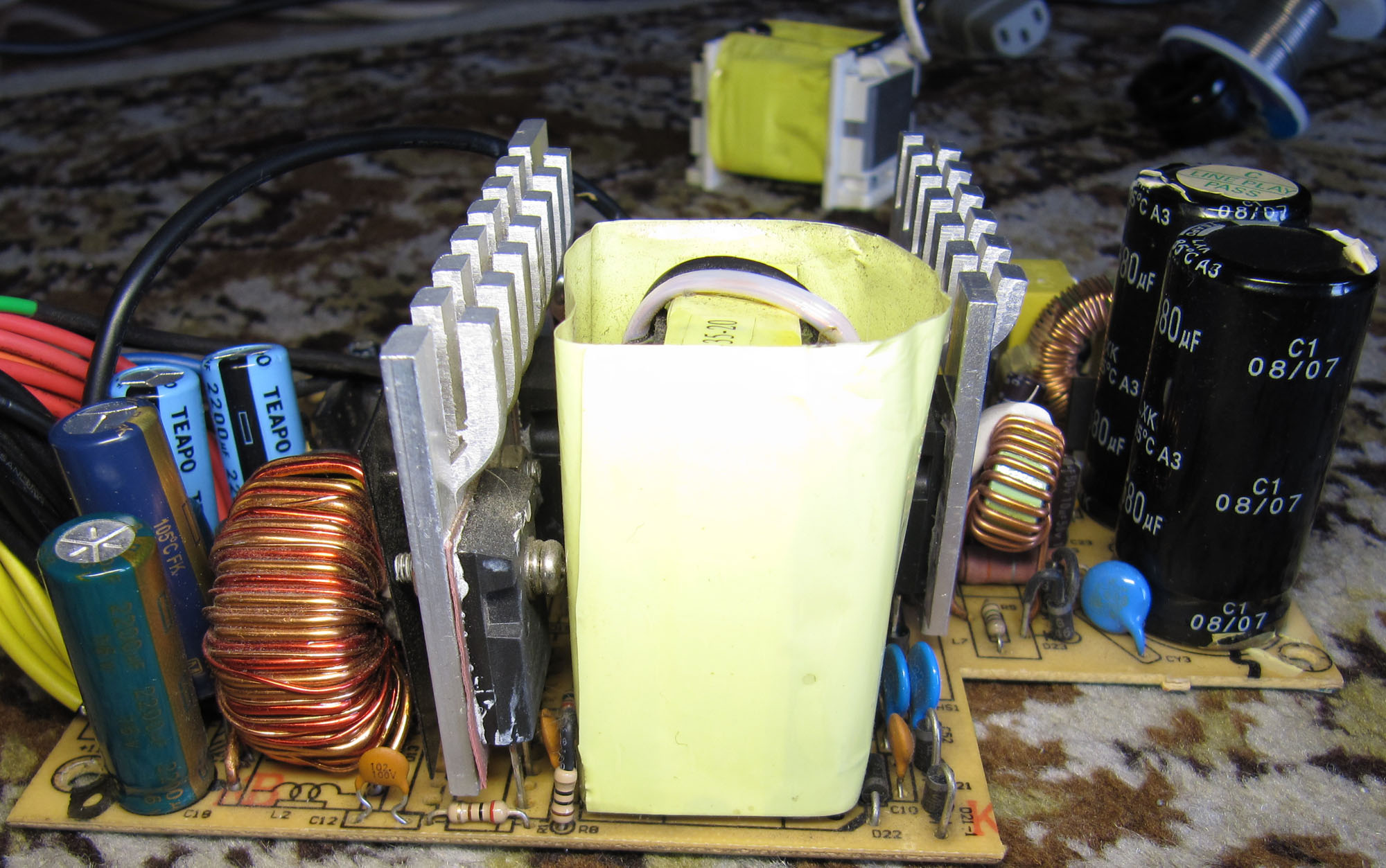

            Depends on what the main MOSFET on the primary is rated for. The Thermaltake TR2-430W (XP550-NP) uses the same platform, and although rated at 430W by Thermaltake, it is only capable of 350W max (PSU has OPP if I remember correctly, so it shuts down if you try to pull more than that out of it).
            The psu works without a problem.
            That may be. But it has a 2-transistor 5VSB design that DOES have a critical cap and is capable of being a motherboard killer (I think even someone on Badcaps posted about his/hers having a voltage on the 5VSB above 6V). So make sure to change that critical cap with something good.
            Confirmed
            My TR2-430W has two 680 uF Teapo caps as well, and both measured around 470 uF. See the chart at the end of my post here:
            https://www.badcaps.net/forum/showpo...5&postcount=57

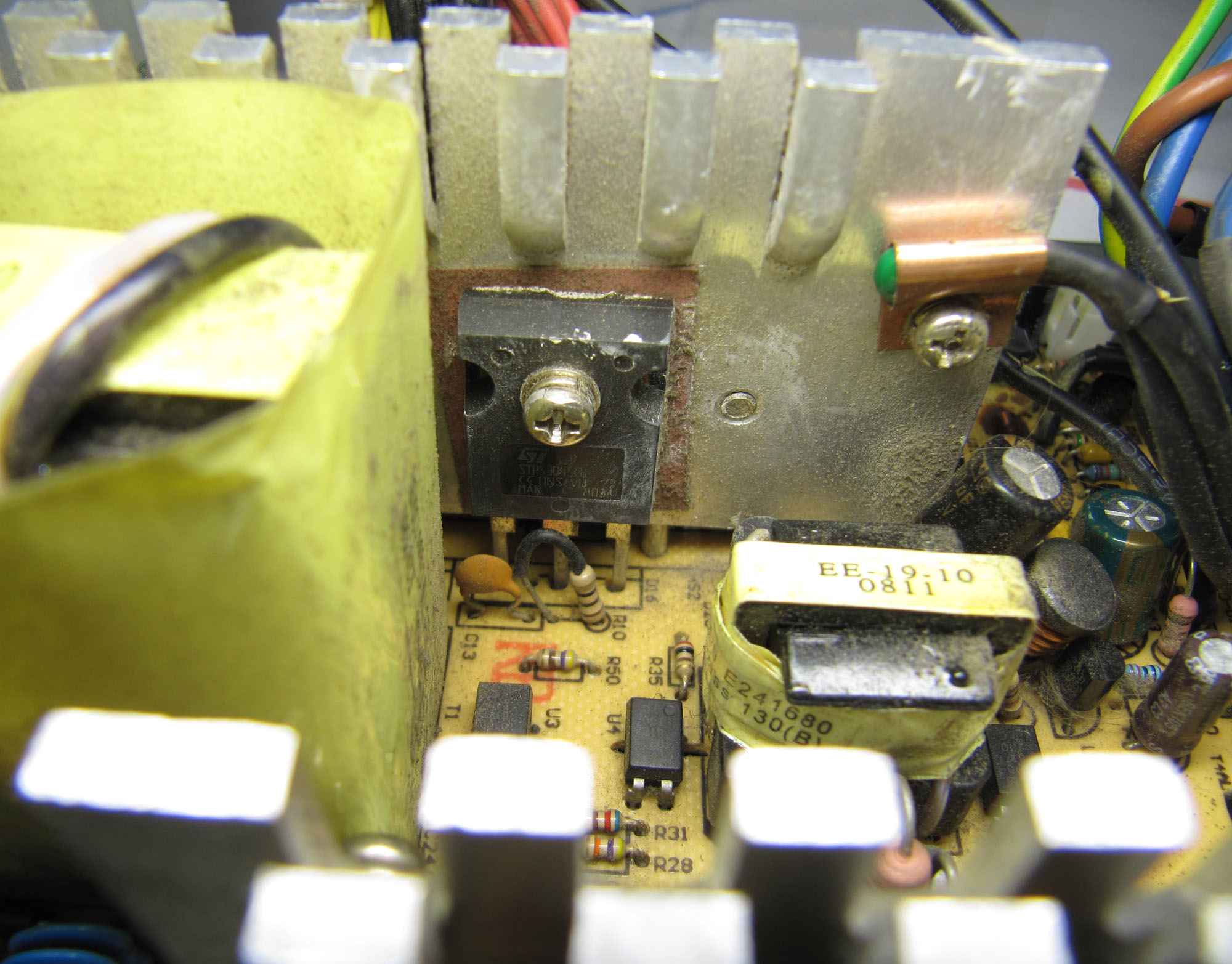

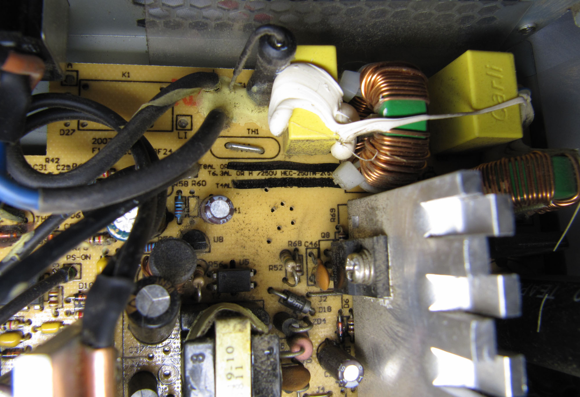

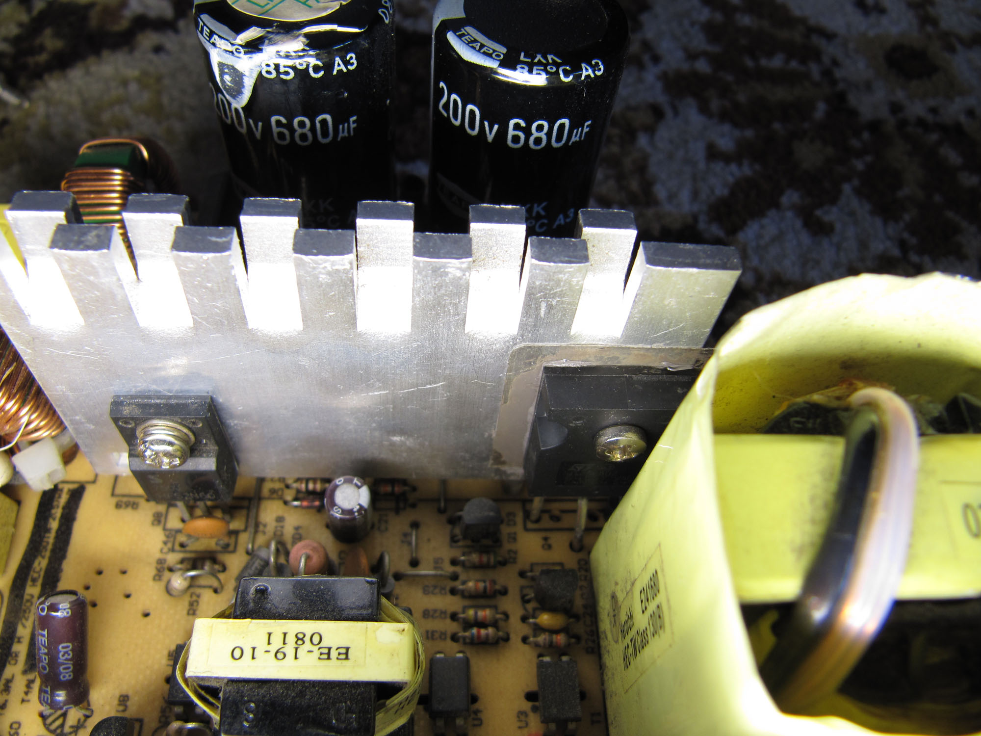

                      This power supply belongs to me now and I am planning to do a recap.
                      I was able to read the marking on the main mosfet. The Arctic psu uses an STP10NK60Z (TO-220 package) in a single transistor forward configuration
                      Drain Current (continuous) at TC=25°C ID=10 A
                      Drain Current (continuous) at TC=100°C ID=5.7 A
                      Drain Current (pulsed) ID=36 A
                      RDS(on)=0.65Ω
                      Total Dissipation at TC = 25°C Ptot=115W
                      I have some STW9NB90 (TO-247 package, RDS(on)=0.85Ω) available from dead Antec SmartPower psus.
                      Is it worth to replace STP10NK60Z with STW9NB90 or should I order something better from http://gr.rsdelivers.com/?
                        lower rdson is better

                          I thought you said earlier that the PSU worked. If the switcher isn't blown, then I wouldn't worry about replacing it. I would just recap the PSU and keep it as a 350 watter. It would do fine in a basic home or office PC.
                          • goodpsusearch
                            • Oct 2009
                            • 2850
                            • Greece
                            The psu works but I thought I could get some extra juice from it if I replace the TO-220 STP10NK60Z mosfet with something better as Th3_uN1Qu3 suggested.
                            For example this psu you have reviewed was able to output more than 400 watt using 1x FQA10N80 MOSFET (RDS(on)=1.1Ω) in a single transistor forward topology.
                            I am also going to replace the fake Teapos with real 680uF primary capacitors.

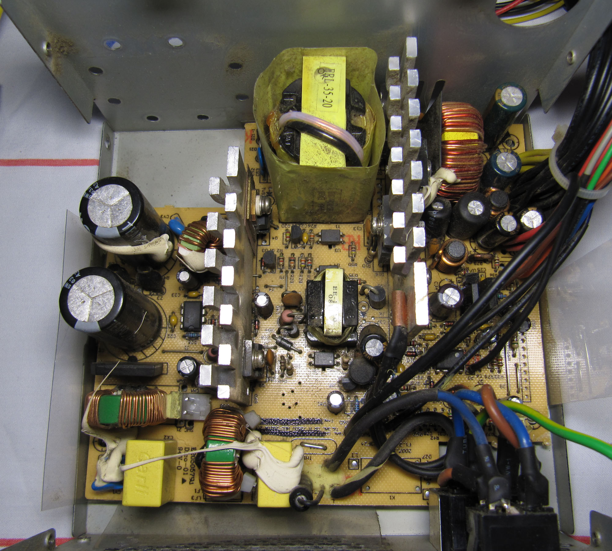

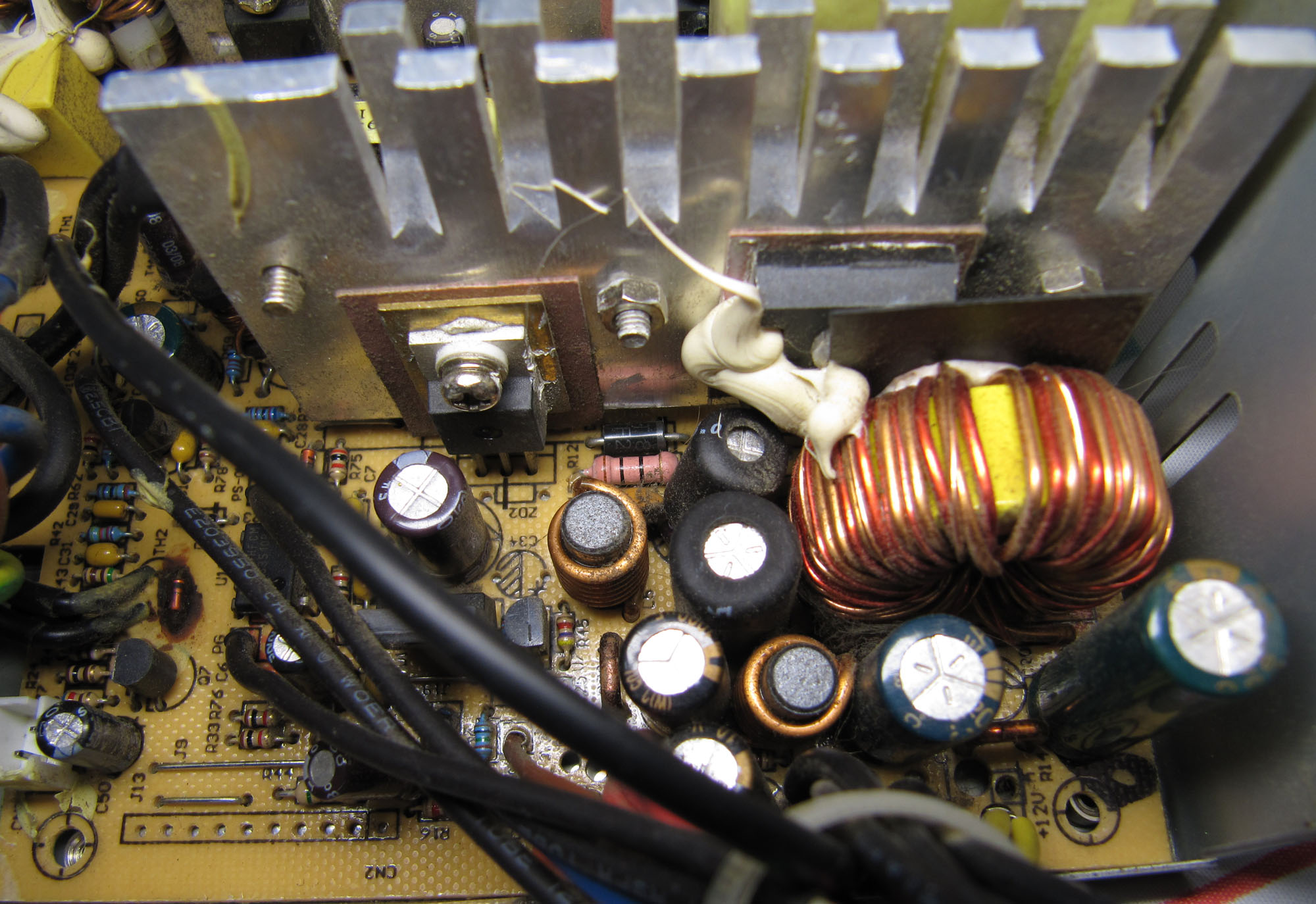

                                I partially recapped that HEC OEM power supply. I used Panasonic, Sanyo, Nichicon, Rubycon and Teapo capacitors.
                                I also tweaked the fan controller. The psu still remains one of the most silent I own and it doesn't overheat.
                                I replaced the fake 680uF primary caps with real 680uf caps (measured capacity 725uF & 690uF).
                                I replaced STP10NK60Z with STW12NK80Z. More info about that operation here:
                                https://www.badcaps.net/forum/showthread.php?t=45884
                                Do you think it can do 350W without blowing?
