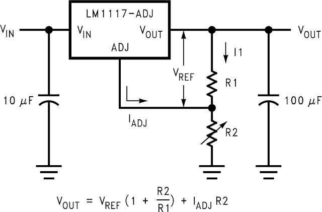

      It's usually not quite as simple as adding a little thermistor.
      Usually, there's a voltage regulator or a current limiter which controls the speed using the resistance of the thermistor as if it was a potentiometer.
      You can look for example at a datasheet for lm1117, which is a simple linear regulator that can output up to 0.8A which is enough for a fan:
      Being a linear regulator, it means it needs a specific voltage above the output voltage to work properly, in this case of this voltage regulator the voltage is 1-1.2v.
      So with this regulator, you could for example adjust the voltage of the fan between 5v and 11v, if you give it 12v at input.
      If you scroll down to page 9, you can see a schematic for a simple adjustable regulator:
      R1 is fixed, and recommended to be between 100 and 120 ohm, let's say you go with 100 ohm, so you're left with adjusting R2 to get 5-11v.
      According to formula ...
      R2 = (5v / 1.25v - 1 ) x 100 = 300 ohm (for 5v)
      R2 = (11v / 1.25v - 1 ) x 100 = 780 ohm (for 11v)
      So now you can pick a PTC (resistance goes up as temperature increases) so that when the psu is at 25-30c your ptc will give 300 ohm and when the temperature goes up to 60-80c your ptc will give 780-800 ohm or thereabouts.
      Alternatively, you can also put a simple resistor in series with this ptc, for example in case you can only find a ptc that's 0 ohm when cold, 470 ohm when 90-100c then you could put a 330 ohm in series with this ptc.
      Another example ... get a basic microcontroller and a mosfet/transistor and some capacitors. Use the ptc or ntc with another resistor to form a voltage divider and measure the voltage with the microcontroller. Based on that voltage, turn on and off the mosfet/transistor to adjust the power going to the fan.

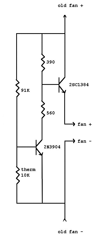

        There's a very simple one here (http://www.heatsink-guide.com/control.gif). The only trouble with it is, that it has an extremely 'aggressive' curve. 1-2*C lower than the target temperature, and the fan turns off. 1-2 higher, and it's at full speed.

          Re: PSU fan controller
          Very cool, exactly what I was looking for!

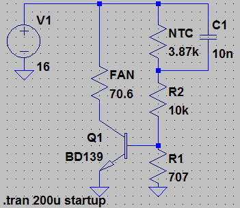

                  A while ago, Th3_un1qu3 showed me a really simplified one (see attached picture).
                  The 10nF cap in parallel with the NTC is to give the fan a "kickstart", since it takes a higher voltage to start them, than to actually keep them spinning.
                  I'm guessing the "FAN" resistance is just its rated voltage divided by its rated current. Feel free to play around with the values in LTspice though

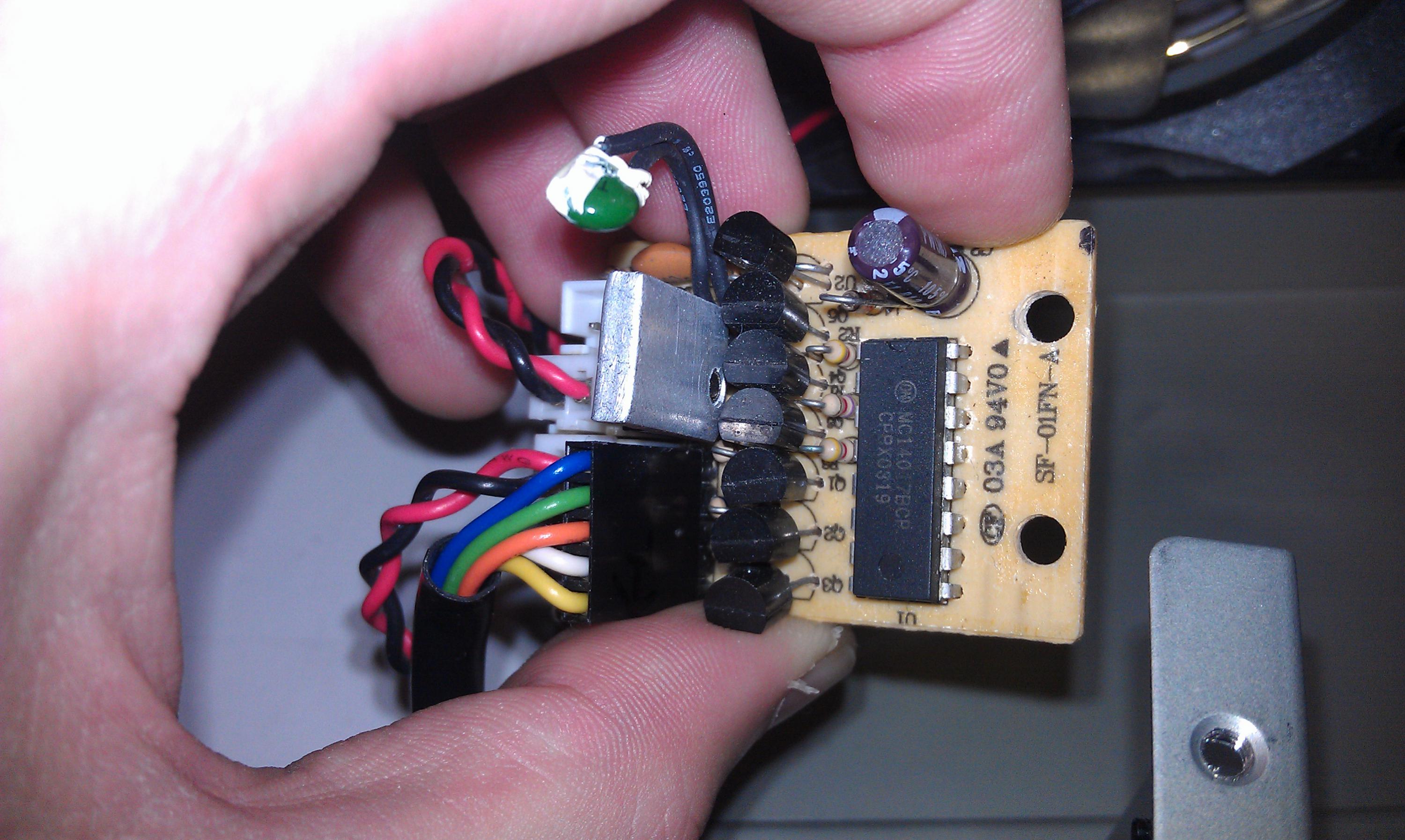

                      I found this fan controller from an old SF unit. interesting, although it has a button on the back to select "Auto, Slow, Fast" That's quite a row of BJT's.
                        Looks like the typical 4017 decade counter with decoded outputs.
                        https://cdn.badcaps-static.com/pdfs/...26b16388c2.pdf
                        I guess it is doing some sort of PWM thing, and selecting different outputs of the 4017 depending on the button on the back. Is there any sort of signal generator/timer/oscillator on there?
                            Wintech forgot to include that cap in my Ultra V-series PSU, and the fan sometimes wouldn't start when it was cold.
                            Here's another fan controller that prevents the fan voltage from going below a minimum:
