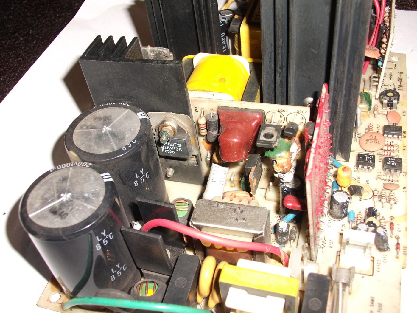

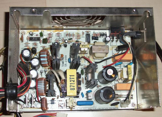

          Re: Definition of an "old-school" SMPS

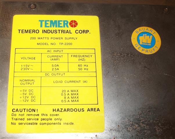

          I'd like to contribute to this nostalgia with some old PC XT units from '98 '92.
          CHUNTEX MPS-4220. Sadly it's case and cover rusted beyond restoration, so its just the guts. It's a single transistor forward, very overbuilt for 200 Watts. Looks like the fan has it's own supply circuit. It has cool Teapo caps from prehistoric times. It works.
          Temero TP-2200. Looks like half bridge to me. Has much more space then the previous one, but still decent. This one is working too.
          There is a 180W Enemax too somewhere, but it's no big deal, except the very long cables. Also, some various beefy AT units.

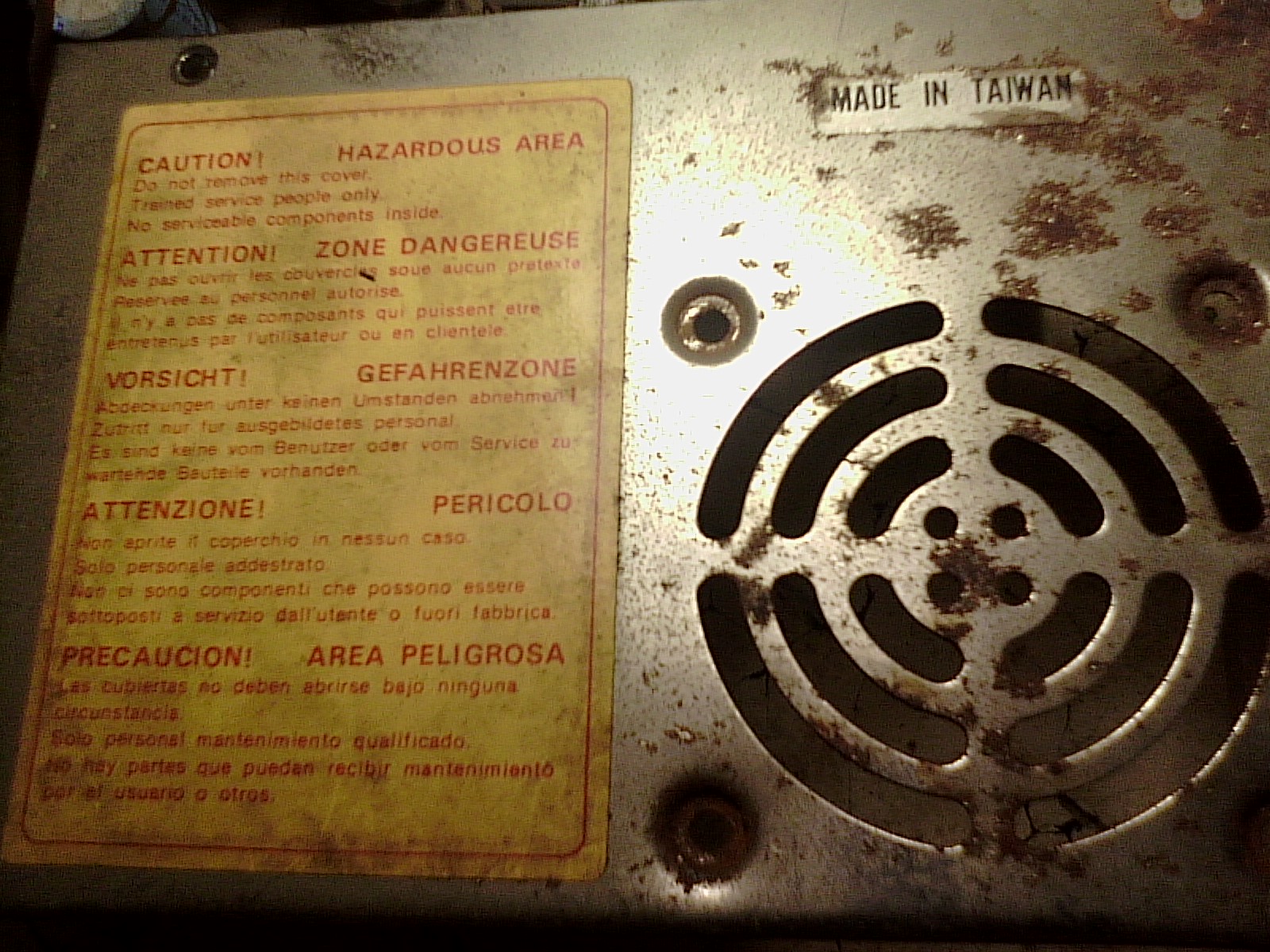

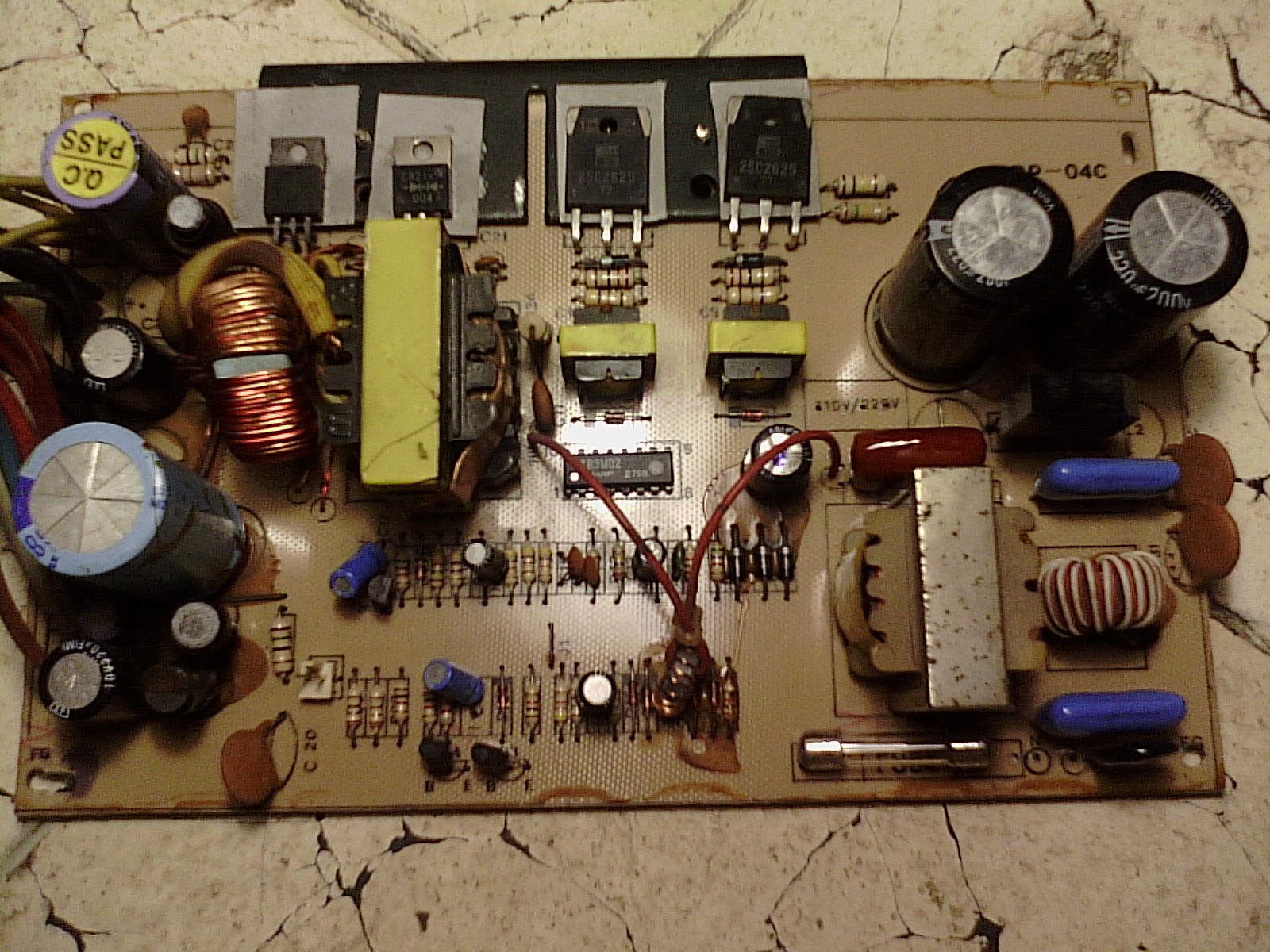

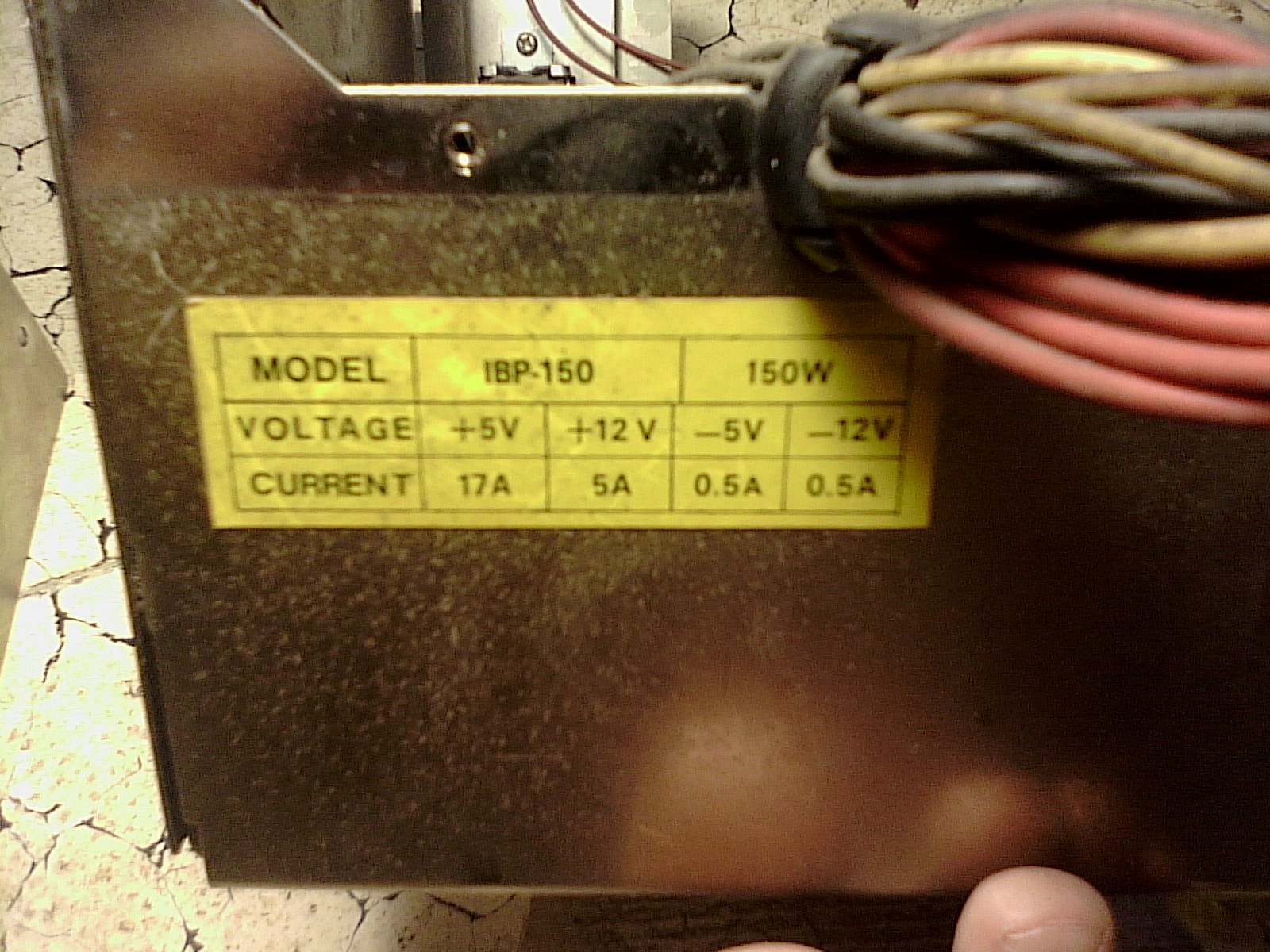

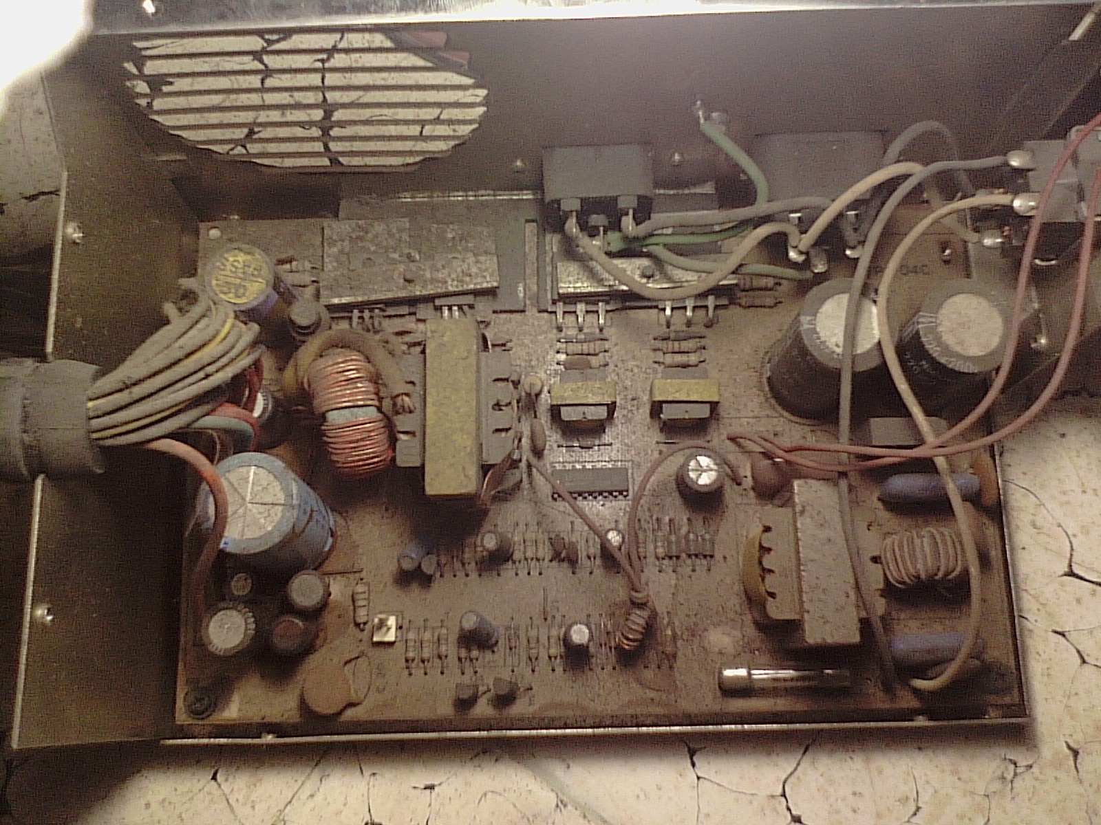

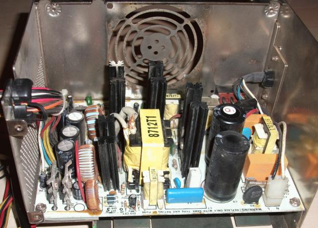

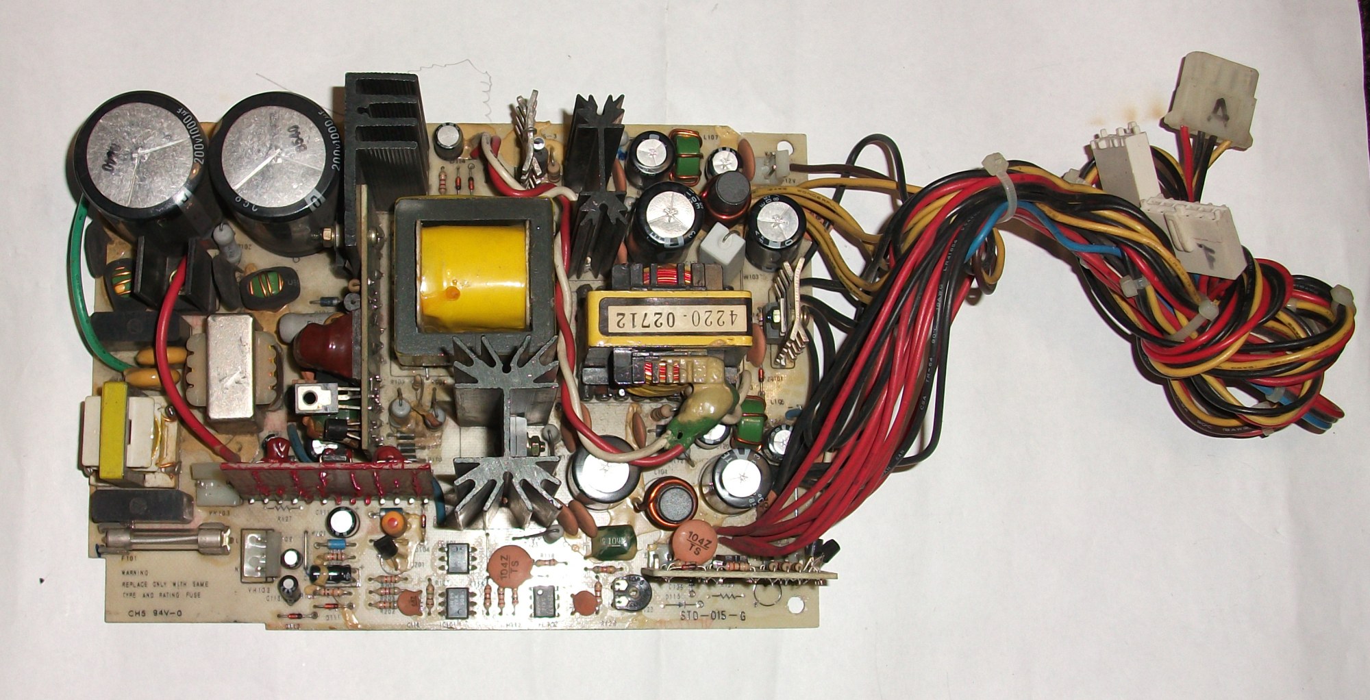

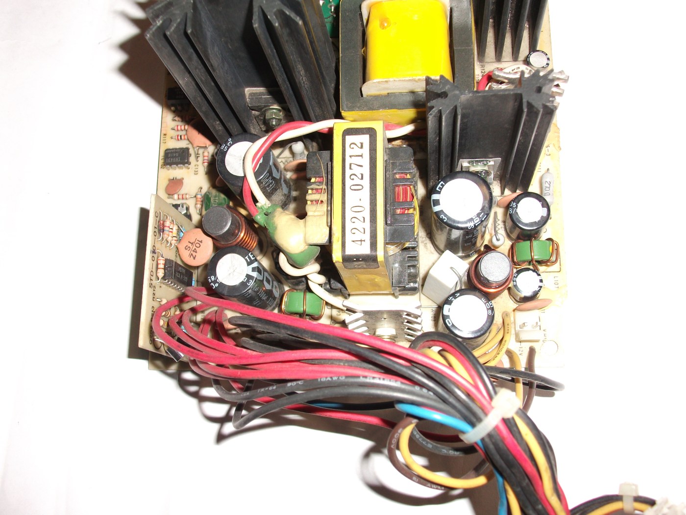

            here we go
            Ancient PC PSU found in my warehouse. I have tested it a months ago and needs a dummy load on 5V rail to fire it up. Recall it has Rubycon/Chemicon(forget) 3300uF on secondary !! Her looks nice and pretty after washing it and tested again
            Forget the chip, transistor/Fet, schottky number because i don't know what i will do with her and just lay it down near the ceiling.
            "There is no shortcut to be successful. No pain, no gain."
            Best Regards
            Rudi
            Thank You

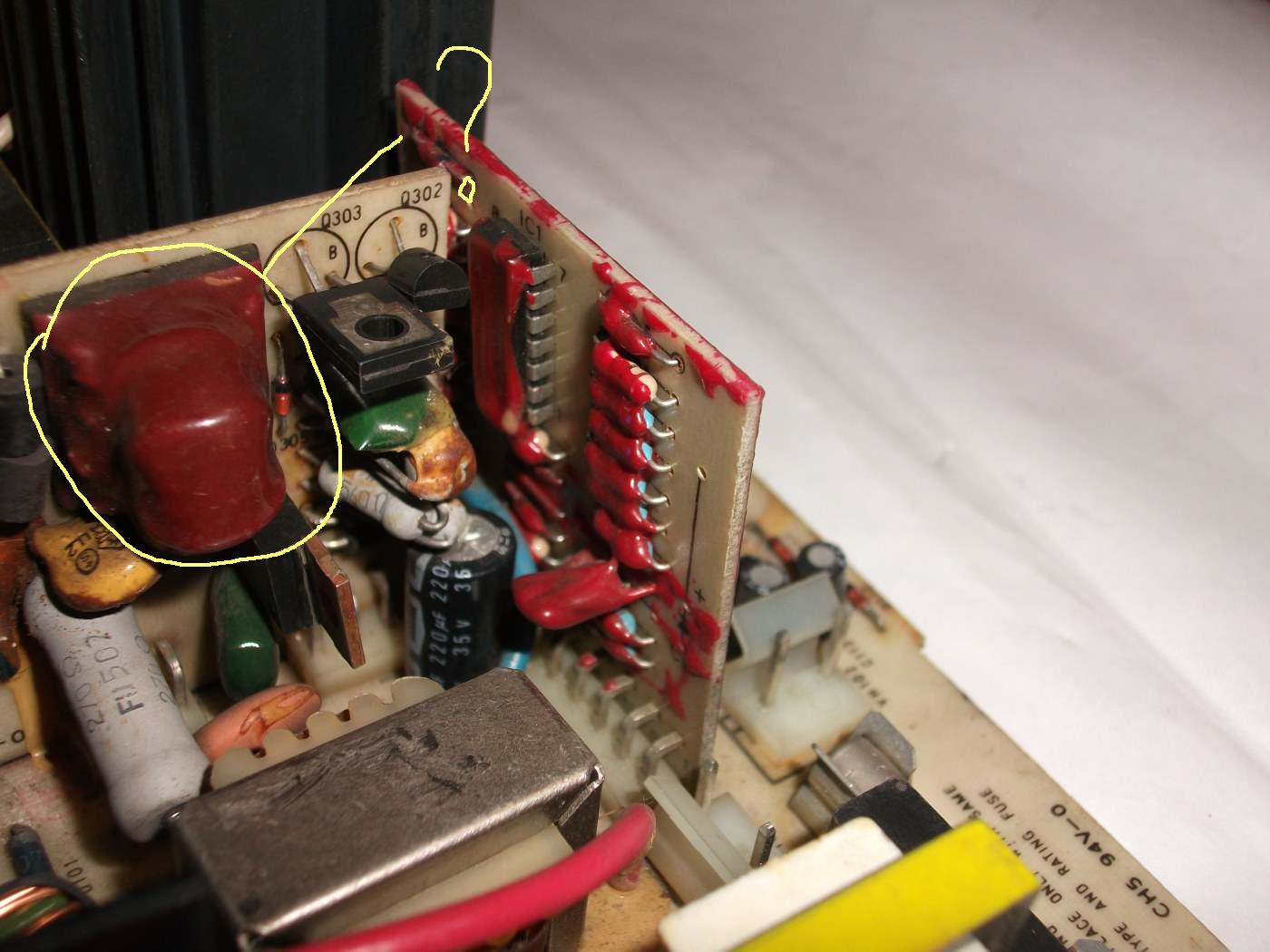

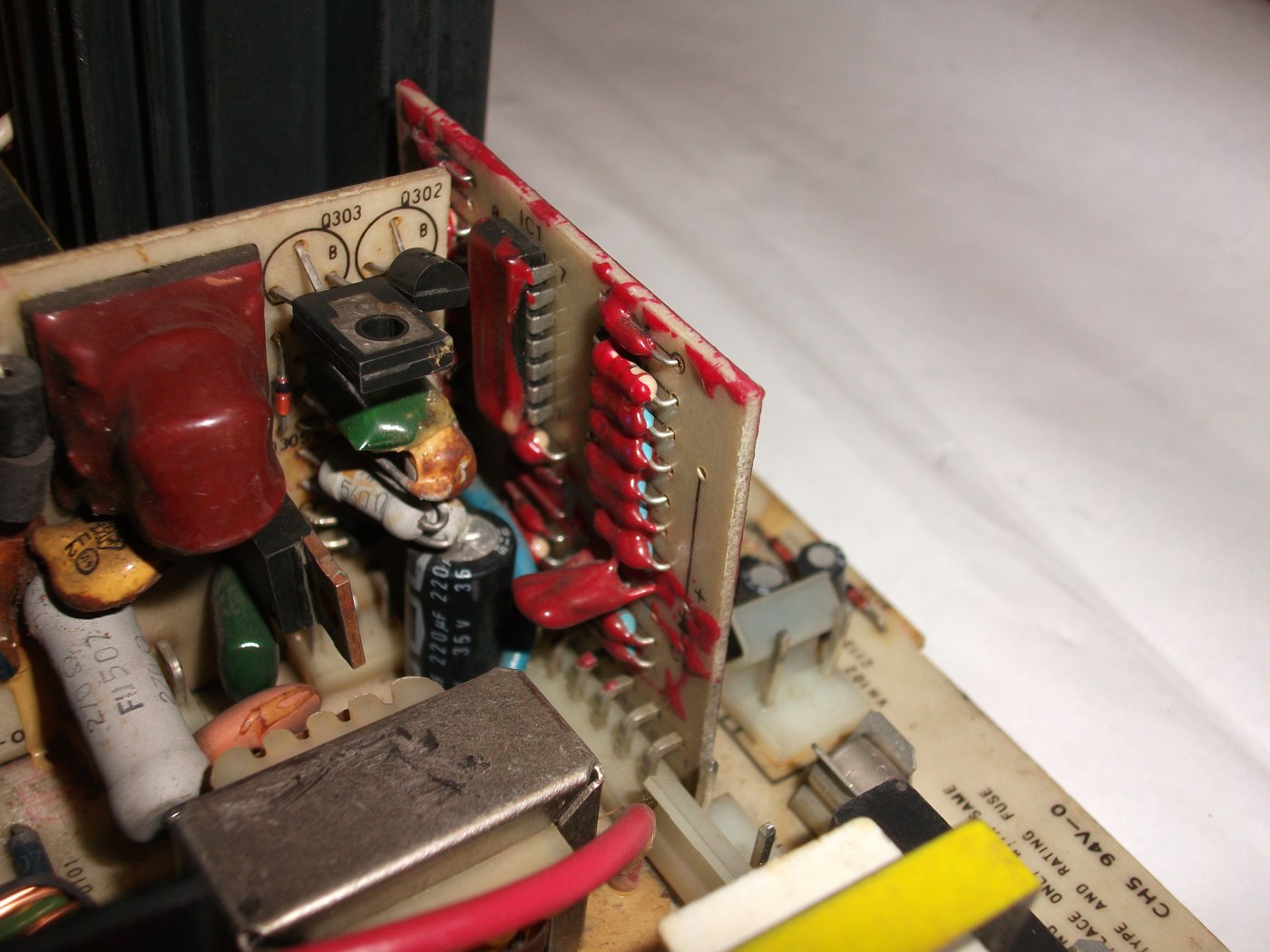

              It looks bloody on the 1st pict, what is that has red coating??
                Originally posted by senz_90
                here we go
                hey, that first picture of yours, it looks kind of unclear, wasn't there enough light or why it is so grey?
                • senz_90
                  • Aug 2013
                  • 328
                  • Indonesia
                  it is a bit dusty huh?
                  look at last picture, I have clean it and looks sexy
                    I'm sure it's some kind of insulation coating. You know, I've seen this red paint stuff method in soviet electronic equipments too. Strangely that was smeared on mostly of the ics and other silicone to prevent the "enemy" to know what it is...
                    I'm just going to take some pics of the other ancient psus I have. Maybe we'll see some more bloody guts
                    • jamesbo
                      • Aug 2011
                      • 36
                      The red "stuff" looks like Glyptal, a GE product used to fix the position on potentiometers and other adjustable controls. It was like a pigmented transformer varnish. In this case it appears to used to mask the identification of some of the components and to possibley encapsulate that coil/transformer.
                        SENZ90, the board has brown glue problem also.
