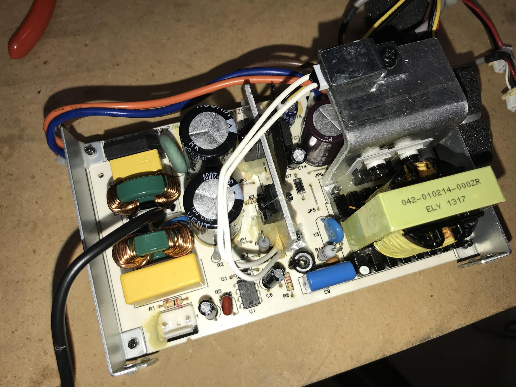

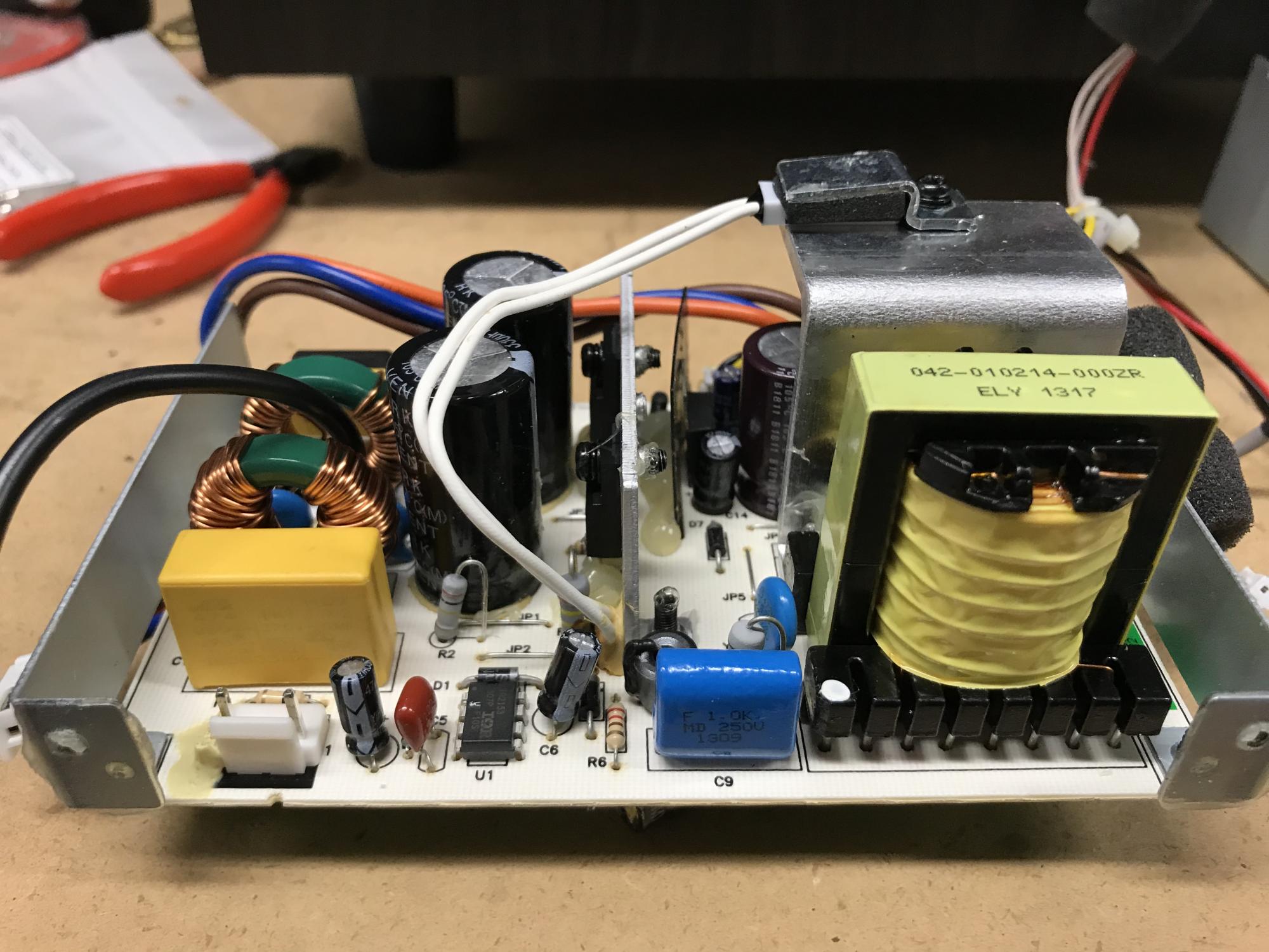

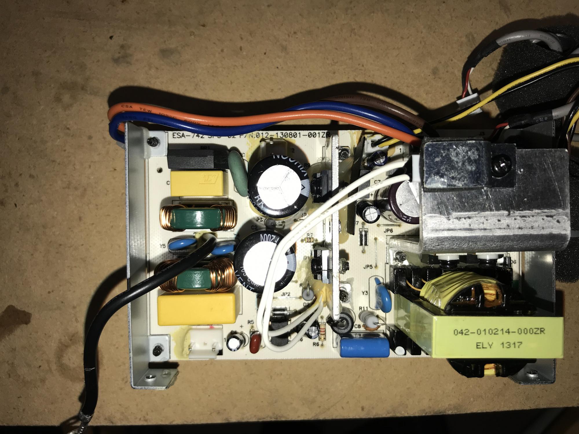

    I need help in finding a schematic or otherwise identifying the electrical characteristics of a transformer in a SMPS having the following marking:
    042-010214-000ZR
    ELY 1317
    A photo of the transformer is attached. In particular, this is a PCB mounted transformer and I need the pinout.
    I've tried Google searches of various portions of the part number with no luck, however managed to find posts with photos of this transformer having the same markings, except for the numbers following the “ELY” which leads me to believe they must be date code info and not relevant to my search.
    Appreciate any help from the community on this one.
    Re: Velodyne SMPS, power transformer

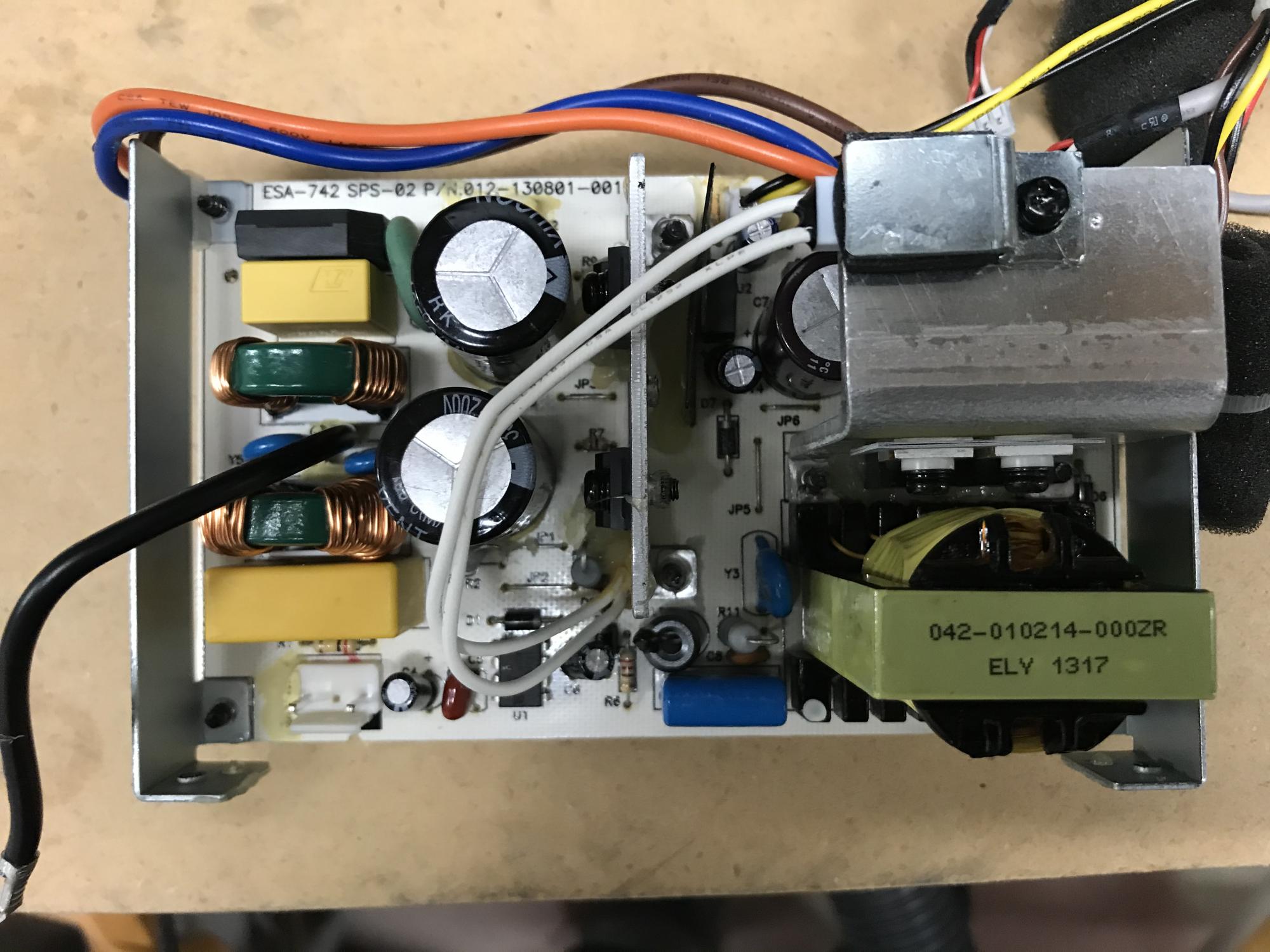

    Why do you suspect that the power transformer is bad?
    Show us good clear straight shot pictures of the whole top and bottom side of the board then we may be able to trace out the circuits.
      Thank you...appreciate the quick reply. I don't suspect the transformer is bad, but trying to recreate enough of schematic to help with trouble shooting the PS. Coming up empty on the transformer is making that difficult.
      Thanks again...will be back shortly with pics of top and bottom of board.

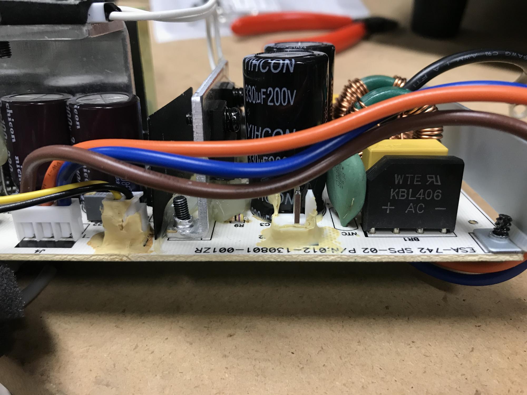

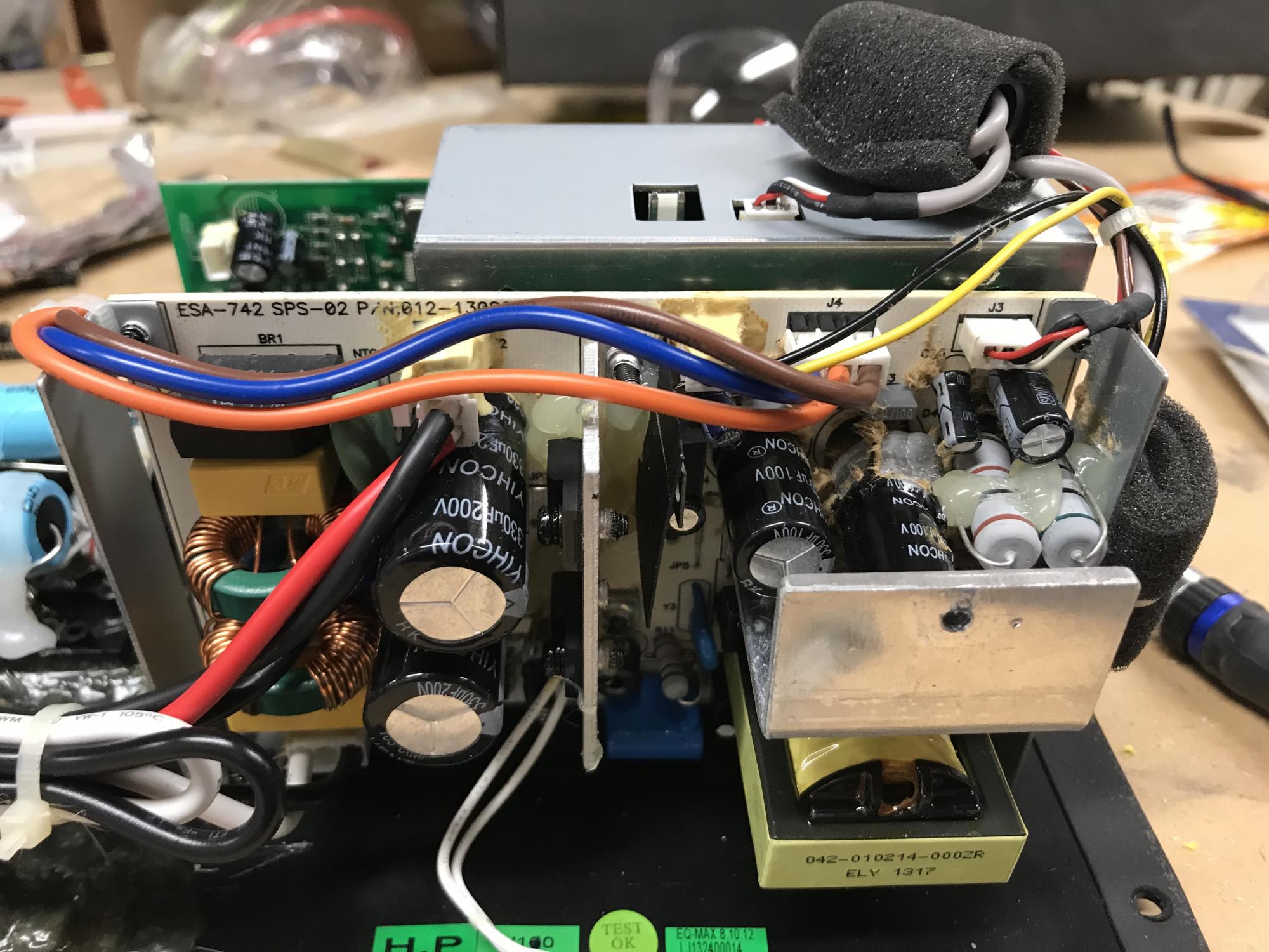

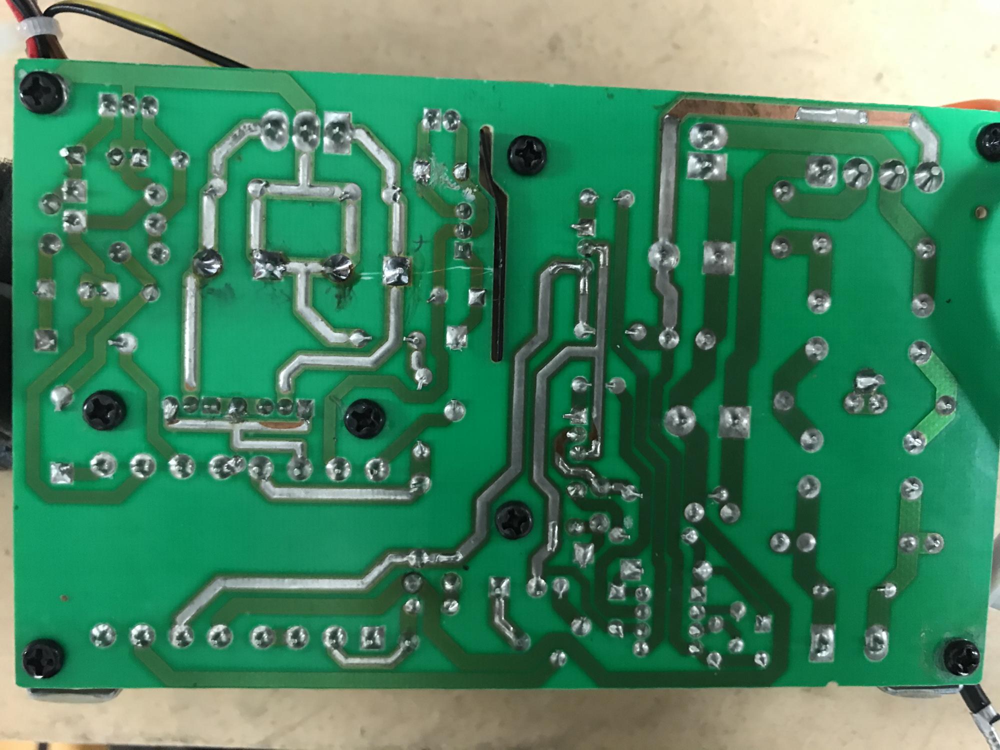

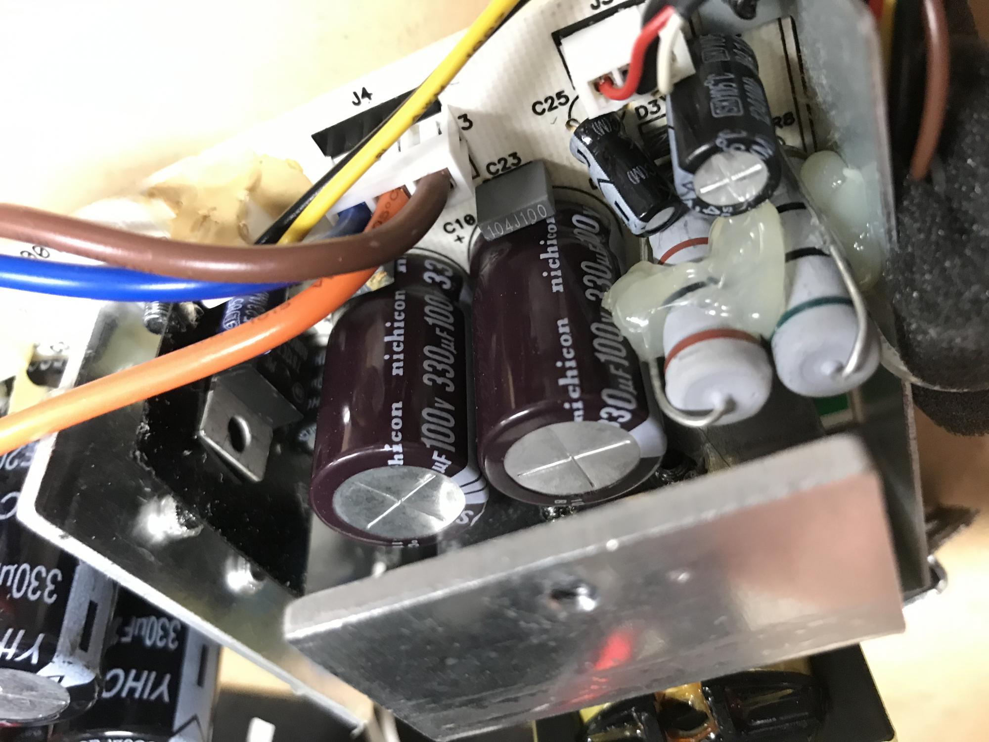

        Just upload more photos of top and bottom of board. One of the big caps (C10) was completely blown has been replaced along with it’s twin next door. See photo of C10 after having been replaced...powering the board still causes main 3A slow blow fuse to open.
        What do you see looking a the underside traces? There are what looks to be some bare spots showing copper runs in some key areas as well as a few spots that look to have been hand worked to add more solder (not by me).

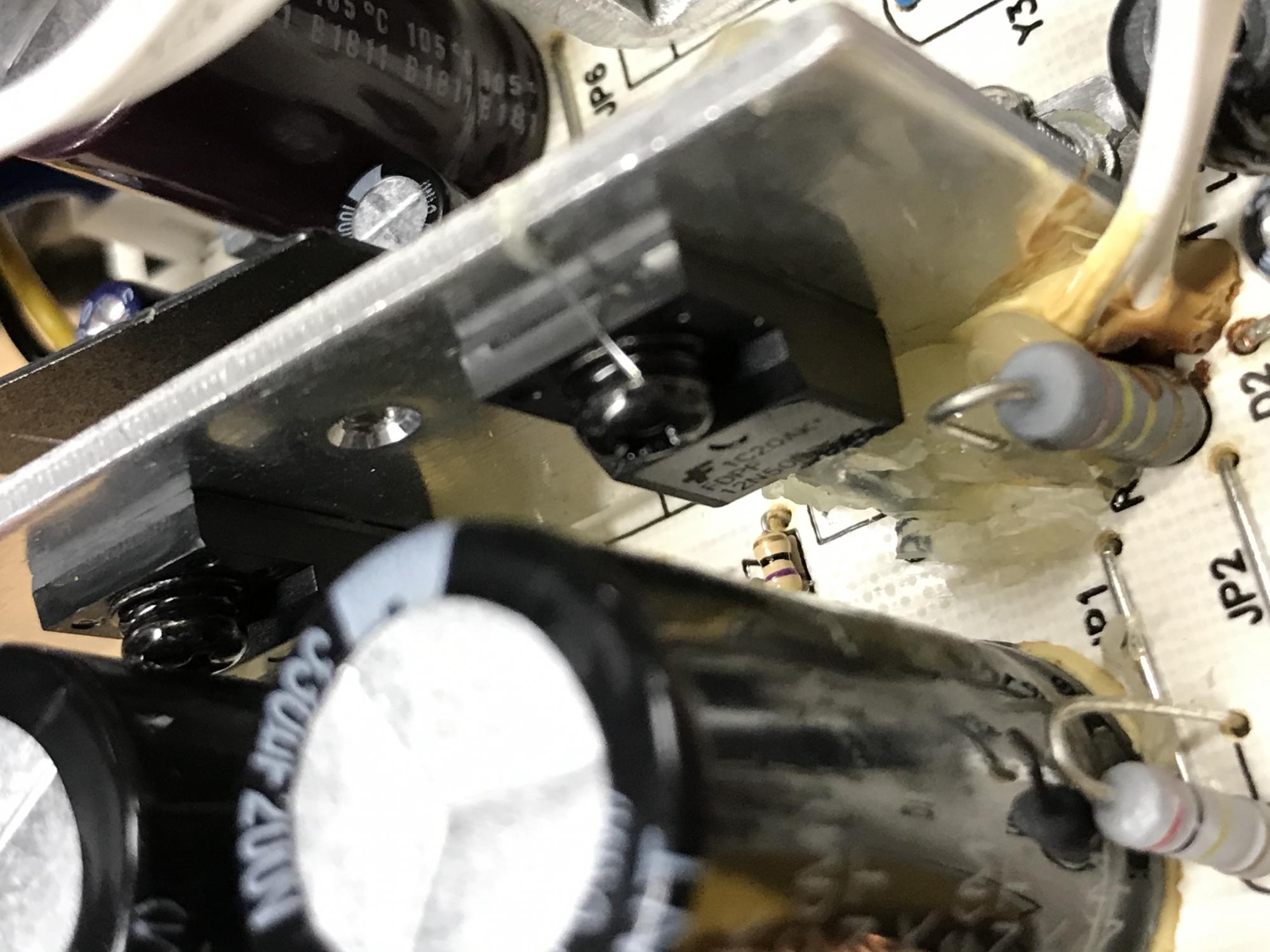

          Check the resistance of the two power device (MOFET) on the heatsink in the hot side, also get the P/N as printed on the them.
          Also check the bridge rectifier in the hot side.
            FET (Q2) has 0.5ohm between G and S and same between G and D. It has 0.3 ohm between D and S...guess that's considered a short?
            FET (Q1) has 1.3ohm between G and S and same between G and D. It also has 0.3 ohm between D and S...guess that's considered a short too?
            The part number of Q1 and Q2 are both FPD12N50.
            Bridge rectifier (BR1) has 0.54V across each of the 4 diodes using multimeter set to test diodes..part number KBL406. I'm thinking this part is OK, no?
            Last edited by PlayerOne; 03-31-2020, 08:18 PM. Reason: Added photo showing Q1 is FET on bottom
                  Shorted MOSFET's at this point which causing main AC fuse to blow. You need to also check other component connected to the MOSFET to see if any of them are also damaged or not.
