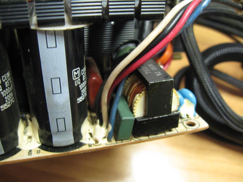

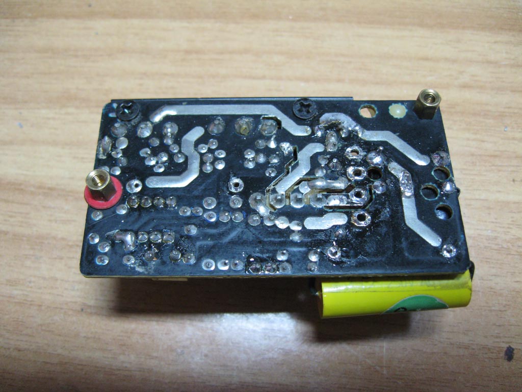

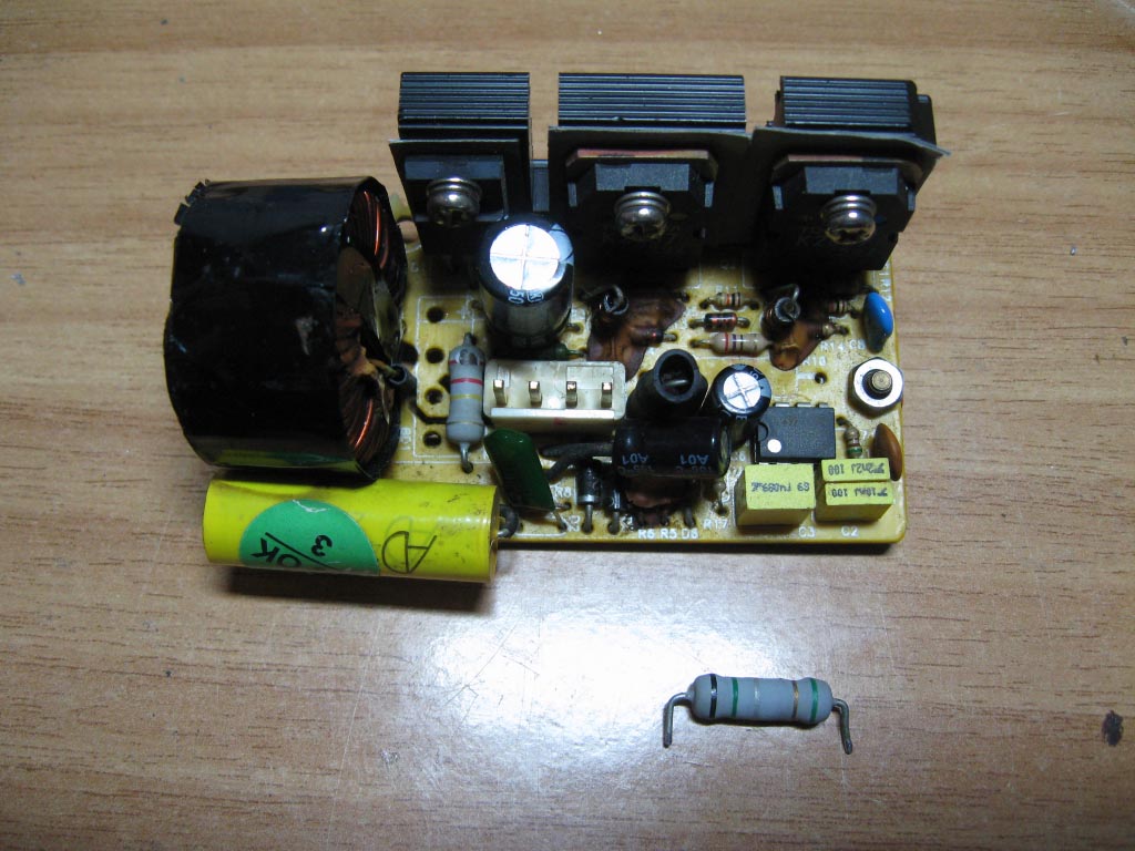

    I have this PSU which has been recapped few years ago and has endless running hours on its solders since it was bought.
    Something shorted one day and fuse was blown so it has been on the shelve for a year now. Just for exercise, cause i assumed it would be something simple, i am trying to repair it now. First of all do you think it has some juice left?
    And now to the main problem.

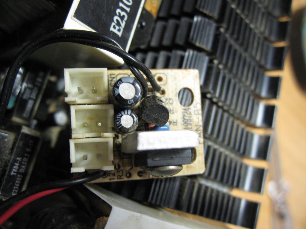

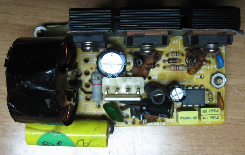

    There is a small pcb, which i think is the APFC, that measures between the +- of
    the rectifier 0 resistance. I found that a big resistor (it looks like one) with strange color code that seems to be the problem (measures 0 resistance). With that removed there doesn't seem to be any short in the circuit.
    Any ideas?
    Your help is greatly appreciated.
    P.S. There seems to be some minor problems at the output rails but i doubt that is the cause of the blow fuse. Also the NTC thermistor has a small part missing but seem to work.

    Re: TAGAN TG530-U15 fuse blow possible pfc cause

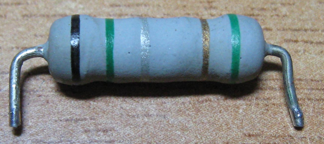

    Read the color code from left to right.
      Thanks for the quick reply.

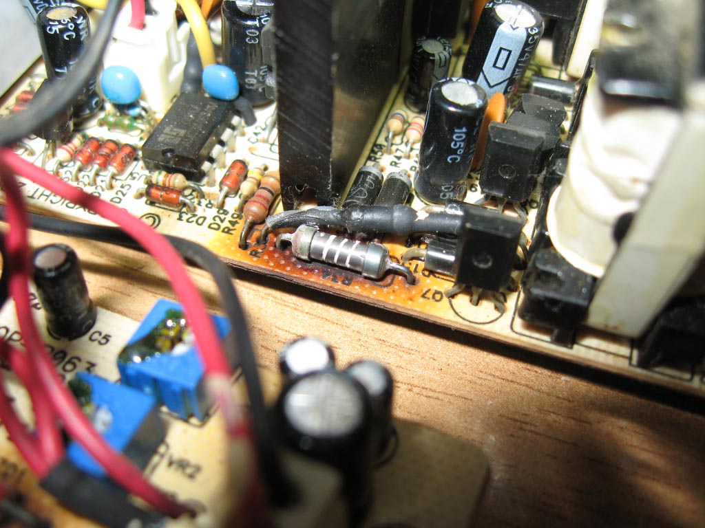

      If i read the color from left to right it gives me 0.05 ohm (although i can't find a 5 band resistor with all color codes of this one) which, if that is correct, will not be the short problem as this resistor is almost of 0 resistance....
      P.S. Eyxaristw!
        One thing for sure, you must remove all those brown glue, they are corrosive and conductive. That resistor is less than one Ohm (Brown, Green, silver etc). How is that resistor connected in the circuit, it can be the MOSFET Source resistor or fusible resistor.
          The resistor really looks like black, green, silver etc. Indeed one end of the resistor is connected to MOSFET source and + of rectifier and the other seem to go to - of rectifier. In previous post there is the bottom of the pcb if that is of any help.
            As long as the resistor is not open, it will be OK. So the MOSFET's do not tested out as shorted?

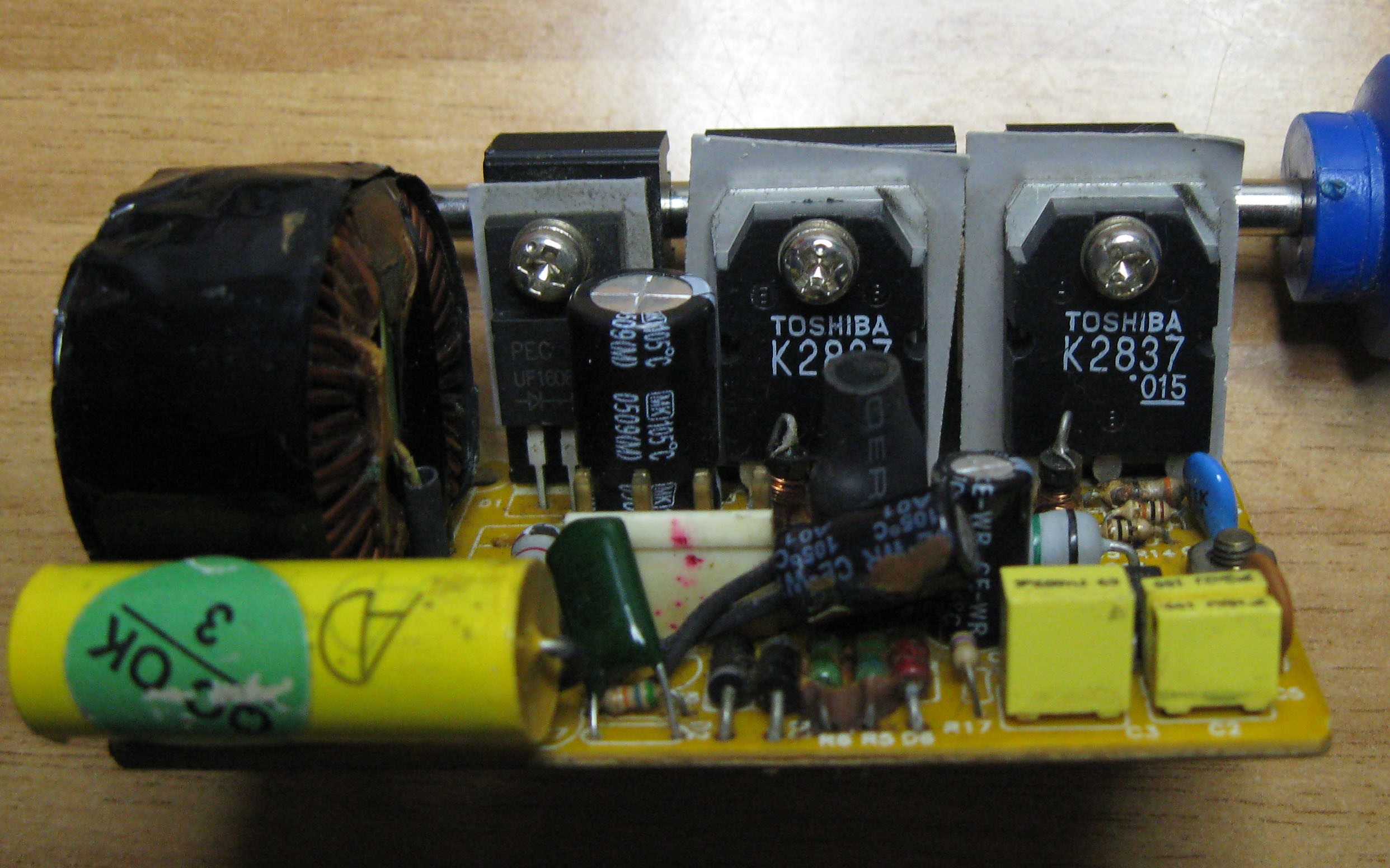

              Sorry for the novice question but can they be tested on board?
              Gate to drain gives me 170 ohm resistance and drain to source almost 0.
              If i read the datasheet correctly do they need 30v to trigger the gate and test their functionality (toshiba k2837)?
              Thanks a lot!
                Most common failure mode for the MOSFET is the shorts between Source and Drain, if it show 0 Ohm on S & D when tested on board, then you should verify again with it off the board.
                This is the typical PFC circuit:
                https://cdn.badcaps-static.com/pdfs/...0c7ba8e0b1.pdf
                You should check the all the active components, The PFC IC can be damaged also when the MOSFET failed (Gate to Drain shorted).

                    Yep! One of the two MOSFETs is shorted...

                          I have two of those one 530W (stopped using it due to some kind of coil whine) same as yours and a 480W which I bought as a backup PSU. I'm going to replace a few leaked caps in both of these with Panasonic FRs as soon as I bought a goddamn iron.
                          I don't know if this would help you but your burnt resistor near the heat sink reads as green-grey-brown-gold (580 ohm?) in my 480W.

                            The burnt resistor has been there, if i remember correctly, since the time i recapped the psu and then it run for some years until the FET sorted. It may be worth to do recap on your situation.
                            Kiriakos the repair at the moment is an easy fix as i can just disable the PFC or just replace the FETs and it will get it back to life. The thing is that it has been running for many years 24/7 and there are components as the filter capacitors and other which are more expensive to replace and may fail in a sort time.

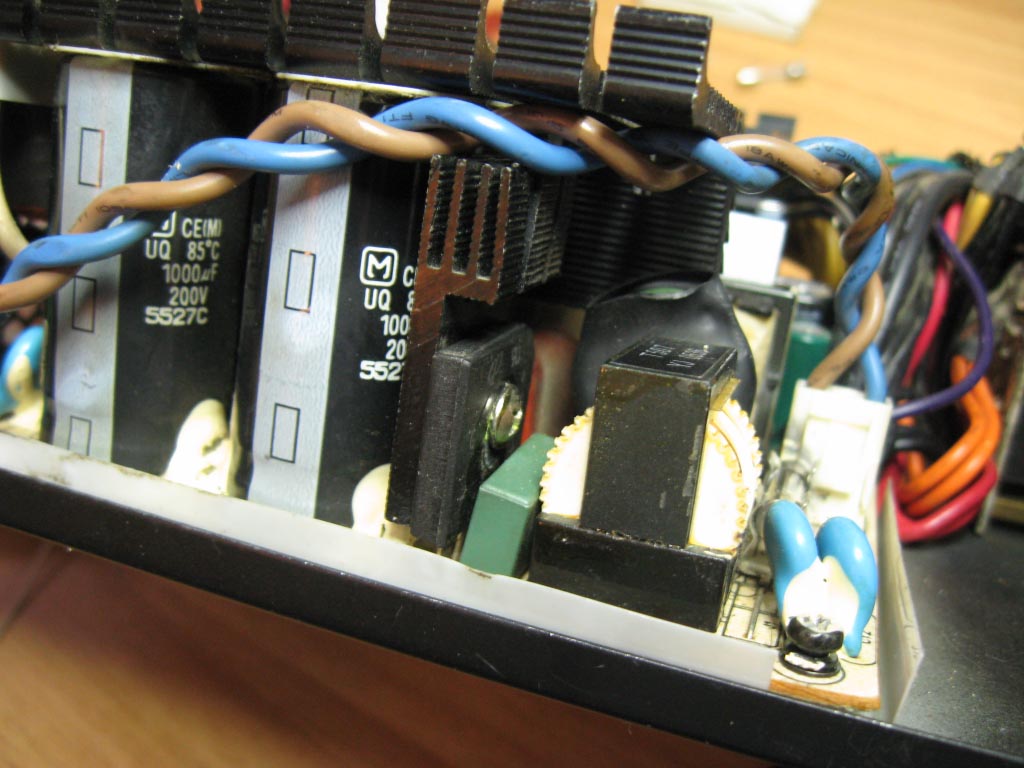

                                  I found some time to solder the rectifier bridge straight on the main pcb and the PSU is working fine now... Sweet!

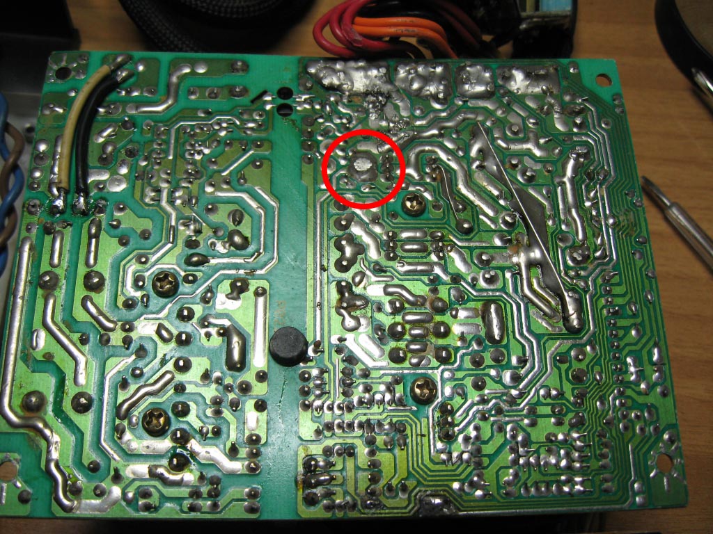

                                  under the main pcb there seem to be a point where it looks like is supposed to touch the metal case of the psu. It is in a red circle...

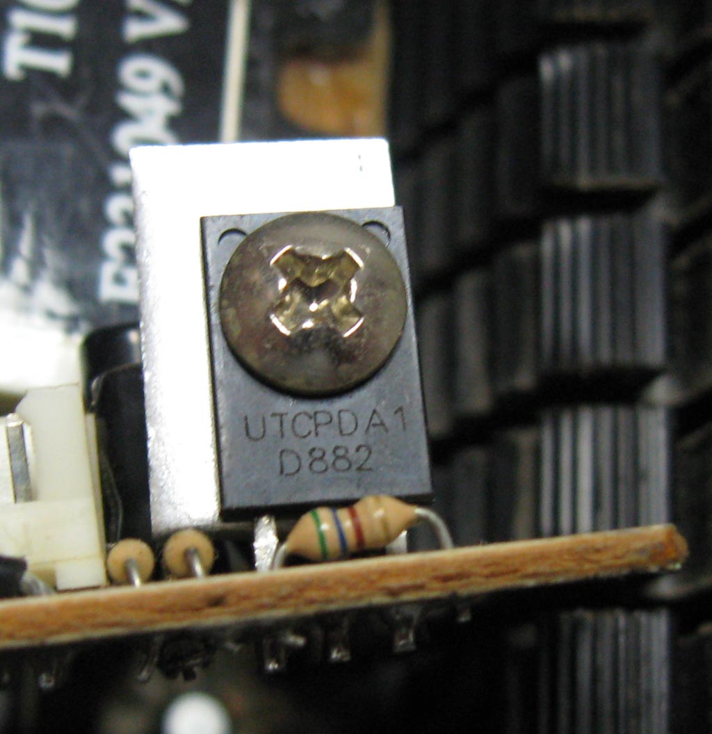

                                  The small fan control circuit has a transistor that i cannon find much about it...
                                    I received the PFC MOSFETs and replaced both (only one was shorted).
                                    Installed the PFC in the PSU and everything test fine. All voltages are ok so there doesn't seem to be any more damage, PFC ic etc.
                                    Thanks again budm!
