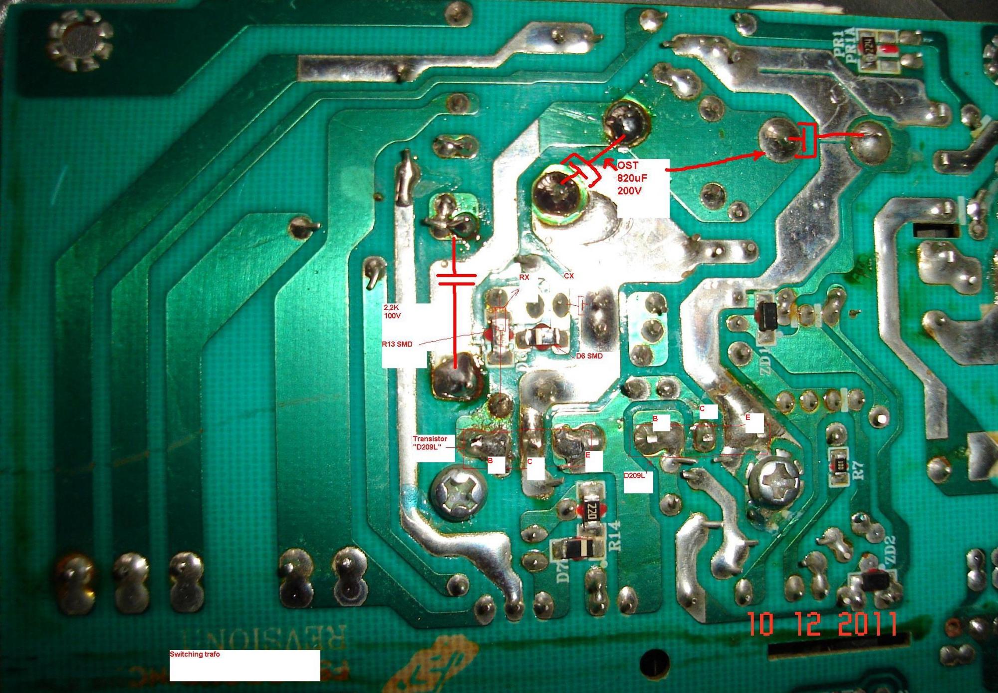

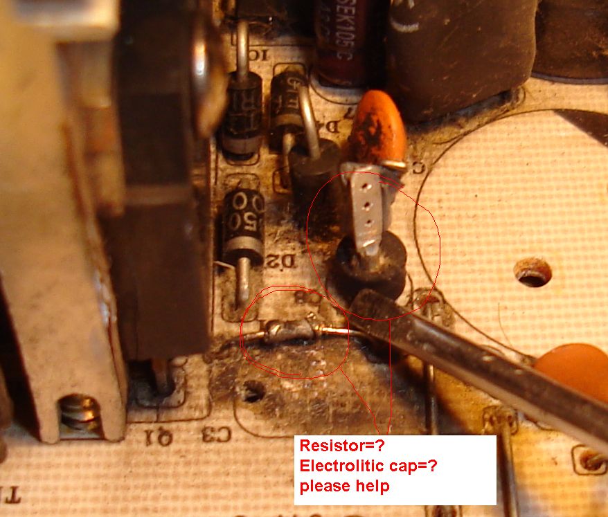

                                  • Darko442
                                    • Dec 2011
                                    • 7
                                    #37
                                    Re: Fortron FSP-ATX-400PNF
                                    hello
                                    I have problem with Fortron FSP-ATX-400PNF, blow out electrolitic capacitor and burnout resistor in HV part of PSU,and please help,I need info for this capacitor, how is rated Capacity/Voltage.
                                    • c_hegge
                                      • Sep 2009
                                      • 5219
                                      #38
                                      I don't know what value the resistor is, but the exploded capacitor is probably the same as the other small one just behind it.
                                        master hoarder
                                        • May 2008
                                        • 12175
                                        • Bulgaria
                                        #39

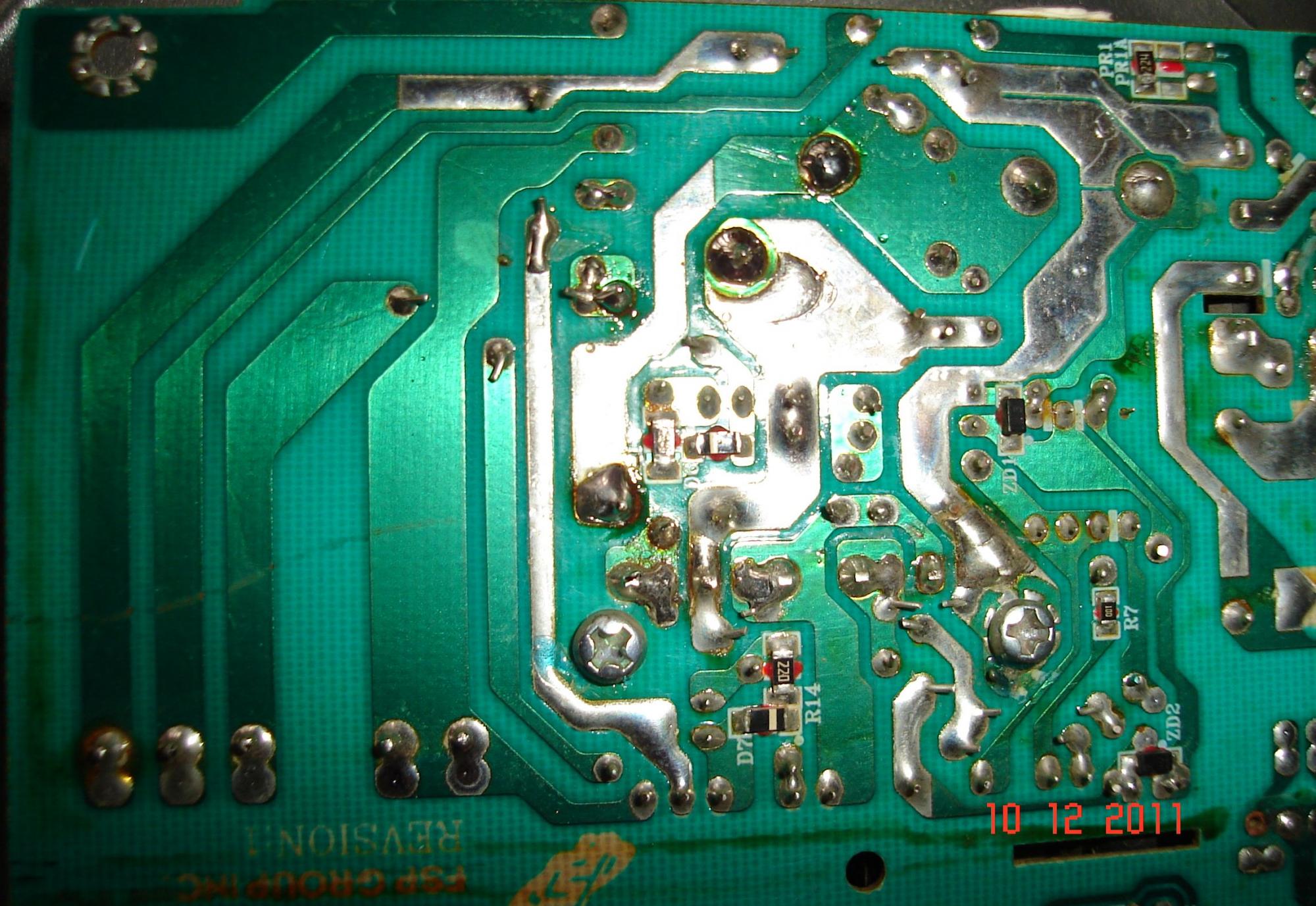

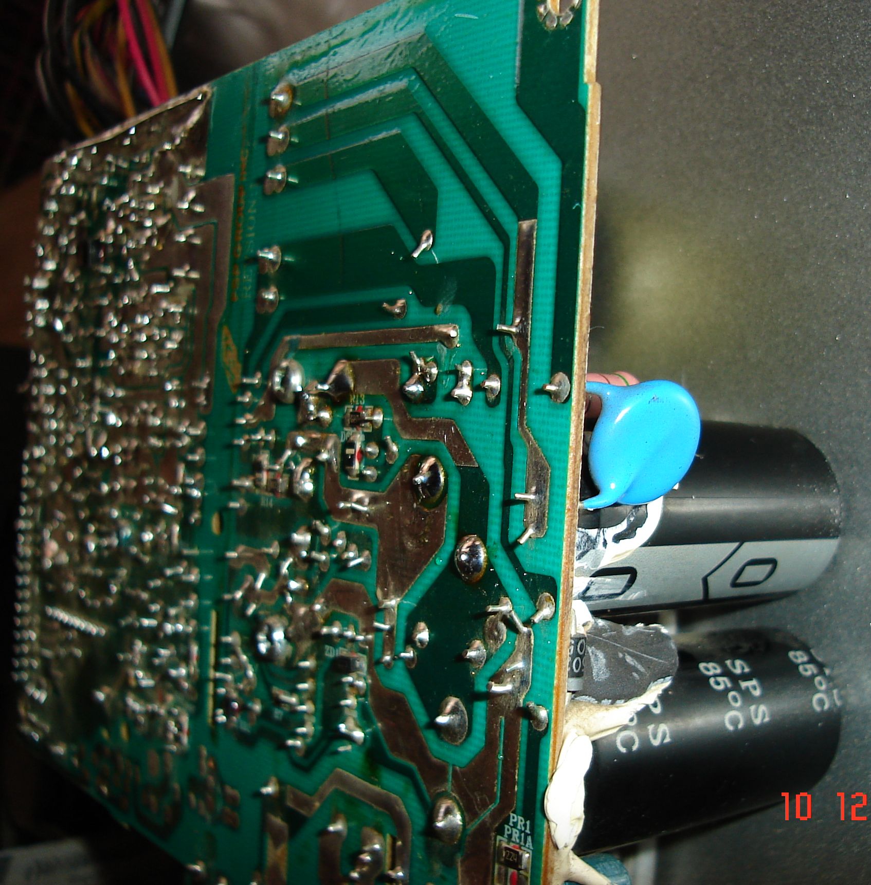

                                        If no one gets to your question in a day or two, post a picture of the underside of the PSU so that we can figure out what circuit that cap and resistor are part of.
                                        • Darko442
                                          • Dec 2011
                                          • 7
                                          #40
                                          thanks for speed help.Switching transistor is NPN "3DD209L" from China on this link is datasheet"http://www.alldatasheet.com/view.jsp?Searchword=D209L".
                                          Resistor and electrolitic capacitor is in base circuit,fuse is blow,main switch transistors is blow,rectifier is ok,main electrolitic cap(1 and 2) is ok.and this is all for now...
                                          pictures is attached
                                          Darko442
