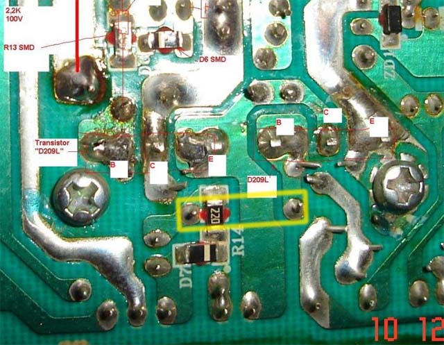

    Capacitor is solved,found rest of dead elco, 2.2uF 50 V(TEAPO),found it in PC case,what a explosion!!good idea for new year crackers...
    Resistor is for now mysteries.

      If I'm not mistaken, it looks like the burned resistor is connected to the Base of Q1. This PSU uses half-bridge design, so the circuits that drive the Bases of the two D209L transistors should be exactly the same. Start at the Base of Q2 and follow the circuit, noting the components connected to it. There should be a resistor connected in the same way as the burned resistor.
      From what I was able to trace, I think the Base-drive resistor for Q2 is on the other side of the heat sink, circled in yellow in the attached picture. The Base-drive resistor for Q1 should have the same value.
      Even if the resistor for the Base-drive of Q2 looks okay, check it with a multimeter to make sure it hasn't gone open-circuit or out of spec.
      ** EDIT **
      I looked up some pictures on Google and from what I was able to gather, the Base-drive resistor of Q2 might be R12. Check to see if the resistor I circled matches the location of R12 - if yes, then that's resistor value you should use for the burned resistor.

        Yes you are right,and R9,R12 is open,and now is time to reconsidering cost of repair or just to throw in junkbox.

          Both transistors is short-circuit betwen base and collector,IC have very big chances to be dead,and how now what else.Yes PSU is for junkbox,in Croatia is very dificult to obtain adequate parts for repair(transistors and IC).One more time
