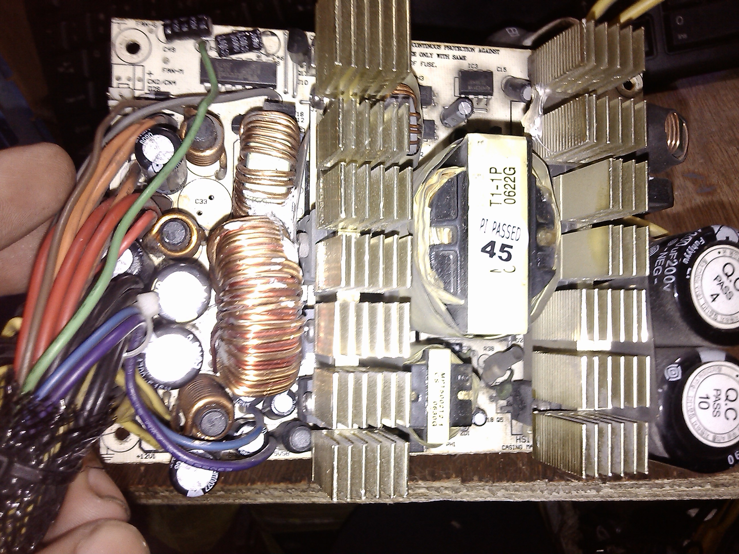

    i recently purchased some 2nd hand psu from local surplus store in our area and i cant seem to trust if these psu performs any good
    psu brand is powerstation2 ps2-450
    internal number is mtp5002
    anyone can tell me where to find any datasheet or information about this psu i tried google but i cant find good information or perhaps some experts are already familiar with this psu
    im using it now and system is stable only one thing i noticed system now runs hotter than before
    my main concerns is maybe this psu is not really 450 watts at all or its very low efficiency making high heat buildup in my computer case
    all caps are fuhjyyu? i maybe misspelled it
    sorry for some weird question i find this forum a good place to ask im afraid this psu may go BOOM and killing other parts

    Uh oh. Fuhjyuu?! Not a good sign but pictures with some model numbers of the primary and secondary silicon would be great and would give us a good idea

            here is one image i managed to upload
            • Pentium4
              CapXon Be Gone
              • Sep 2011
              • 3741
              Re: Weird PSU
              Doesn't look horrible. That could do at least 300W, maybe higher than 350W (Would need to know the specs of the silicon though) Probably isn't that efficient, even on 230V but I don't think that should be much of an issue. The biggest issue is those Fuhjyyu caps, they are extremely unreliable, and die faster with more heat. I would replace them if you can.

                the caps are really the problem for me im living in a place where the air temperature can go 37 this psu wont last longer then , the seller where i brought this psu also have 400 watt delta psu but i dont know if they could handle my system

                    Yeah use the Delta, it can handle that...It will be designed better in general, and have batter caps (Probably Ltec, maybe Taicon, hopefully not CapXon) that 3870 pulls a lot of power. I imagine the ESR in the Fuhjyyu cap on the 12V rail is already rising and it will probably bulge first. How old is it though? I think this one is worth recapping, it has a good sized transformer and nice heatsinks. Can you list some of the silicon's specs?

                      A decent 400 Watter will easily handle that PC. Chances are, that Delta will be a more modern, more efficient design, so it will probably run a little cooler than this one.
                      The part number for your PSU suggests it's a Casing Macron. The design looks capable of 450W, but it will depend on the silicon. I would definitely recap it, though, and stick a 2200uF cap in that blank spot.

                        who desoldered c33?
                        +3.3 will be noisey without it.
                        just replace all the fuhkkyu caps before using it.i would assume that c33 would be a 2200@6.3.maybe a 3300

                          That "mystery" P/S looks decent, other than the cap brands. Nice heavy metal (the heatsinks), the O/P transformer looks substantial, too. If that 8-pin DIP IC is the PWM, it's probably of the UC384X family, which is good. I could believe that capable of 350W-450W, but definitely get good caps in there, including the I/P lytics (and get 105C parts there, if possible). If you can match the impedances of the O/P caps using Nichicon PW or PA series parts, UCC LXZ series or Panasonic FC, that would be slightly preferable to Nichicon HE, UCC KZE, Panasonic FM or Rubycon ZL, given your warm climate. But if PW, PA, FC or LXZ have too high of impedances, then HE, KZE, FM or ZL are pretty robust.

                            i removed c33 to take a closer since its different with the other caps same brand but with different label color (blue) , also the capacitor in 5v rail is also different its OST i guess this psu have previous capacitor failure in 5v and 3.3 v rails and been replaced. im using the psu right now and its working fine tested played heavy game (metro LL) for almost 3 hours and only a very little drop in 12v rail 11.988 to 11.877 my only concern right now is those caps that are replaced if they are in correct specs. also i really dont know where to find good caps in my area

                              OST is better than Fuhjyyu, but they still aren't good. If they were all OST I'd feel a little better. But I still think Japanese capacitors are necessary for reliability in that heat

                                The bad thing about OST is that they go bad without bulging up. Does look like a good PSU, can you post a pic of the soldering side? I would like to see the soldering quality.
