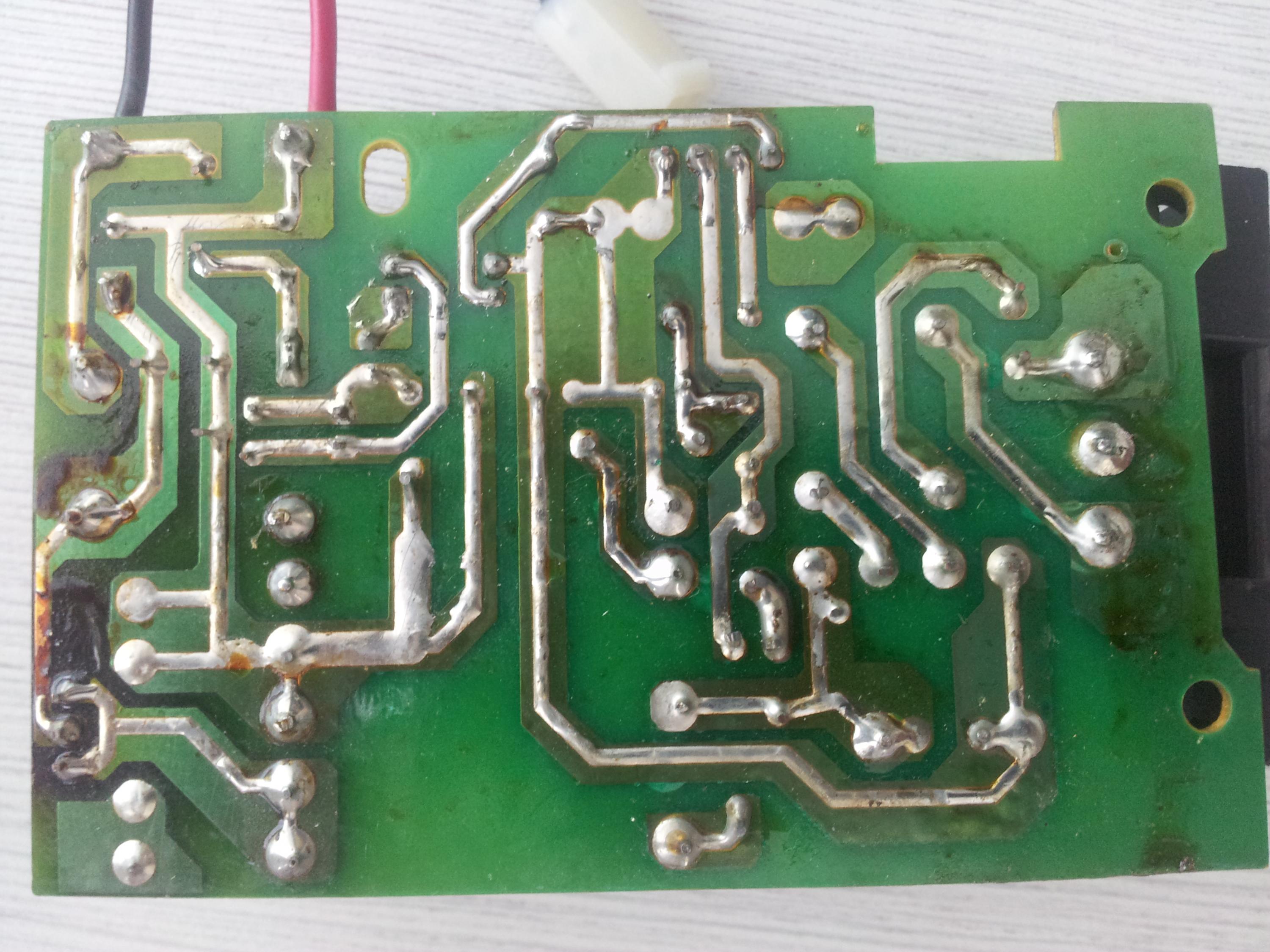

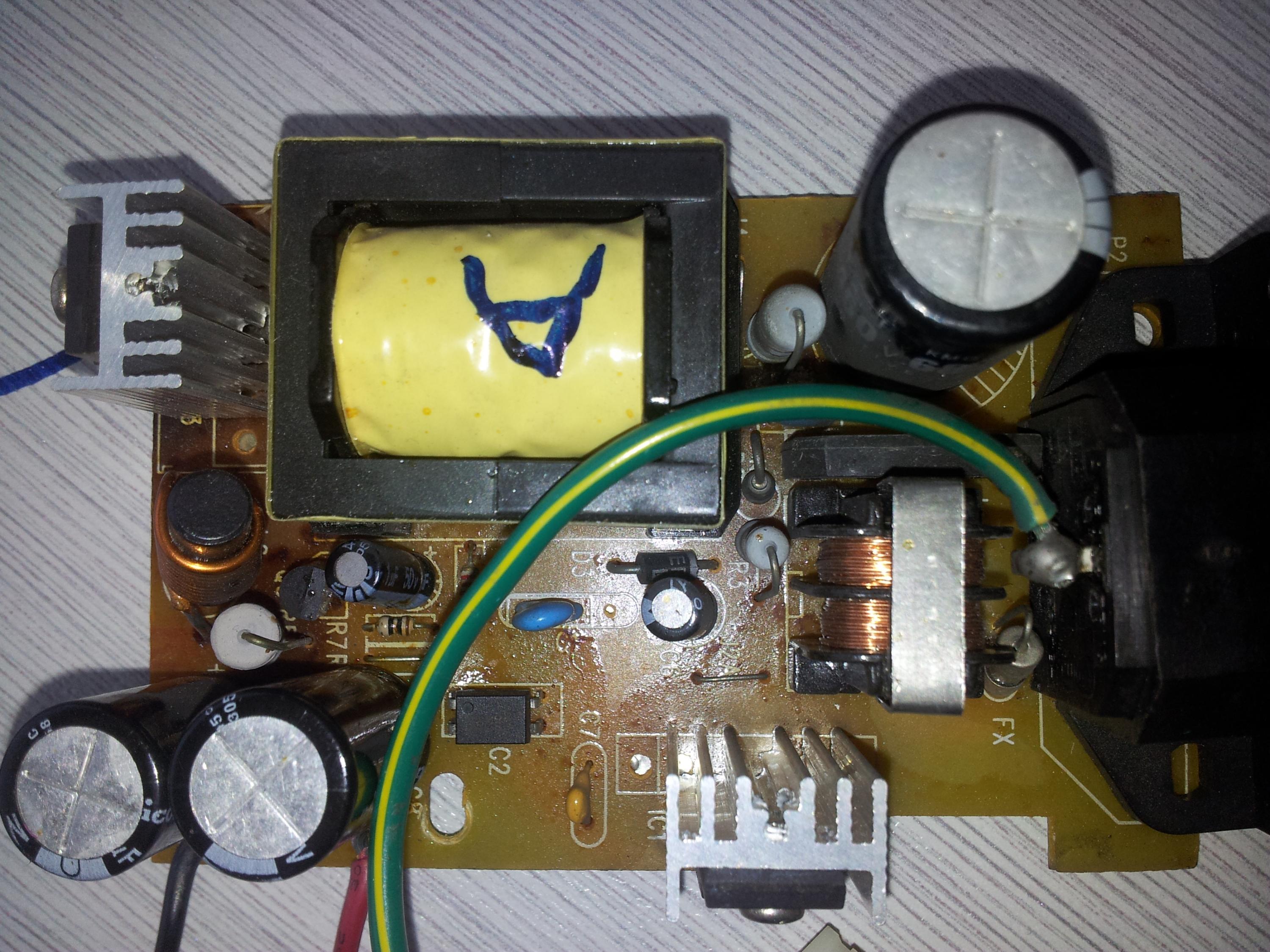

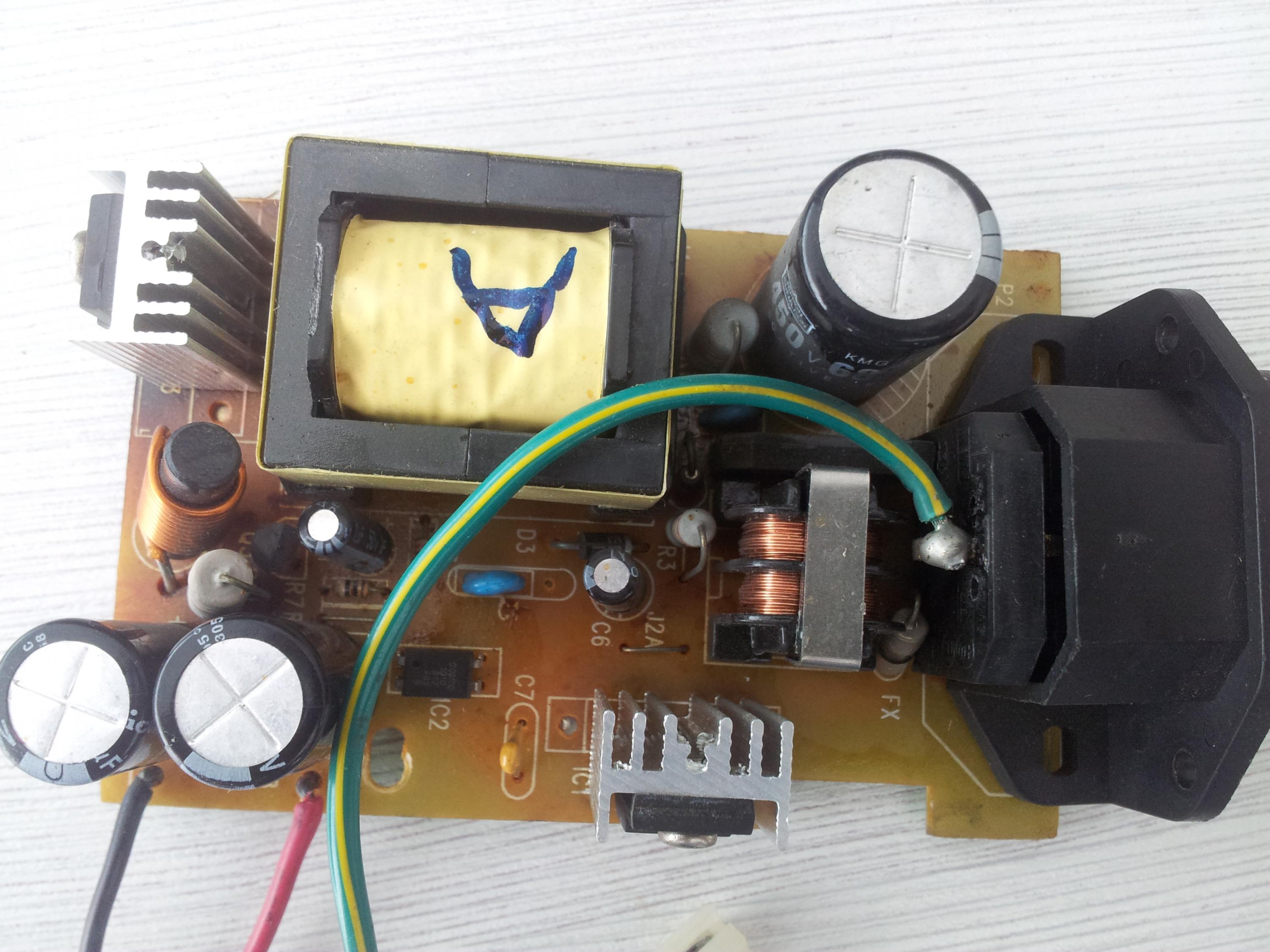

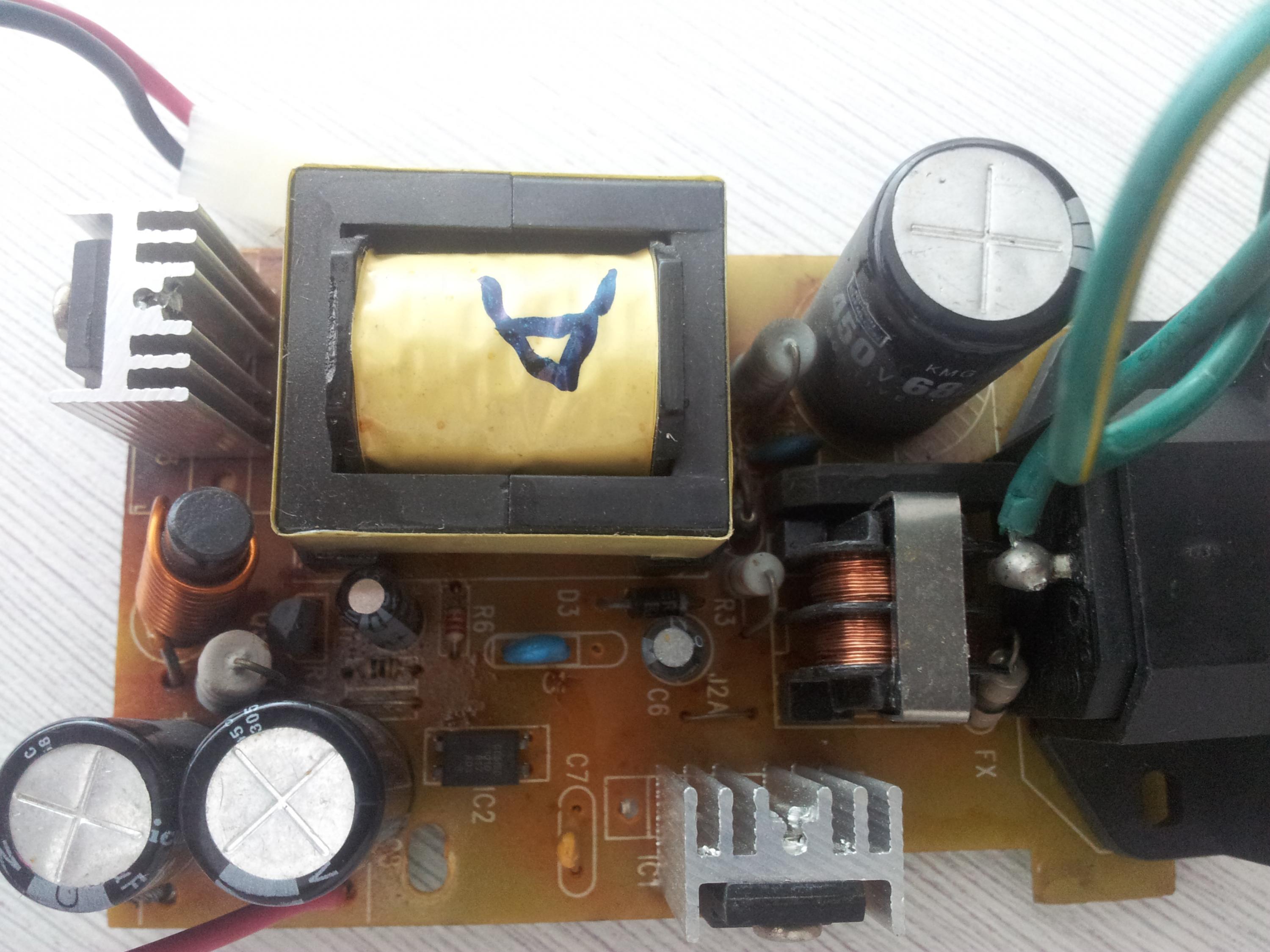

    PSU dead see attached pictures tell my what was the out put DC volt of the circuit
    help me to repair this or alternative PSU rating DC?? Amps??

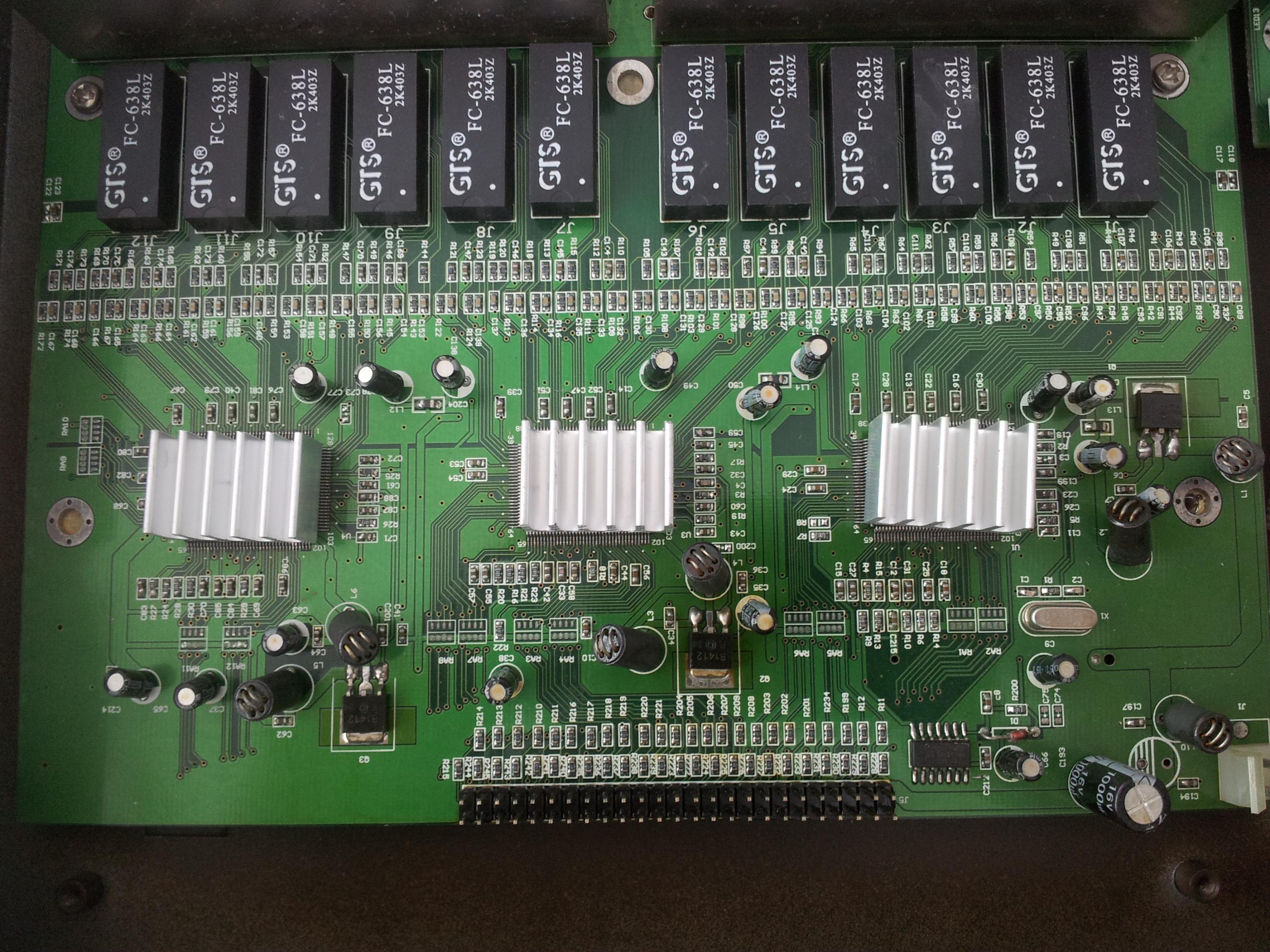

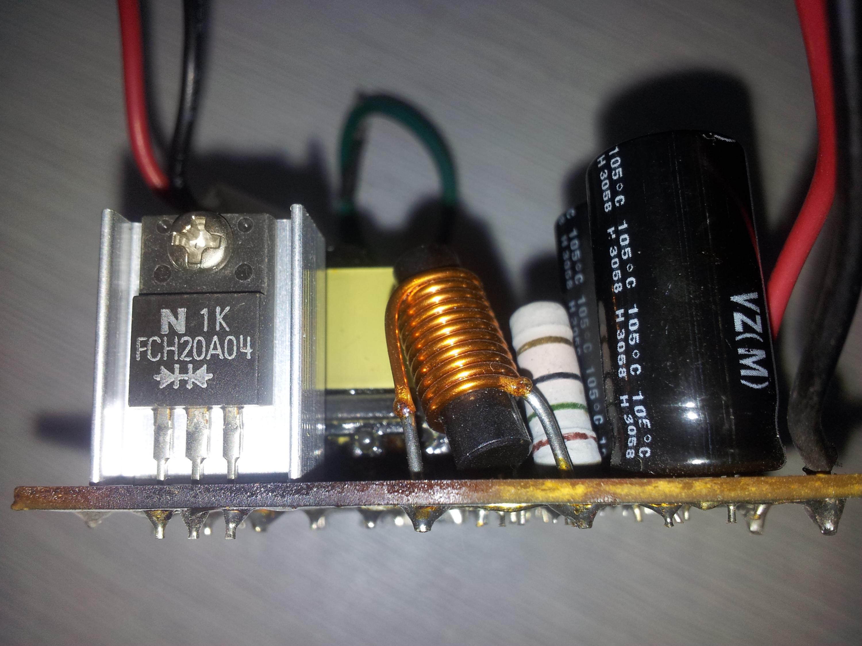

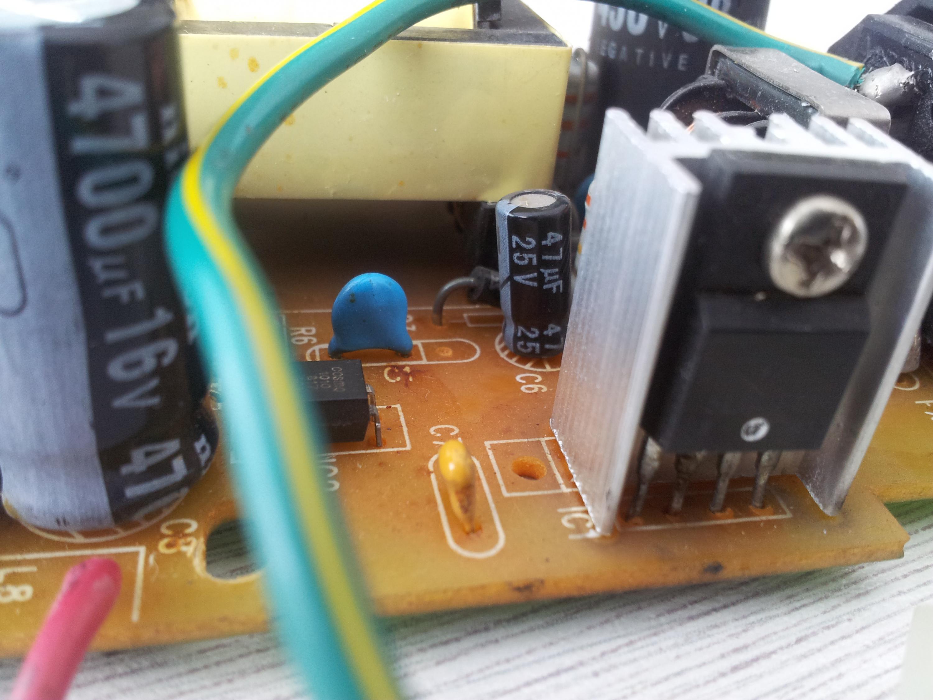

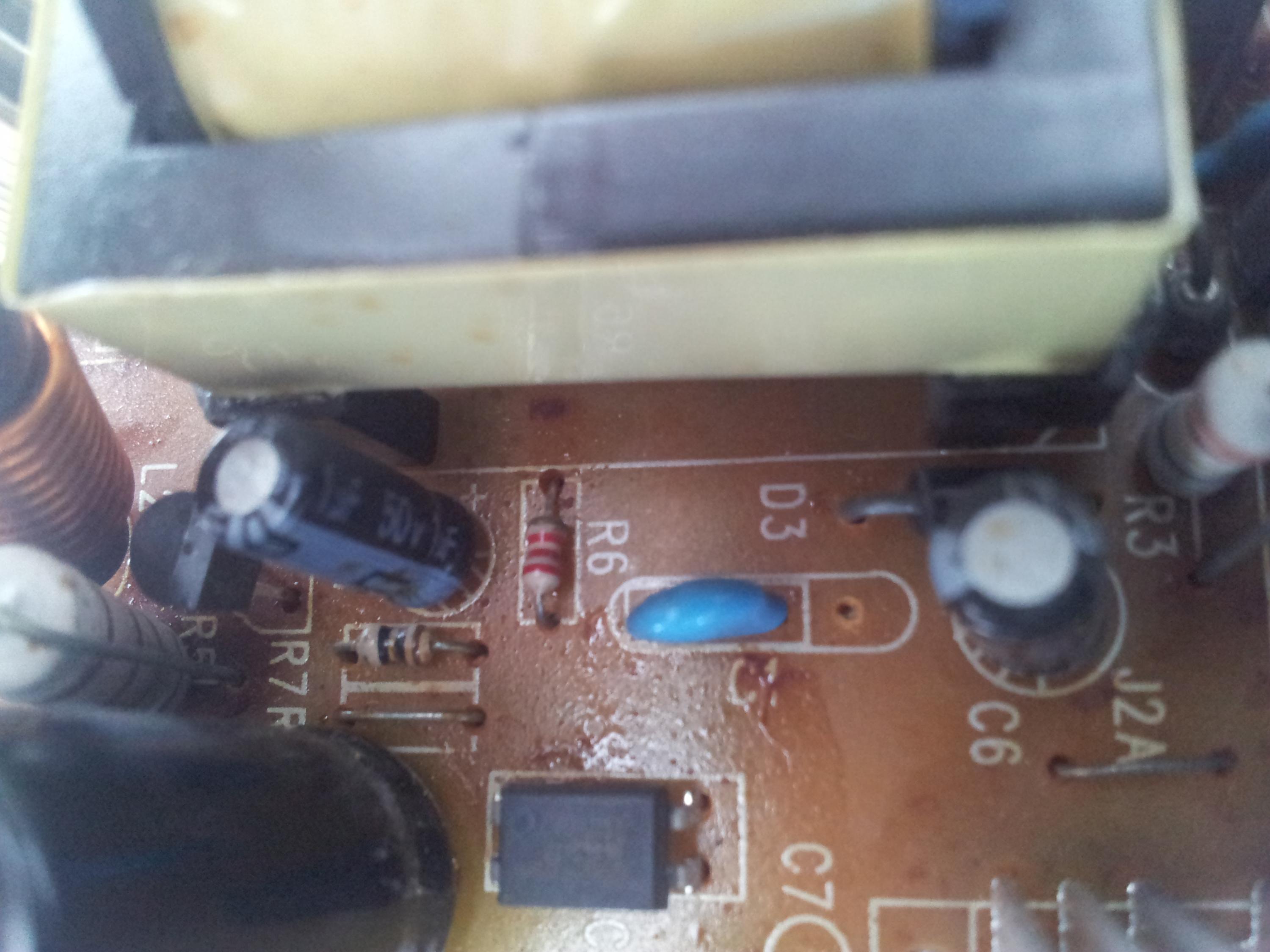

    There are models of that switch with 5.0V - 2.5A psus, and 3.3V 2.5A psus. Please, take a photo of the psu from above, also a good photo of the board of the switch.

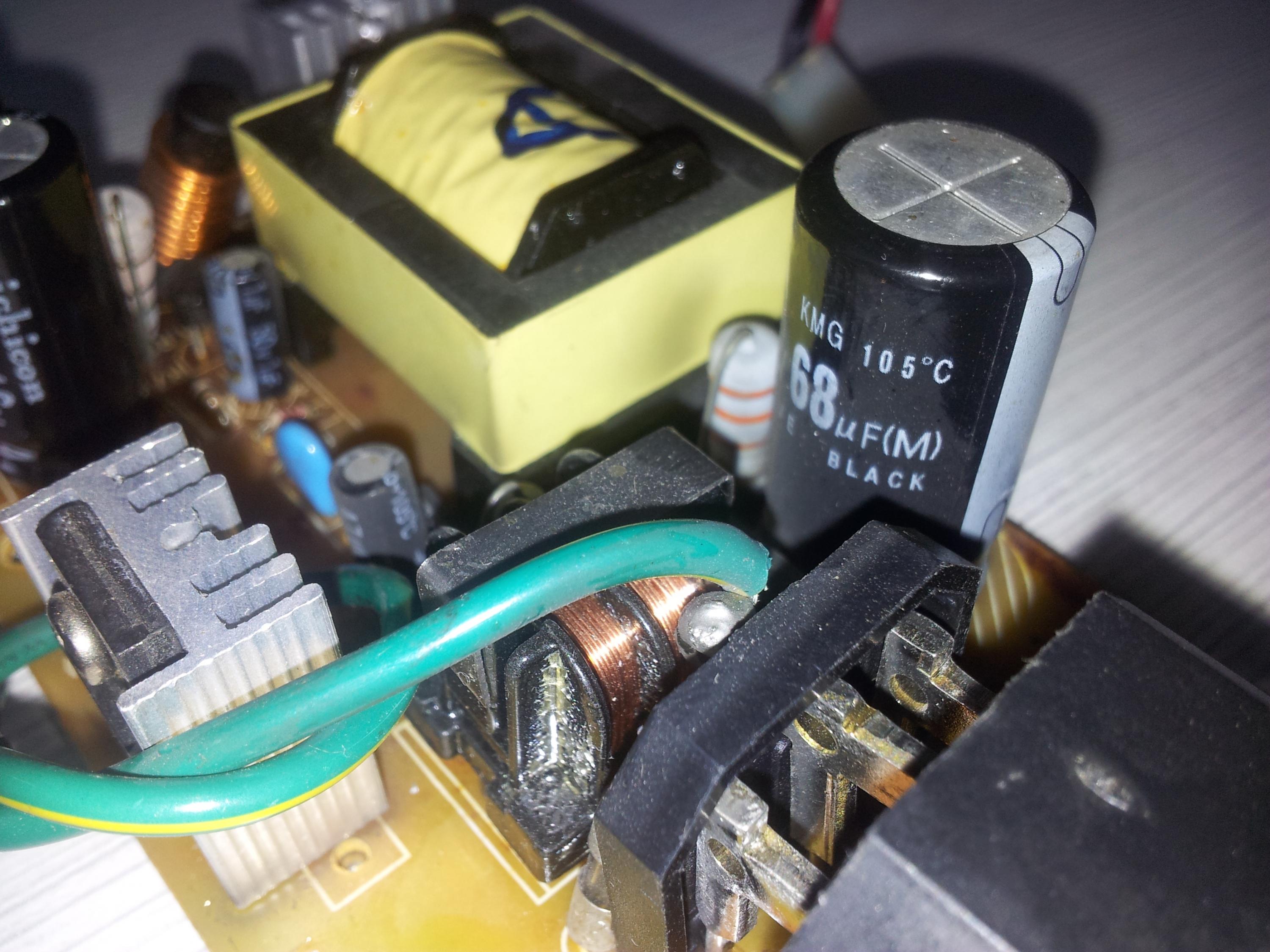

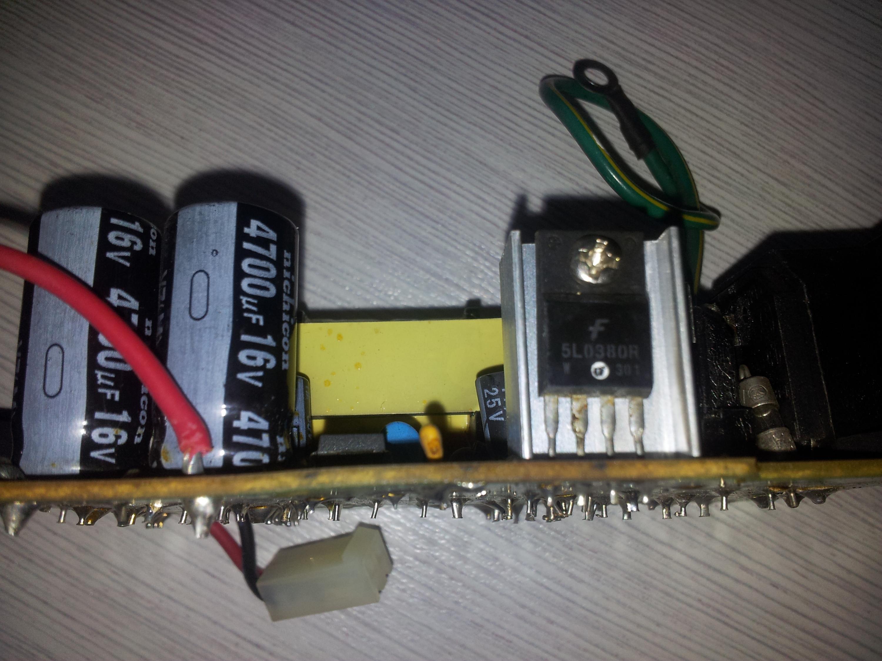

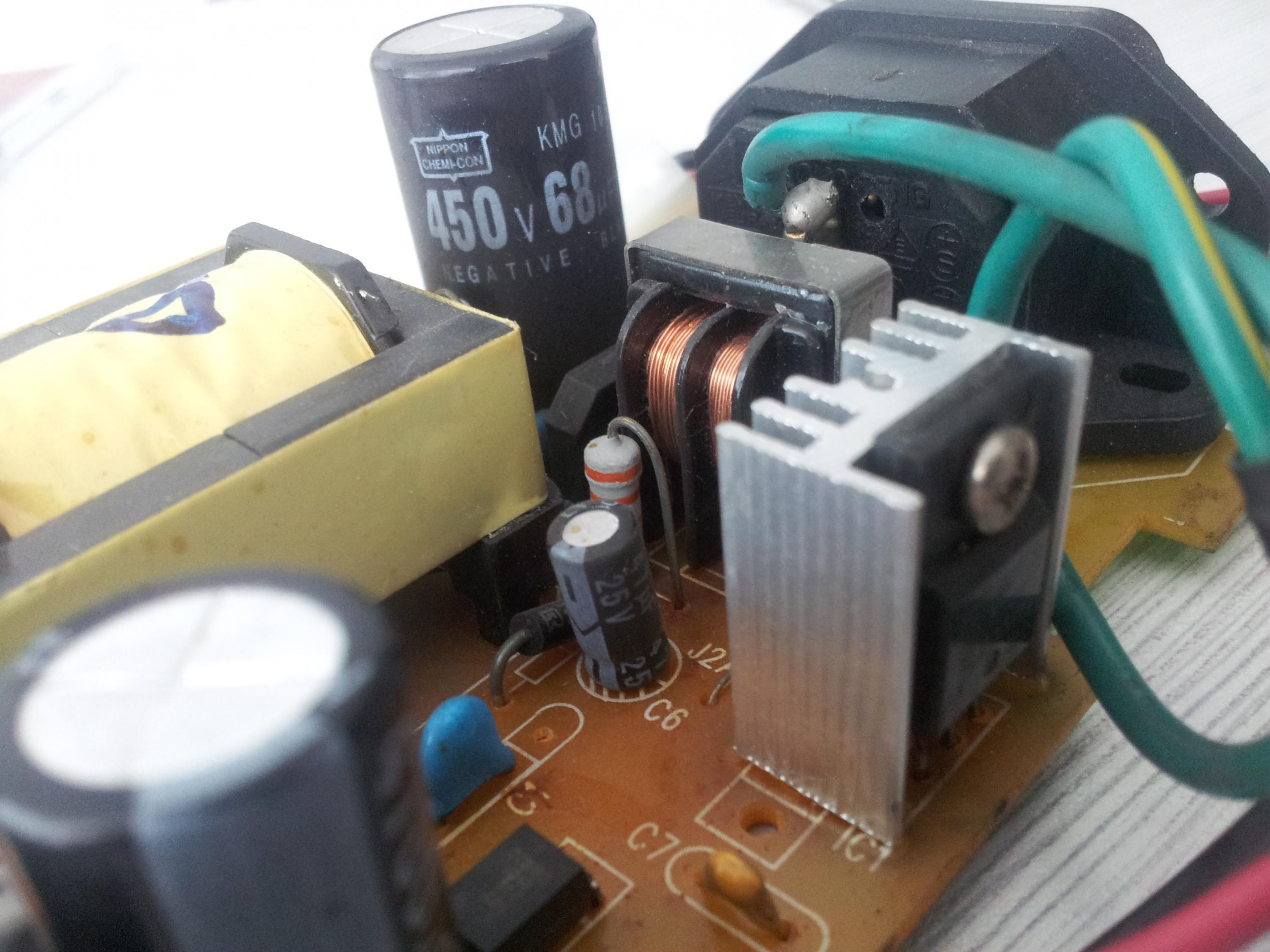

    Try changing those two output caps. Also, the external connector of the psu seems broken ( its shield is out in the 4th picture ). Also, it seems a blob of solder could be causing a short to the filtering coil in same 4th picture.
      Re: D-link DES1024D Dead

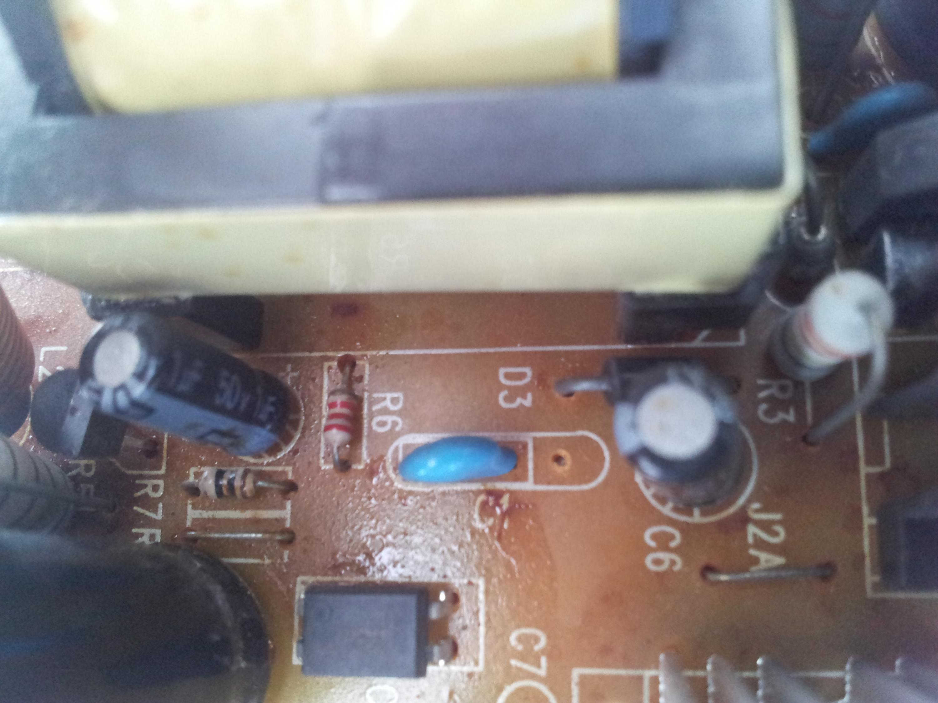

      Fuse tested OK? Try heating the 2 small startup/running capscaps (One is C6, anther one I cannot see the designator) with hair dryer to see if it will start up.
      According to the user manual, this D-link consumes about 8.5 Watts of power.
      So it is not a big power supply.
        C6 is 47uf 25v
        C11 1uf 50v
        C1 102 2kv

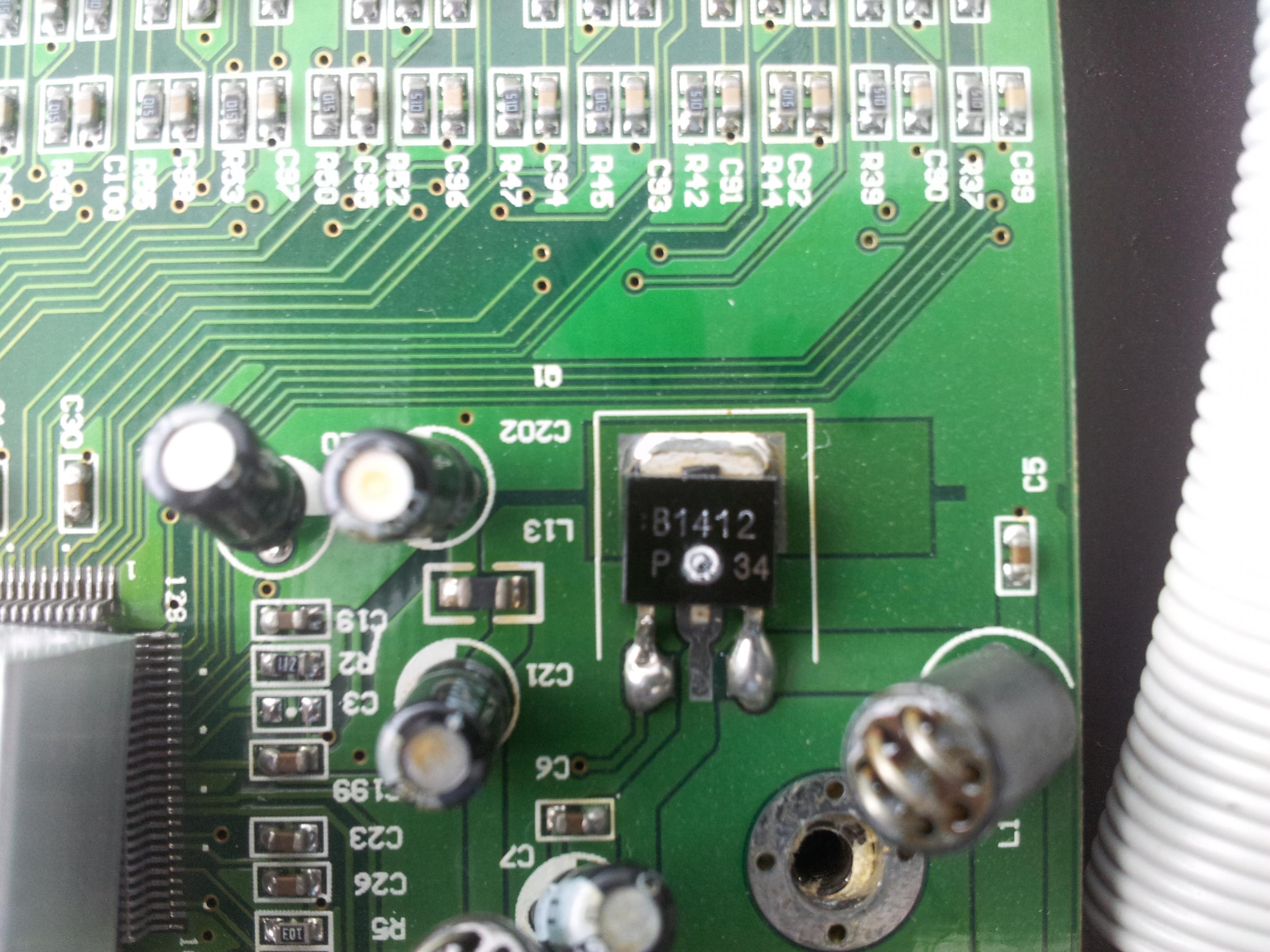

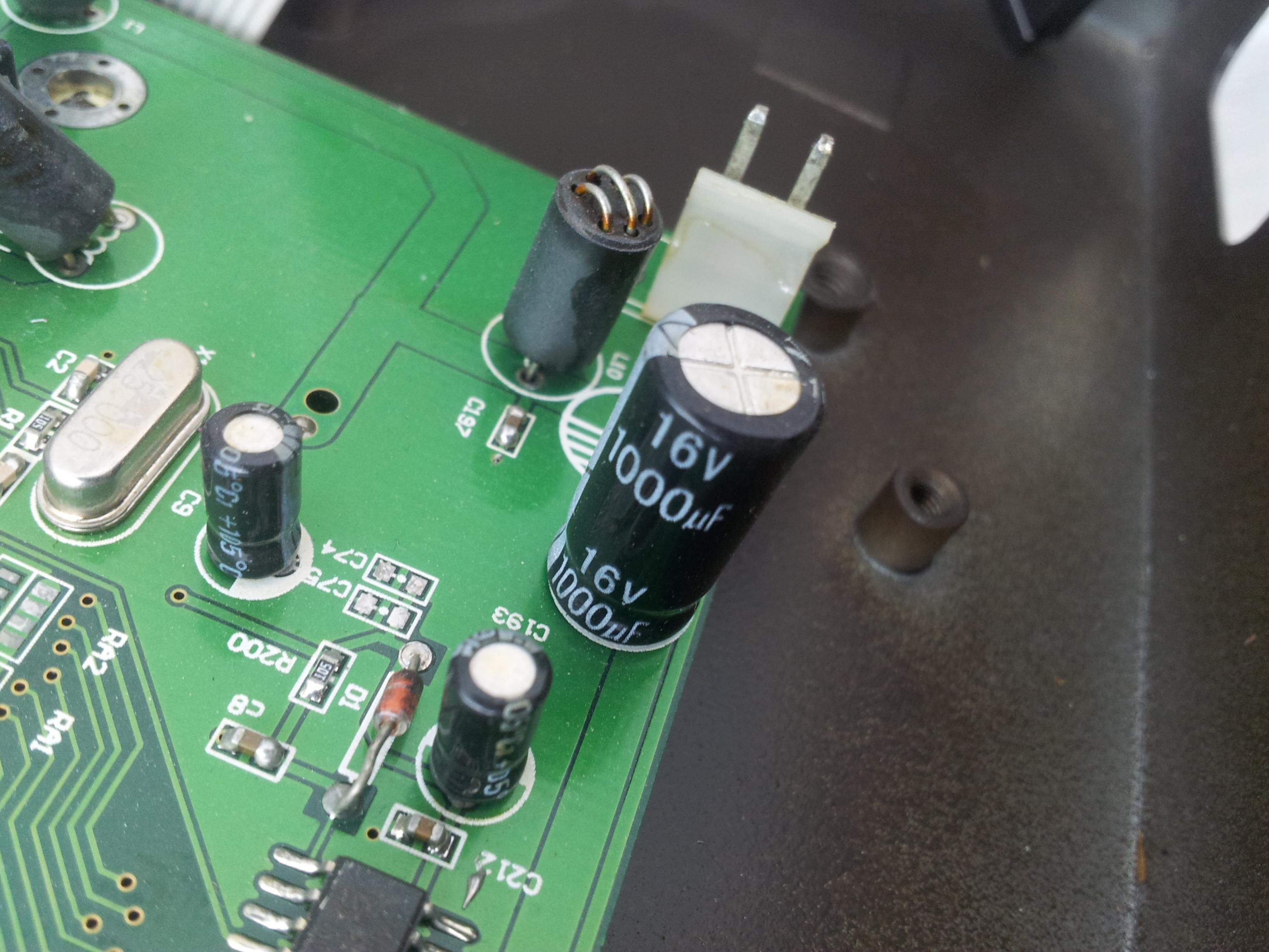

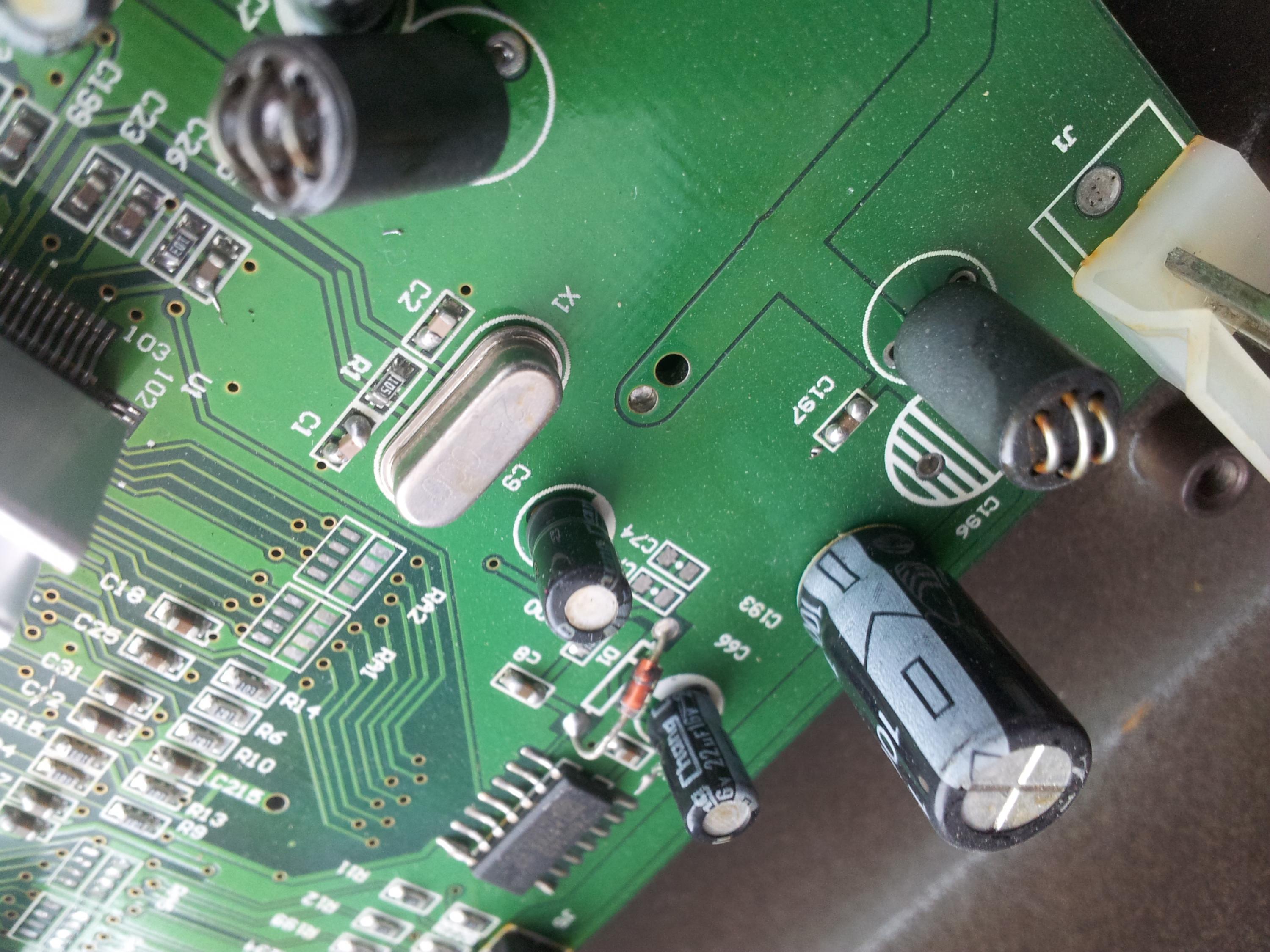

        on switch board there is
        at starting C193 1000uf 16v
        and 3x transistors B1412 p34

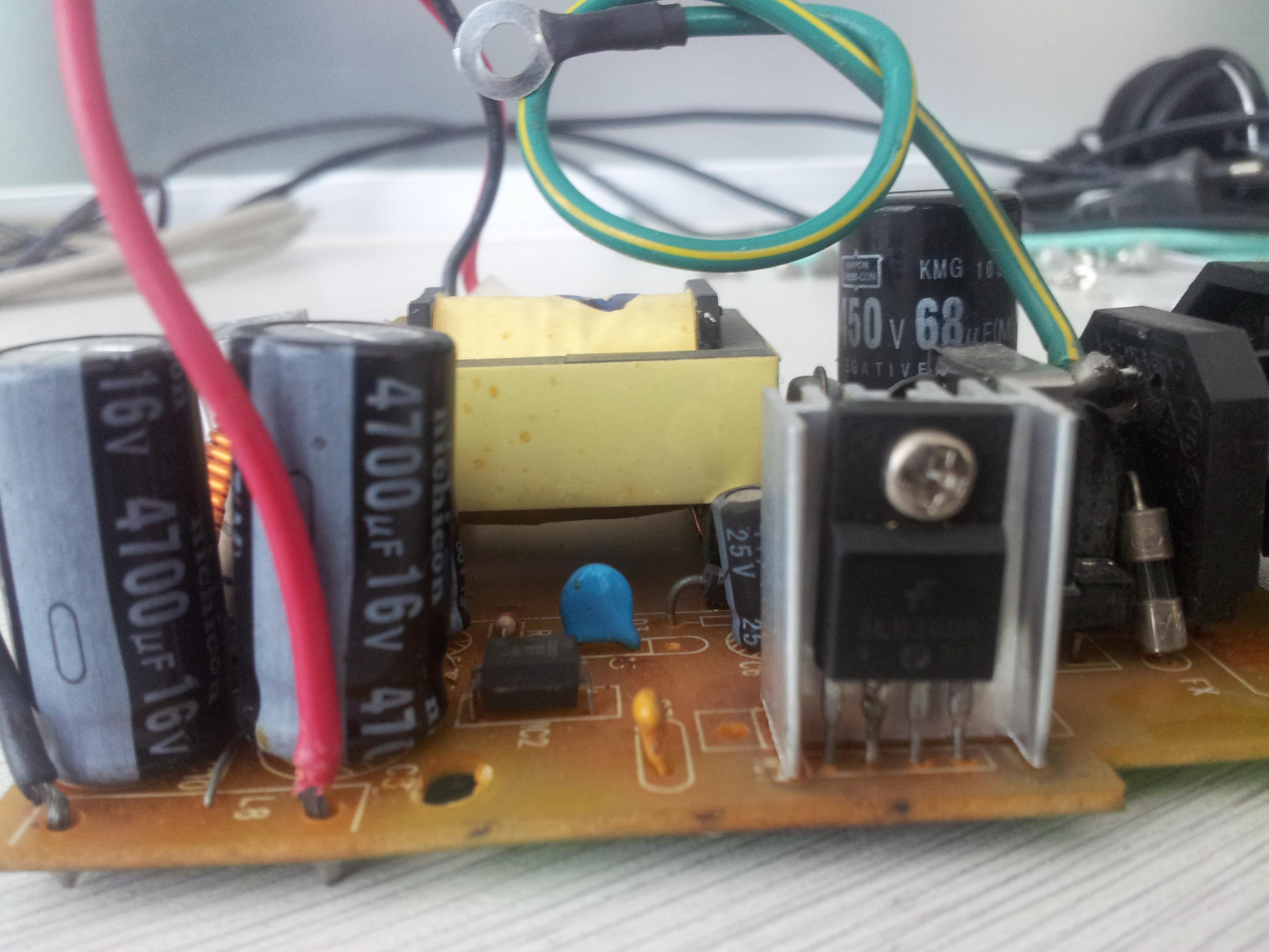

          Replace all the capacitors. Notice the fake NCC KMG capacitor!!!
            on psu or switch board ??
              Preferably both, but I was talking about the PSU.
                no luck still dead
                  no luck still dead
                  Does the fuse measure good?
                  Could you read us the markings on IC1?
