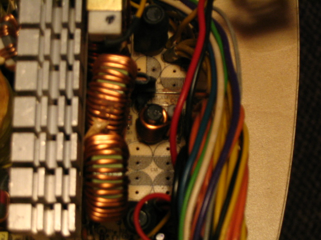

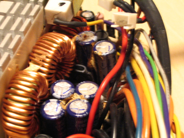

    I'm recapping 2 of these bad boys.
    Cap list is as follows:
    8 3300uf 10v 10mm
    4 2200uf 16v 10mm
    4 1000uf 10v 8mm
    2 470uf 16v 8mm
    Problem is I can't find ANY
    2200uf 16v 10mm caps. They need
    to be 10mm as it's a tight fit.
    Any suggestions out there?
    elbrute'

          Time for an update.
          New caps in hand, Samxon GC's (thanks to BigPope)
          3300uf 10v Fuhjyyu > 3300uf 6.3v Samxon
          2200uf 16v Fuhjyyu > 2200uf 16v Samxon
          1000uf 10v Fuhjyyu > 1000uf 6.3v Samxon
          470uf 16v Fuhjyyu > 470uf 16v Samxon
          Recapped 1st PWS and reassembled it.
          Powered up test bed computer, and it works!
          Been a while since I did any circuit work.
          12v = 12.0v
          5v = 5.08v
          3.3v = 3.34v
          Happy as a clam.
          Now to do a little premptive recapping on my
          main Antec PWS thats been running since 2002!
          Wonder what I'll find when I open it up.
          I'll keep you all posted, and thanks again
          to BigPope.
