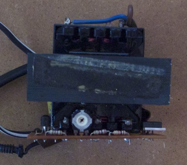

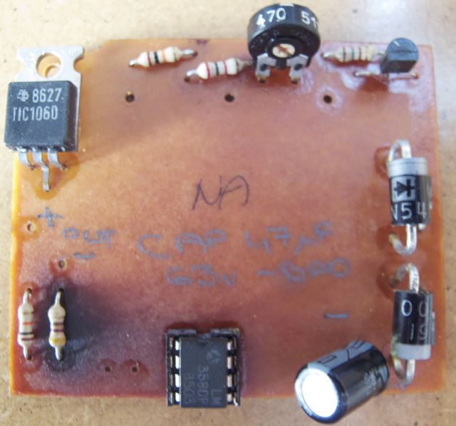

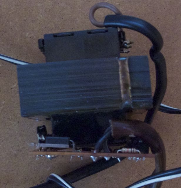

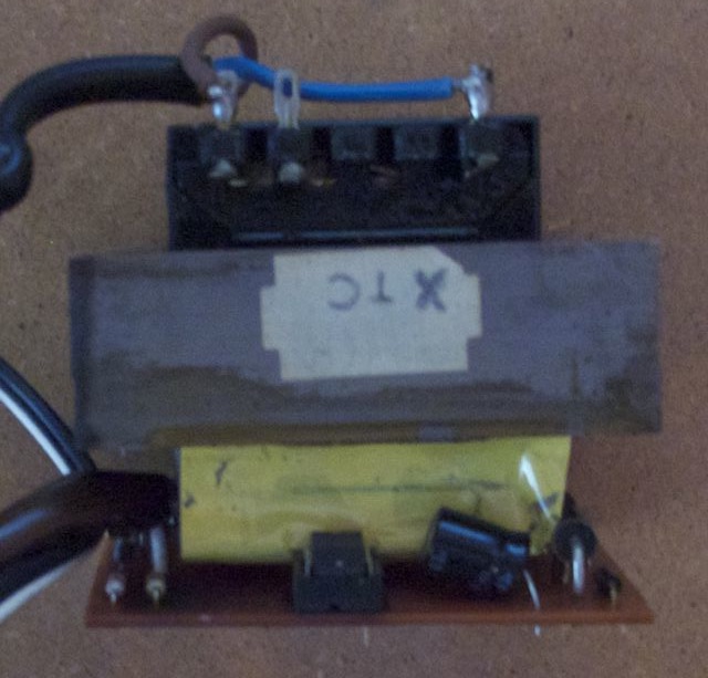

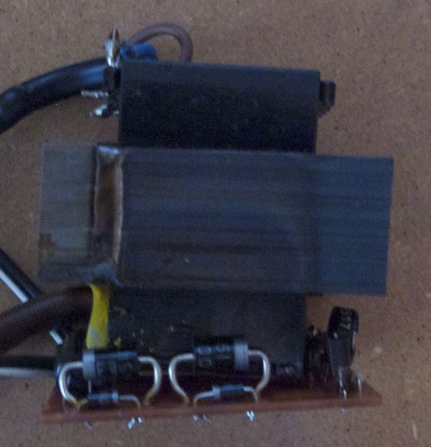

        Thanks for your replies. This is only an exercise to help me improve my understanding of power circuits - this one is unusual (?) and I cannot see how it is working, particularly how the +ve output is linked to the -ve output, as the negative output is only connected via the supply to the LM358 to the rest of the circuit!
        I have attached some photos as requested - and have overlaid components on the back of the PCB.

        • The 370 ohm resistor which is overheating is 470 ohm and is on the output of the LM358, and not the input as originally drawn!

          Do you still have the case of the power supply? I would like to see what it is said on it.

            I do have the case but there are very few markings unfortunately - I cannot even remember what this supply was originally for but have an inkling that it could have been for a very early gen transportable phone
            The markings are:
            Approval no: S1357/4/G/500454 (probably BABT)
            Made in England
            and on the base:
            25D83599R
            XDC 86 (49)
            I have googled but found nothing with this.

            After a days research, my only thoughts are that the LM317 is giving a ref voltage to the LM358 which is switching the TIC106D - logically this would be as overvoltage protection, but in reality, it seems to be to provide the positive rail! If this is a charger, then this would be to stop overcharging.
