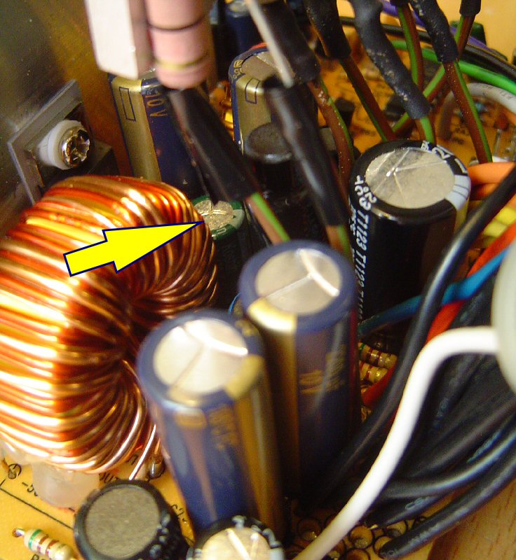

                #167
                Re: Cheap PSU: Piece of junk or semi-decent?
                It looks like one lead was torn out of one of the Choyo caps.
                Try to find some better caps. If you find a 10V or 6.3V cap, you should be able to use it for -5V.

                    #169
                    IT'S ALIVE!
                    Rotated the -5V Ruby 180 degrees, planted back a Koshin for -12V ...
                    ... and The Thing breaths! No thermobaric explosions, no dimensional rifts!
                    And with a couple fans plugged to the Molex sucking some +12V I get these pretty coherent voltage readings :
                    +12V: 11.80
                    +5V: 5.11
                    +3.3V: 3.32
                    -12V: -11.45
                    -5V: -4.77

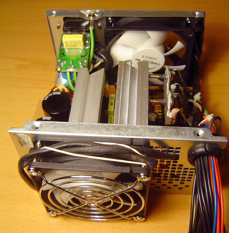

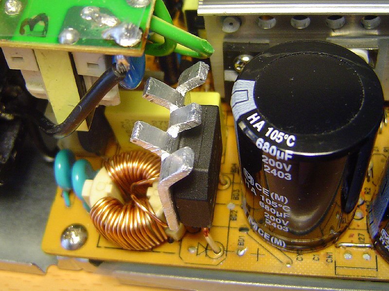

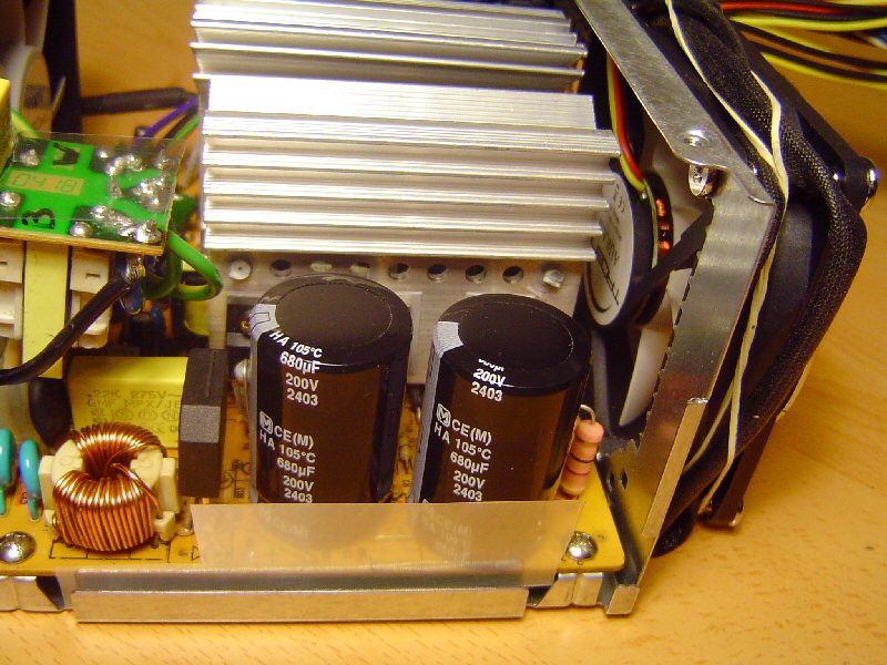

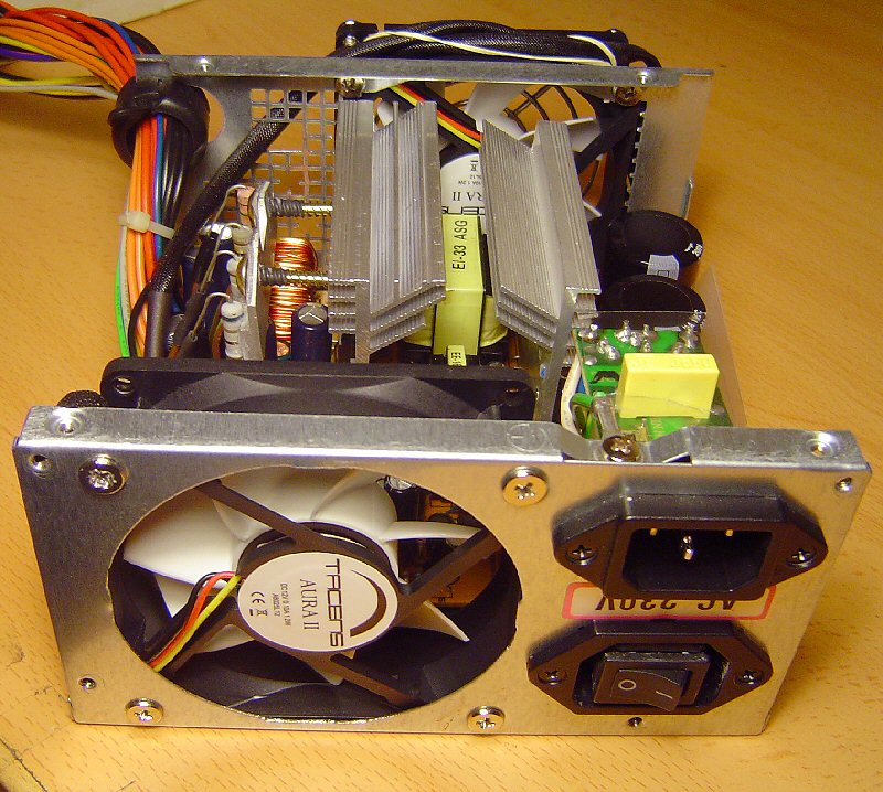

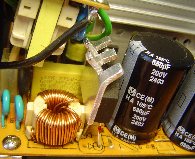

                      #170
                      Let the air flow - Both turbines slow ahead!
                      -> LARGE -> LARGE -> LARGE
                      Added a DIY heatsink for the rectifier bridge.

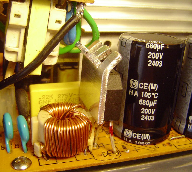

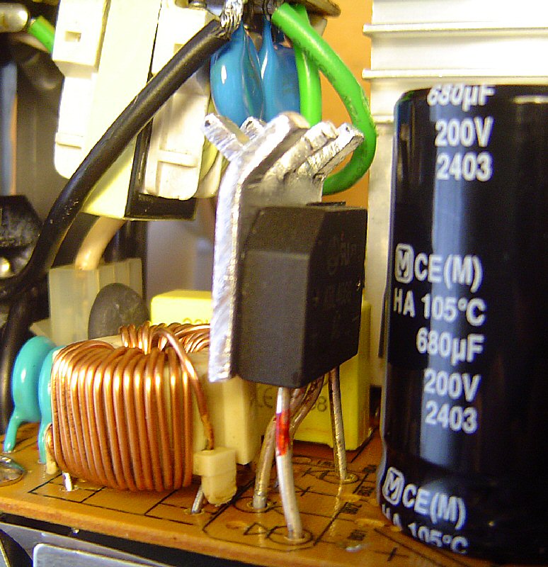

                        #171
                        Overkill!
                        • mariushm
                          • May 2011
                          • 3799
                          #172
                          That wire above the rectifier heatsink with so much uninsulated copper would worry me, don't like it at all.
                          Yeah, it's probably ok, you close the case and the wire doesn't move anywhere, and the rectifier is still passivated glass, insulated, so not much concern... these things just irk me.
                          Other than that, really overkill but somewhat nice at the same time. Good job!
                          • jamesbo
                            • Aug 2011
                            • 36

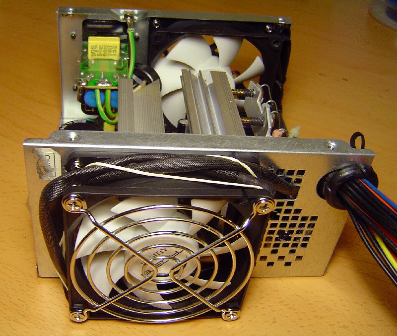

                            #173
                            I would recommed putting a grille on the outward facing fan. Turning the supply off by blindly reaching behind for the power switch could prove startling.
                            • goodpsusearch
                              • Oct 2009
                              • 2850
                              • Greece
                              #174
                              I thought he was going to put a grille there later....

                                #175
                                Yeah, it's probably ok, you close the case and the wire doesn't move anywhere, and the rectifier is still passivated glass, insulated, so not much concern... these things just irk me ...
                                I think you are right, I must insulate that wire better.
                                The front fan definitely needs a grille, as it could catch some internal PC wiring. But the exhaust one can live without, and we regain a bit of volumetric efficiency. PC fans aren't really dangerous, I stop them routinely with my fingertips when testing for noise sources.

                                  #176
                                  I accidentally touched one a week ago and broke a fan blade.. Better safe than sorry.
