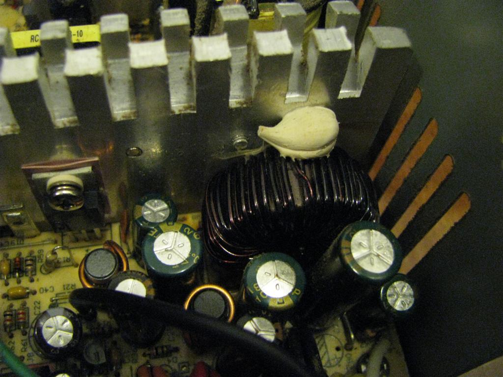

    • c_hegge
      • Sep 2009
      • 5219
      #62
      Re: thermaltake tr2 430w
      I just got one of these PSUs in to repair. It has two bad caps and a rather "well-done" torroid coil.
      • rogfanther
        • Jul 2006
        • 458
        • Brazil
        #63
        Had the fan stopped ?
        Will you rewind a new toroid, or just swap one from another psu ?
        • c_hegge
          • Sep 2009
          • 5219
          #64
          The fans are fine, so IDK why the coil burned up. As for a new coil, I'll just scavenge one from another PSU. I have a dead Besta PT-550 which I blew up on the tester. The coil looks about the same size, so I'll try it.
          • ben7
            Capaholic
            • Jan 2011
            • 4059
            #65
            Possibly they messed up on the core material.

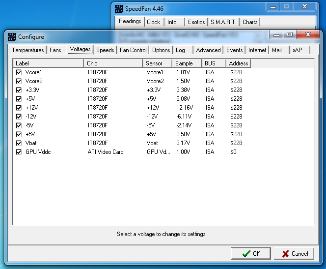

            • Phaihn
              • Jan 2009
              • 842
              #66
              does all that look normal or are there some under voltages?

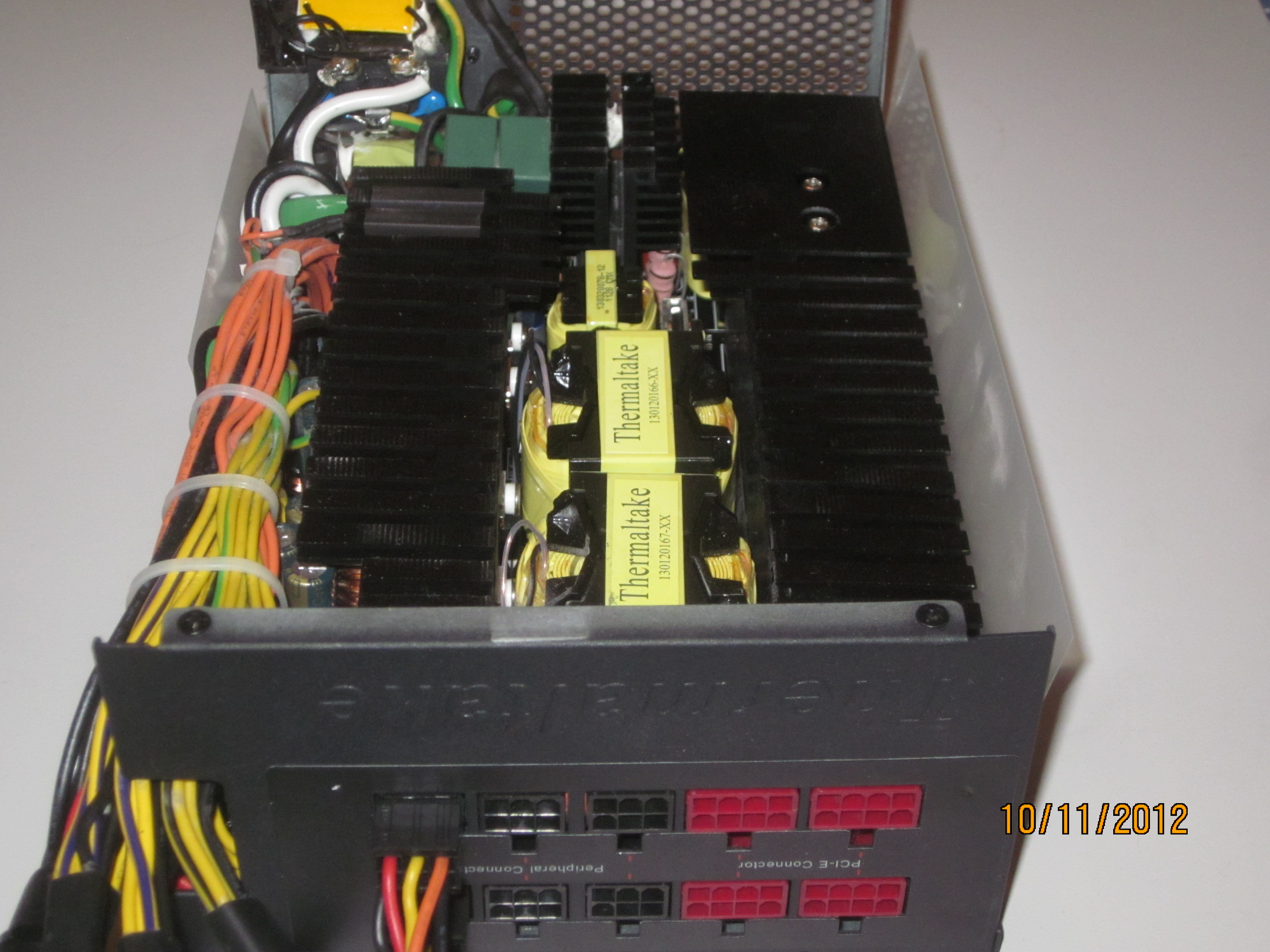

              • everell
                • Jan 2009
                • 1514

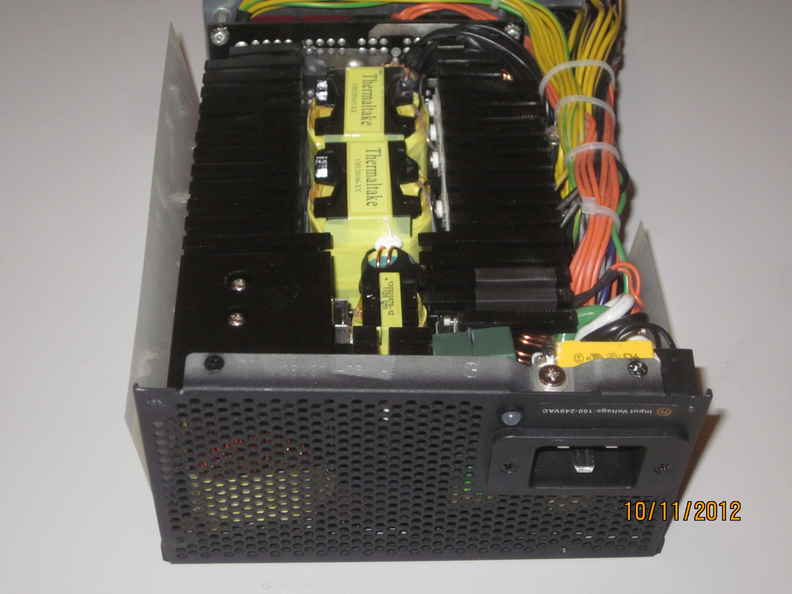

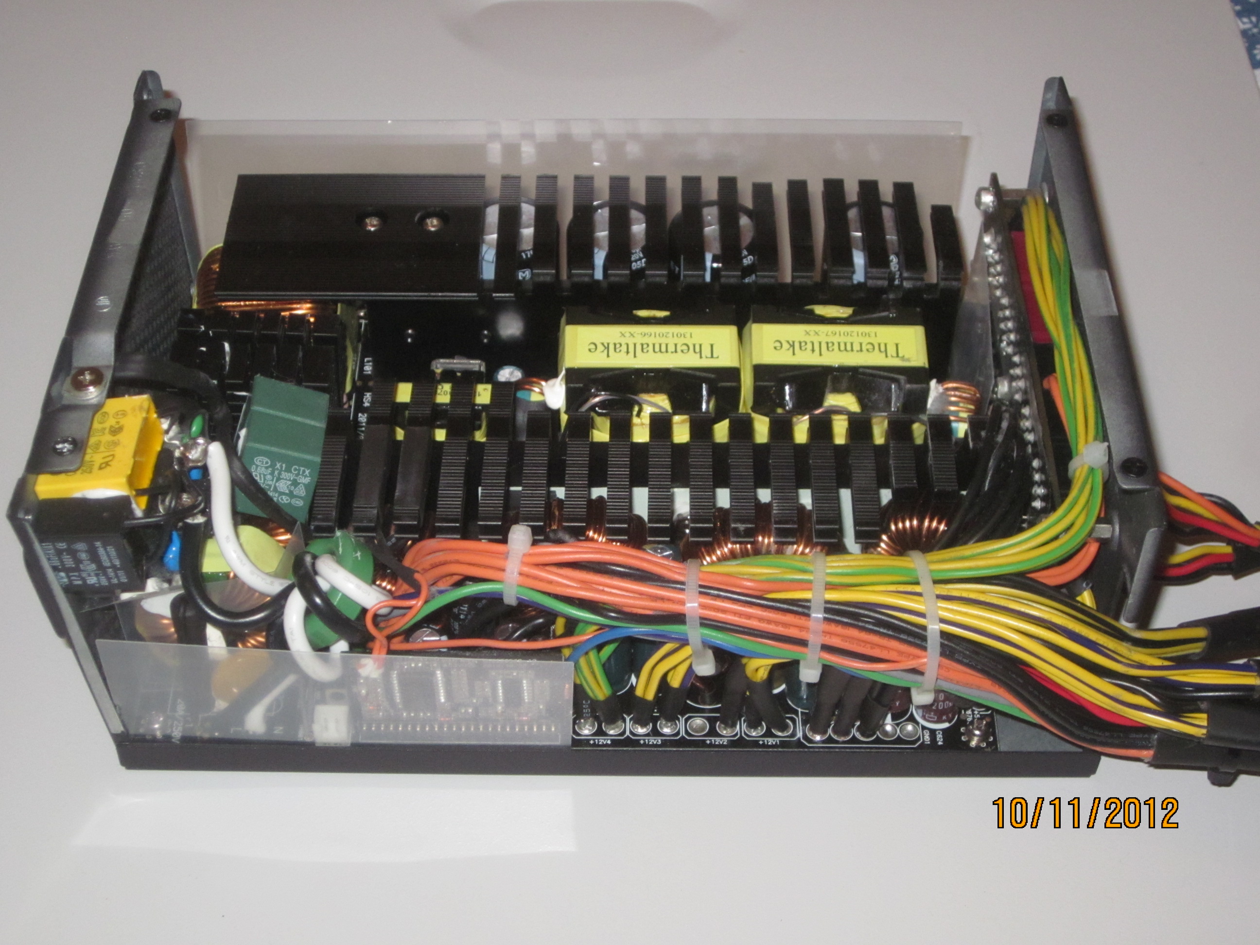

                #67
                I just got a Thermaltake model TP-1500AH5CES, looks very clean but unknown condition. If I remove my Bestec ATX-250 12E, which is powering the computer just fine, and put this Thermaltake in its place, will it power the computer without causing problems for the motherboard or power supply?
                Old proverb say.........If you shoot at nothing, you will hit nothing (George Henry 10-14-11)

                  • everell
                    • Jan 2009
                    • 1514
                    #69
                    Too late tonight to take it apart and have a picture taking session. Am on my way to bed so I can get up early tomorrow morning. Will post some pictures a little later. Sure is a heavy thing!
                        Failed caps or heavy cross-loading perhaps??
                        Motherboard voltage sensors are usually not very accurate. I never take them seriously and always check the voltages by myself with a multimeter.

                        • Phaihn
                          • Jan 2009
                          • 842
                          #72
                          Originally posted by momaka
                          No, the ripple on the outputs of the secondary might increase if the ESR (not the capacitance) is increased or descreased too much from the original. Increasing the capacitance will, *in most cases*, decrease the ripple and improve voltage stability.
                          The primary is a whole different story. There, the primary capacitors are used more as "energy storage units" rather than as noise/ripple suppressors.
                          This actually foreshadows the answer of your next question.
                          Like I mentioned above, the primary caps store energy so that there is a fairly constant high voltage source available for the switching transistors to "chop" and "feed" to the transformer. If the primary caps are too small and the transistors start to "demand" to "use" more energy than what the primary caps can supply, they will only be able to do so when the AC line voltage is near its peaks. If this continues further, you will start seeing 50/60 Hz noise on the outputs. At that point, the efficiency usually drops quite a bit.
                          So ensuring that your PSU has big enough primary caps is important.
                          i dont have a multimeter yet amongst other tools i need.

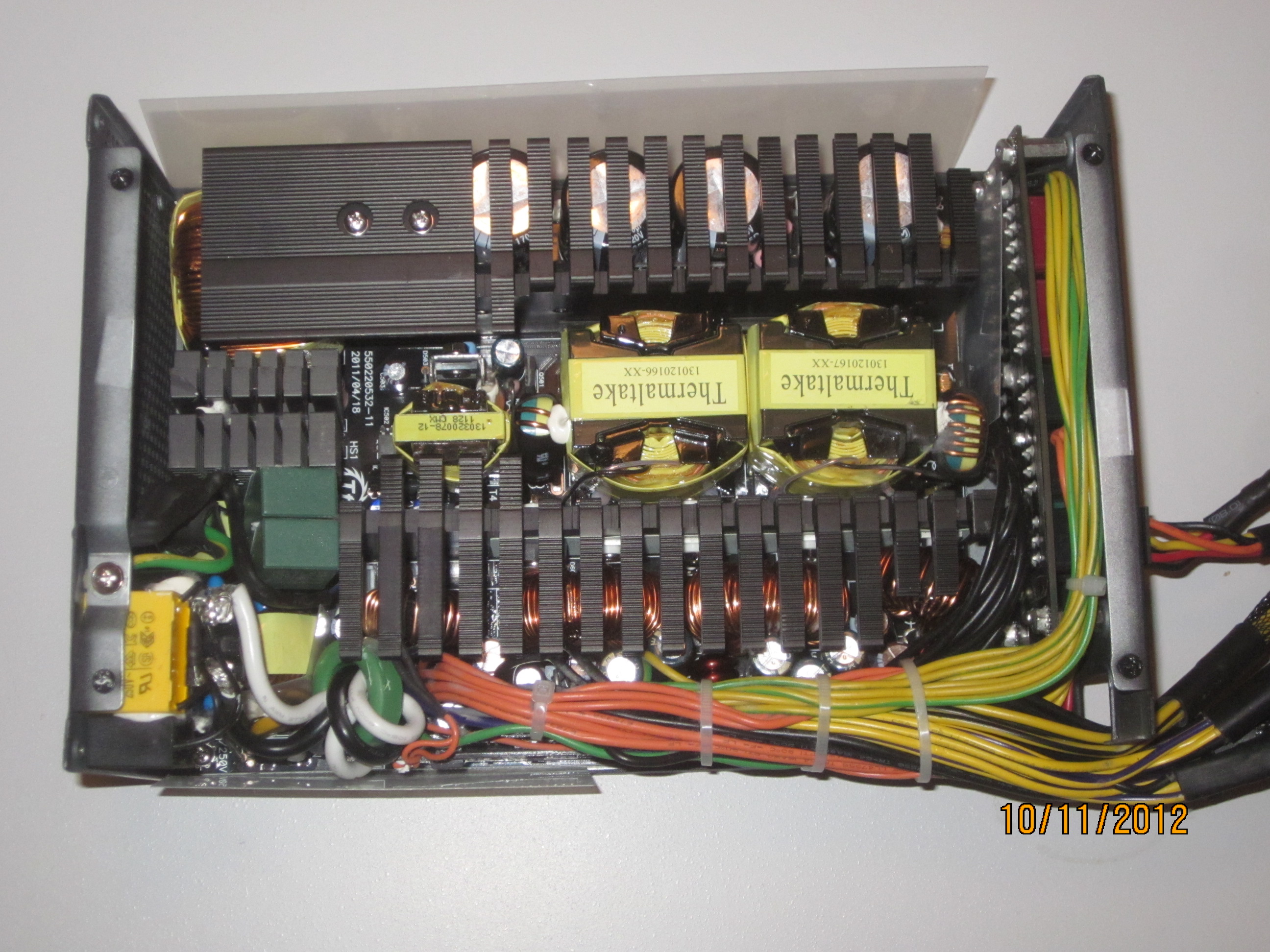

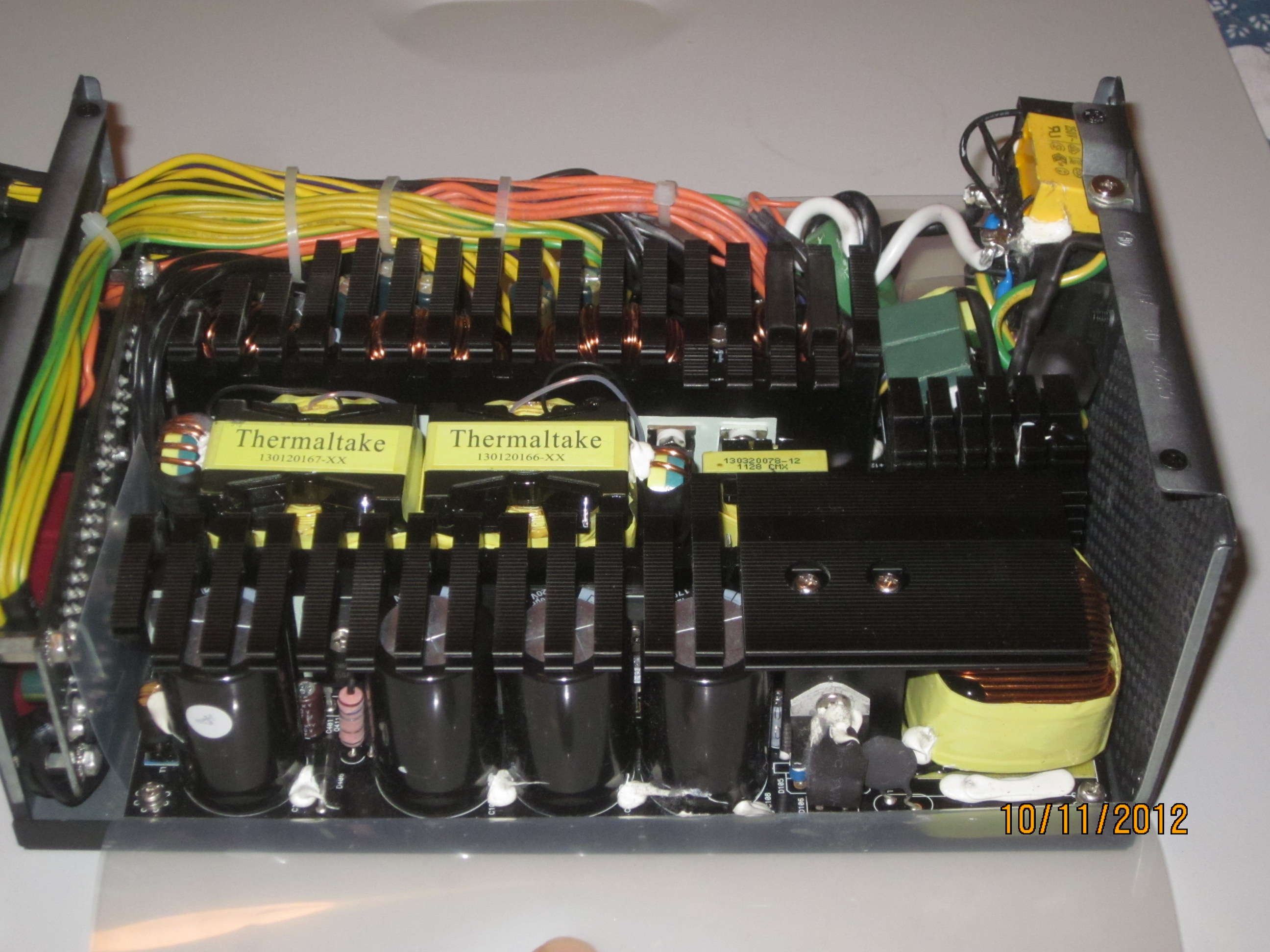

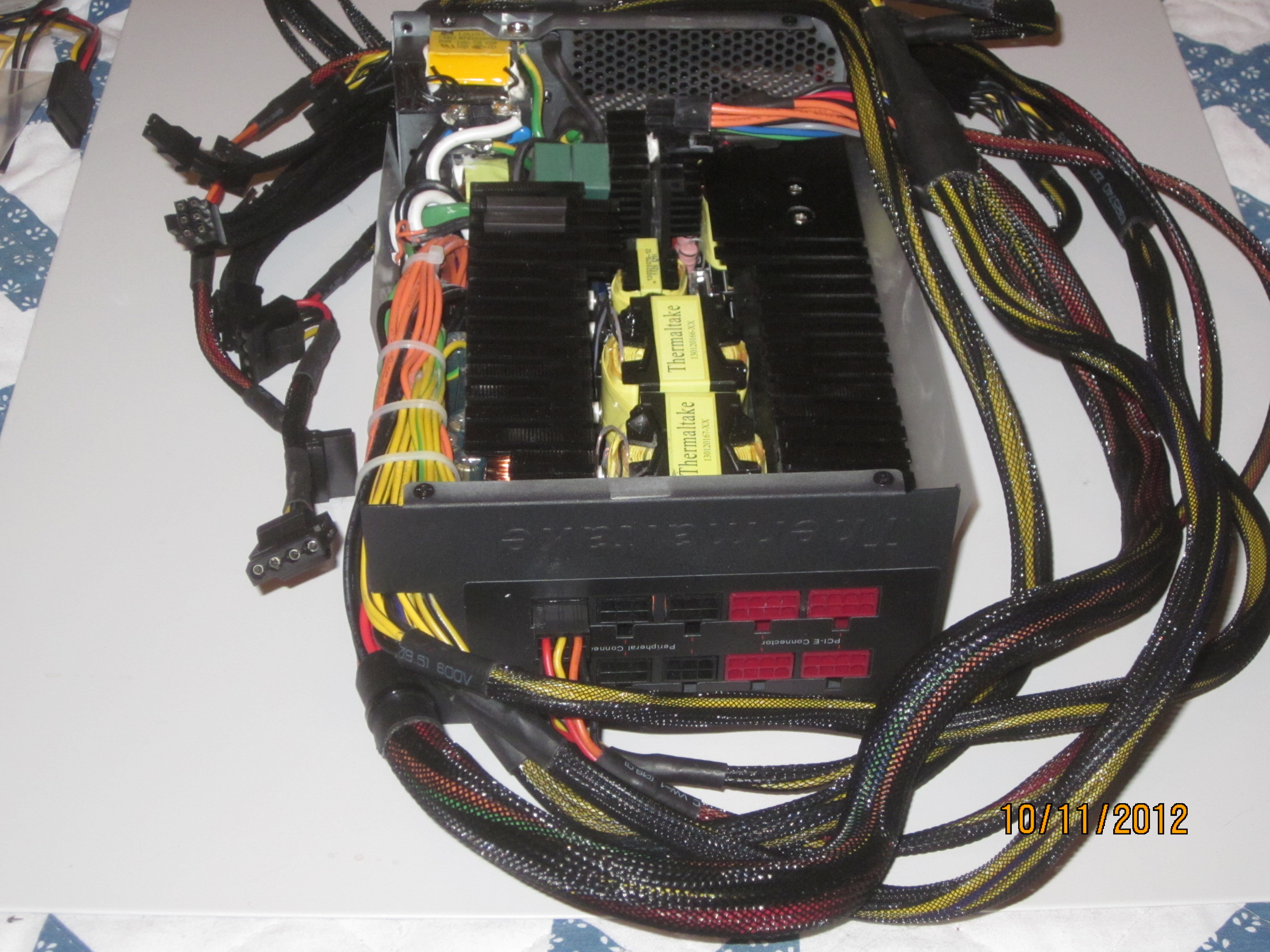

                            • everell
                              • Jan 2009
                              • 1514
                              #74
                              Here are some pictures I took tonight. This thing has more cables coming out of it than an octopus!

                                #75
                                Originally posted by goodpsusearch
                                You NEED to buy a multimeter if you are going to do stuff like this.

                                • Phaihn
                                  • Jan 2009
                                  • 842
                                  #76
                                  looks like a decent psu. is that a short psu looks smaller then most for some reason.
