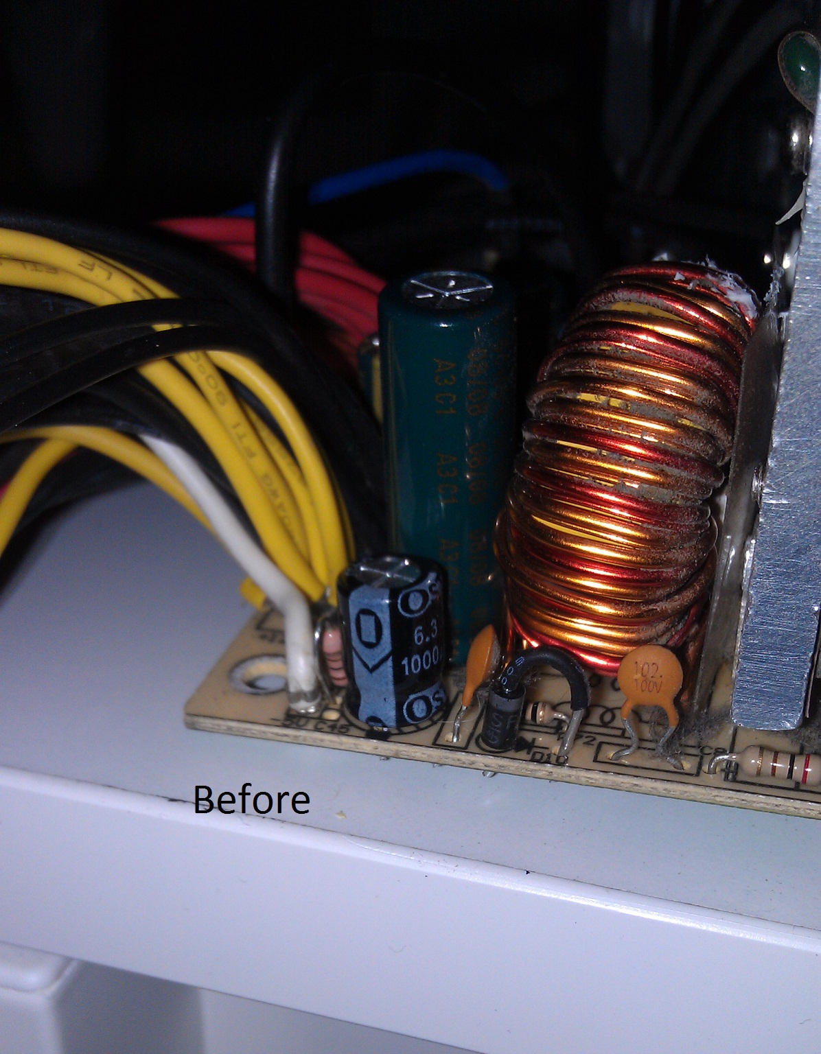

      Originally posted by goodpsusearch
      I attached a pic with my suggestions. The cap circled is 85 Celsius cap. This is unacceptable for a power supply. You should replace it with 105C cap. I am not sure if this cap is for -12V or 5vsb. If it is responsible for 5vsb filtering along with the other 470uF I would advise you to put a 1000uF there too.
      You better stick to the original voltage values. 6.3V can be replaced with 6.3V or higher Volts (10V, 16V).
      10V -> 10V or 16V
      16V ->16V
      is it safe to go from 1000uf to 470uf?

        Originally posted by Phaihn
        i just put them back the way they were
        Good. It should take out the hot air out of PSU and PC.

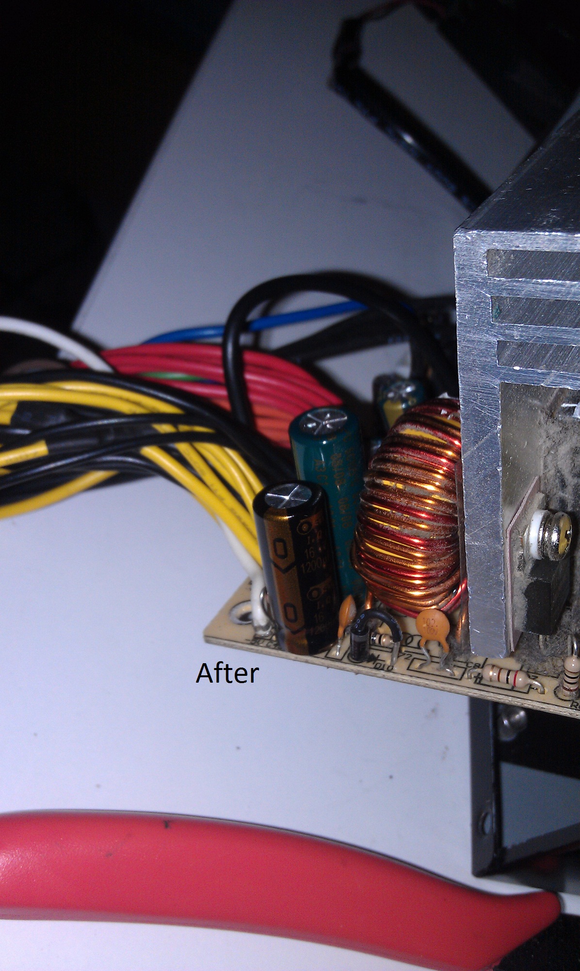

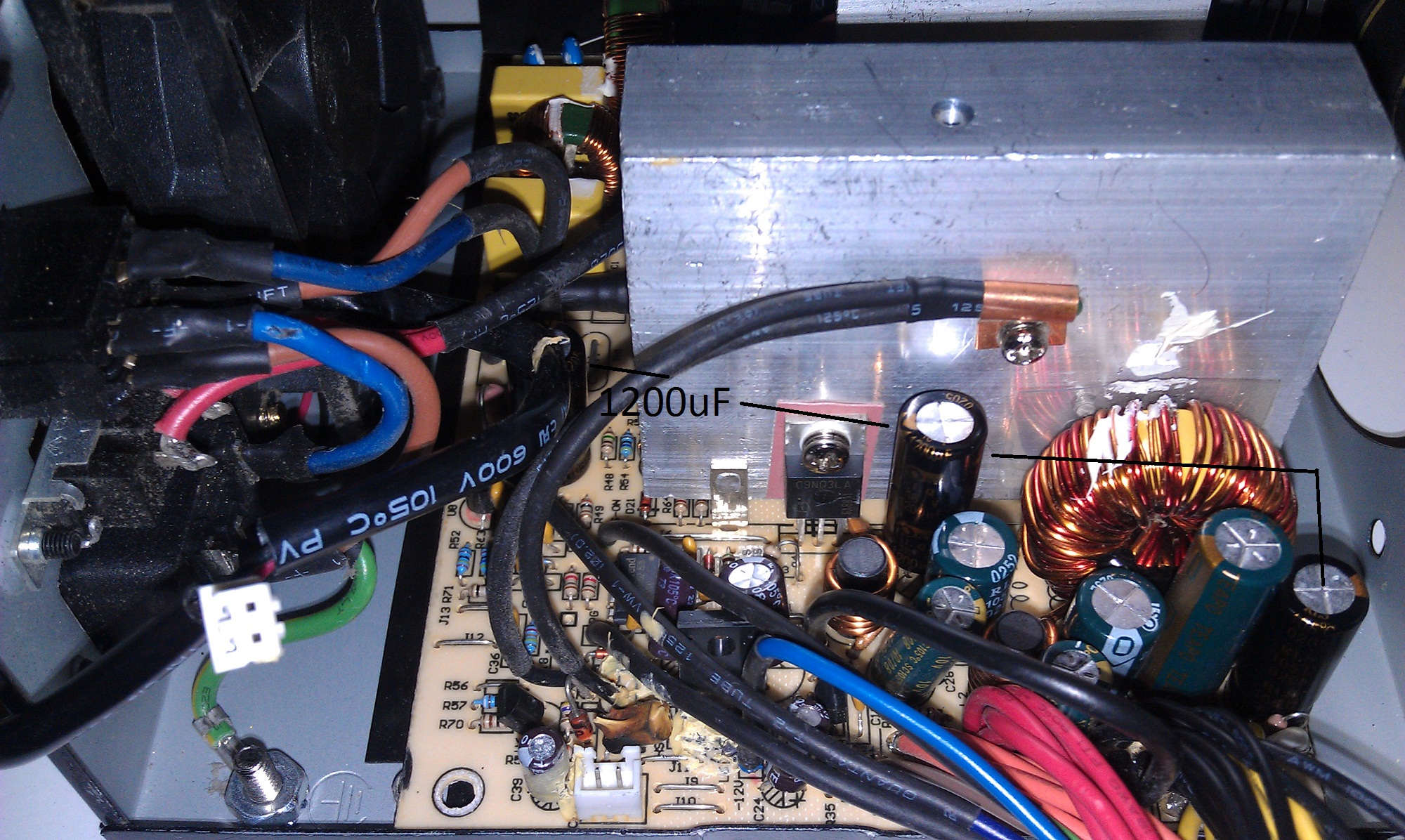

            had to use 1200uF caps didnt have any 1000uF 16v caps.

              You recapped with OST?

                Have you even checked the series and the esr of the old and the new caps?
                  The tall green one is a Teapo, I am surprised you did not mention it. Unless OST is so much worse than Teapo that they seem good in comparison.
                  I would not use these either (Thanks to this site educating me.) unless it was something I needed right now or it was just for temporary use. If it was something that I wanted to use long term than I would do it using good caps. If getting caps is a problem then you just have to do the best you can with what you have and hope it does not go .

                    Several things that need to be addressed here...
                    1) It's nice to post the stash of caps you have, but without listing what series they are or what dimensions they have, then we can't really recommend which ones would be appropriate replacements. Same goes for when you listed the caps in the PSU. Ideally you want to put it in this format:
                    voltage rail: -- cap brand -- cap series -- cap voltage -- capacitance -- cap diameter (in mm).
                    2) The stash of caps you have all seem of inferior brand or inappropriate series (or both: the United Chemicon KZG, for example). In this case, I would suggest not to replace the caps in the PSU except those 85C rated ones that goodpsusearch pointed out, along with any other 85C rated caps (except for the big high voltage Teapo caps on the primary side - those can stay). The small caps can stay too
                    3) You might want to get rid of this loose wire. Looks like a manufacturing defect/sloppy work.

                      Re: thermaltake tr2 430w
                      Indeed. Replacing TEAPO with OST is not an upgrade, it's a downgrade.

                              i didnt replace teapo with ost i replaced YEC with ost.
                                It's like you can read my mind
                                All good, though. Saves me from having to write the same stuff over and over .
                                i only changed out 3 and they were 85c ones.
                                i cut that off yesterday that was my own handy work i removed cables that were no longer of use. mostly extra old style molex plugs that were never used anymore.
