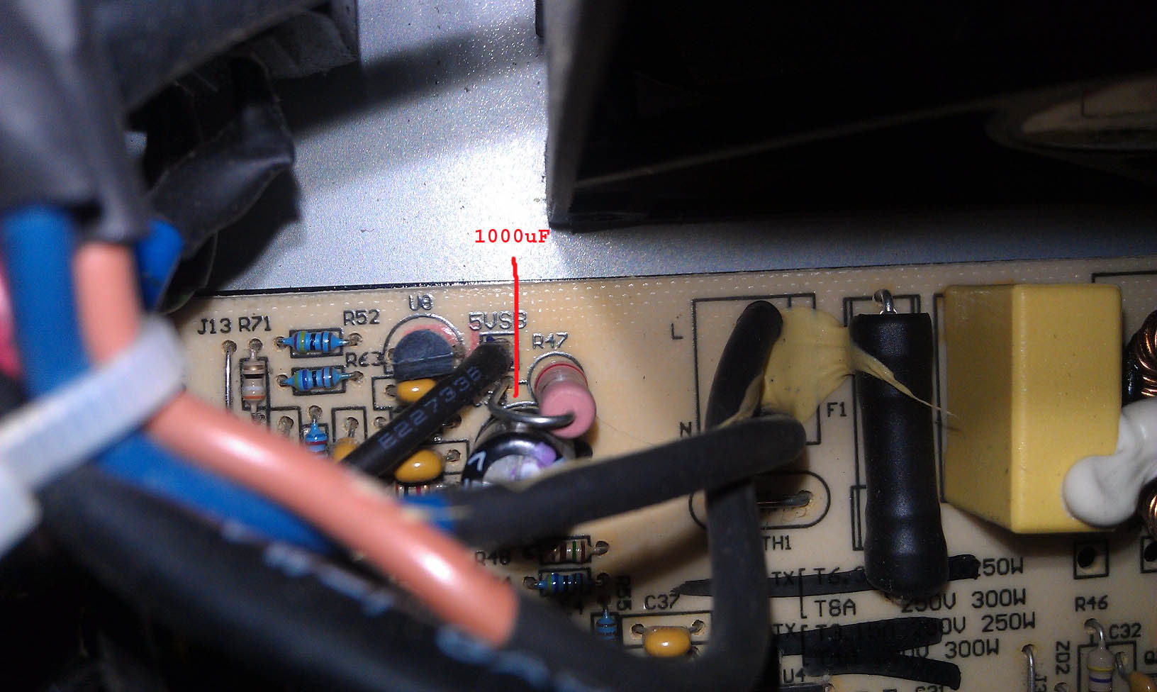

      Re: thermaltake tr2 430w
      Originally posted by goodpsusearch
      What???????
      Btw the photo you posted shows the 5vsb line.
      Are you sure you know what you are doing?
      not as well as you guys know but enouth to recap it.\
      the second set of pictures has the 12v.

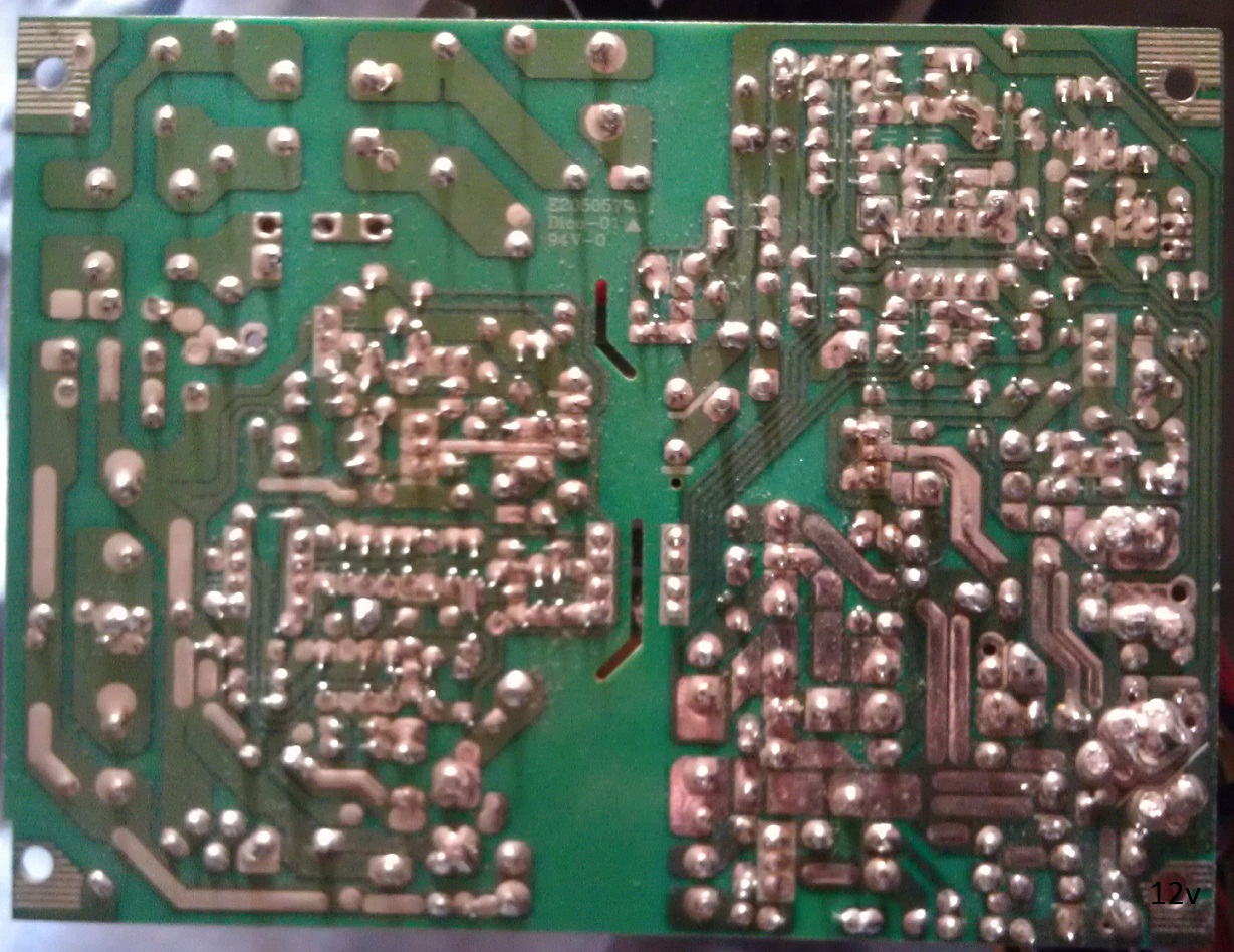

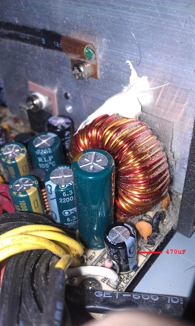

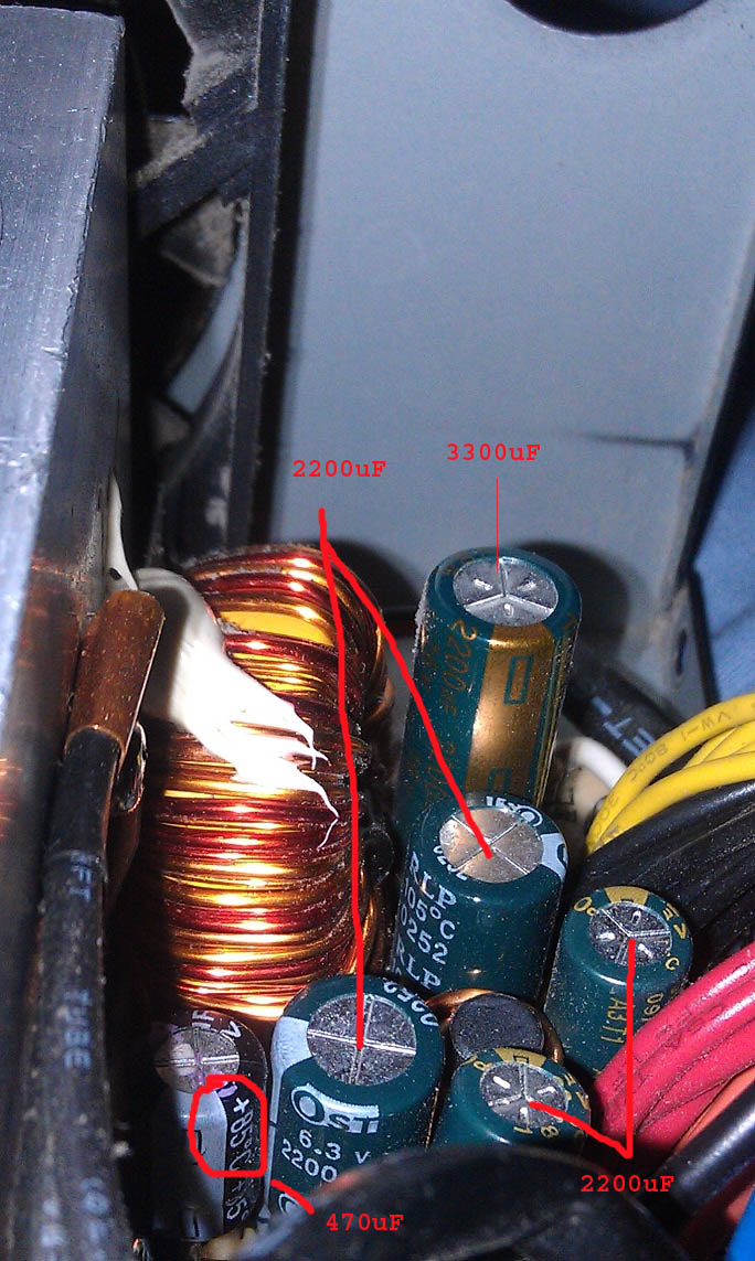

            Ok, no prob! Either way I would replace the 1000uF caps with 2200uF or 3300uF.
            I would also replace the 5vsb 470uF capacitor with 1000uF.
            If momaka saw this, I am sure he would warn you about that resistor near the 5vsb capacitor. Try to bend the resistor away of the capacitor if you don't want it to cook the cap.
            12V has actually only 1 cap and no coil. You might want to replace that 2200uF 16V cap with a 3300uF 16V cap.
            Please post a nice picture of the solder side if it is possible.
                i marked the corner that is 12v had to open up the psu again i had just put it back in my computer.
                  Originally posted by Wester547
                  And, alternatively, maybe you could bend (slightly) the capacitor away from the resistor.
                  Indeed, I do both!

                    #29
                    i just replace one of the 470uf or all 3?

                      #30
                      also for the 3300uF do i go up to 16v? or jus 6.3 and 10?

                        #31
                        I attached a pic with my suggestions. The cap circled is 85 Celsius cap. This is unacceptable for a power supply. You should replace it with 105C cap. I am not sure if this cap is for -12V or 5vsb. If it is responsible for 5vsb filtering along with the other 470uF I would advise you to put a 1000uF there too.
                        You better stick to the original voltage values. 6.3V can be replaced with 6.3V or higher Volts (10V, 16V).
                        10V -> 10V or 16V
                        16V ->16V

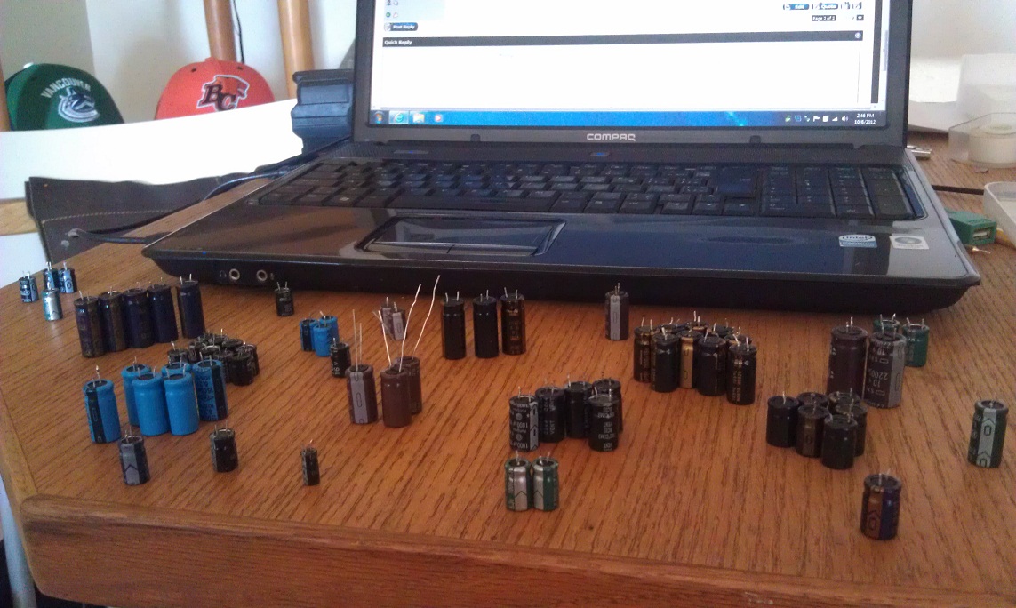

                            • Phaihn
                              • Jan 2009
                              • 842
                              #34
                              ost 3300uf 6.3v x5
                              kmg 3300uf 6.3v x4
                              yec 1500uf 6.3v x6
                              nic 1500uf 16v x9
                              fu 1000uf 10v x5
                              ost 1500uf 6.3v x1
                              can 1500uf 6.3v x6
                              [A] 470uf 10v x7
                              Glux 470uf 16v x1
                              yec 470uf 16v x1
                              ost 1200uf 16v x3
                              sxe 2200uf 10v x2
                              yec 1000uf 6.3v x3
                              fu 470uf 10v x3
                              ost 1000uf 6.3v x3
                              glux 1000uf 6.3 x3
                              junfu 470uf 16v x1
                              kzg 820uf 6.3v x2
                              ost 2200uf 6.3v x1
                              kme 1000uf 16v x1
                              glux 1500uf 6.3 x2
