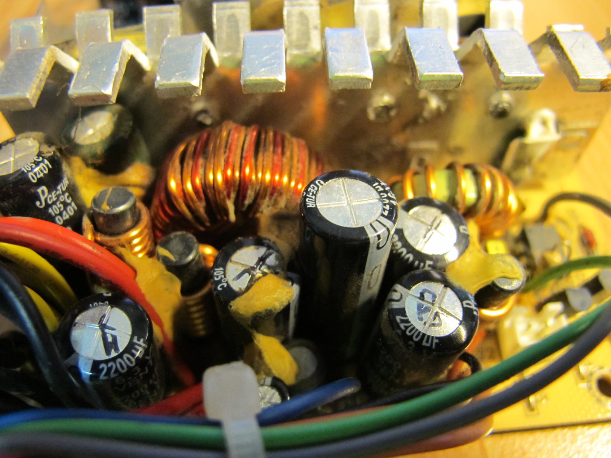

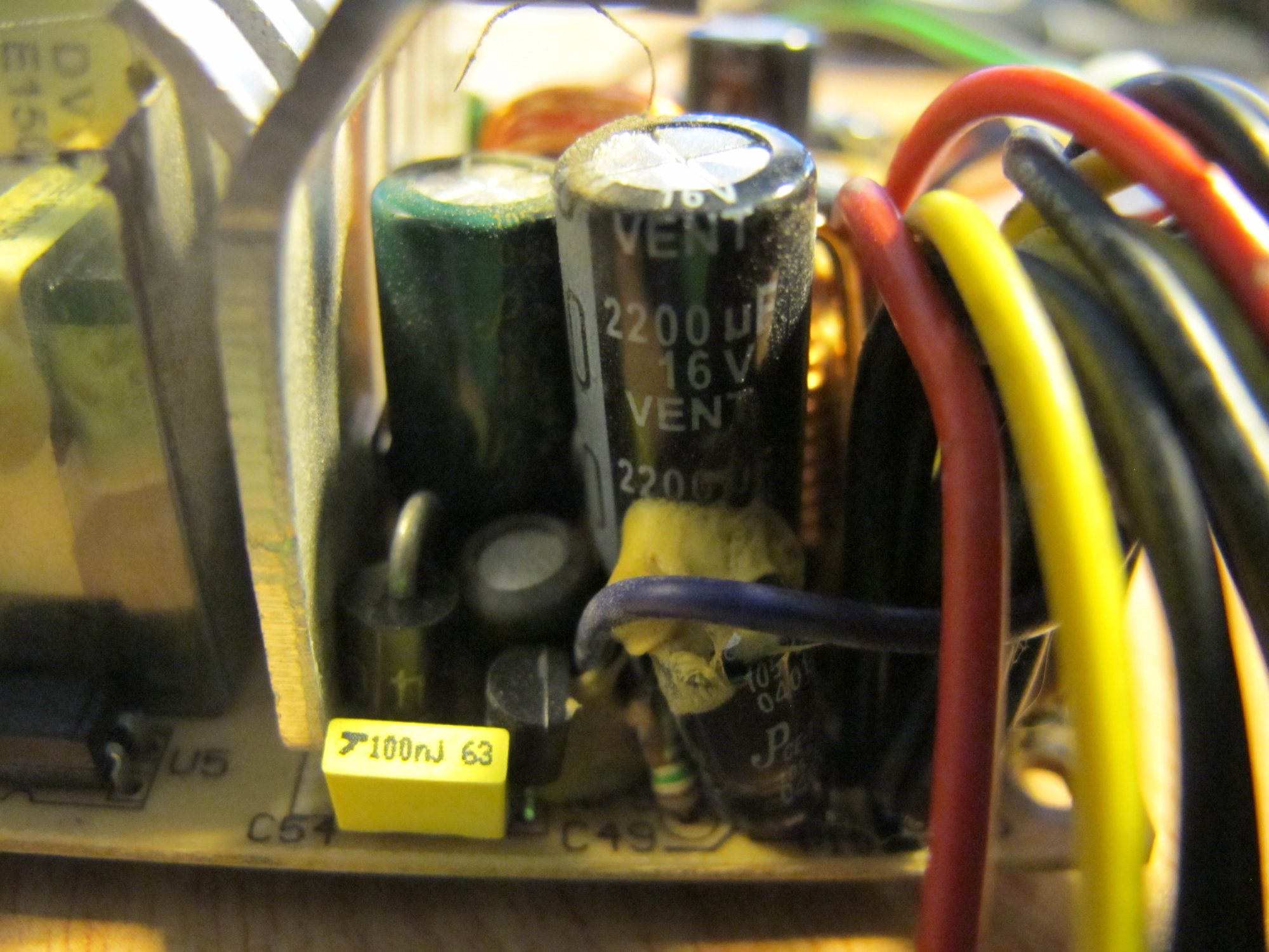

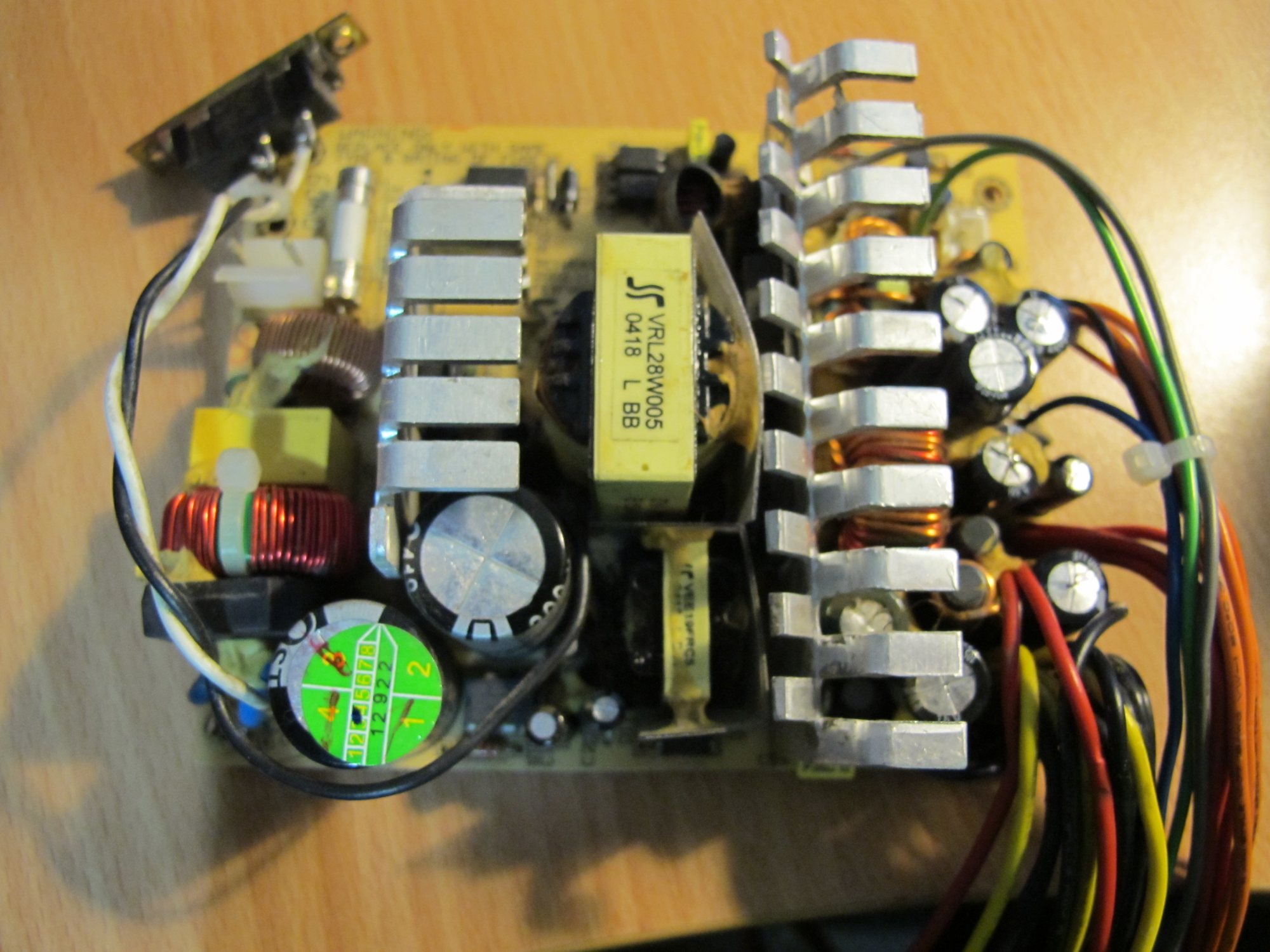

    I was wondering if I could get any help with my Seasonic SFX power supply.
    I've been getting strange instability inside my Atom based server with the video going fuzzy with this power supply recently, I've opened the power supply and marked the ones I think are bulging with black sharpie, seems like the 2200uf 6.3 v capacitors have gone bad, what should i replace these capacitors with?
    Should I also replace all of the capacitors including the 16v 2200uf?

    You should replace the ones around the swollen capacitors as well, with the proper values.
    Measure the diameter of those capacitors then pick a 2200uF 6.3v capacitor that is of that diameter (or smaller) from the following series:
    Panasonic FM, FR
    Nichicon HM, HN
    United Chemi Com KZE
    Rubycon ZLH
    For a 200w psu, I think you might be fine replacing them with 1800uF capacitors, but it's safer to keep them at 2200uF if you can.
    Check the Badcaps store, or if it's more convenient see digikey.com or farnell.com/newark.com/element14.com

                  Also, like it's already said, consider replacing the other capacitors on the secondary. Basically those 3 taller capacitors, especially the one right near the heatsink, should also be replaced.
                  • demented_demon
                    • Jun 2008
                    • 19
                    Re: Seasonic 200W SFX woes
                    I'll see if I can desolder the taller capacitors to ID them properly in the morning, I just can't get a good enough view since it's packed in so densely.

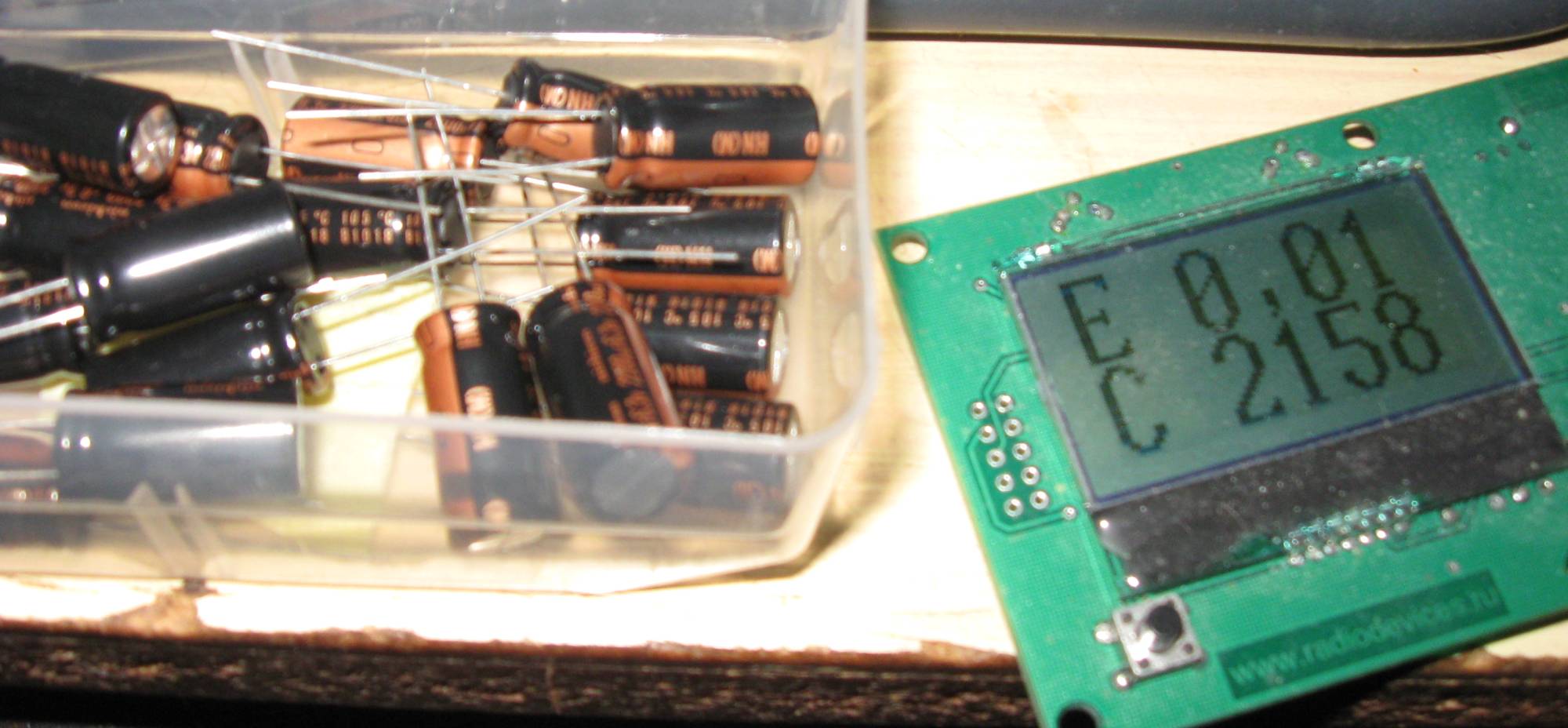

                          Yes, you're right, their ESR is quite low. Mine register at 0.01 ohm with the esr meter:
                          I already explained that sometimes too low esr is bad, but it seems he already had in mind either the HE or the FR from Panasonic so it's all good.

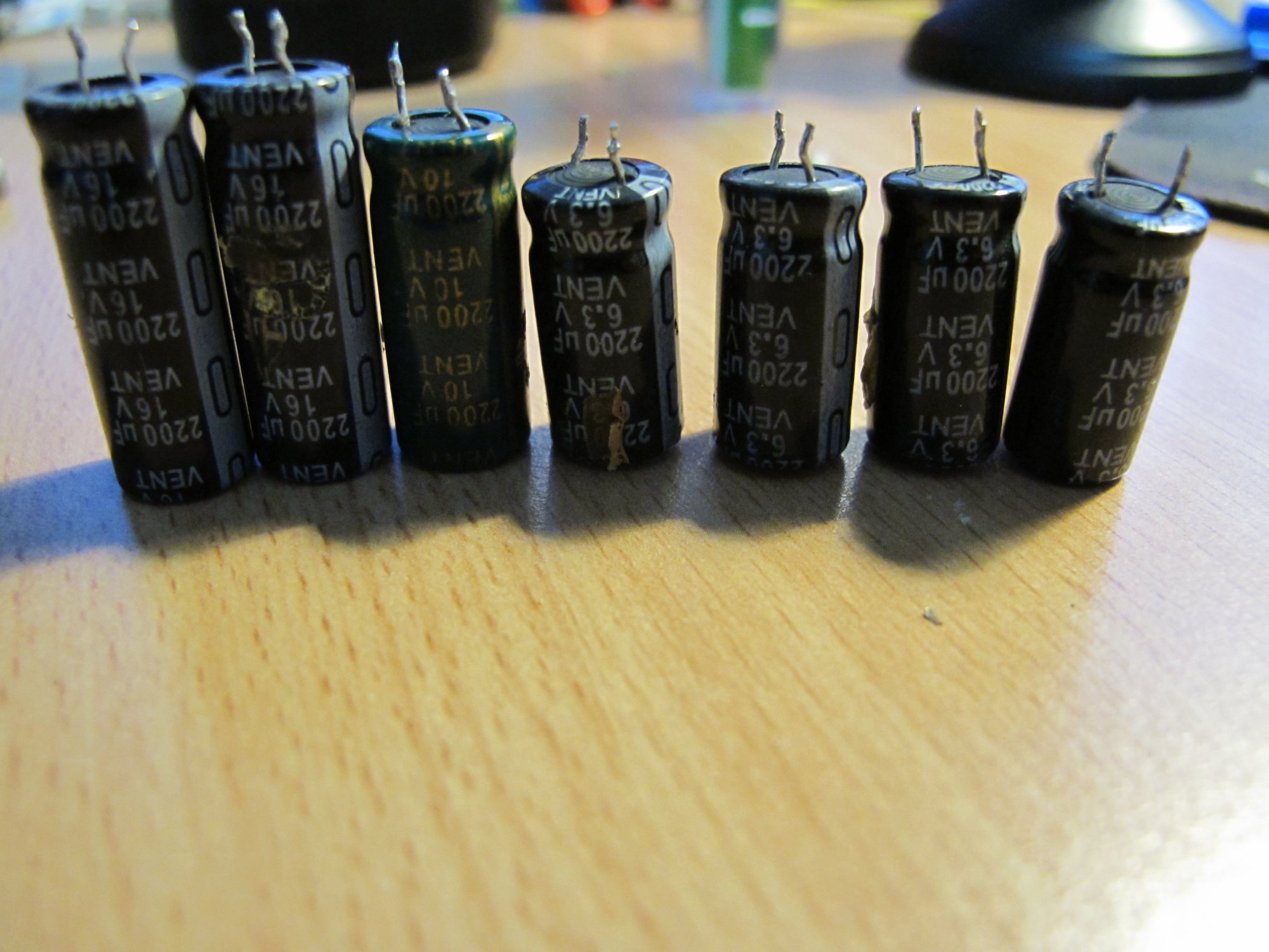

                                  I've removed the capacitors from the PSU.
                                  4 2200uf 6.3v Pce-Tur
                                  2 2200uf 16v Pce-Tur
                                  1 2200uf 10v Pce-Tut
                                  Is there any reason seasonic used a 10v capacitor? seems wierd to me.
                                  The 16v and 10v capacitors seem fine, they seem not be bloated but i wouldn't know.
