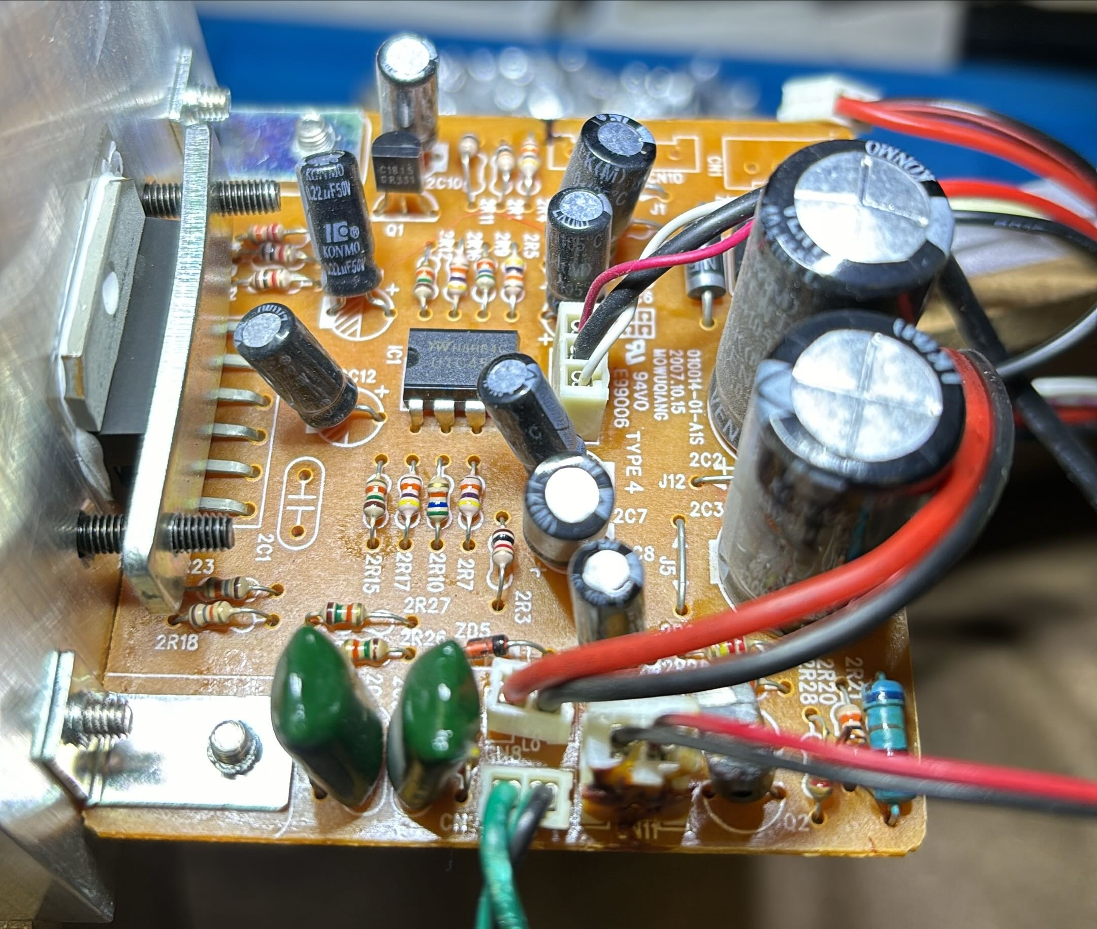

    I've just been repairing some (very) old speakers with a loud hum that occurred as soon as you powered them on regardless if any actual audio is played through them. I work in a School so it's 99% likey that the Teachers have hardly ever turned the power off on them for well over 10+ years.

    As you can see the top large capacitor on the right has a bulge on the top so defincately needs replacing. As the one next to it is exactly the same capacity and voltage I planned to replace them both.
    What is your advice/opinion on whether or not on old(er) equipment that has been well used, should all the other electrolytic capacitors also be replaced as they cost just a few pennies each or am I just wasting my time and should I just replace the one(s) that are clearly faulty?

    I would say it depends. Factors such as the ease of replacing all the caps (is it only a few, or does the device have dozens/hundreds of caps, are they accessible or do you need to remove other components, do you have the caps on hand or do you need to buy them?), the quality of the caps (are they reputable Japanese/European/American brands, are they known failure-prone brands, or are they "no name" caps that are hard to find any info on?), and how critical the device is/whether you're willing to replace them all for "piece of mind" are all factors worth considering.
    I do usually at least replace all the caps that are identical to the failed one(s) though.
    A while back I recapped the entire secondary side of the power supply in one of my laser printers (Brother HL5250DN circa 2005), after the standby rail cap failed (with the classic "wouldn't start after a power failure" symptom), though all the caps (all Japanese) except for the standby one (which was powered 24/7 for 16 years) tested in spec, so it probably wasn't necessary, but I had the caps on hand and once the PSU was out (removing the PSU from the printer was more difficult than actually replacing the caps) replacing them was fairly easy.
    I've also got audio equipment (audio applications are generally much less stressful on caps than SMPS/computer application) going back to the 1960s/1970s with caps that still test in spec, so while all electrolytic caps may fail "eventually", "eventually" may be a very long time for quality caps that aren't heavily stressed.

        I can't make out the brand of the two large caps, which probably should be replaced, since one is bulged. The small ones are Illinois Capacitor, which is a fairly good brand. Replace or leave alone depends on lots of factors. Age is one. At 30YO or greater, I'd consider it. The ambient temp when in use is a factor (e.g. 85C caps in a 70C internal ambient are probably not going to last as long as if the internal ambient is 50C). The application matters. Use as a switching P/S output cap is more stressful than use as a decoupling capacitor in an analog or digital circuit. Not being powered on for a decade is not healthy, as the aluminum oxide dielectric can thin during non use (i.e. cannot withstand the full rated voltage).

          "KONMO" are known low-quality Chinese electrolytic capacitors. Notice the Illinois Capacitor "IC" logo bastardization lol. It says they founded in 2016 and are making appliances.
          The prego main filter caps could have been overvoltaged or just low quality. I'd replace all, use film caps for the 0.22uF parts and let it run for decades.
          The power amp IC was replaced I can see, the heatsink bar massively over-torqued bending it.

            When it comes to cheap-o computer speakers, the answer I usually give is: replace everything if the caps are "no-name" garbage brands. Reason I give that suggestion is because most cheap PC speakers I've dealt with pretty much always used garbage no-name caps, and more than 50% of the time, just about every cap inside, big or small, tested bad or about to fail. The most recent case of this was a set of Boss 3000 PC speakers - every single damn cap tested bad... except for the large filter for whatever odd reason. That one tested in spec for capacitance and ESR, though I didn't test it for leakage current, so who knows. IIRC, it was a 25V cap and had 24.5V DC supplied to it at no load. How it survived for so long is really a miracle.
            On that note, check the output AC voltage of the transformer (assuming it uses a linear / AC line transformer?) and see how high it goes with no load. Then multiply by 1.4142 (the square root of 2) to get the peak DC voltage that could get to the filter cap(s). In general, it's not a good idea to run caps close to their rated voltage. Rule of thumb is to have the cap voltage rating at least 2x the circuit voltage. Of course, with higher voltage circuits, the 2x rule becomes cost-prohibitive. In those cases, 10-30% margin is not uncommon.
            Given the above picture, it looks like there aren't that many caps to replace on the board (assuming that's the entire board for the speakers), so should be pretty trivial to replace all of the caps. Anything electrolytic under 1 uF you can replace with film caps.

              Nope! This was done by the manufacturer as we have a fair few of these dotted around the place and the ones I've peered inside so far are all the same! 😲
              They clearly didnt think about (or care about) them being repaired as the 'removable' plugs were not in sockets and were actually soldered directly on to the PCB so (as you can see on the above photo) I had to desolder them to be able to work on the PCB and remove/replace the caps!
              They have pretty much been left turn on all day (and night) for the last 10 years, only exception is during a power cut in a thunderstorm!! Teachers don't know how to operate power buttons/knobs on any device from a TV to a laptop and (in this case) a set of wall mounted speakers so everything is pretty much power on all the time 😒 we did go around powering them all off during half-term breaks once but we were then inundated with helpdesk incidents saying data projectors, speakers, TV screens and computers in computer suites were all not working!! How they manage to turn on their TV and/or laptop at home is beyond me as they cant do it at School.
              I replaced all of the caps, mainly to practice my desoldering and soldering technique and the speakers are now as good as new (with no loud humm/buzzing) so the Teaching and Learning can commence again when the pupils return in a weeks time 😎
