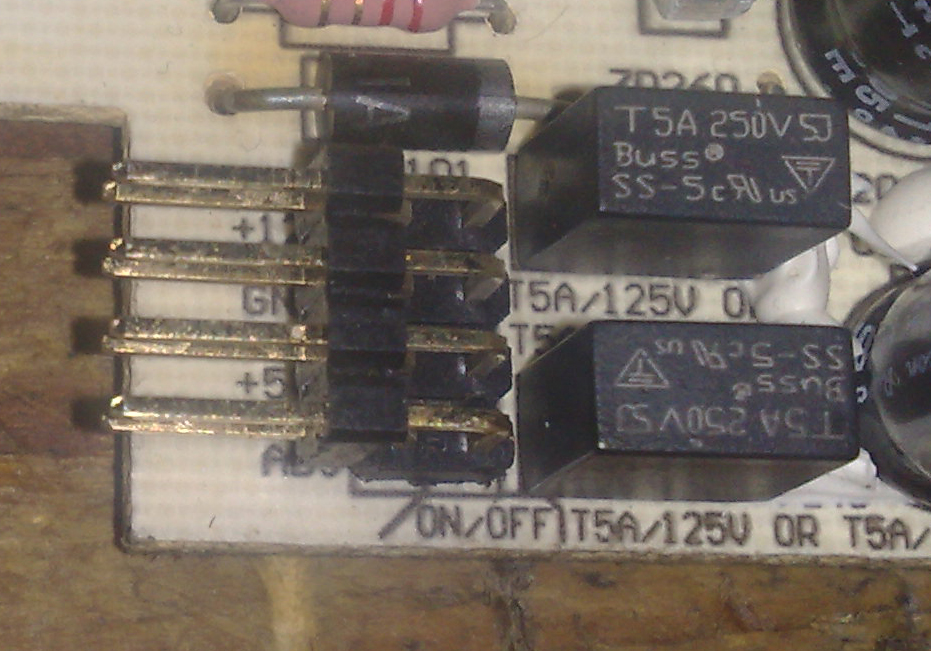

Help me troubleshoot this power supply. FSP043

    Okay, I hooked up the power board and the video board, verified that the voltages coming out of the power board were the same as previous ... i.e. 11.78, 11.78, 5.15, 4.85, and took the voltage measurements of the LM1117L voltage regulator on the video board... Here are the numbers:
    black to pin 1, red to pin 2 : 1.25v
    black to pin 1, red to pin 3 : 2.44v
    black to pin 2, red to pin 3 : 1.18v
    ... an easy test if we can find the right pins is to test the secondary windings on the inverter transformer. My guess would be that there are two secondaries one at each end of the transformer.
    Is there anyway that I could check the main SMPS transformer first? Remember the 5v rails on the power board are reading the same as a working power board. It is only the two DC 12v rails that are reading approx 1v below the working power board. I understand what people are saying about that 11.78v is within the 12v +/-5%, but it just seems wrong to me..

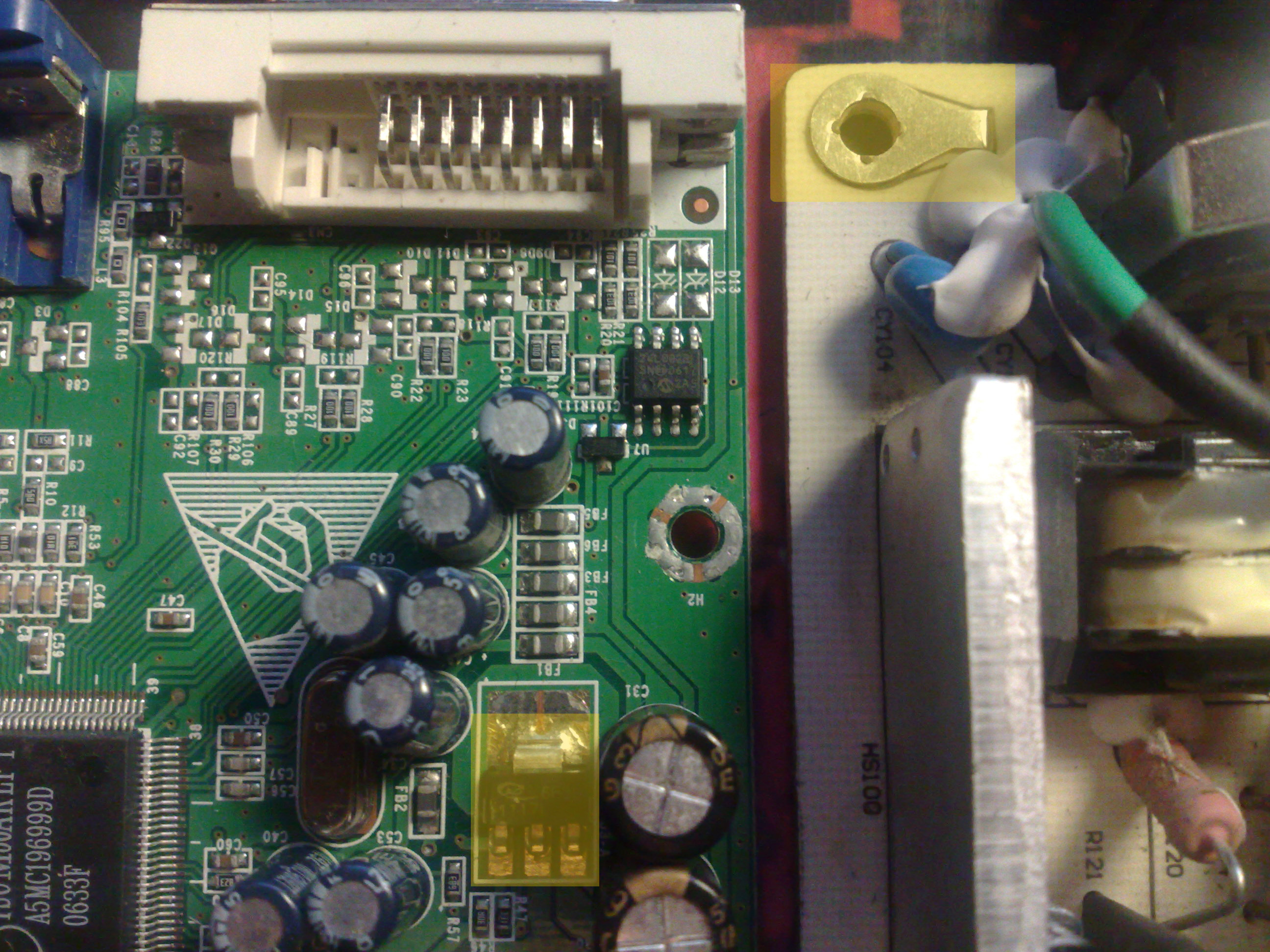

        Because the voltage regulator is surface mounted, there are no pins on the rear side of the board. So when it is in it's metal casing I have no way of connecting to the voltage regulator... Could I use connection on the power board where the big screw goes in ... (both regulator and screw hole are highlighted in yellow on the image below).
        http://omg.wthax.org/17072012826_copy.jpg

              You can measure to that screw hole marked "H2". Black lead in it, red lead in the 1117 pins.

                Okay voltages between LM1117L and cold ground H1.
                PIN1 - GND : 2.09V
                PIN2 - GND : 3.35V
                PIN3 - GND : 4.55V
                While I had the video board hooked up to the PS for this test, I measured the voltage across the power supply's 12V DC output which feeds the video board and it read 12.15V.. It reads as 11.78V without load. Maybe it is working and I just need a new video board..
                If I could get the BL_ON signal and test the backlight it would confirm it.

                  The 1117 voltages seem to be ok. It is converting 5V to 3.3V. I agree with the idea of testing with a known good video board. Didn´t you say that you had another display of the same model ?

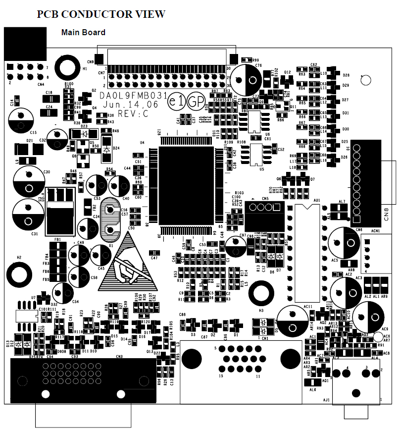

                            I wasnt gonna troubleshoot the Video board, but I've found the service manual for the DAOL9FMB031, so I'll give it a shot .. This is the board layout
                            http://omg.wthax.org/DAOL9FMB031_Schematic.jpg
                            And this is the flowchart of troubleshooting the board.
                            http://omg.wthax.org/DAOL9FMB031_Troubleshooting.jpg

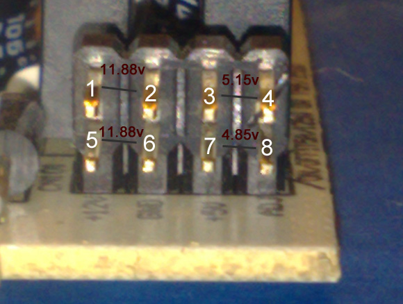

                                    I thought those 8 pins were just for providing power to the VGA board, I didnt realise the backlight on signal was sent through here..
                                    This is a capture of the pins from above
                                    http://omg.wthax.org/powerconnections.jpg
                                    And the voltages I measured across those pins earlier with the MM.
                                    http://omg.wthax.org/measured_voltages.jpg
                                    I see the words ADJ and ON/OFF beside the 5v rails, I'm assuming that it's the ON/OFF which seems to be the bottom pins.

                                      Connect pin 4 to +12v through a 1k resistor, and see if the psu turns on.
                                      When you do it, keep the video board disconnected from the psu, but keep the ccfls connected. See if the ccfls will light up.

                                        Okay ben (and thanks for your help so far, really learning a lot) I've created a 1k circuit on my breadboard and connected two jump wires from it to the two pins mentioned above. The backlight flicks on for a fraction of a second (while the pins touch) and then goes off.
                                        I'm unsure as to whether you meant to connect them or to just jump the pins give a 1 to switch on? (trying to be careful)

                                          Ah, it appears there is a problem in the backlight inverter.
                                          Does the power supply turn off too(measure its output voltage(s) if your not sure)? Or, does the backlight not work until you disconnect and reconnect the resistor to the BL_ON pin?
                                          Yes, we are sending it a '1', to tell it to turn on the backlight. The resistor will limit the current when [if] you touch the wrong pin.
