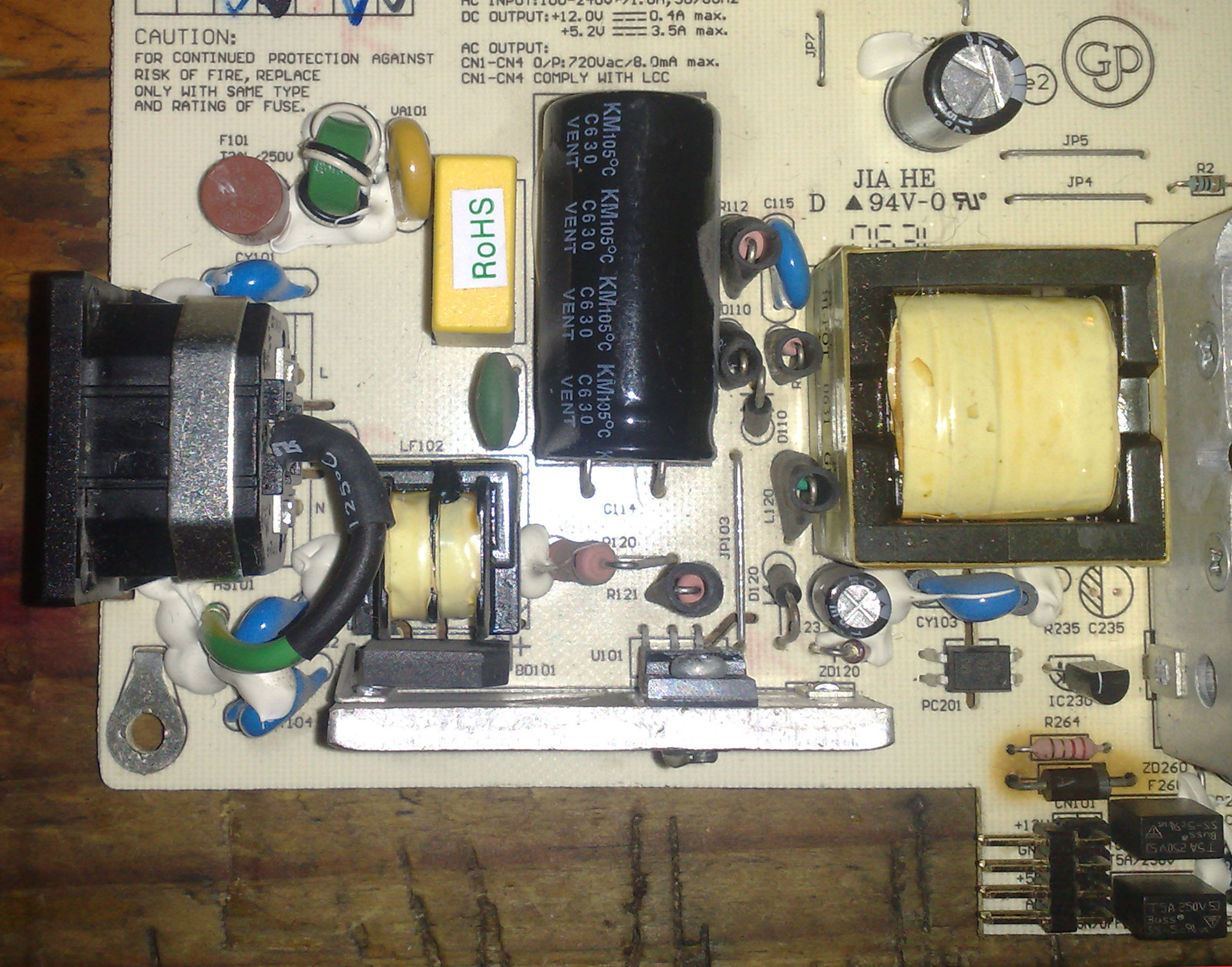

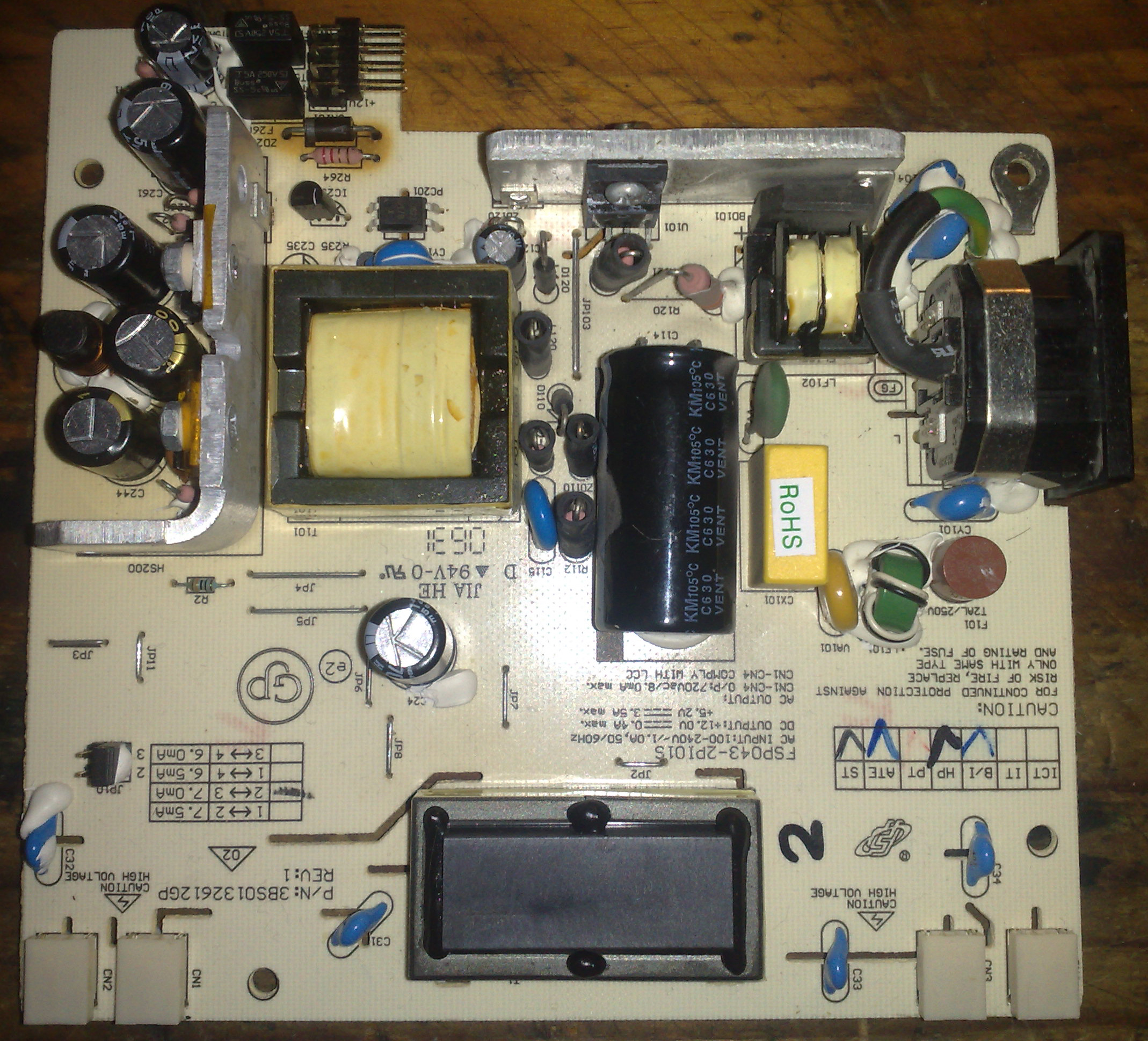

                              #54
                              Re: Help me troubleshoot this power supply. FSP043
                              Photo of power board.
                              http://omg.wthax.org/powerboardoverhead.jpg
                              This is the schematic from my original post..
                              http://omg.wthax.org/FSP043.jpg
                                #55
                                Can we have a better picture of the bottom? There are some tiny resistors on the bottom which I want to read.
                                Muh-soggy-knee

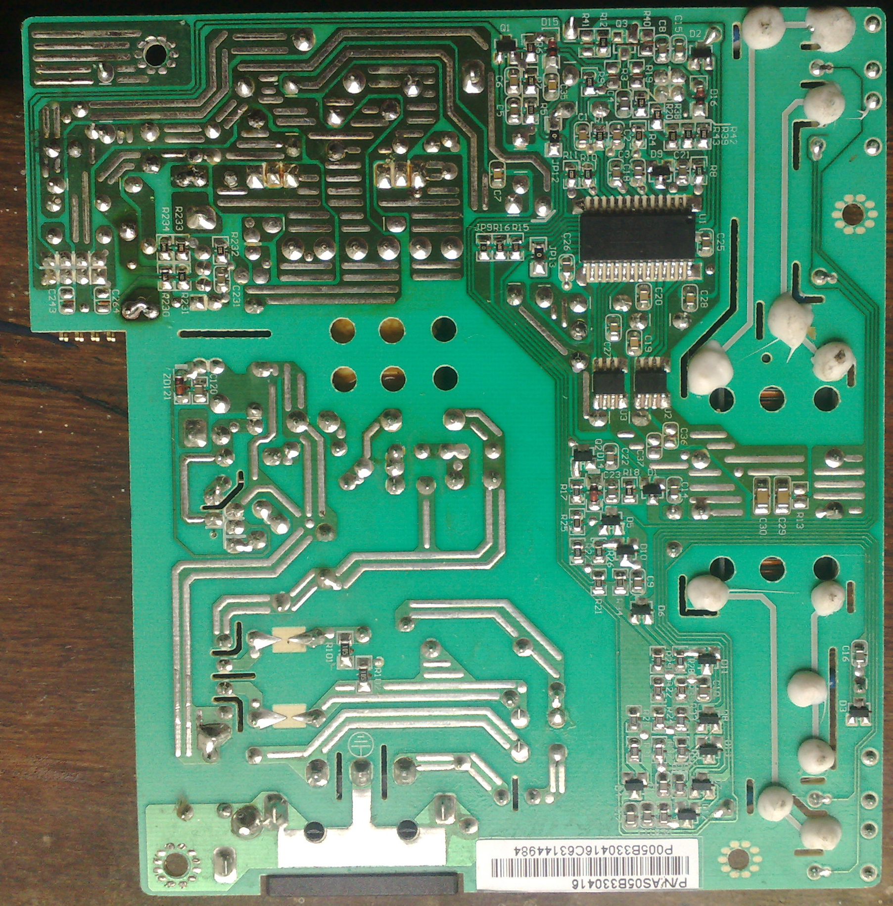

                                  #56
                                  Bottom Left:
                                  http://omg.wthax.org/powerboard_bottomleft.jpg
                                  Bottom Right:
                                  http://omg.wthax.org/powerboard_bottomright.jpg
                                  The bits are packed quite tight together so it's hard to get the detail without taking the picture from directly above the component.
                                    #57
                                    Bottom Left:
                                    Bottom Right:
                                    No, I meant the underside of the board, the "bottom".
                                    Muh-soggy-knee
                                      #58
                                      http://omg.wthax.org/back_board.jpg
                                      btw, am I wrong in thinking that measuring the voltages across the caps all the way along (both ceramic and electrolytic) is a good way of tracing the signal across the board? What I was thinking of doing was measuring the voltages across all the caps and enter the information on to the schematic (with photoshop)... It should be pretty easy to diagnose with that shouldnt it??
