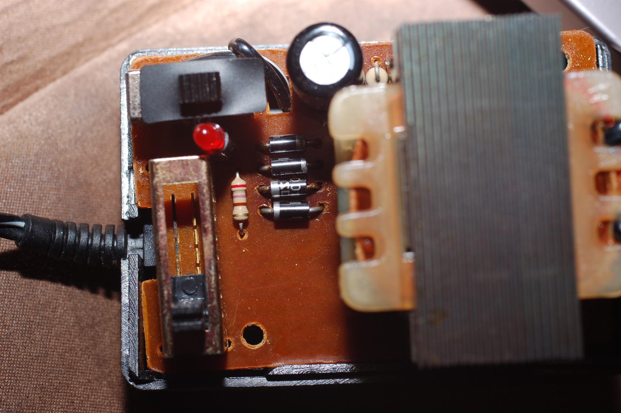

    hello, this is probably simple, but I searched and didn't find a thread with this specific repair, so I thought if nothing else, I'll document mine.
    This is a variable voltage output wall wart power supply, with reversible polarity. It was mainly used for a power supply for audio pedal boards. It has died. This could go under audio, I suppose, but because it is a universal power supply, I thought this section to be better.
    This was my friends, and the cord looks like a candy cane its so twisted... Maybe there's a short there somewhere.
    When I plug it in, there is no voltage to any of the optional tips.

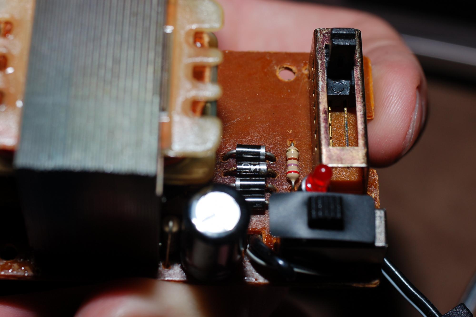

    I opened it up (after fabricating a split flat screw driver tip with a dremel tool and an old flat screw driver bit) and it looks pretty simple. A transformer, 4 diodes, 1 capacitor 25v 1000uF , and 2 resistors. A switch for dc voltage output and a switch for +- polarity reversal.
    I have no idea whats wrong with it. Diodes in circuit read 460v 459v 464 and 464v respectively. reverse reads 598 598 602 and 602v respectively.
    Caps not bulged. ESR meter won't be here until next week.
    Any thoughts on where to begin on this would be appreciated. I don't know how to test the transformer...

    Re: Select-able wall wart power supply - dead
    Minor nit. Those readings are millivolts or 0.460V.
    All those readings suggest all 4 diodes are shorted. A good diode should read between 0.3 and 0.7V one way and 0L (out of range) the other way.
    Desolder all 4 and remeasure out of circuit to verify.

        i would unsolder one leg of each diode and re test them

                          Check the resistance of the primary winding of the transformer, if it is O/C then the transformer is dead (has overheated)
                          Muh-soggy-knee
                          • ajsemtb
                            • Jul 2010
                            • 79
                            There are about 7 wires that come off this transformer. Which 2 are the primary pair?

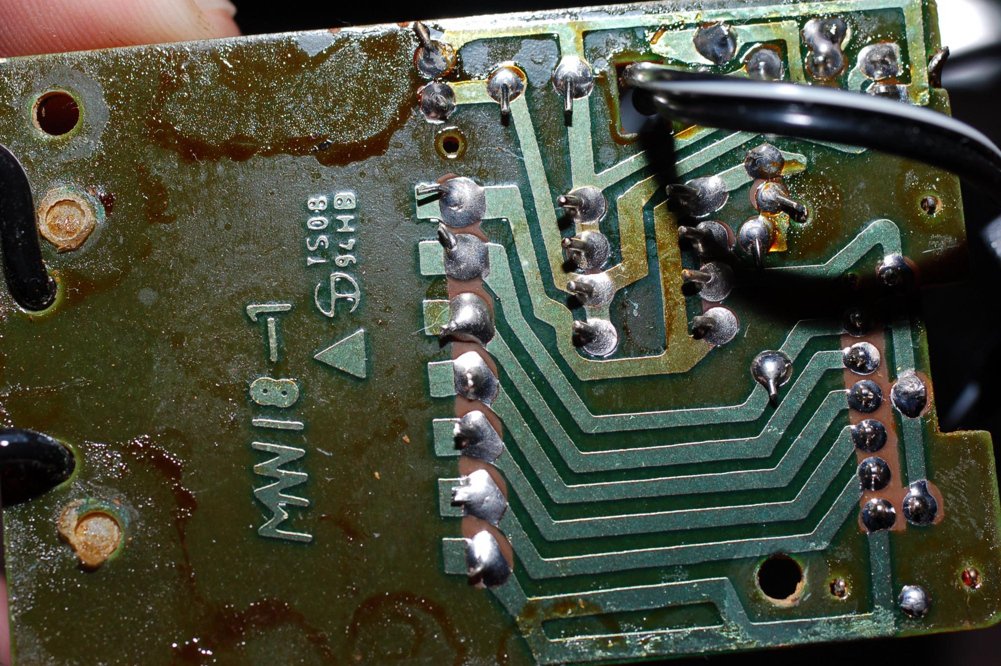

                              The two black wires on the left of the picture #2 which should go to the AC prongs are the primary winding.
                              If it is open, there should be a thermal fuse under that red tape on the transformer.
                              • ajsemtb
                                • Jul 2010
                                • 79
                                Ac prongs are open. No tone on continuity test open ohm reading. However all prongs that come off the bottom of it are shorted. They all have continuity which I would Imagine is bad... lol
                                • ajsemtb
                                  • Jul 2010
                                  • 79
                                  Oh and diodes are good.

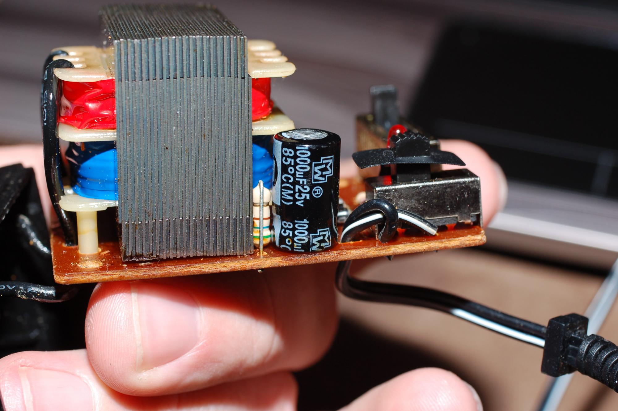

                                    If you always leave this wall-wart plugged into the outlet, that power supply would have been running 24/7, so it will exposed to any surges/spike/over voltage/under voltage all day long.
                                    • ajsemtb
                                      • Jul 2010
                                      • 79
                                      Yeah, so dead transformer? Is it cheaper to just buy another ps or get the transformer?
                                        Better off getting new PS, and unplug it when not in used.
