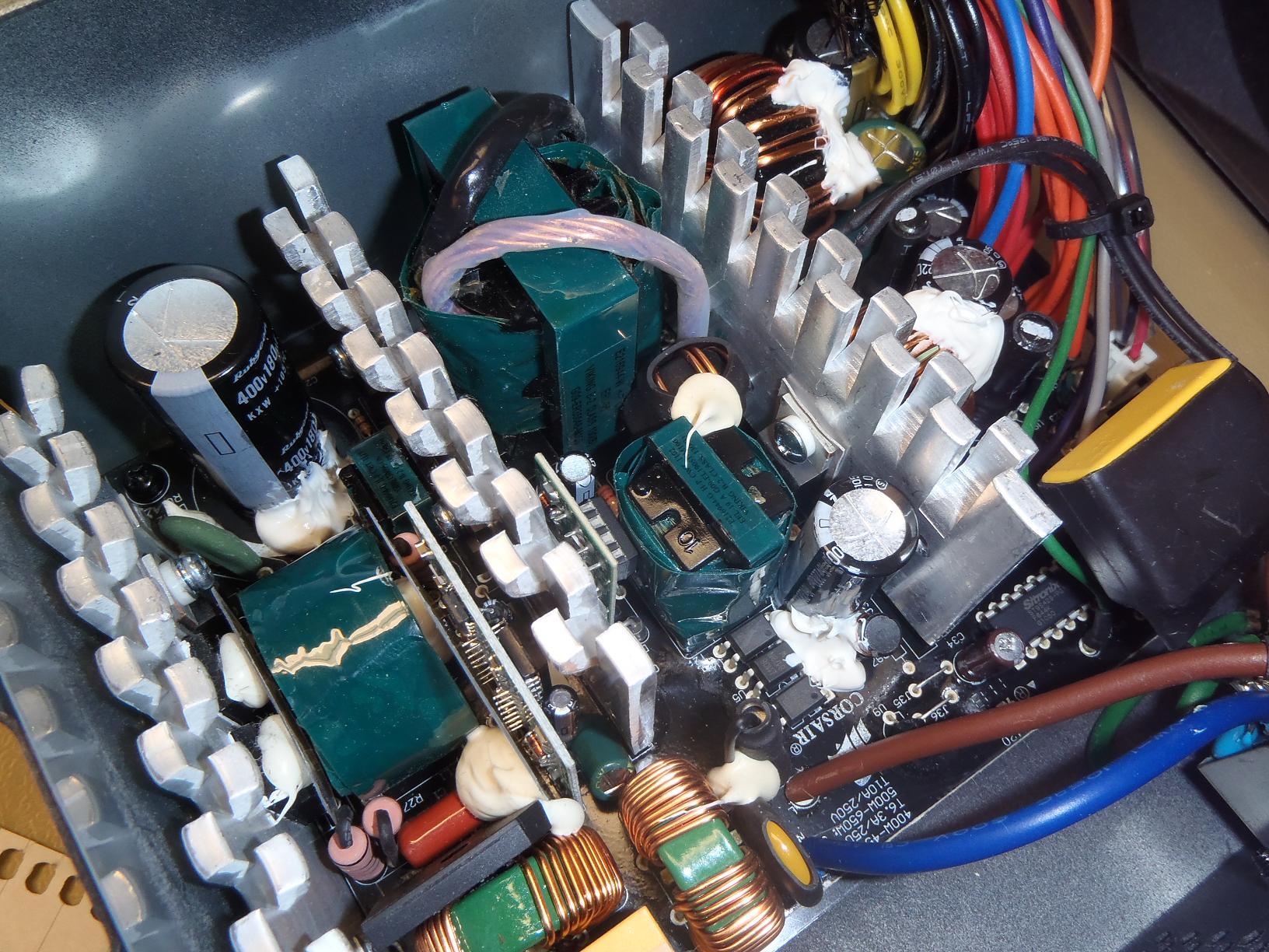

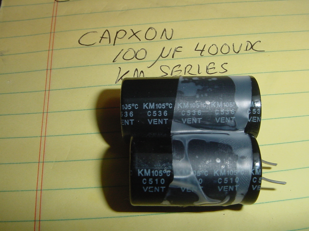

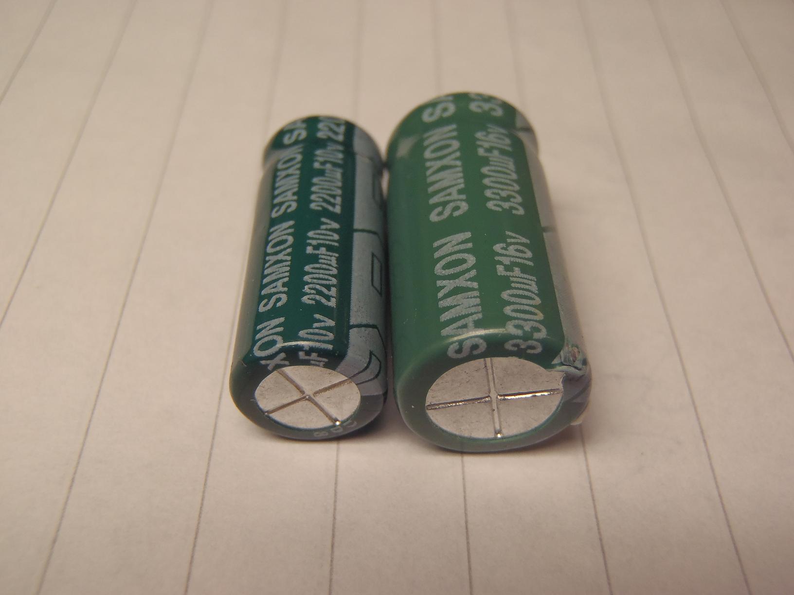

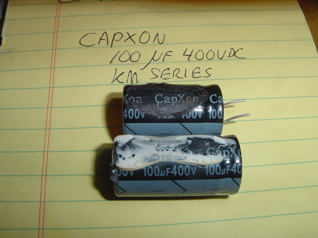

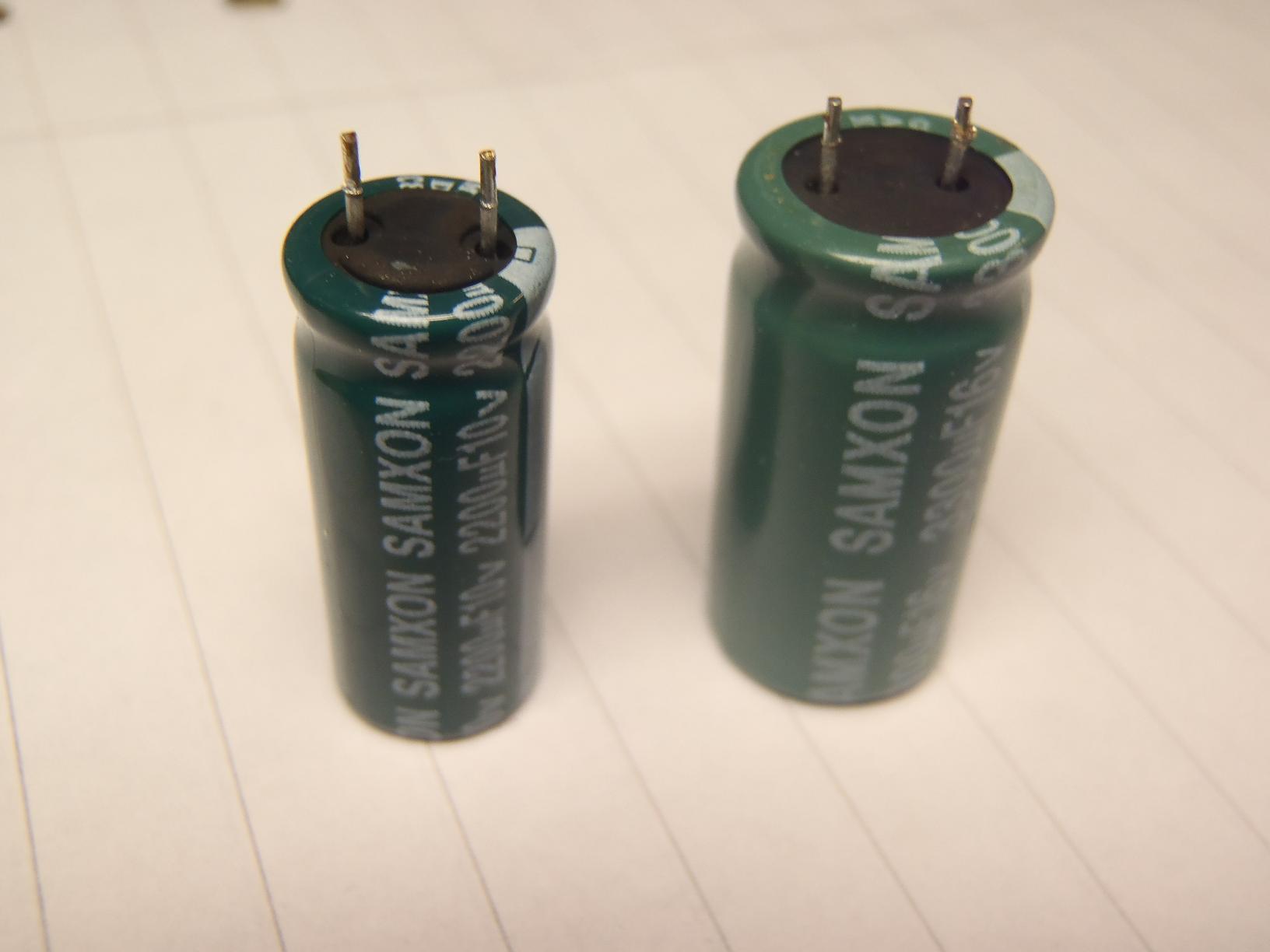

Fake SAMXON cap in Corsair PSU?
  • imp
    • Aug 2010
    • 125
    • Sweden
    Fake SAMXON cap in Corsair PSU?
    I´ve just recapped (and fixed, more of this later) my Corsair CX430 V2 power supply, and found one of the capacitors not looking like the rest in the SAMXON GF series. Please see attached photos.
    All the GF's are dark green and one is light green. The difference is greater in reality compared to the photos. Also, the bung is different. Might this one (the 3,3mF) be a fake you think...?
    NONE of the caps was within limits when tested with a professional bench LCR-measuring device, especially the small Jun Fu 1uF 50V had an ESR of whopping 3 kohms. The SAMXON's were either low on capacitance and/or high ESR. None had bulged. The power supply has been in light use for about eight months 24/7 prior failure. The symptom was that the computer didn´t start at all, only the fans and hard drive spun up.
    I´ve recapped it with various Rubycon ZLJ's, Panasonic FM, Suncon WX, ELNA's and UCC for the small caps. That´s what I had available at the time... Want to see the end result to? OK, I´ll attach one more photo
    What do you think?
  • Rob Northen
    • Jan 2010
    • 137
    • Denmark
    Re: Fake SAMXON cap in Corsair PSU?
    I don't think they are fake. Samxon is cheap shit. They probably just used what ever bongs there where cheapest that week.
    • imp
      • Aug 2010
      • 125
      • Sweden
      Re: Fake SAMXON cap in Corsair PSU?
      I don´t like the SAMXON either, I replace them on sight, especially the GF series. But why is one of the capacitors so different from the others?
      • lti
        • May 2011
        • 2557
        Re: Fake SAMXON cap in Corsair PSU?
        I noticed the same thing with two Samxon caps I removed from a cheap label printer. They actually had the same bung styles shown in the picture (one perfectly flat, one with a raised portion between the leads). I posted the pictures here.
        • c_hegge
          • Sep 2009
          • 5219
          Re: Fake SAMXON cap in Corsair PSU?
          Samxon are often inconsistent with their designs, so this comes as no big surprise. If you think the CX series use bad caps, wait for the VS series!
            Re: Fake SAMXON cap in Corsair PSU?
            Well CrapOn is not any better, both of them has the same value, same series, same diameter, but they are not the same length. May be they ran out of the large cans, or they just fake the smaller one as the big one.
            • dmill89
              • Dec 2011
              • 2534
              Re: Fake SAMXON cap in Corsair PSU?
              Originally posted by c_hegge
              Samxon are often inconsistent with their designs, so this comes as no big surprise. If you think the CX series use bad caps, wait for the VS series!
              Funny, I remember when all of Corsair's PSUs were made by SeaSonic and were of top quality (even the budget models). Man have they gone downhill fast! First they went to CWT, but still used decent components. Then they started to cheap out on the components, especially in entry level units. What's next? Maybe L&C, ATNG, SunPro, or Yuelin at the rate they are going.
              Last edited by dmill89; 05-04-2012, 10:07 PM.
              • c_hegge
                • Sep 2009
                • 5219
                Re: Fake SAMXON cap in Corsair PSU?
                Well, I've had a sneak peak at the up and coming Corsair VS450W. It's made by CWT, but the PFC cap and a few of the output filters were made by Jun Fu!
                • imp
                  • Aug 2010
                  • 125
                  • Sweden
                  Re: Fake SAMXON cap in Corsair PSU?
                  Originally posted by lti
                  I noticed the same thing with two Samxon caps I removed from a cheap label printer. They actually had the same bung styles shown in the picture (one perfectly flat, one with a raised portion between the leads). I posted the pictures here.
                  Yup, I recognise that post Inconsistancy in production at it´s "best"
                  • imp
                    • Aug 2010
                    • 125
                    • Sweden
                    Re: Fake SAMXON cap in Corsair PSU?
                    Originally posted by c_hegge
                    Well, I've had a sneak peak at the up and coming Corsair VS450W. It's made by CWT, but the PFC cap and a few of the output filters were made by Jun Fu!
                    Wonder what the retail price of the VS series will be then ... The CX430 V2 cost about $50 US here in Sweden and the design itself is pretty decent IMHO; stable voltages on the output, high efficiency and more. I think it will do great after the cap upgrade I made.
                    If < $50 and what can you expect at all then? It´s brave of Corsair if they still stick to the three year warranty, like with the CX series with perhaps even LOWER quality components.
                    • b700029
                      Banned
                      • Sep 2010
                      • 640
                      Re: Fake SAMXON cap in Corsair PSU?
                      Originally posted by budm
                      Well CrapOn is not any better, both of them has the same value, same series, same diameter, but they are not the same length. May be they ran out of the large cans, or they just fake the smaller one as the big one.
                      Have you measured their capacitance? The date codes suggest the shorter one was made before the longer one.
                      • dmill89
                        • Dec 2011
                        • 2534
                        Re: Fake SAMXON cap in Corsair PSU?
                        Originally posted by c_hegge
                        Well, I've had a sneak peak at the up and coming Corsair VS450W. It's made by CWT, but the PFC cap and a few of the output filters were made by Jun Fu!
                        Doesn't surprise me much. CWT uses Jun Fu on other units they OEM. Most of the CWT built Thermaltakes have JunFu on the secondary (I've got a TR2 550W that has Rubycons on the primary and JunFu everywhere else, I only use it for testing so I haven't recapped it yet but I probably will when I get board someday). Of course if Corsair goes this route and keeps the 3 year warranty they may end up with a ton of RMAs like Antec did with the SmartPower/TruePower series.
                        Originally posted by imp
                        If < $50 and what can you expect at all then? It´s brave of Corsair if they still stick to the three year warranty, like with the CX series with perhaps even LOWER quality components.
                        I don't necessarily expect high quality Japanese caps at that price point, but I at least expect some mediocre Taiwanese caps like Teapo, OST, Ltec, or SuScon. Those might not be the best but they at least have a chance of lasting a few years. There is no excuse for using crap like JunFu ("cough" Fuhjyyu) that is virtually guaranteed to fail.
                        • RJARRRPCGP
                          • Jul 2004
                          • 6304
                          Re: Fake SAMXON cap in Corsair PSU?
                          Are you saying that Corsair has model confusions like CoolMax seems to.
                          (Where V-500 isn't better than its other models, if not worse.)
                          (And IIRC, the V-500 is a "500 divided-by-2" or roughly that!)
                          Where VS450 is inferior to CX430?!
                          Appears that's the same tactic that CoolMax uses.
                          ASRock B550 PG Velocita
                          Ryzen 9 "Vermeer" 5900X
                          Arc A770 16 GB
                          eVGA Supernova G3 750W
                          Alienware AW3423DWF OLED
                          • mariushm
                            • May 2011
                            • 3799
                            Re: Fake SAMXON cap in Corsair PSU?
                            The VS450x is 230v only, and I believe they're only to be sold in Asia... but who knows.
                            Yeah, on these budget power supplies they're gonna cheap out on capacitors.
                            • Shocker
                              Banned
                              • Dec 2011
                              • 635
                              Re: Fake SAMXON cap in Corsair PSU?
                              Originally posted by c_hegge
                              Well, I've had a sneak peak at the up and coming Corsair VS450W. It's made by CWT, but the PFC cap and a few of the output filters were made by Jun Fu!
                              That's very scary. Perhaps CWT is playing name games with capacitors, hoping people don't know the connection between Fuhjyyu and Jun Fu...
                              EDIT: So Corsair is the new Antec???
                              • dmill89
                                • Dec 2011
                                • 2534
                                Re: Fake SAMXON cap in Corsair PSU?
                                Originally posted by Shocker
                                That's very scary. Perhaps CWT is playing name games with capacitors, hoping people don't know the connection between Fuhjyyu and Jun Fu...
                                EDIT: So Corsair is the new Antec???
                                Or I suppose Corsair would be the new old Antec since Antec hasn't used Fuhjyyus, or CWT for that matter, for several years now. In fact Antec's higher end models (HCG and HCP) use 100% Japanese caps now.
                                It is almost the exact opposite course of events between the two. Antec PSUs started out pretty poor and got progressively better. Corsair PSUs started as some of the best around and have gotten progressively worse.
                                • Behemot
                                  • 4845
                                  • CZ
                                  Re: Fake SAMXON cap in Corsair PSU?
                                  I would say people bashing Samxon are just stupid idiots or trolls. It has been proved beyond all doubts Samxon is good brand over the last what, five years? I use them on my own for liek three years now.
                                  The thing is, their GF series is nothing spectacular. On the other hand, neither is Chemi-Cons KZG, right?
                                  • Rob Northen
                                    • Jan 2010
                                    • 137
                                    • Denmark
                                    Re: Fake SAMXON cap in Corsair PSU?
                                    Originally posted by Behemot
                                    I would say people bashing Samxon are just stupid idiots or trolls. It has been proved beyond all doubts Samxon is good brand over the last what, five years? I use them on my own for liek three years now.
                                    The thing is, their GF series is nothing spectacular. On the other hand, neither is Chemi-Cons KZG, right?
                                    There is nothing wrong in beeing cheap.
                                    Just like there is nothing wroong in buying caps of Ebay and then come complain here when you see they are fake ...
                                    • Behemot
                                      • 4845
                                      • CZ
                                      Re: Fake SAMXON cap in Corsair PSU?
                                      Well I buy only caps with good enough photos from eBaywhere I would recognize them being fakes. Last time boguht 1000 of 1000uF Rubycons MBZ. Capacitance still arround 750 uF what is pretty good considering they have been unused since they have been made back in 2005
                                      An oh, no, Samxon's are not cheap. Comparable Chemi-Cons are much cheaper from Digi-Key. The thing is, I can order for as much as 200 USD only like once a year to not pay another 70 USD for postage
                                      • ben7
                                        Capaholic
                                        • Jan 2011
                                        • 4059
                                        Re: Fake SAMXON cap in Corsair PSU?
                                        imp, you might want to replace the Elna's you put in there, Elna is a good mfg, but their caps are not rated for low esr, and high temps.
                                        -Ben
                                        Muh-soggy-knee
                                        • h0m3w0rk
                                          Random Shutdowns/Startup Failure with Corsair SFX 450
                                          by h0m3w0rk
                                          I'm encountering a frustrating issue with my Corsair SFX 450 power supply. After an undefined period of operation, my PC will either suddenly restart or, in some cases, it won't start at all until I disconnect the power cable and reconnect it. This erratic behavior occurs intermittently, making it difficult to pinpoint the exact conditions under which it happens.
                                          For context, I have tested the PSU using an electronic load at 150W, and under those controlled conditions, it functions flawlessly. This leads me to...
                                          02-09-2025, 03:19 AM
                                        • paparazzo79
                                          Fake magsafe 2 charger
                                          by paparazzo79
                                          Hi guys.I bought Macbook Pro mid 2014 15 inch model which did not came with charger.
                                          I got new charger but judging by the specs seems it is fake one.Sadly I live in Bosnia and genuine charger is rare to find.
                                          what to do?Should I use the fake one?
                                          Will it damage the macbook?...
                                          10-02-2024, 08:18 AM
                                        • Galraedia
                                          Fake Caps in Xbox 360
                                          by Galraedia
                                          I decided to take one of the Rubycon capacitors out of a phat Xbox 360 with a Zephyr motherboard and noticed that all the Rubycon capacitors near the CPU were fake. The capacitors in question are Rubycon MFZ 680uf 6.3V and they all have a bullseye bottom, something not found in genuine Rubycon capacitors. None of them were leaking, they all have the K top, and the system has never been opened before. It appears Microsoft was using fake capacitors in the Xbox 360, or the Chinese facility where the console was manufactured in was using them and passing them off a genuine. Just thought I'd share...
                                          02-04-2023, 09:55 PM
                                        • chth96
                                          Can I replace KME cap with Samxon GF cap?
                                          by chth96
                                          Hello.
                                          I have 29inch LG CRT TV,And Yesterday,Whenever I connect AC power cord to power outlet without switch on, I heard a sound like white noise, And When I switched on this CRT TV, It sometime displayed correctly But usually It won't last more than 20 minute and The screen begin to dark and It finally did not display at all for hours..
                                          Today,I dismantled its plastic case and discharged the biggest capacitor(400wv 470uf) which still holds 250 voltage,and I finally detached PCB from cathode-ray tube.
                                          I measured ESR value of most of caps in PCB with MESR-100 and I found that KME(25v...
                                          04-17-2024, 07:11 AM
                                        • coinwizx
                                          Corsair HX1200 connected w EVGA molex cable, 12V pin back feeded to 5V. Anybody has experience in this damages repair?
                                          by coinwizx
                                          The power supply is 2020 Corsair HX1200 modular power supply.
                                          Cause of damage: I connected EVGA molex cable to the Sata port and test it with a ATX tester. Since the pin out on the EVGA is wrong, result in the 12V pin shorted to the 5V pin, in the 12V back-feeded to the 5v port.
                                          Damage: Power supply shorted out, shut off itself internally, damaged the 5v or 3v rail or the monitoring circuitry. The self protection circuit shut off the power supply when power up because it detected some abnormal/defect. I waited a few minutes, let it self reset then try to re power up....
                                          09-15-2025, 12:46 PM
