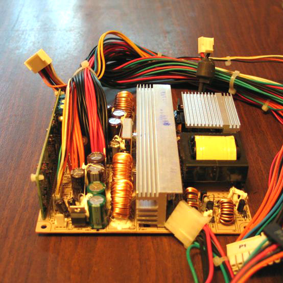

      I would love to see a picture of PSU with good caps inside, so if you stumble upon one, please post. I'm sure most BadCaps members will applaud you!
      See this thread, (scroll down to post 10 in it...)
        Re: Antec 480W "NEO" PSU with Fuhjyyu caps

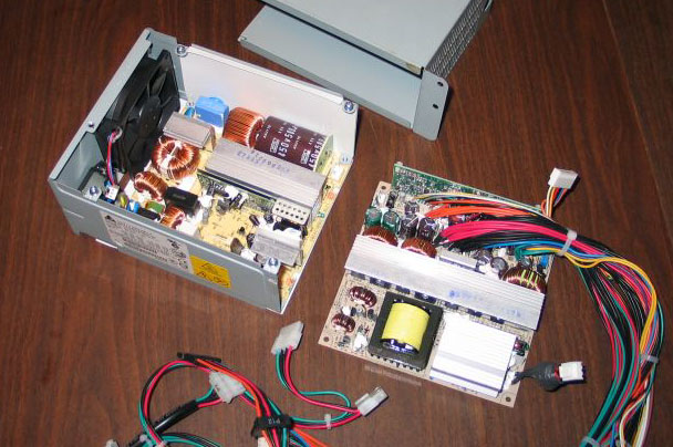

        Here's another, pictures originally from some obscure Russian site...
        Delta DPS-600MB, the same PSU that Intel includes in its server chassis such as SC5275 and SC5300 base model.
        All NCC/UCC, as you can see. Interesting PSU layout too.
          The 380W Delta OEM PSU on a 8-year old HP Kayak also looks somewhat similar - a 2-piece sandwich with cables running between the two halves. That one had Rubycons, Nichicons and Chemicons.
