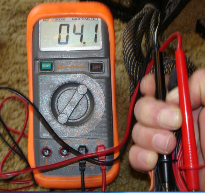

    Hello all!
    I use this one on my stuff so if its not feasible to use it again please do say so!!! EnerMax had warranted it like three times already. I did test the rails before I disassembled it only rail to far out of wake was the red wire 5v rail. It was reading 4.1v, this was only a fan and hard drive on it. If need be I can go back and re test again.........

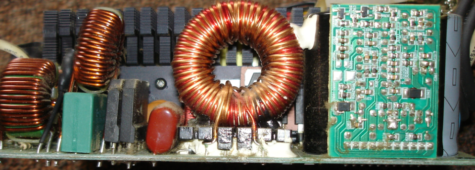

                    Nope, yours doesn't seem to have separate DC-DC converters. Either the parts are bolted to the secondary heatsink or are on the reverse-side of the PCB. A DC-DC board usually looks like this:
                    Your PSU seems to have them as part of the main PCB.

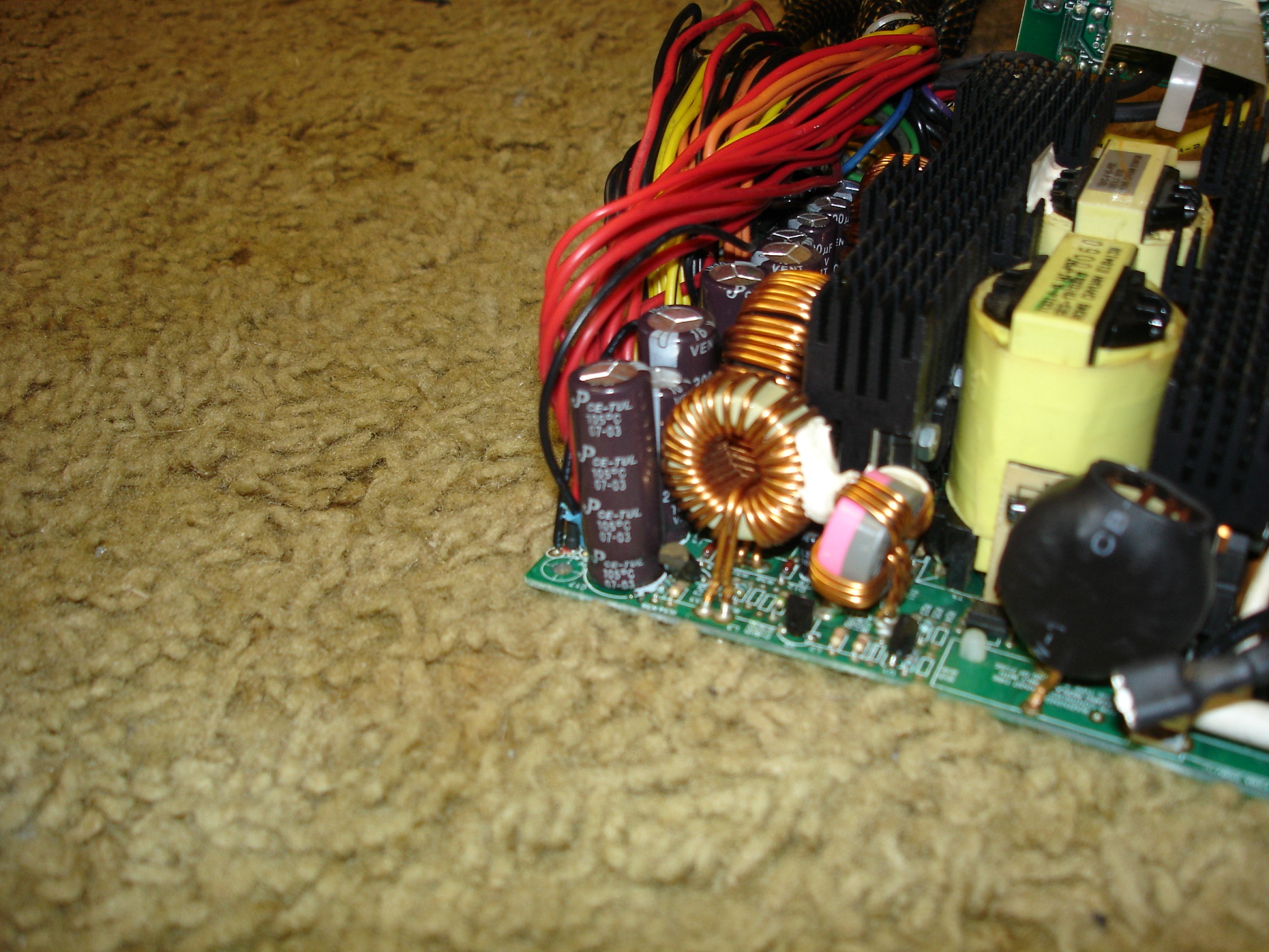

                      I took some of the CAPS on the secondary side there not RubyCons, the two big black caps are Rubycon's but the rest are these. None looks leaky, I got a couple of them big round things like you posted Hegge. But there covered in rubber shrink wrap stuff, I assume just cut it off? Also noticed a couple of heavy gauge wires on the end of the PSU looking like they were touching the heat sink, there sheathing is torn(circled in red).
                      Thanks guys!

                        and I thought you had Chemi-con capacitors (That's what they look like from on top)

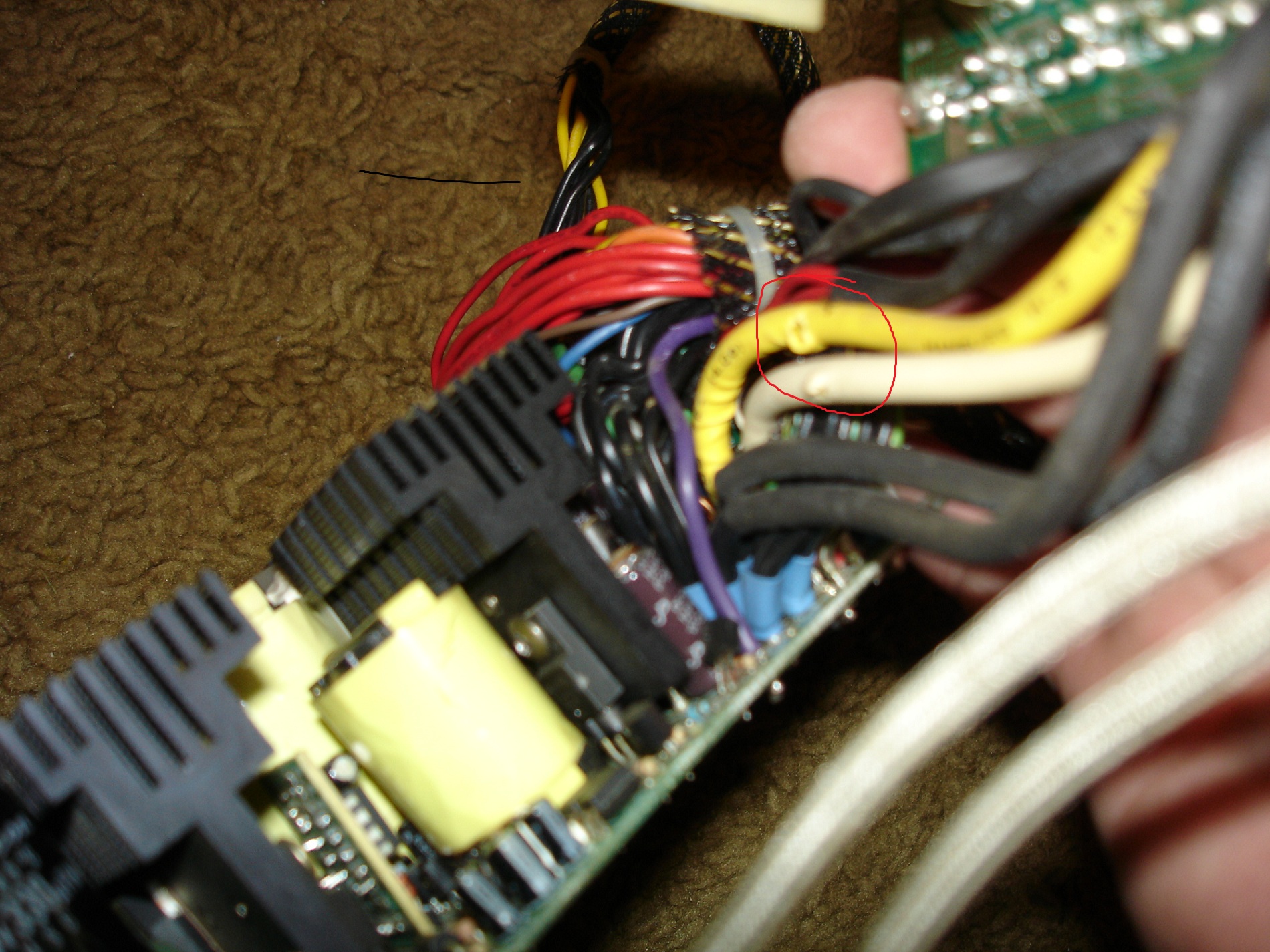

                        I think you can leave the primary side alone. The problem is almost definately with the secondary side. Can you get a good, clear picture of the solder side of the PCB?

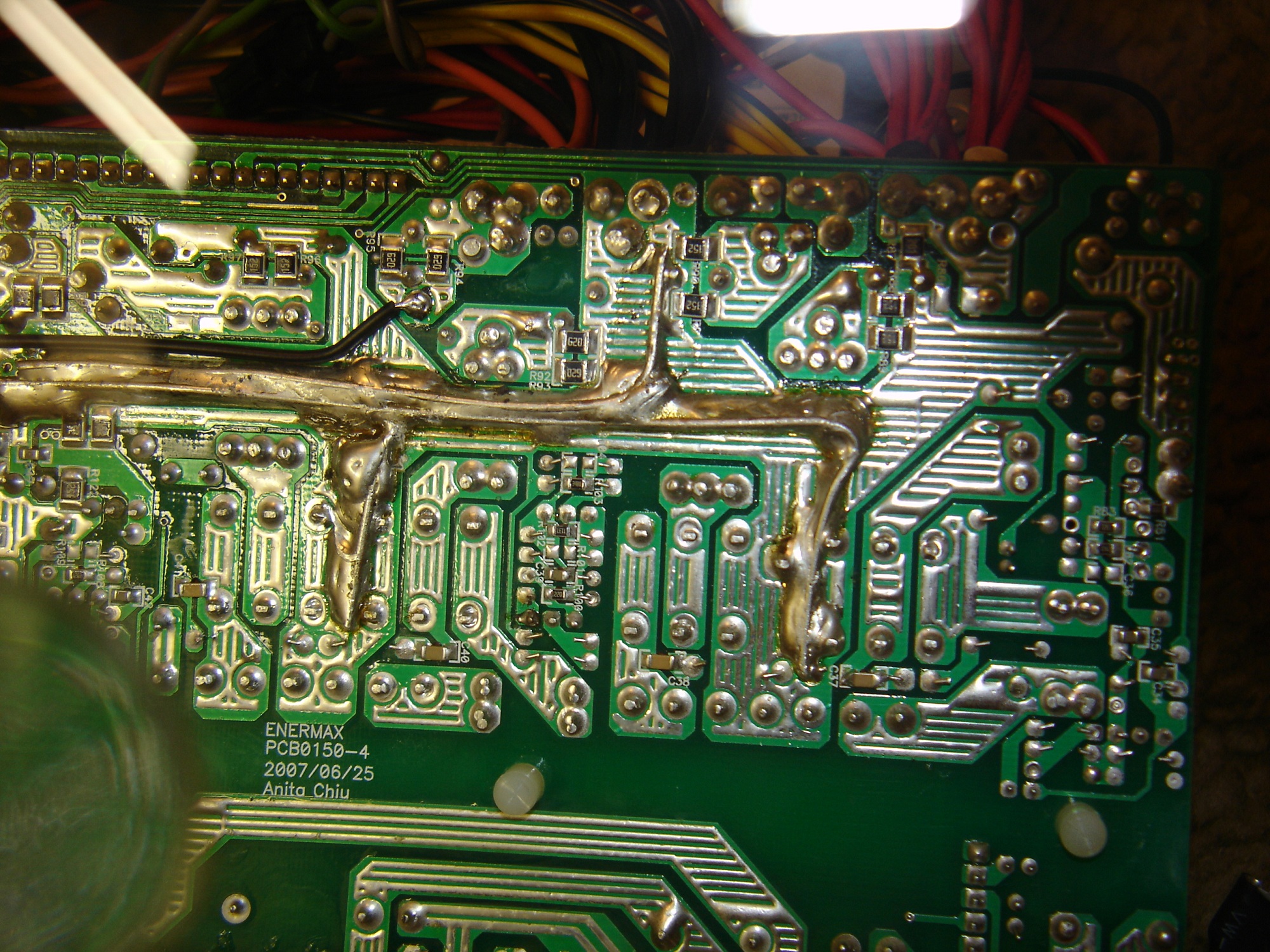

                        I doubt that the damage to the wire is responsible. It's on the 12V. You can put some tape around it if you care to.

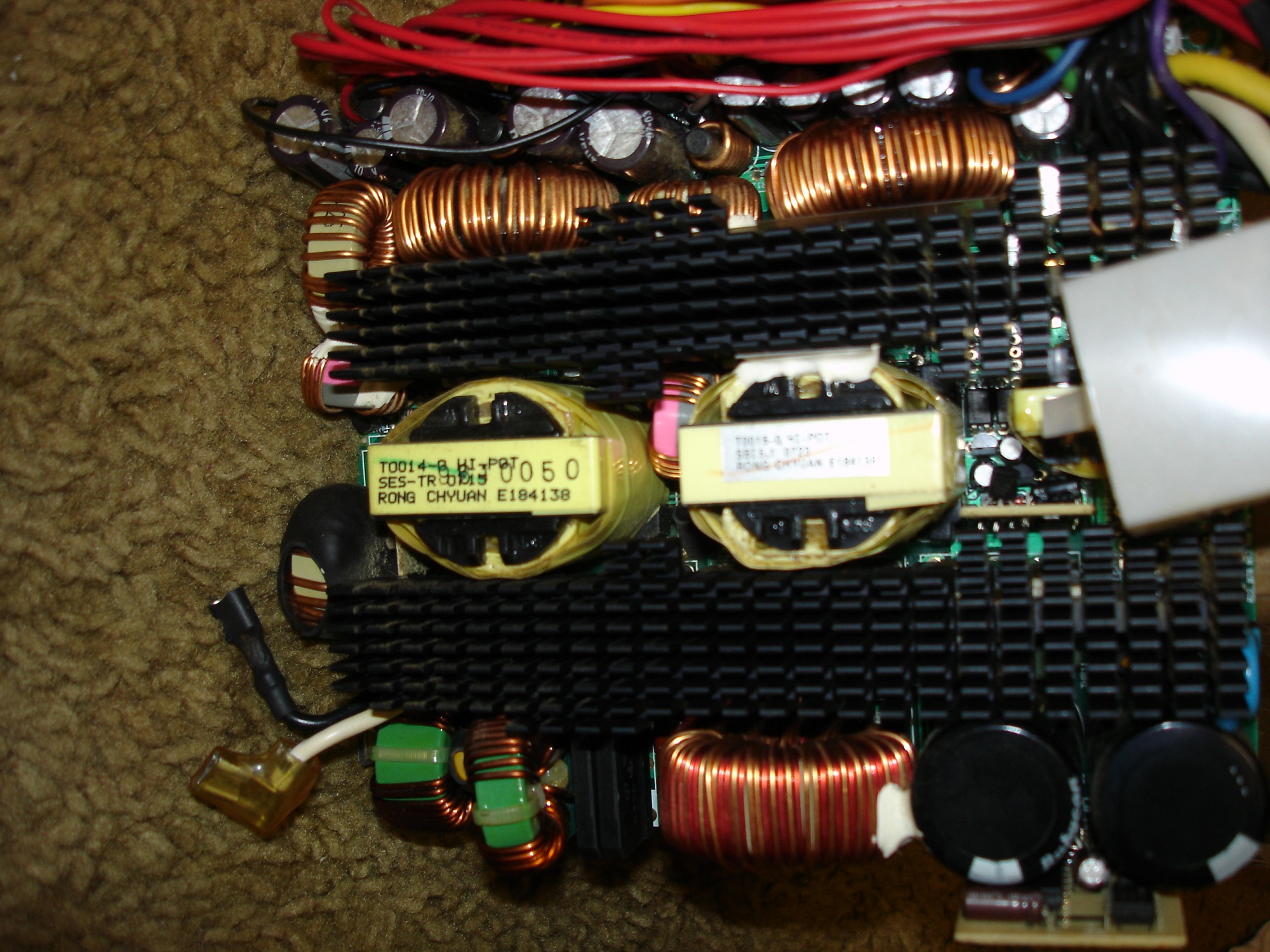

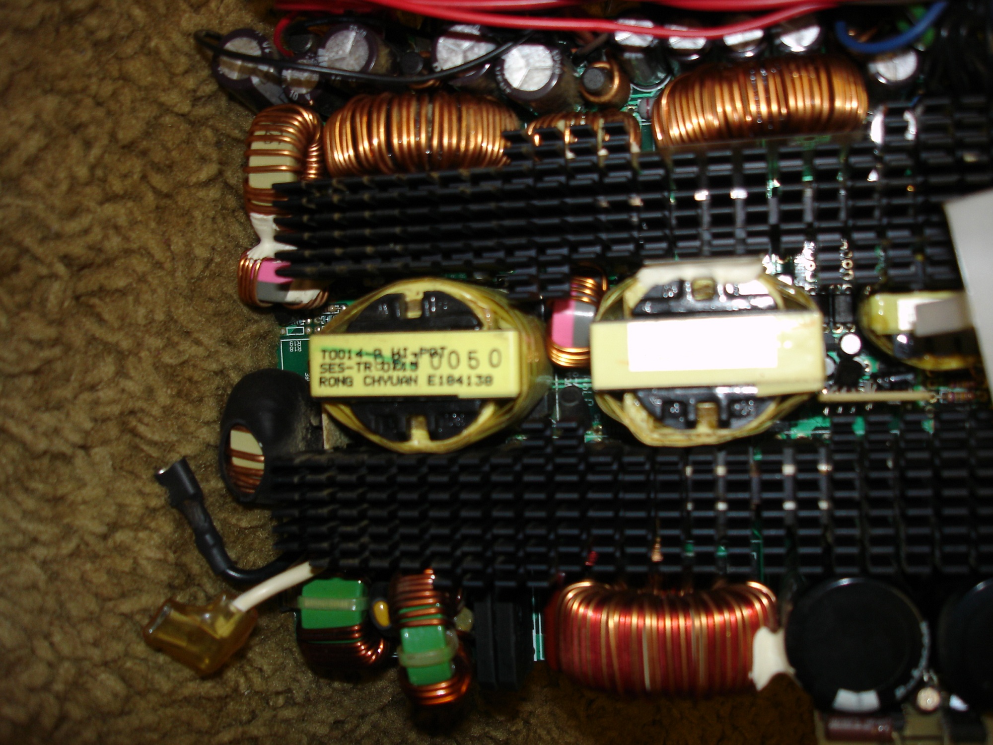

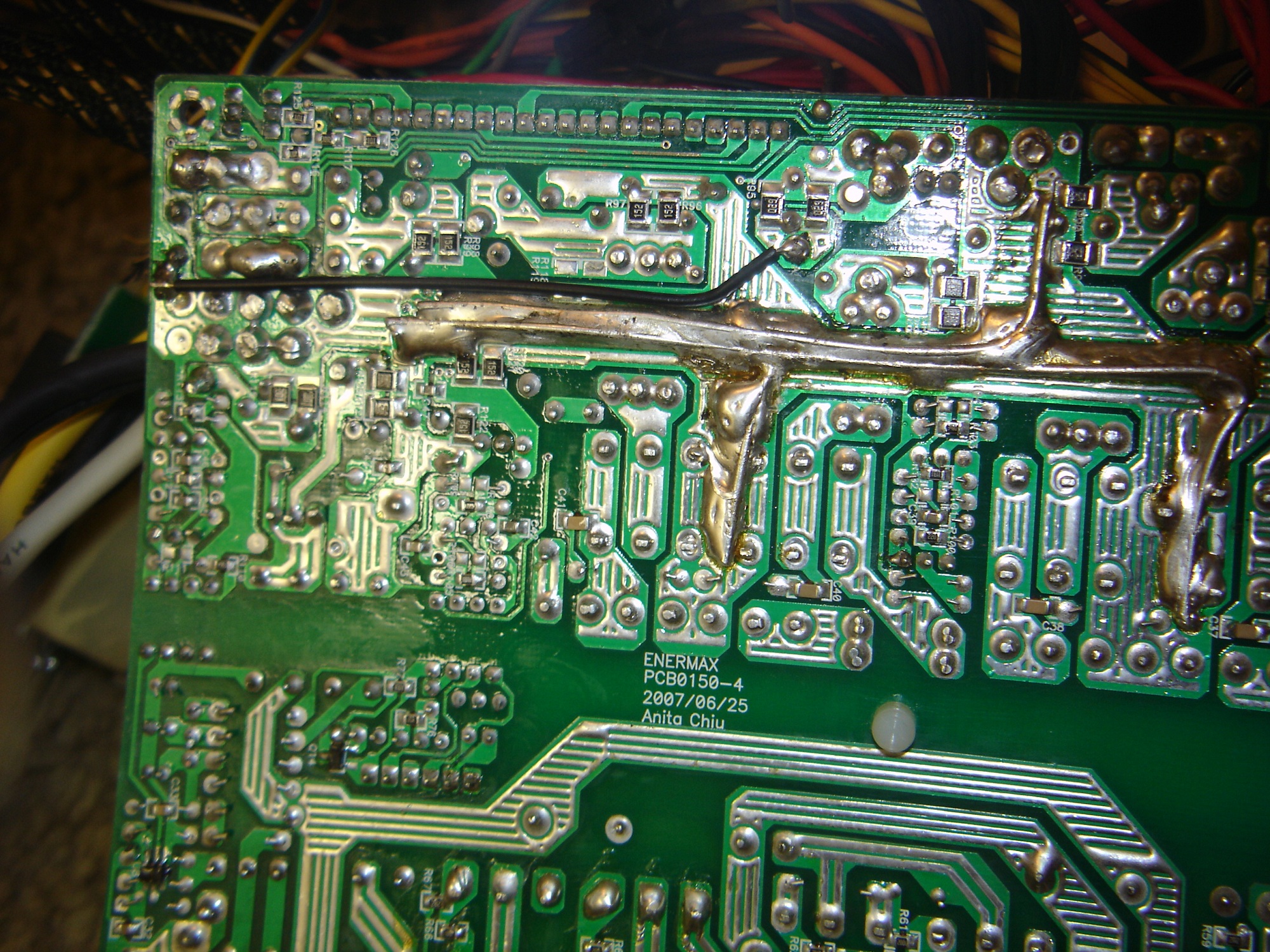

                          I'm not sure why but been having a hard time with good picture's up close, but I can use a magnifying lens. I'll post back,
                          Thank you!
                          Update: see if these will work, that one cap says "CE TUL" on it then the next big one over to the right is mark "VENT" and the back side secondary side.

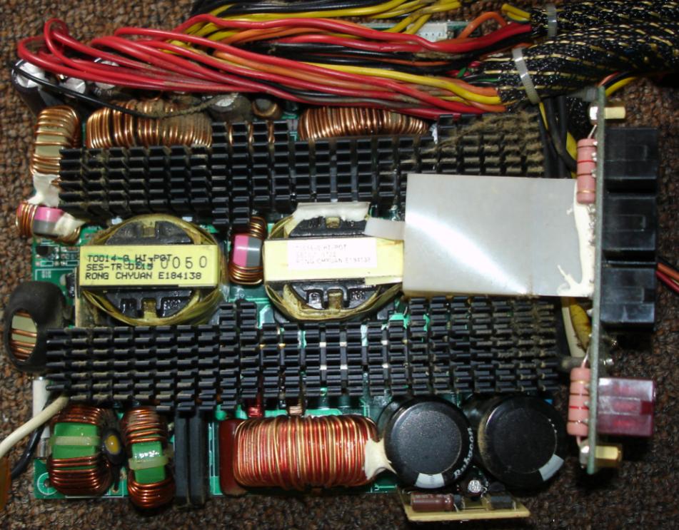

                            OK. Unlike tom66 said, this PSU doesn't use DC-DC conversion, so there is no DC-DC converter to speak of. That means that the problem could be with the transformer (perhaps a partially shorted winding). If so, you'll have to either re-wind or replace the transformer.
                              Re: EnerMax Galaxy 1000Watt DxX

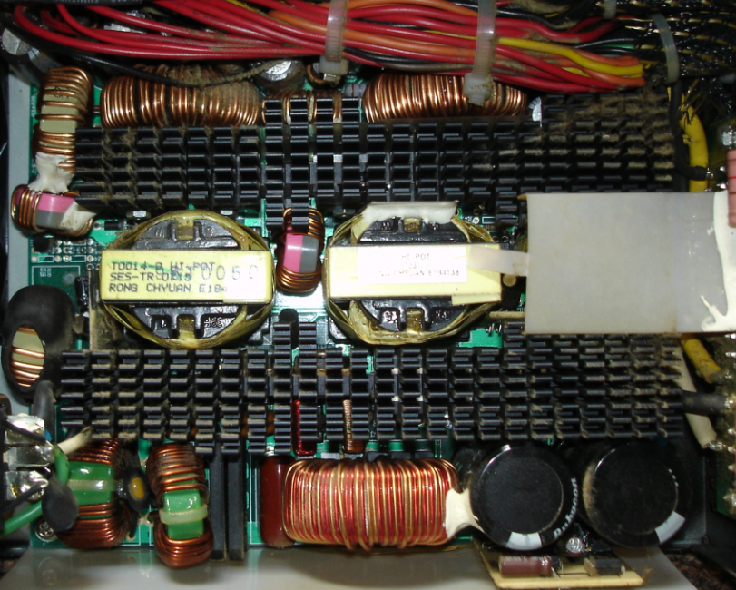

                              Are there three transformers on the PCB, I can see two large one but on the right side of the middle transformer it looks like a small transformer for the 5V standby?
                                  I doubt it. Big transformers like these never go bad (or at least not before the schottky rectifiers and the switching transistors on the primary blow up).
                                  One thing that caught my attention in post #1 is that this PSU was tested with only a hard drive and a fan. For a 1 KW PSU, that's a very very light load, so it is possible that it just needs a bigger load.
                                  @ Philly Cheese Steak: If you have a spare Pentium 4 computer (or something equivalent - i.e. a motherboard with a 4-pin CPU connector), use that to test the PSU. If the 5V rail is still bad, all I can think of is this:
                                  1) In the past, Enermax used to use a tan glue to hold down components on the PSU board during manufacturing. As this glue ages, though, it turns brown and becomes conductive, thus making it possible for short circuits to appear inside the PSU. I can already see there is some of this glue used in your PSU.
                                  2) If #1 doesn't apply above, then perhaps those PCE-TUR/TUL caps are starting to go bad and thus causing the regulation of the PSU to go amok.
                                  But again, I think you should test the PSU first with a much heavier load - possibly something that pulls more power from the 12V rail than from the 5V rail since this is a modern PSU.
