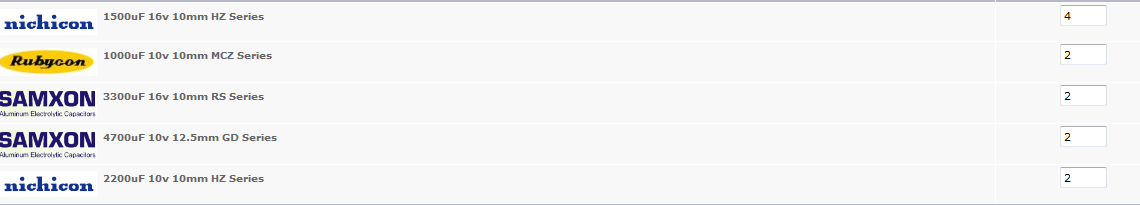

                  yeah these are the caps:
                  2 16v 3300uf
                  2 10v 4700uf
                  2 10v 2200uf
                  4 16v 1500uf
                  2 10v 100uf
                  That transistor did have marks on it they are : FOR3G then under that it has "7.C" I assume that's not to hard to find. So Panasonic is good, will it be OK for all of them if they are Panasonic? I want to use this on my stuff for a few more years, also I over clock too so if need be I'd like to beef it up a bit even if that means replacing other parts, so long as I don't lose more stuff to it again.....................
                  Thank you hegge!
                  Update here's my shopping cart wanted to make sure it looks good, I'll get the transistor from digiKey.

                          Yes Panasonic is definitely good but you could also consider Nichicon and UCC (United Chemi-Con)/ NCC(Nippon Chemi-Con) [same company 2 names].
                          For those CEC TULs I'd go probably with the following for replacements.
                          Nichicon: PW/HE
                          UCC: KY/KZE
                          Panasonic: FC/FR
                          All of these are good long life low impedance caps. There are few specs available on the CEC caps that the Enermax came with but from what I have heard the TUL series is entry level low impedance specs wise either equivalent to or slightly worse than something like Nichicon PW, any of the above listed caps should meet or exceed the specs of the caps you are replacing. I usually use UCC caps for PSUs since they tend to be lower priced than Nichicons or Panasonics but on a small order (enough to do one PSU) the price difference will be minimal

                            2 16v 3300uf - these (if you can't squeeze 12.5mm dia caps in) or otherwise, these
                            2 10v 4700uf - these if you can use 12.5mm, otherwise, these (Yes, I know they are 3300uF, it will work fine - the 4700uF rating on the originals is bogus if they are 10mm diameter)
                            2 10v 2200uf - these
                            4 16v 1500uf these
                            2 10v 100uf - these or these

                              Thank you dmill89!
                              4 16v 1500uf these
                              Cool cool!
                              Ordered, got to wait it out.
