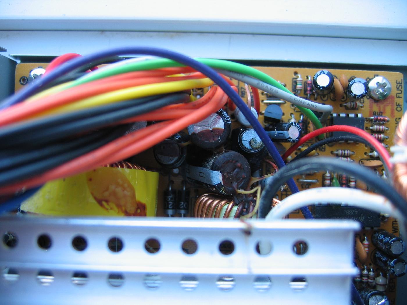

No name/brand diode split in half/exploded cap

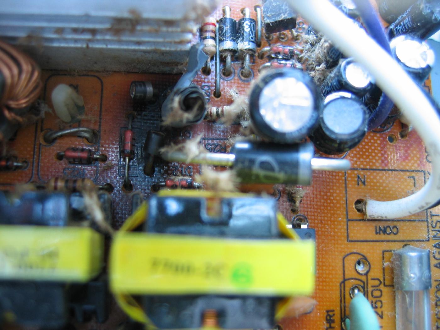

    This is literally a no name/brand power supply. I got this power supply as "it should work". Good thing I check everything before I use it.

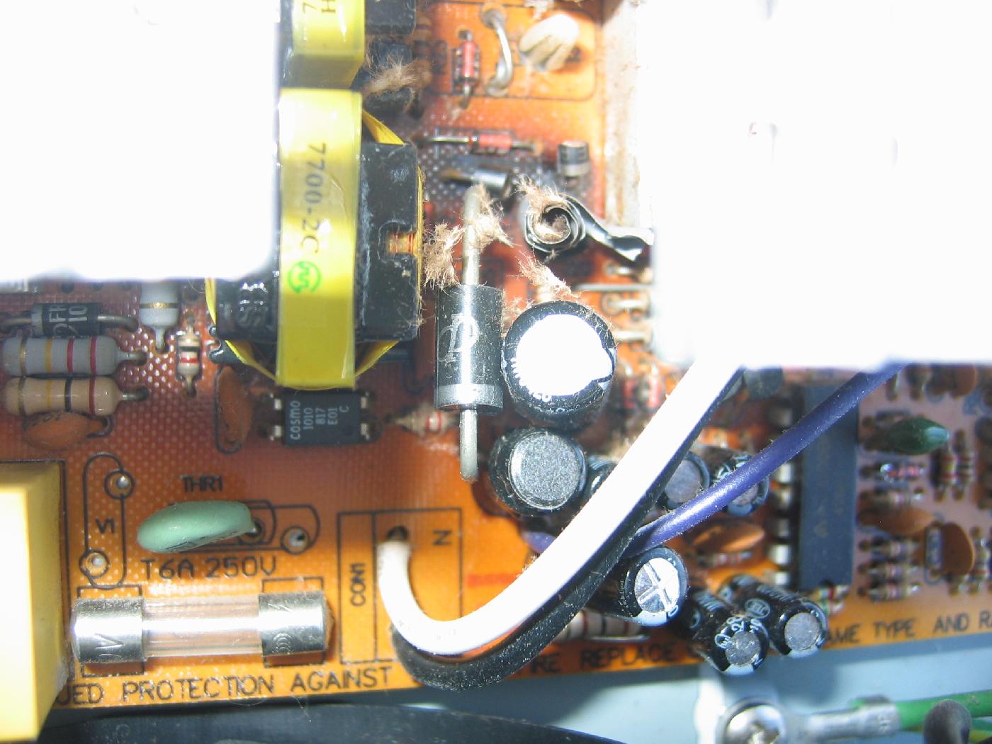

    Notice the blown in half diode and 47uF 50V cap that unravelled itself.
    I might repair it just to learn something, but the only parts I'll save are the fan screws and maybe a few resistors.

    Re: No name/brand diode split in half/exploded cap
    It's a Sun Pro. I can see some heat damage on the PCB around that area, although it may still be repairable

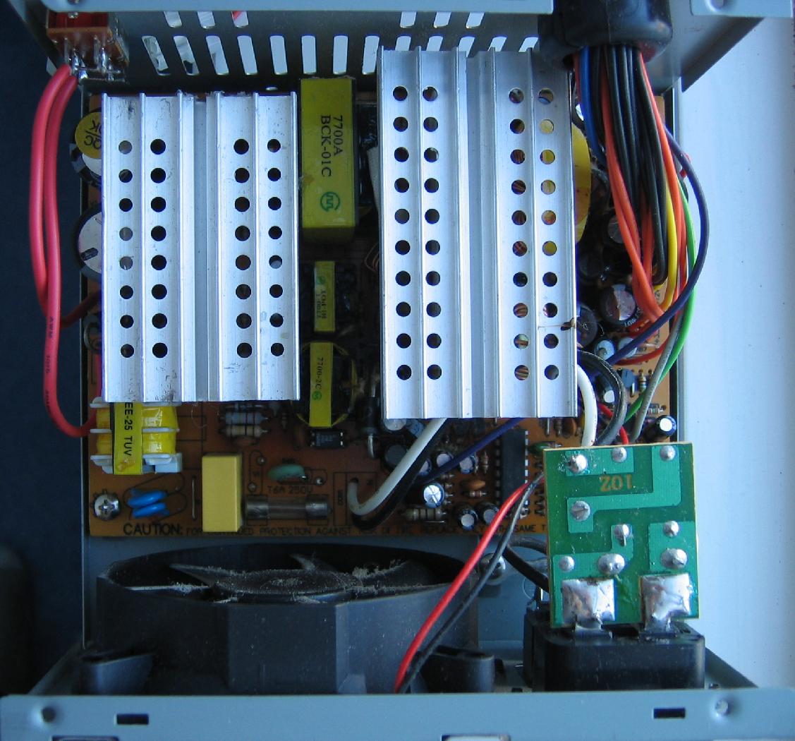

          Seen this platform before, i have one lying around somewhere. It's fairly solid if you put in good caps and good secondary diodes, it'll do 400W as the transformer and inductor are big enough. Just check that the primary transistors are 13009s.

            I see 13007-2 (x2) and 10401 (with a F symbol - probably Fairchild).
            400W is 200W more than I will ever need for my purposes.

              13007s will give about 300W given that the output diodes are adequate (efficiency is kept high). Use at least 30A rectifiers on all rails and it should do well.
                  Confirmed.
                  The 7700 on the transformers gives it away.

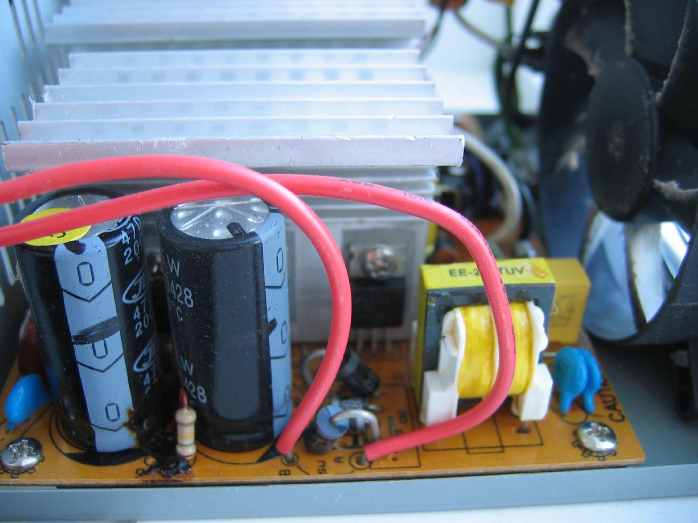

                  I have a Raidmax RX-380K (Sun Pro KY-480ATX) that looks almost exactly the same as yours but with even more undersized components. Many of the caps in it are cooked, which shouldn't be surprising as there's heat damage on almost the entire area of the PCB. Blame the tinfoil heatsinks for that.
                  IMO this PSU is a complete piece of junk not worth fixing. That aside, mine does have a few resistors and coils in it that may come handy for other PSU repairs, so I'm still keeping it. At least yours has input filtering.
                  By the way, it looks like the 5vsb circuit committed suicide in yours. Probably went overvoltage and that's why you see that small exploded cap.
                    On the split rectifier are the letters "FR" for Fast Rectifier, and it appears to be a 1A unit, and hopefully, the number at the end (e.g. 107) is still readable.
                    If this number cannot be read, you can safely use a FR107.

                            Ok, the diode that blew up is actually a FR107 on mine. Also note that in the 4th picture he gave us, the 100 ohm resistor next to the middle transformer is toasted a bit.
                            Two interesting things are, one, his psu has two 470uF input caps when mine has two 680uF ones. Second, his bridge rectifier is made of an assortment of diodes, mine is just 4 of the same type(large barrel).
