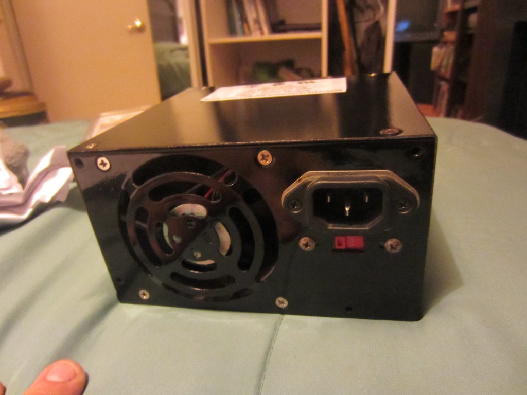

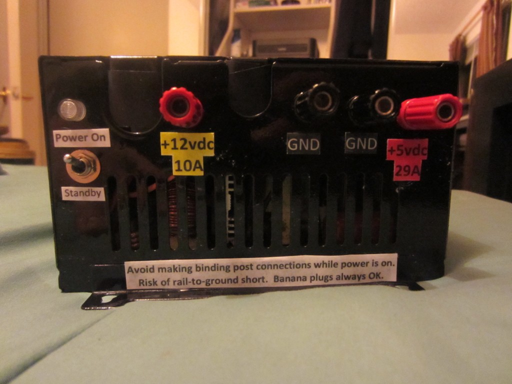

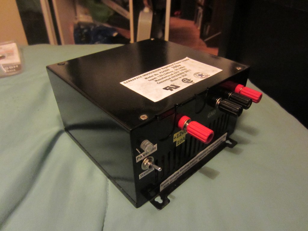

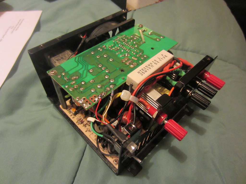

    Alright guys, she is all done.
    I ended up curing the enamel in a toaster oven @ 250F 25 Min.
    I think it came out really good. Looks pretty sharp considering it was grimy and rusty around the vents when I first got it. I did my best to keep the interior wiring clean and I have to say I think I did pretty damn good. I ran two wires each to the 12v and 5v binding posts for all that high-amperage goodness.
    The LED above the switch is dual-color. It is green whenever the PSU is plugged in and orange when the PSU is on.
    The only thing left to do is to fix that loud Beta fan. I'm thinking a 3v zener diode.
    Let me know what you guys think.

      Looks good.

                            Agreed. Very awesome paint job.
                            Shouldn't the LED colors be backwards, though? (orange for OFF and green for ON?).

                                I also think the dual colour LED would be more logical the opposite way round...?

                                  I originally wanted orange for standby and green for on, BUT, here is why that didn't work:
                                  Two color LED: green and red. Turn both on and you get orange.
                                  To get orange when it's in standby, I would need to have green on constantly (wired to standby) and red wired to a voltage that is only there when the PSU is in standby. I tried the power_on signal wire, since it sits at 5v until it gets pulled to ground to start the PSU, but the LED would not light.
                                  I could have done red when in standby and orange when on, but I don't like red.

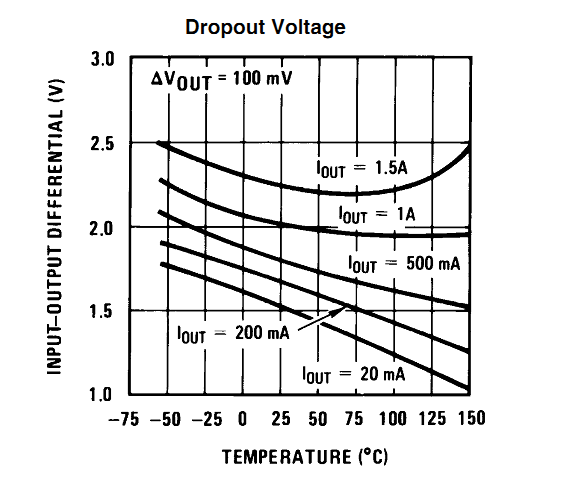

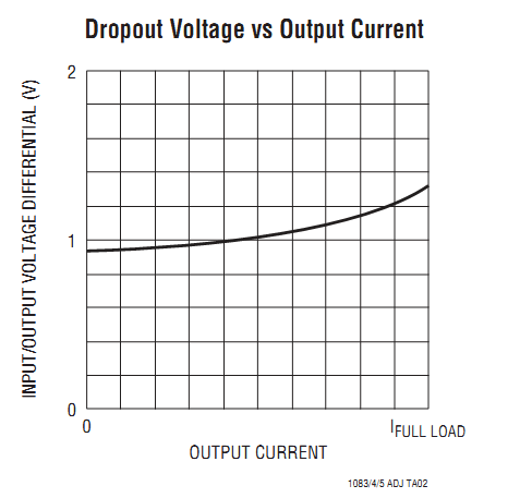

                                    Be careful with that as very few power supplies do 1.5A on -12v, which seems to be required by that schematic (well, more as a consequence if you plan to go over 10-11v at high loads, other chips won't do better) .
                                    Also, I'm not sure you'd get 24v as the chip has about 1.3v dropout when in use, going up to 1.5v when heated and under 1-1.5a load - you'd probably only be able to get about 1-1.3A at ~ 22v
                                    Consider using LT108x (1083 - 3a, 1084 - 5a , 1085 - 7.5a) :
                                    digikey:
                                    1085 http://search.digikey.com/us/en/prod...3PBF-ND/891129
                                    1084 http://search.digikey.com/us/en/prod...3PBF-ND/891835
                                    They use the same 1.25v reference voltage so they're probably drop in replacements to LMx17 but it has better load regulation (0.1% vs 0.3%) and has guaranteed dropout voltage betwen 1-1.5v compared to about 2.2v on LMx17.
                                    lm x17: lt 1083:
                                    and it doesn't make much difference but resistors are cheap enough to use 1% rated ones instead of 5% as in the graphs there.
                                    ... and keep in mind they'll generate a lot of heat, make sure they're heatsinked properly.
