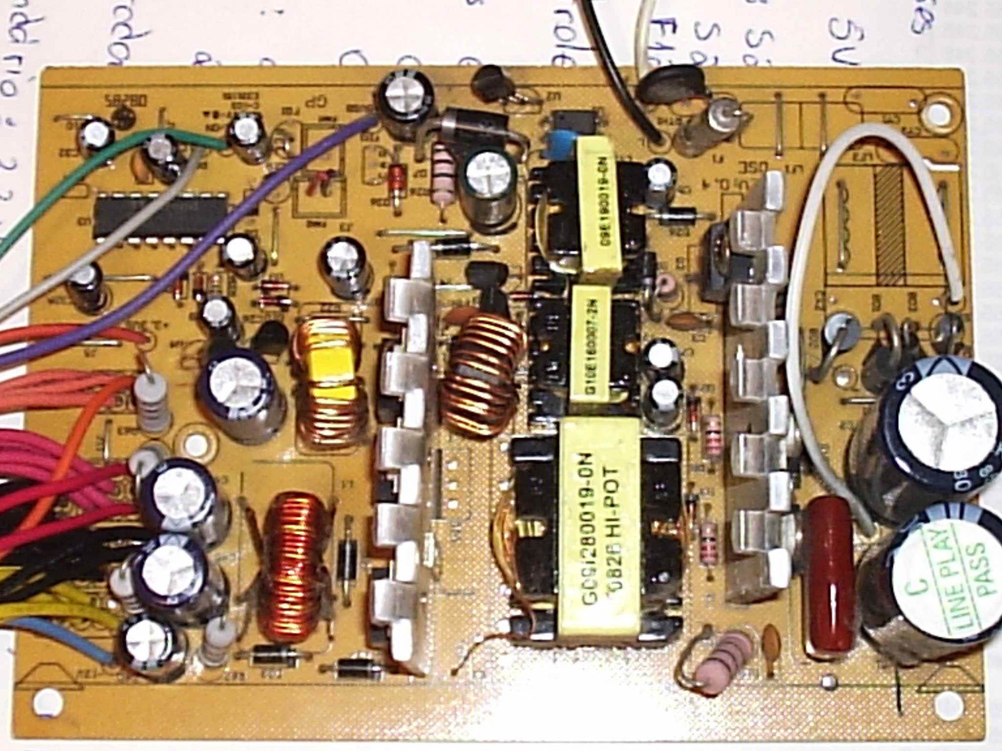

    First, I know this is a gutless crap. They sell well here, and are the kind of model found in popular shops.
    It is a Coletek CT-2045S. I collected a bunch of burnt PSUs from friends just for studying how to fix them, and was lucky to get 2 or 3 of the same model each. I ask you for please reviewing my conclusions.
    From the label :
    Peak Power : 450W
    3.3V - 18A
    5 V - 22A
    12V - 25A
    5Vsb - 2A
    -12V 0.3A
    Maximum combined power for 3.3V and 5V : 140W

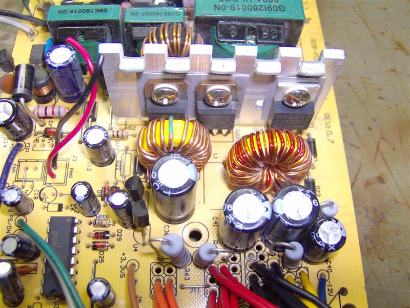

    Primary diodes : 2 x 1N5406 ( rated max 3A ) and 2x 2A05 ( rated max 2A ) .

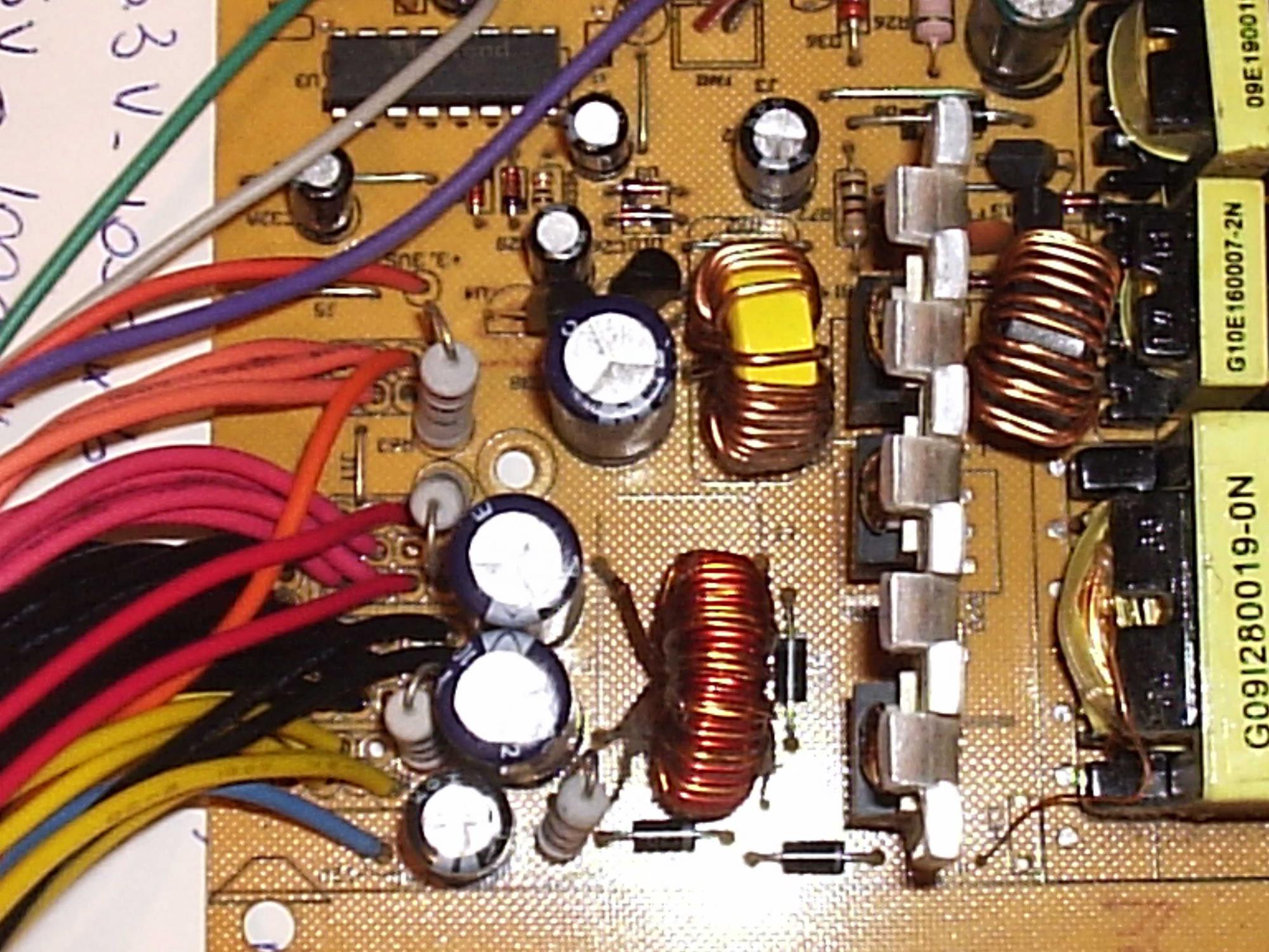

    Secondary rectifiers : 3.3V - S20C45C ( max. 20A )
    5V - S2045C ( max 20 A )
    12 V - F12C20C ( max 12A )

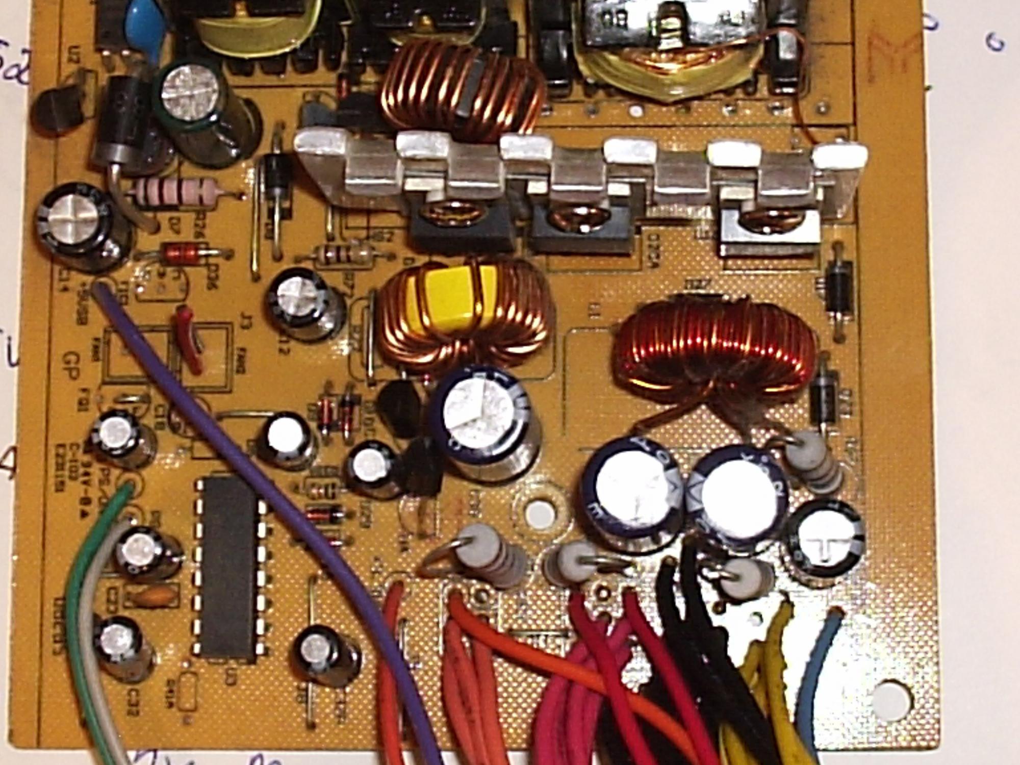

    The main controller is a Welltrend WT7520. Secondary caps are marked 1000uF x 16V KYS . The -12V line gets a 470uF x 16V KYS.
    The voltage here is 127VAC.
    So, I believe I could argue that the most power this would be able to have was 127 x 3A = 381W.
    With those secondary rectifiers, while the 3.3V current is inside the possible, the 5V exceeds it ( and in one of the psus, the 5V diode was shorted ) , and the 12V line is very exagerated.
    That , along with the ausence of pi filters, would make this a not-that-good 350W PSU with much ripple.
    Sorry for the bad photos, if necessary I can get a better camera in the office.

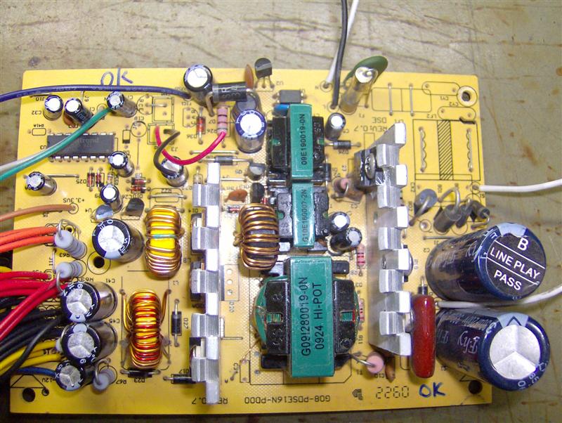

    This is a CWT unit, unfortunately. Probably from their ISO division. It could probably do 100W barely in spec, maybe 150 before blowing.
    While the amperage rating of the input diodes would indicate they would fail at 381W, typically they can do much more than that. But it dosen't really matter as it would never reach that level of loading, probably more along the lines of 250W input to get 150W output before 'sploding.

        370forlife, but is my analysis correct, in that with the maximum current for the secondary rectifiers, or the input diodes, limits the real maximum this psu would be able to do ?

          @370forlife, You sure that's a CWT? I can't imagine CWT would build something that bad (and there are no "CWT" markings on the transformers and no green tape). It looks like an Okia/Broadway Com Corp to me.
          @rogfanther, That is correct. The input diodes could in theory handle 381W assumming a 127V input which will equate to about 285W output assumming 75% efficiency, however, those switching transistors will go kaboom at before that.

            In cheap PSUs generally the maximum current of the secondary rectifiers limits the output power - but to reach that maximum current the primary switchers must be able to take it, and most of the time the heatsink they're on is way undersized for the task, and unless the overload was on only one rail they will usually fail before the diodes do. On your particular PSU you also have a really small output filtering toroid coil (the round thing with lots of wires on it). It'll do 200W... barely.
            Approaching maximum current also means high voltage drop thus a lot of wasted power (and more heat to get rid of). That's why cheap PSUs have lousy efficiency. Picture this - a 300W supply with 70% efficiency eats 429W from the wall. If the efficiency were 80% said PSU would be able to provide 350W from the same input power.
            As for primary rectifiers, their current handling capability depends a lot on their temperature. It's not uncommon for them to survive almost twice the rated current continuously if they're placed in the path of airflow.

              In this case, though, it wouldn't take much at all to overheat them with those tiny little heat sinks. I recently put an okia PSU on my load tester which looked similar to your unit. It managed only 79% efficiency on 230V (120W load), and failed at only 250W load. On a lower input voltage, the efficiency would be lower, so it would generate more heat and fail sooner. The ripple was WAAAYYYYY over the limit, even at 120W, at around 180mV on the 5V rail and over 200mV on the 12V.

                          ah, OK. I have an ISO -branded- PSU and it has CWT markings all over the transformers. In any case, though, they must have taken a low end 100W CWT and put a 450W label on it.

                            I have a 75W power supply with more guts, and the manufacturer had to cram everything into a smaller enclosure.
                            Only one cap filters each output, there is no room for a pi filter, and the main filter coil is smaller than the 3.3V coil. If the filtering components had been installed and the heatsinks were bigger, the transformer would limit the output power.
