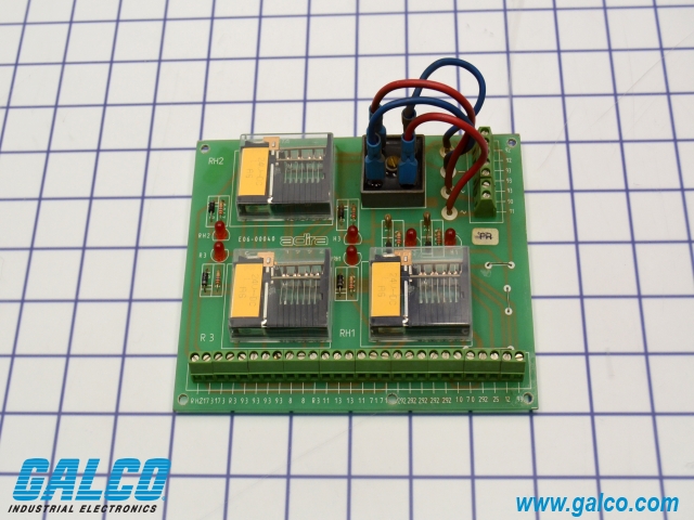

Secondary out 32 volts AC getting 146 volts DC do not understand
    • Jul 2011
    • 6057
    I will post a picture of this transformer setup tomorrow I hope someone can shed some light on how this
    could be ( has a bridge rectifier with no capacitors on the DC side on other thing that is strange about this setup is that negative side of the bridge rectifier also goes to machine ground )
    Now if check one wire that to the machine ground and wire one tap that goes to the bridge rectifier the voltage is really wired and when you check the other tap wire that goes to other side of the bridge rectifier this voltage is also is really weird but not 32 volts AC side of the rectifier
    This transformer has multiple secondary outputs and there voltages are different two of the taps go to machine ground ( if I remember correctly there are six fuse one for each tap wires
    Because I just do not understand this at all
    Now it is common to see secondary transformer secondary winding one wire goes to machine ground
    ****but I have not seen on the secondary side after a bridge rectifier that the negative side of the power supply goes to machine ground *****
    **** Does this make scene to anyone **** if it does could you please enlighten me on what the purpose of this is
    I am using a Fluke meter to make these measurements

    Re: Secondary out 32 volts AC getting 146 volts DC do not understand
    deffo needs at least pictures
      A sketched diagram how it is all hooked up will also help.
      Since it is rectified by bridge rectifier and no filter cap, what you see on the output will 120Hz pulsing DC.

              Well I finally figured out why this machine foot pedal controller board causing me such a headache because the board has some issues but still operates the hydraulic cylinders but not with the foot pedal
              This controller is the weirdest setup I have seen in quite some time
              This machine has DC solenoid valves the coils are powered by this controller board power supply
              This controller uses 24 volt relay coils which was throwing me a curve ball
              This customer wants machine to work correctly again with the foot pedal so the solution for this problem is to use the portion of the controller board that still works and power the control relay that operates the valves
              with a new relay mount on the machine and remove the relay from the controller board because I do have any idea where you would find this type of relay ( relay has bad contacts and not repairable)
              Have a separate power supply for the foot pedal relay coil for the solenoid valves with a E stop switch for the foot pedal ( 24 volts DC power supply)
              Some wire that did not have any function to that wire were removed from the controller board
              One note this machine was manufactured in 1992 and made in Portugal
              One other note these relays are open to the elements no plastic cover
              One other note I tried to not use this controller board at all would not work correctly and blew fuses on the control transformer not exactly sure why this was happening this is what drove me to this solution for this problem
              One other weird thing about the way this power supply controller board is setup the board does not use the positive section of the rectifier
              The positive side of rectifier goes to a normally open switch on the main contactor then from there is not clear exactly where it goes but my guess is that it is the other side of each of the solenoid coils but this the part that not clear how it gets there
              One other note the writing diagrams are about the worst I have seen in a long time
              The biggest problem I have is how the 24 volt relays are powered from this board ???
              This customer employees tried to put a new foot pedal on this machine because the one that was on there the switches plastic housing broke into pieces
              ( the old foot pedal had two switches two normally open and two normally close on each switch and has six wires that went to the foot pedal )
              and by them trying to put another foot pedal ( which the OEM part is no longer available and there employees did not understand how you would have to wire the new replacement foot pedal they fried part of controller board or something else but not sure what the something else is
              This customer has other issues where there employees do understand how controls work and mess things up and then the customer call me to see if I fix there mess

                    I think you might be reading stray voltage due to leakage currents. Does your multimeter have LoZ capability? Or put a 20k resistor across the leads so the multimeter is not so sensitive.
                    I was looking for where the transformer's secondary gets connected to earth-ground. Before or after the bridge rectifier.
                    I can't see the pcb traces around the bridge rectifier, but it looks like two red wires (32VAC from the transformer to #94, earth-ground to #93 and a mystery wire to #92. The pcb jumper below that terminal block seems to also connect to the relays. They're supposed to have a clear cover on them, the contacts look a bit bent and burnt dead. There is no arc snubber for them.
                    I would remove the pcb, take pics of the backside to draw out the schematic. You don't need three DPDT relays for this. But the voltage readings are still confusing.
                    The relays might be machine safety relays.
                    adira E06-00040 relay board

                      If a terminal is not used from the bridge rectifier, it might be a bipolar solenoid drive? So +ve 1/2 wave DC pulls it in, and -ve 1/2 wave DC pushes it out. Instead of simply solenoid on or off.
                      The foot pedal double switches might again be a safety function.

                                It's definitely a machine-safety system. They use relay logic for AND and OR, including the foot pedal.
                                Safety relays- so one set of stuck contacts does not prevent any others from moving, unlike usual DPDT relays or the Omron LY4F which jam if any contact arcs stuck.
                                Interlocks galore - if the foot pedal is open-circuit, ground fault or the foot-pedal up switch contacts are not asserted, it will never give out a foot-pedal down signal to energize the solenoid.
                                If the solenoid is on and a foot-pedal up is seen (i.e. stuck down), de-energize the solenoid regardless if a foot-pedal down is seen/stuck on.
                                It looks like just a DC power supply but rectifier (+) goes through E-stop and something else to make it back to the board. Have to see the wiring diagram and board backside to finish any meaningful schematic.
                                The original problem might be a ground fault somewhere else, on the solenoids or other transformer windings.
                                I find most of my labour cost for fixing plant stuff is just figuring out the wiring. Once I spent a day on a CNC machine just finding a wiring diagram, following wires to the correct fuse holders.
                                I don't want to give out advice if you're going to strip out all the safety interlocks/relays. I'm assuming the machine can hurt people if it malfunctions, so the manufacturer did it that way originally.
                                The foot-pedal is complicated with six wires and two switches to keep it safe.

                                  One set of contacts are not going to be used pins 23 / 24 are not need
                                  I going to use pins 51 / 52 and pins 61 / 62 in series for in case the other pins were welded then the safety relay would not rein gauge the foot pedal relay again
                                  I am also going to use a 24 volt switching power supply for the two relay because there is no 24 volts available on this machine and because I want to controls circuit to be 24 volts
                                  For your comment about “ I'm assuming the machine can hurt people if it malfunctions “
                                  no it would only keep the blade in the down position and you would not be able to do anything else with it but I am also going to add a limit switch for the blade when it is all way down it goes back up in the neutral position unless the safety relay malfunction it would keep the blade in the down position
                                  Because the up function does not work correctly either or it did not have this function to begin with because some of these machine did have a automatic blade up function
                                  also some machine have a function that you can leave the blade in the down position when you turn the machine off this machine does not need this function because the cylinder rod length is very short and does not suffer from leaking down sin drum like a lot of machine do

                                      Euro standards for machines have redundant safety controls.
                                      A pic of the pcb backside would make it easy to figure out, I can draw a schematic.
                                      This thing will arc and kill any relay you use to switch power to the solenoid. It needs a snubber or back-EMF diode for the solenoid, and there's no capacitor at all even 0.1uF on the DC bridge to stop HV from killing the bridge rectifier. The 146V reading might even be from insulation failing somewhere due to this.
                                      The danger is possibly if the blade moves down by itself?- due to the footswitch cord gets stepped on, damaged connector etc.?
                                      I'll look for a example safety-relay redundant connection circuit to explain what they originally tried to do.

                                        “ A pic of the pcb backside would make it easy to figure out, I can draw a schematic.”
                                        I will try to do this when I go back there to work on it again
                                        “ This thing will arc and kill any relay you use to switch power to the solenoid. It needs a snubber or back-EMF diode for the solenoid, and there's no capacitor at all even 0.1uF on the DC bridge to stop HV from killing the bridge rectifier.
                                        The 146V reading might even be from insulation failing somewhere due to this.”
                                        ( please explain what you mean by this statement )
                                        This voltage has been this high every scene I have worked on now that not to say there has been something wrong with it for a while because when the original foot pedal worked it would blow one of the fuses on the control transformer for the controller board ( it would do this every once in a while ) ( sometimes it would blow the fuse so bad that it would be a dark black color and then sometimes it would be very clear that you could not tell that the fuse blew ) all fuse are 3.15 amps
                                        As far as the relay killing part of it you can see what is on this board there is nothing other some diodes
                                        “ I'll look for a example safety-relay redundant connection circuit to explain what they originally tried to do. “
                                        I would really appreciate if you would do this for me Thanks
                                        This 146 volts dc voltage has puzzled me for a while that is the reason for starting this post in the first place
                                        This is what does not make scene to me
                                        I understand the reason you would machine ground the secondary winding this is done on a lot machine
                                        I understand the reason you would one side of a switching power supply to machine ground
                                        But what I do not understand why you would ground the secondary winding in two places and then do the same thing after the bridge recdefier this part ( I just do not understand why you would do both ) unless you are doing this for the dc voltage but then you would have ac voltage on top of the dc voltage rail would you
                                        Most of the time you do not have so many secondary winding like this transformer is and so many fuses
                                        We have a machine that use the same setup but it has a different ( one ) fuse for each voltage output however if it does do this I do not know where it is done but it is not done at the transformer ( this one only has 3 different voltages ) 24 volts 120 volts 220 volts ( I know it done some where because we had a short on the 120 volt tap before and it had blown that fuse )
                                        You might have a selection of taps for different voltages but only the voltage that you want to use is selected
