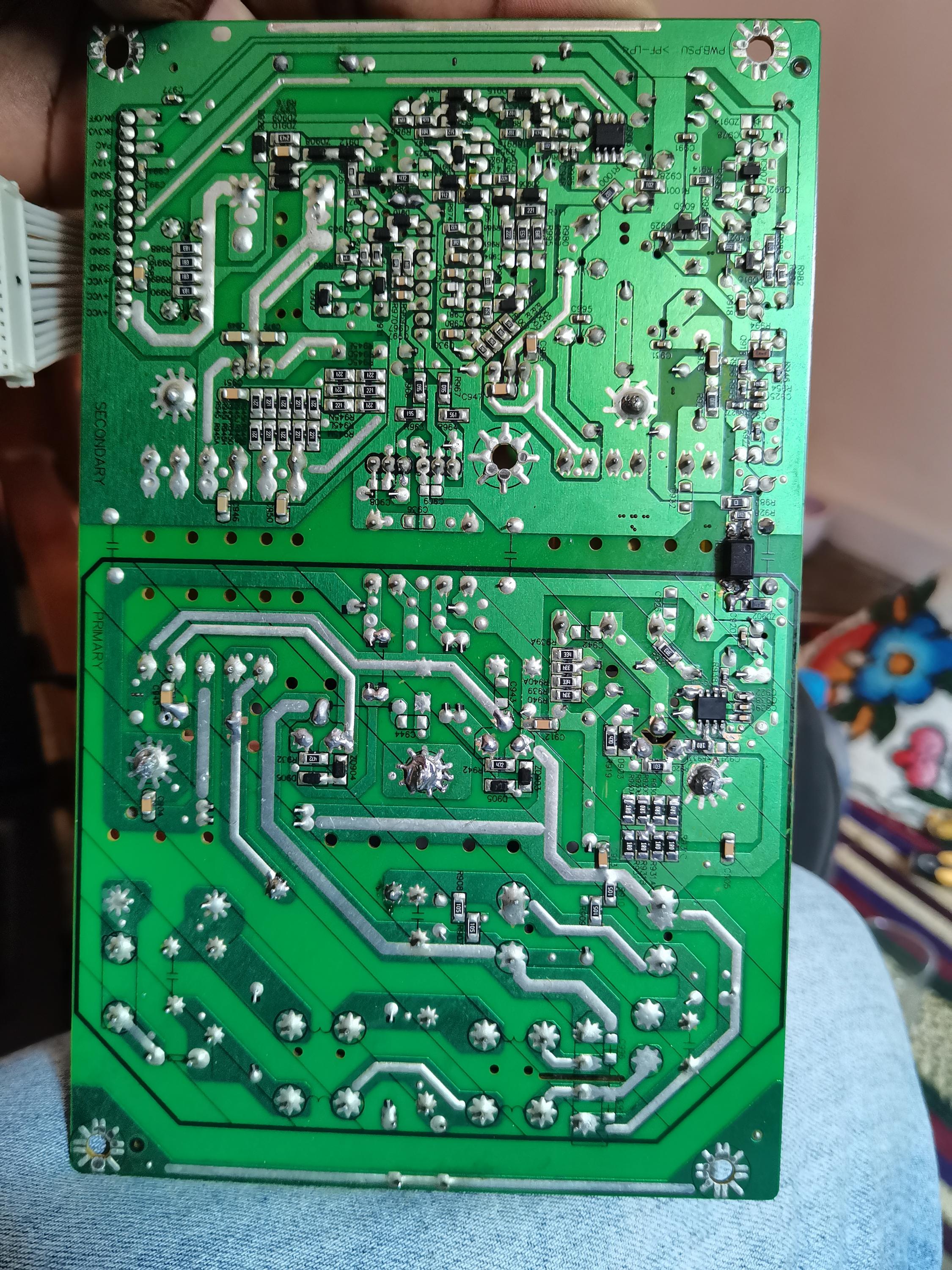

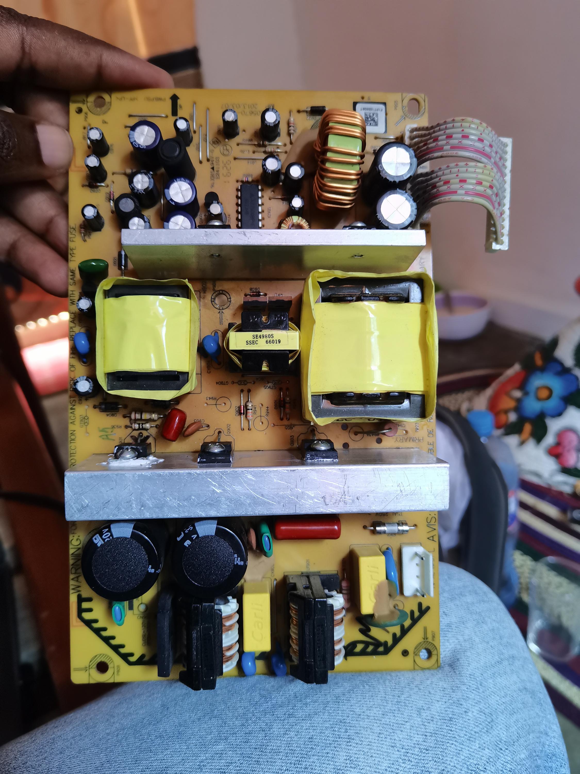

    Hi guys, I have this power supply which has a problem providing power on the secondary portion, seems like there's no power past the transformers, I checked the PFF4N80 which had shorted and replaced it with a new one, I then checked the optocoupler part and found that the TL341 IC too had shorted out so I replaced it with a new one as well, I measured everything on the secondary side of my power supply and I found a 1N5819 diode shorted, I replaced it with a new one, nothing else seem to have a problem, I am out of ideas, please anyone help me out what should I look after

    If the PFF4N80 was shorted, check the 1Ω resistors and replace the ssc6200, check the 1N4148, 10Ω and 47Ω. also replace the 47µf/50v

        I checked those and I found 1N4148, 10Ω and 47Ω not functioning at all so I replaced them, Also I had already replaced the ssc6200 because when PFF4N80 shorted, it blew up together with all the 1Ω resistors and the ssc6200, Now that all the components above have been replaced, still there is no output power, but sometimes I get some 12> voltages if I put my -ve multimeter probe on the -ve of the bridge rectifier and measure my output, is there anything else I can check?

          You can NOT use the (-) of the bridge rectifier to check the voltage on the secondary side. The primary and the secondary are isolated from each other.
          Can you list the board reference numbers you replaced, If ic904 was bad, I suspect IC901 is also bad as well as zd902and maybe R938 is open.
          What is the vcc voltage you get on the ssc6200? R937 may be open

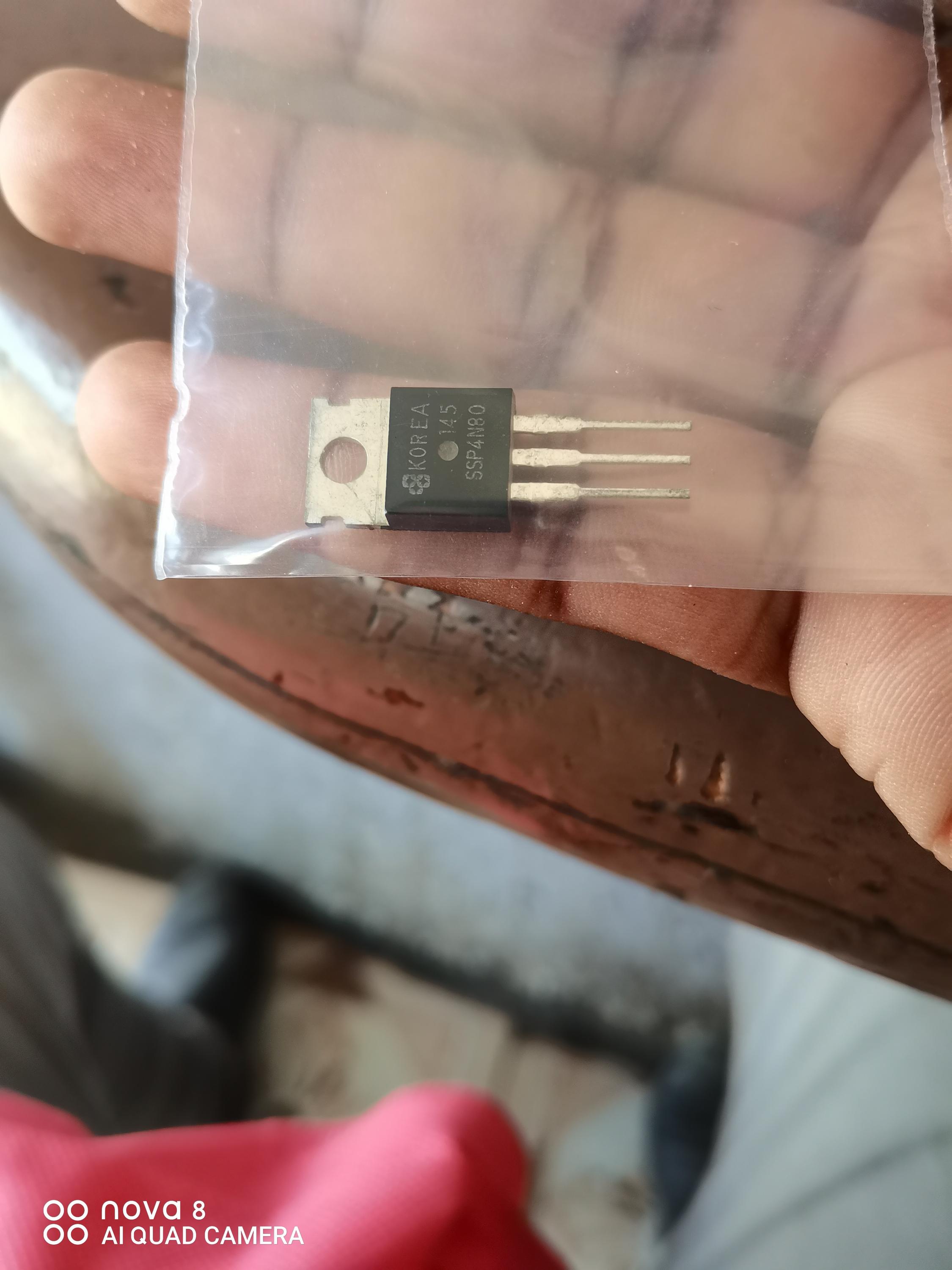

                  What part did you use for Q901? Was the case the same as the original? or did it have an isolated case. I checked other pictures and Q901 is an isolated case. (like Q902)

                    Negative tip on IC903 leg 8 and positive one on leg 2. I replaced Q901 with the one on the uploaded image but i only have thermal paste applied between the Q901 and heatsink so that they won't touch each other

                      Thermal paste is not an insulator! You need the correct case mosfet. besides the screw is shorting out the mosfet as well. An insulator kit might work but it is best to use the correct part. PFF4N80 not SSP4N80
                      You must have something in backwards to be getting negative voltage on the vcc pin. Are you sure you installed ic903 the correct way?

                            How are you measuring the capacitors? You don't seem to understand the schematic. CE901 and CE902 are in series. You need to check the voltage between CE901 negative terminal and CE902 positive terminal, but that will only give you the raw dc voltage which should be close to 330vdc.
                            Check the voltage on ic903 pin 4 being careful not to short any pins and blow it up.
                            Check R935, it should be 100K, you may need to remove one end to get a proper reading

                                I doubt the main filters are that bad. The voltage on ic903 pin 4 is way too low, it should be around 15~20 vdc, Something must be loading it down, likely something on the vcc line
                                Also check the A/C voltage at the ac input (CN901) Then check the A/C voltage across 2 & 3 of the bridge rectifier.
