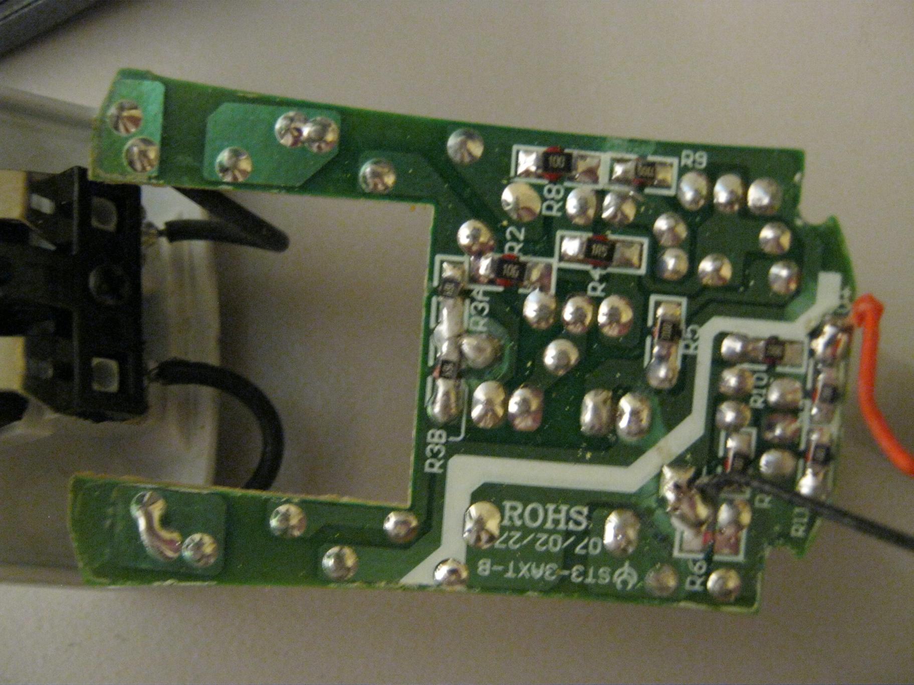

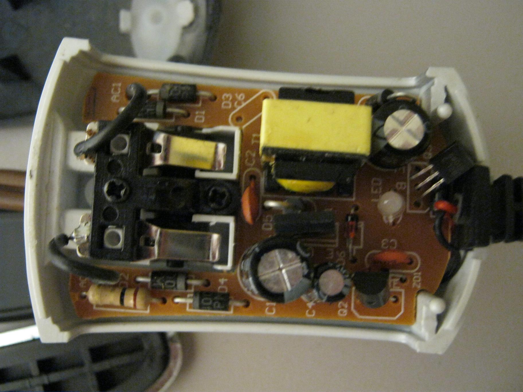

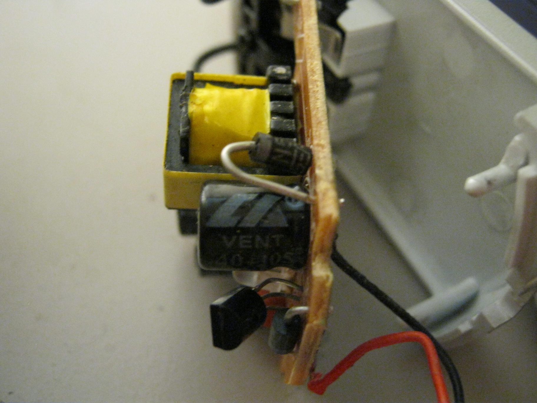

There is no fuse. The bridge rectifier diodes are 1N4007s. The primary filter cap (C1) is a 4.7uF 400V Fullcon (the logo reminds me of Fujicon), and the small cap next to it (C4) is a Jakec 33uF 50V. The output filter cap is a CA 470uF 16V and is probably not low ESR. The largest cap is 8mm in diameter. It has a very small transformer.

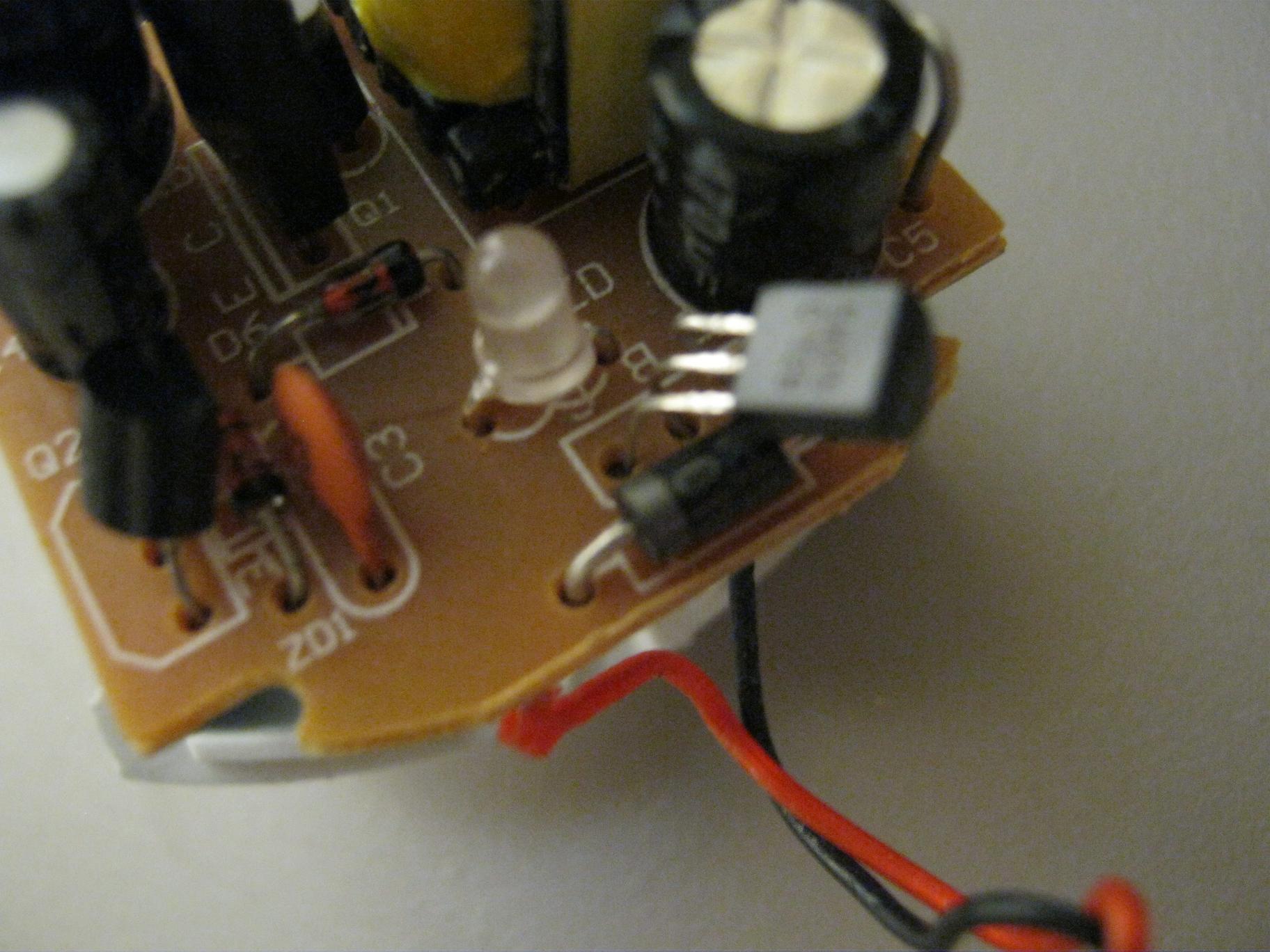

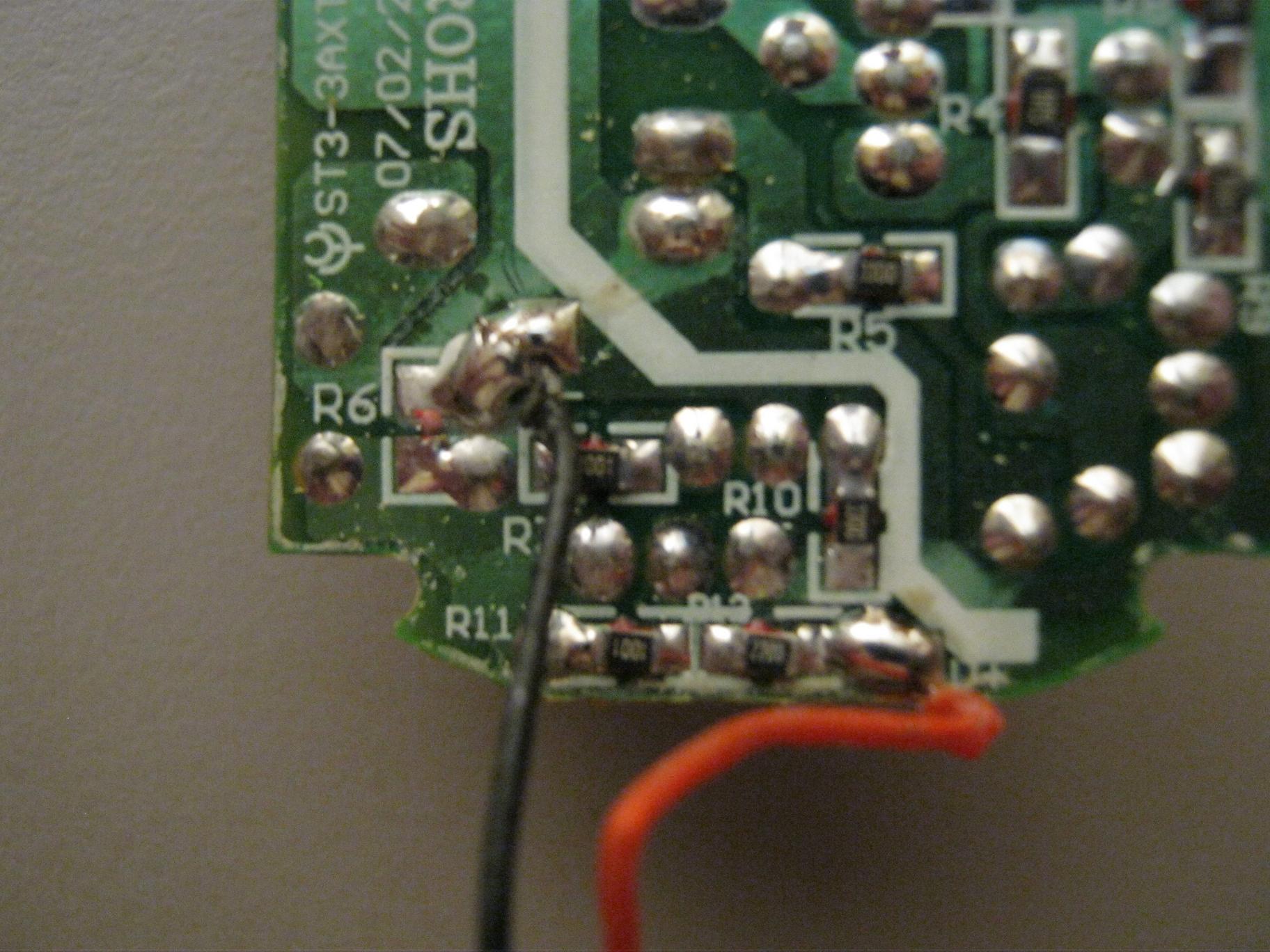

There is also a current sensing circuit on the output. It is a voltage divider in parallel with a diode. The voltage divider is connected to the base of an S9015 transistor that switches on a yellow LED if the current draw reaches a certain level. The LED is a bicolor yellow/red part, and the red section is powered constantly.

Is this charger dangerous? Is there anything that needs to be improved? I am not currently using it, but I am keeping it as a spare.
