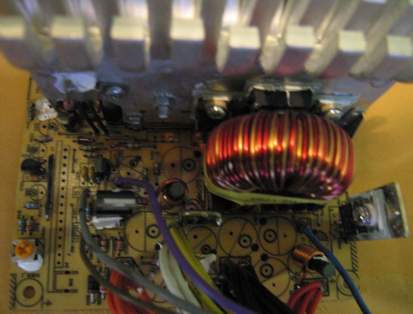

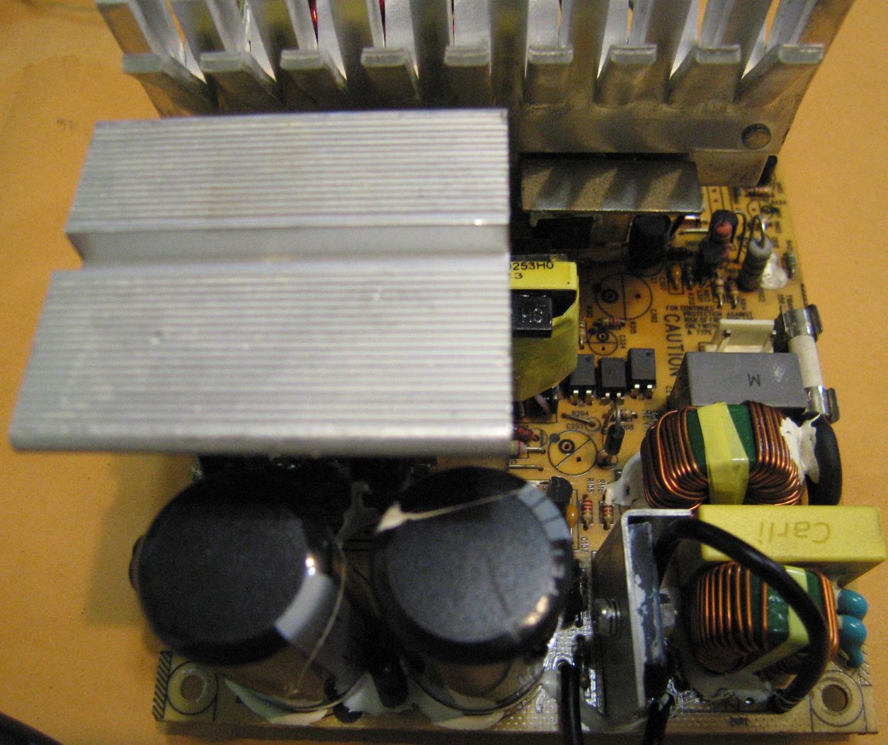

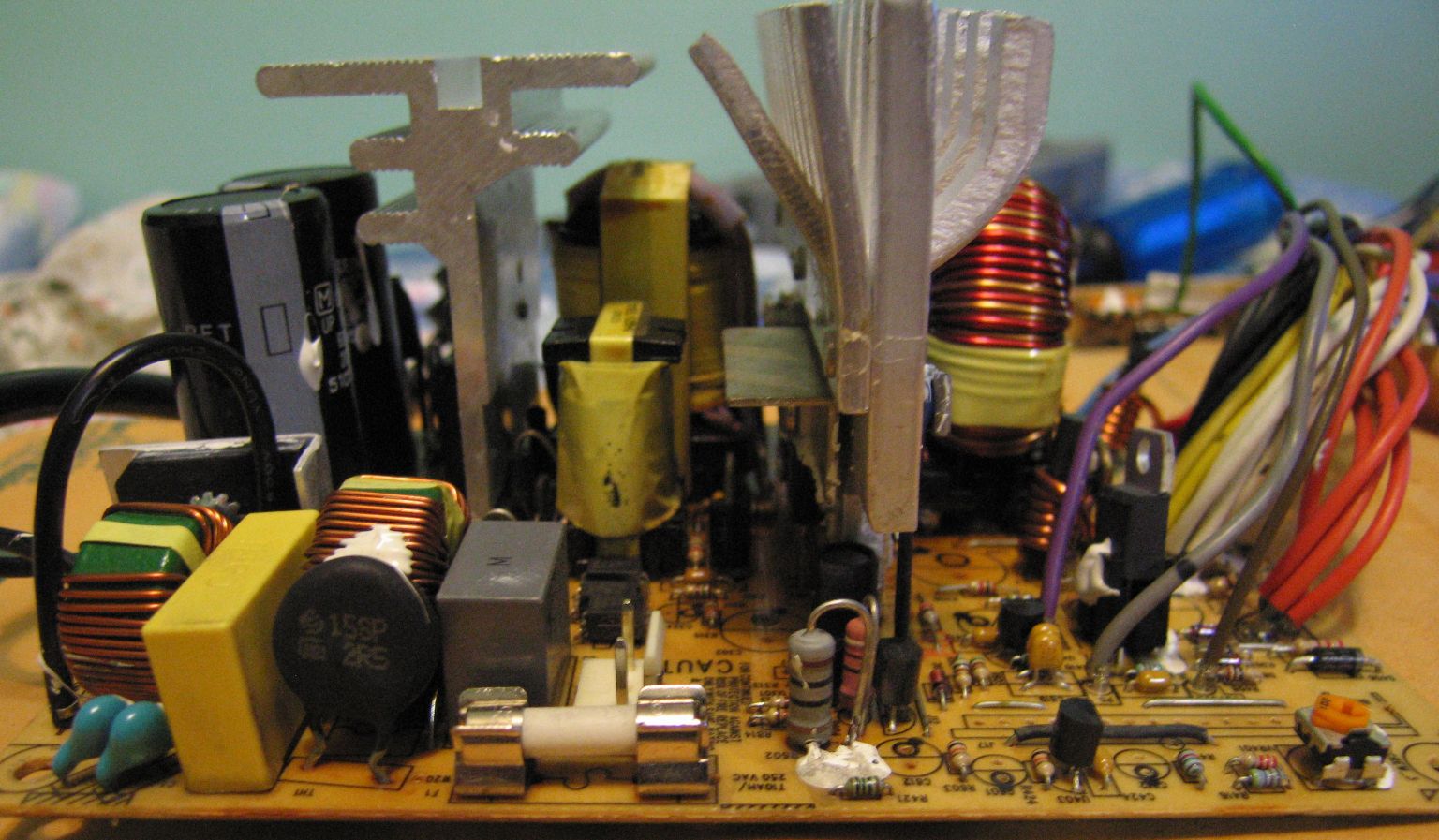

          Had one of these sitting around for a while, pulled out of a Gateway I acquired. "Adda" fan (AD0812HS-A70GL) has seized and caused most of the caps to bloat. There is also dark discoloration all around the secondary FETs on the PCB, but nothing appears to be damaged. I think this is the first time I've seen the 16V 2200uF Teapo SC bloated, they're usually visually ok on the FSP/Sparkle units.
          PSU oddly has a PCIe connector. Last week I took apart a 24-pin InWin that had the -5V circuit, so I guess anything is possible.

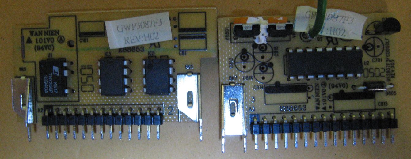

          Chips on the two modular boards I had to unsolder to remove the caps on are:
          Board on primary side:
          1) ST LM393N
          2) OnSemi UC3843AN
          3) TNY266P - Bingo. 5VSB chip. If it didn't have this, it would have been relegated to the pile that needs the mod done as soon as I develop enough skill to do Everell's mod, G-D willing.
          Secondary board has the Welltrend WT7517.
          All the MOSFETs appear to be either ST, OnSemi, or Farchild, so HiPro didn't skimp here. The heatsinks are also pleasantly oversized, and the half bridge is also screwed to an albeit miniscule heatsink which is a nice touch.
          The tack that HiPro used here is a high quality tack which will not oxidize. I'm not worried about it like I am with the tack used on Bestec units. Has a more enamel-like texture than the foamy tack used on Delta units.

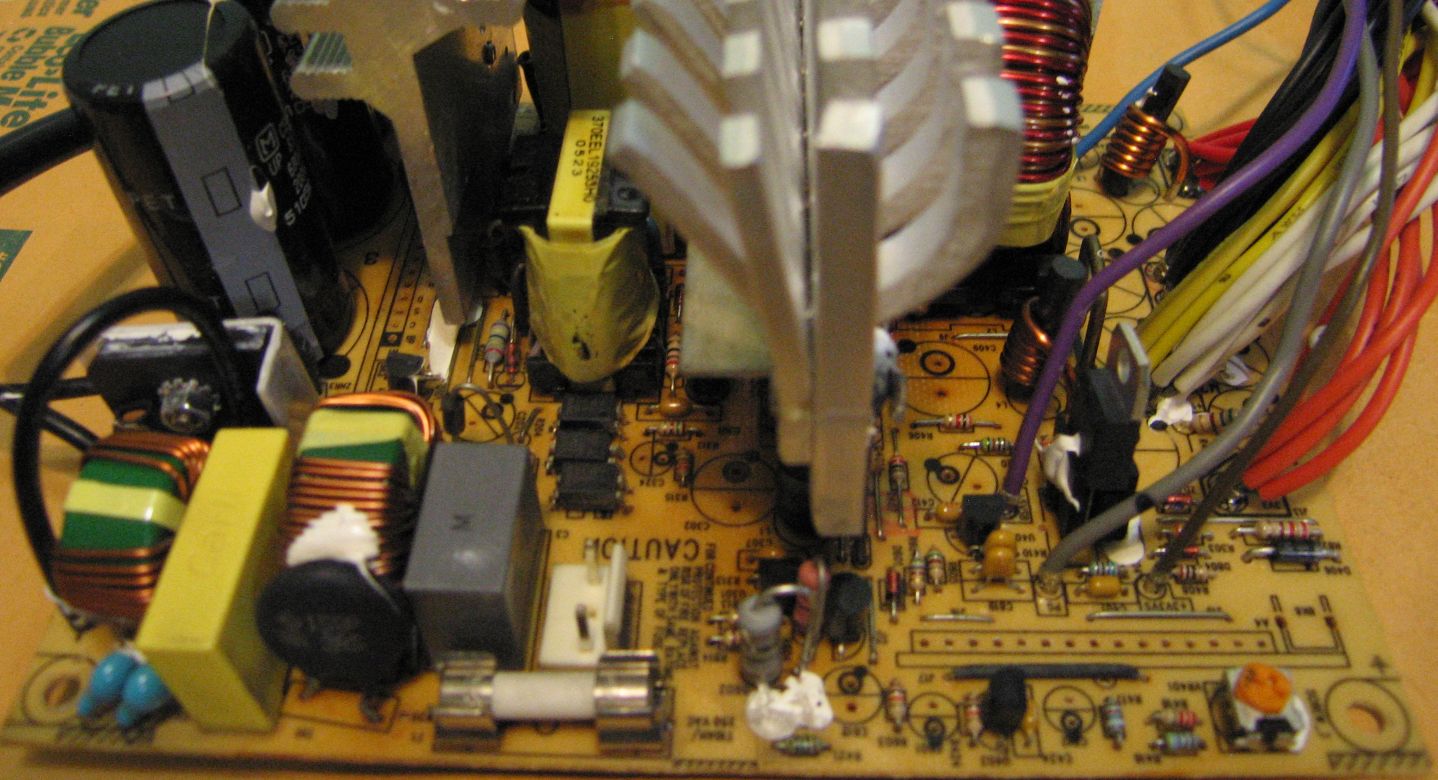

          Only two ferrite coils for the secondary pi filters, and two TO-220 standing on their own in the secondary, one Fairchild KA7912 near the top of the PCB, and one ST TYN-408. Datasheet says the 408 is a rectifier, maybe someone has some insight on what these two are doing here.
          Many of the 10mm caps can be replaced with 12.5mm caps (Good old Hipro - always silkscreening to allow for 12.5mm caps), and I will probably use them where I can.
          Neutral and load cables were crimped into a connector, so I had to unsolder nothing to remove the PCB from the chassis. The 115v/230v switcher also unscrewed completely which is nice.
          All in all, a nice PSU, not as easy to work with as the D3057F3H, but definitely a quality PSU worth re-capping.
              The 7912 is definitely for regulating the -12v rail. I've seen a number of units with the same setup. The TYN-408 is a SCR aka thyristor - it's likely part of a crowbar protection circuit.
