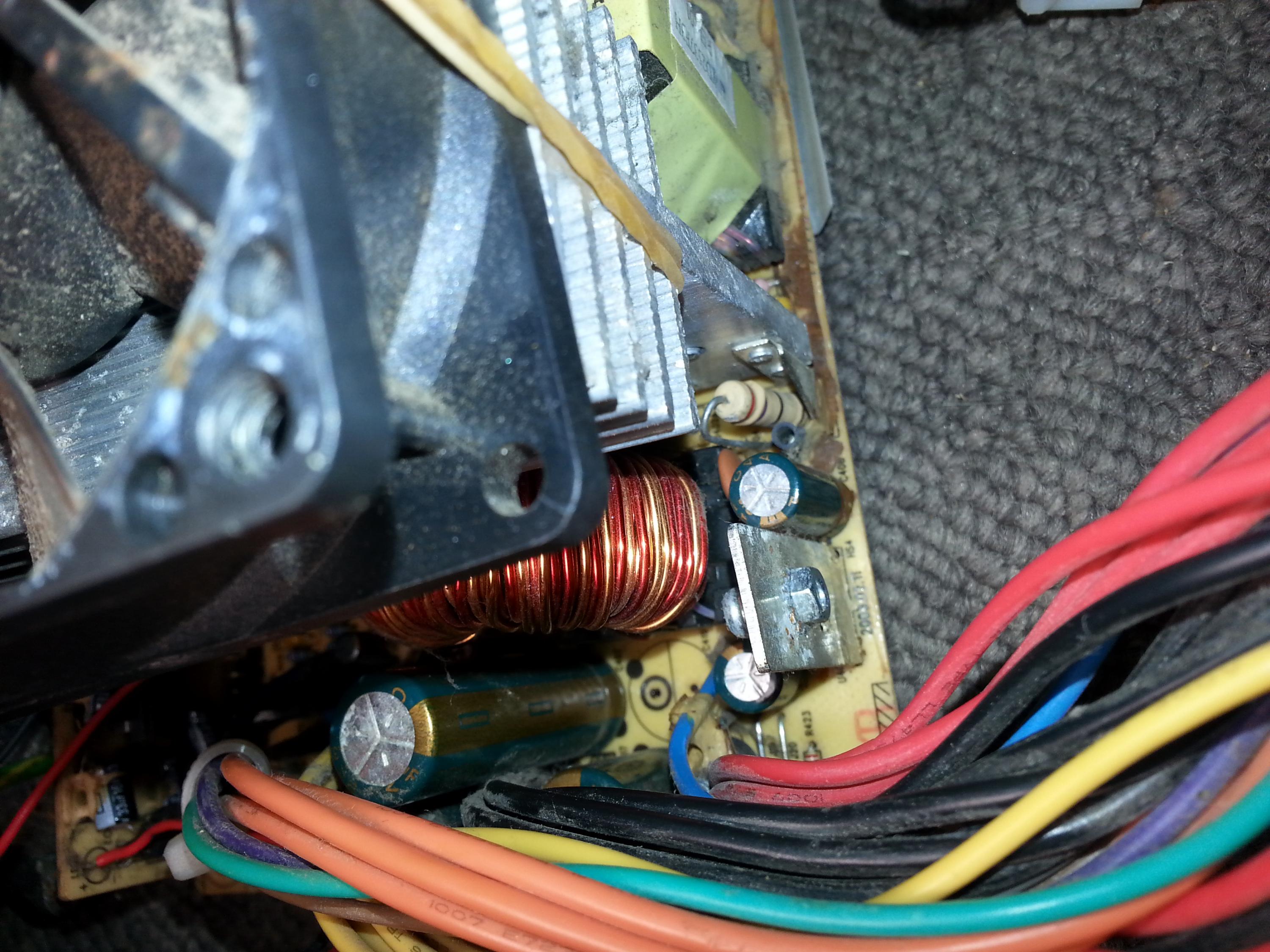

    Thought that it would be worth rescuing this one, but it's got one bulged Teapo that is in front of the big coil.
    Would it be perfectly OK to replace this 4700uf SC (which currently measures 600uf and 1.2ohm ESR) 5V output cap with XYJ 3300uf? More specifically, was the original 4700uf Teapo cap overkill?
    i also (inline) tested the 3300uf SC (which is parallel with a 2200uf SC cap, that is right next to it) on the 12V rail, and get a measurement of 5500uf and around 0.1 ohms ESR - So those caps look like they are still healthy?

    teapo are pretty good if kept cool, i wouldnt drop to 3300uf unless you have no choice.
    what diameter is it?

        no problem finding a 4700uf panasonic or rubycon then.

              how about a 6.3V (original was 10V) ZL, or is that too low ESR for this PSU?

                6.3v on the 5v rail is too close really.

                  How about these Lelon RZW's? They aren't as low ESR as ZL's and they are a lot closer to PW's, but the datasheet doesn't list for these 30mm (only 35mm)

                    if height isnt a problem then try them.

                            I suppose I'll chime in with my 2-cents worth of PSU recapping.
                            In particular, I think it's better to go with the Japanese caps, even if they have slightly lower capacitance, than with the Lelon caps. I don't trust Lelon caps much. And L-tec? If you see them in these HiPro PSUs, get rid of them ASAP. They tend to have nearly 100% failure rate. Considering they do work for at least 5 years in these PSUs, they are not terrible. But nevertheless, I like to recap my PSUs only once and then not worry I have to touch them again.
                            Should be OK.
                            The lower capacitance would just increase the ripple and noise when PSU is near max load on the 5V rail - not a big deal if you are going to using this PSU on a 12V-heavy PC (just about any modern PC.)
                            Nah, not really.
                            I've done it plenty of times. 6.3V caps on the 5V rail are fine.
                            Only when you use cheap cap brands it can be a problem, because they rarely can stand the ripple current close to their rated voltage.

                            With these HiPro PSUs, I've gone as low as Rubycon ZLH on the 5V rail and Nichicon HZ (the lowest ESR e-lytic cap out there) on the 3.3V rail. Both recaps were okay. These PSUs are happy, as long as you keep the capacitance reasonably close to the original or no less than 1-2 notches below.
                            And for the 5VSB rail, Chemicon KZE or Panasonic FM/FR/FS -grade caps are not only fine, but recommended. The 300W and 350W versions based on this platform sometimes have a 16V, 2200 uF KZE on the 5VSB.

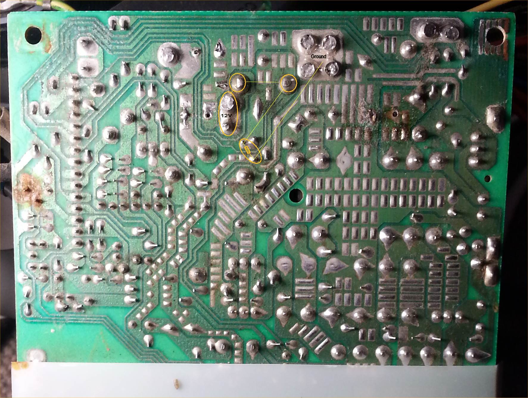

                              The caps measure 2480uf and 2676uf, (and 5268uf combined) out of circuit.
                              Have got a lot of 5V boards (not to mention older PSUs), so will likely stick wth the Lelon (after testing it)

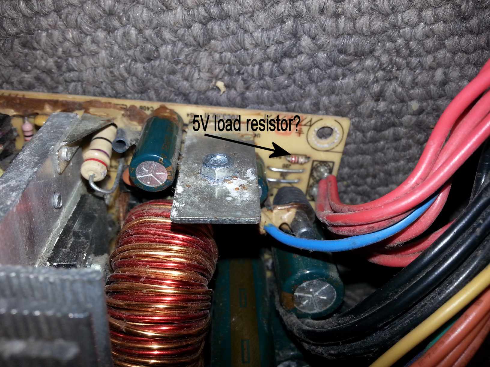

                              Am assuming that that load resistor is the big beige-coloured one, that is mounted vertically (also seems to have lost a bit of it's casing).
                              Looks like it's 27 ohms (and i get 27 ohms, measuring across it in-circuit) - which, after reading your comment, sounds far from ideal.
                              There is 200 ohms resistance between the 12V cable plugs, and ground (so am assuning that somehow more resistance gets added to the rail after the 27ohm load resistor)
                              What type of resistor (non-SMD) should i look for, and what rating. The 5v rail is rated for 12V @ 14A; so is that any resistor greater than 270 ohms that can tolerate greater than 168W?

                                    Any kind of varnish or lacquer should do. I often use nail polish (just don't use anything with metallic paint in it.) Hot glue should work in a pinch too (or any other glue that is not conductive, corrosive, and won't get damaged from heat and heat-cycling.)
                                    Yeah, that's not the resistor I'm taking about.
                                    I think I got confused with the part numbers of your HiPro, as I have a slightly different 250W version. Could you post a few more pictures of the PSU? Also maybe a PCB pic? That should help us a bit.
                                    Looking at my own pictures, it's the 300W and 350W models that have the resistor by the toroid inductor, but it's not at the edge of the PCB - it's near the center of the PCB, next to the toroid. Your PSU looks a bit different though, so it might not be there.
                                    With that said, don't remove that 27-Ohm resistor yet, as we haven't determine what it's for.
                                    No, shouldn't be that way.
                                    You probably have either 220 or 270-Ohm resistor on the 12V rail, which should be OK then. Reason for the lower resistance reading is because of the capacitors in the circuit (which, when they are large, will take some time to charge up, thus lowering the overall resistance) as well as any other logic circuits connected to the 12V rail.
                                    Might want to check the 5V rail resistance to ground as well. Anything less than what would seem to be a 47-Ohm resistor, and I'd suggest you increase that a bit (especially if you plan to use the PSU with a 5V-heavy PC, so you won't really need much of minimum load on the 5V then, as the PC will provide it.) Though, I don't think any of the HiPro PSUs I know to have a problem with the 5V rail load resistors. It's usually FSP and Deer that do.

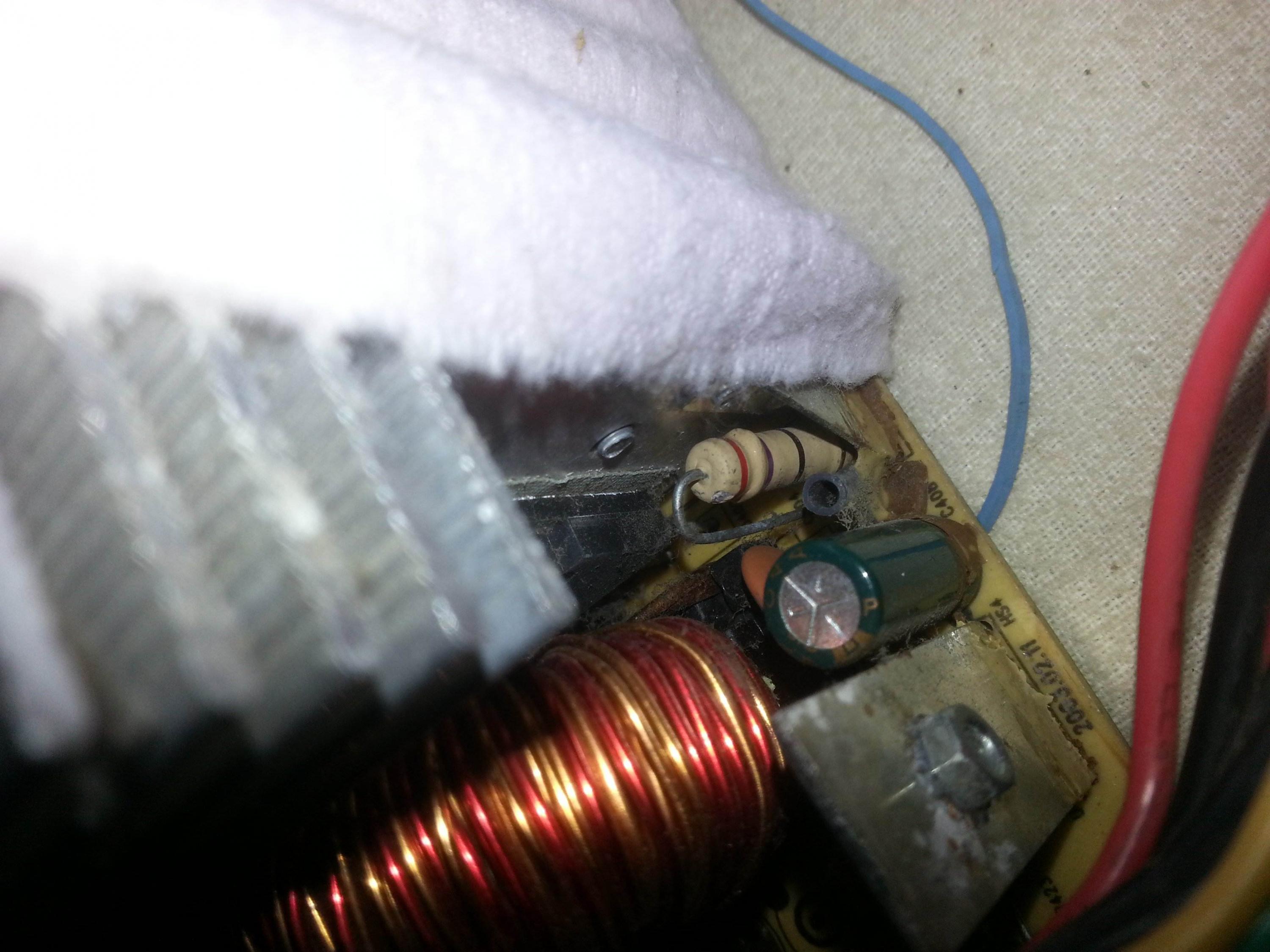

                                    And how does the load resistor, that is on the supply to the 12V rail, cook the first cap in the 3.3V rail? Is the first part of the 3.3V rail in series with that load resistor?
                                    That might not apply to your PSU. I will have to see more pictures to determine. On the latter 300W and 350W models, it does, because they have that resistor right where I stated by the inductor and next to the 3.3V rail input cap.

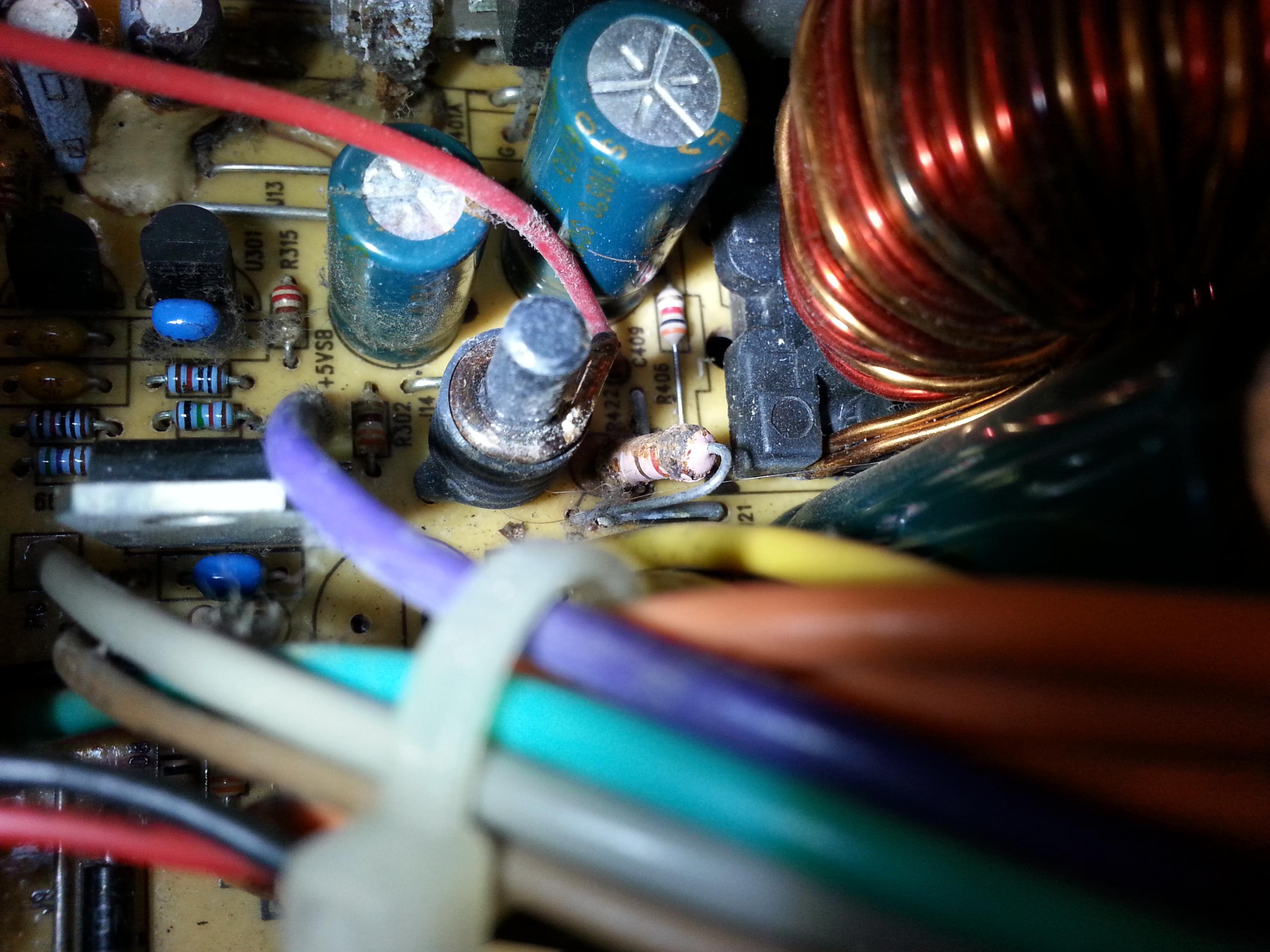

                                      Your'e right! There is 210 ohm directly across the 12V output.
                                      i was fixated with looking for a large resistor, which was reinforced because of the wrong high wattage that i had wrongly calculated.
                                      Looks like the top of it has suffered from some heating, and subsequent decay
                                      The designer must have desiginated the resistor there for some reason - what are the consequences of removing it and not replacing it at all?
                                      The 5V rail resistance to ground is 206 ohms, (and the 3.3V rail resistance is 520 ohms, and 12V is 209 ohms)
                                      So what's that larger 27 ohm resistor, that's on the other side of the torodial coil, for? One side is connecetd to ground and the other side goes through the brown ceramic cap that is next to it, and then goes underneath the large torodial coil base? Looks like that could do with being replaced.

                                        Re: Hipro D2537F3H - Teapo output capacitor replacemnt
                                        (was suspicious of 520 ohms on 3.3V rail, and just realized that makes a difference which way the test leads are, so black to ground = 285 ohms. Is there some diode being added to that when the meter leads are swapped? )
                                        And is this the reason why the physical size of the 220 ohm (load?) resistor, that is on the 5V rail, is so small compared to the 220 ohm load resistor that is on the 12V rail?:
                                        P=25/220=0.11W
                                        P=144/220=0.65W
                                        Getting back from that tangent, to the previous question... why does that 220 ohm load resistor, that is on the 12V rail, cook the first cap on the 3.3V rail?
