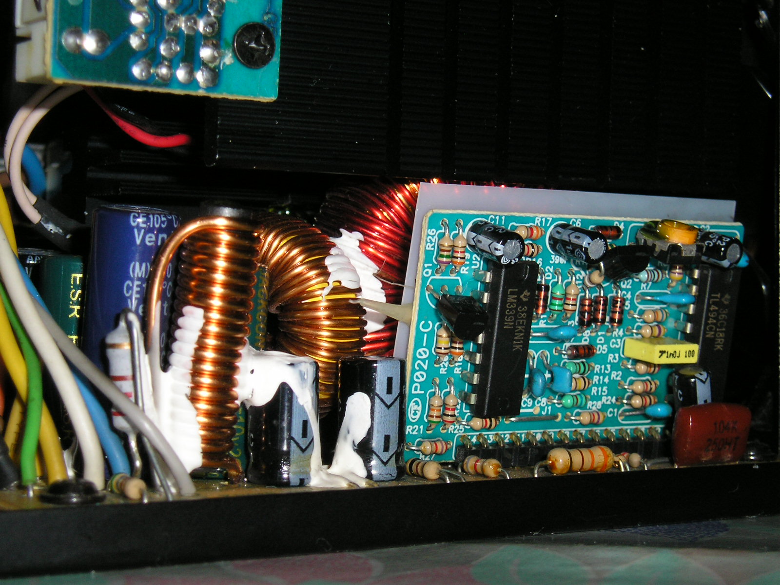

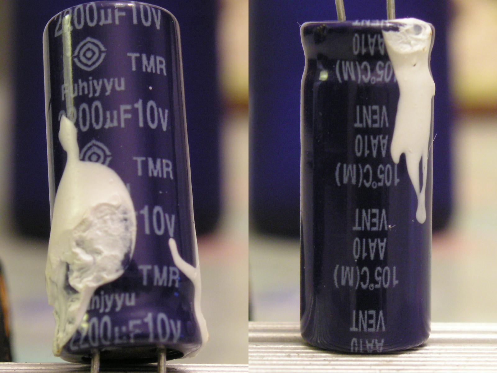

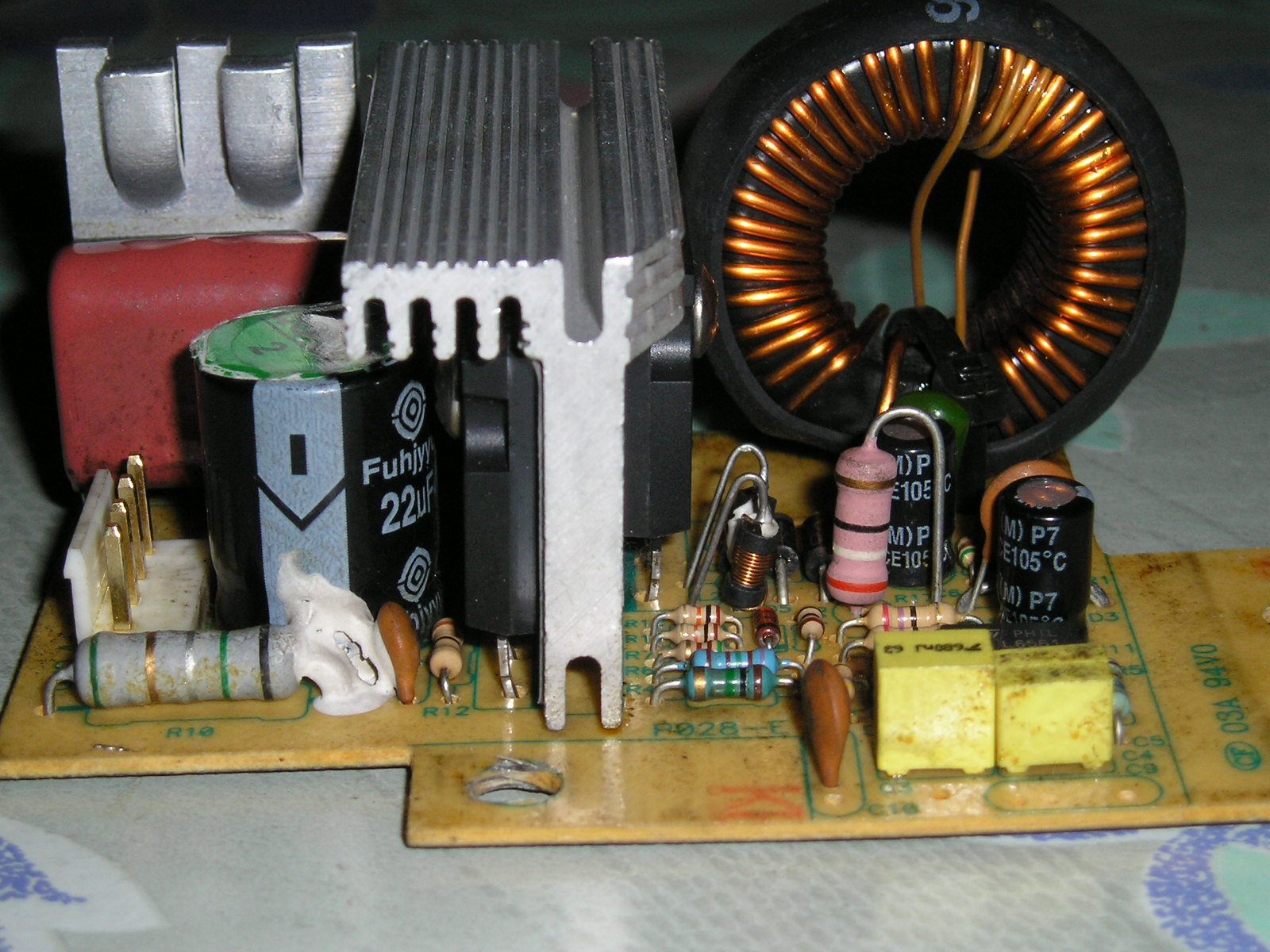

    Hello to all. This is my first post here, but i've been around even before I registered.
    I have this Tagan TG380-U01 unit which was working fine, but recently I opened it out of curiosity/boredom just to find it was full of Fuhjyyu capacitors, except the primary ones, I think. Also discovered that 2 of the 2200uf x 10v ones were bulging, so I replaced them with........ 2 JACKCON's I had around there (don't punch me, they were the only thing I had around).
    Of course I don't want to leave the JACK's and Fuh's in there, so I request if someone can give me any advice as to what caps should I buy to replace all those Fuhjyyu ones. Can motherboard capacitors be used as replacement in PSUs, or are some other capacitors recommended ?
    Also, should I replace all the smaller ones ? They're all also Fuhjyuu (for example, there's some 4.7uf x 50v ones amongst others).
    The PSU has:
    3x 2200uf x 10v
    1x 2200uf x 16v
    2x 3300uf x 10v
    2x 1000uf x 10v
    2x 470uf x 16v
    Thanks in advance.

    Re: Advice regarding Tagan TG380-U01 recap
    Those power supplies get very hot because they try to be very quiet...
    Now, if you consider that the caps are Fuhjyyu, you understand that there is high possibility to fail.
    If I were you I would fully recap it with Japanese capacitors only.

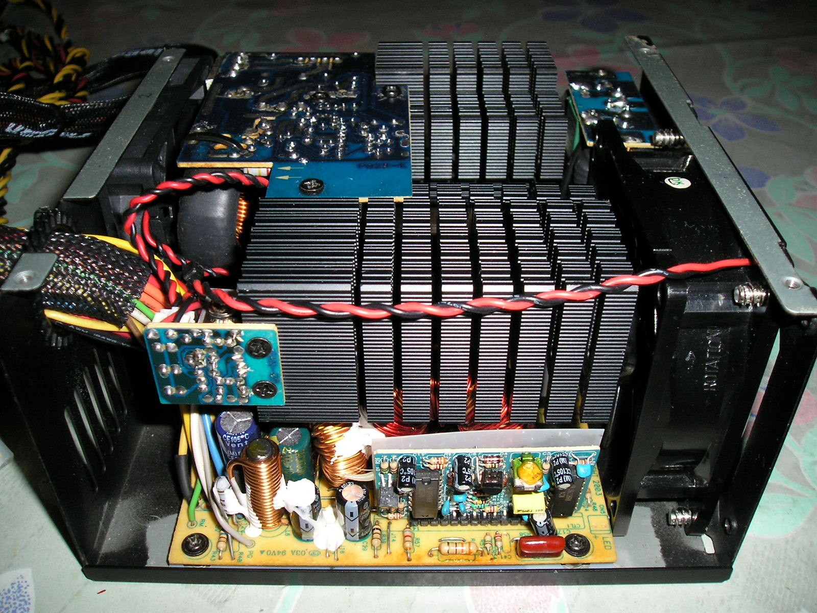

        i've recapped 2 of these (330/310W and a 380/360W just like yours). Used Panasonic FC and FM. those are a pain in the butt to recap due to the huge heatsinks and general crammed design, but well worth it.
        just make sure you replace ALL the fuhhuhfhkhuuhu's ... including the small ones (except maybe the really tiny ones like those on the controller board that sticks up in the 2nd pic)
        if you don't care about how silent it is, i'd recommend rewiring the fans to 5V or 7V.. these things get really toasty..

            There's also a "big" capacitor on the little PCB that's mounted above the heatsinks. I can't see it well, but it seems to be a Fuhjyyu 22uf x 400v, MK series, 16x22mm.

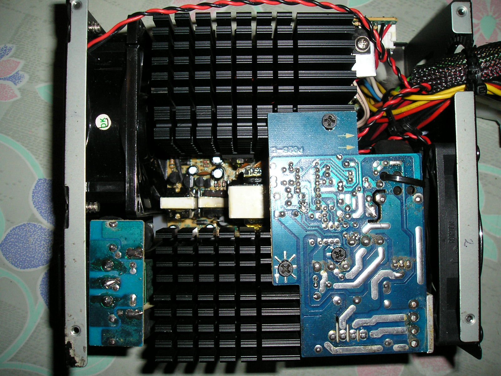

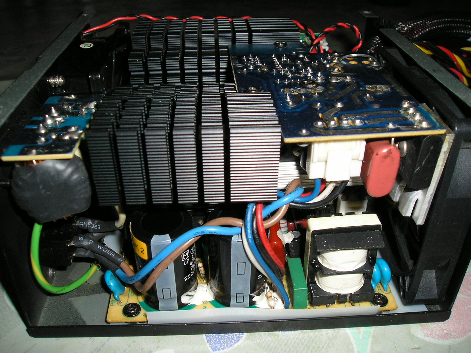

              A friend of mine gave that Tagan to me:
              https://www.badcaps.net/forum/showthread.php?t=12484
              Due to extreme heat, every cap on it was dead, I mean every cap, including the 2 big primary caps, Panasonic 85C.
              The primary transistors were blown too.
              I decided not to recap it, because it would be a very difficult and expensive project (do you know how much those big caps cost?) and the output of my effort would be a 330W Power Supply with a single 18A 12V line...
              I don't intend to discourage you repairing yours, I just say that a full recap is necessary, and a mod at the fan controller circuit would help the new caps last...
                That's the pfc circuit. That cap needs to be replaced. Fuhjyyu are so bad that even their high voltage caps fail...

                          Then, where can I get that kind of replacement for that "big" capacitor ? (I checked here in badcaps store but it doesn't seem to be that kind of capacitor).
                          On ebay, I searched only members egekecu and audjade_chn. I think I read here in somewhere that those were "trusted" sellers. Maybe I made a mistake.
                          Even if those sellers sell fake ones, are those ones I mentioned correct replacements for the Fuhjyyu one ?

                                About the big cap, you can try digikey, mouser, or ebay sellers that scenic recommended. That capacitor is not low esr, general purpose, probably 85C, but you should try to choose a 105C one.

                                  Scenic: yes, those are exactly the sellers I searched for. I read here in badcaps that those were "trusted" sellers aware of the fake caps. Maybe I read a post of yours about it.
                                  About those 22uf 450V caps, I'm still not sure. Are those correct replacements for the Fuhjyyu 400V one ?

                                    these two should do just fine for the 400V 22uF fuhuhufhuf*ckyou cap (well.. if they fit)
                                    http://cgi.ebay.com/300381786398
                                    http://cgi.ebay.com/300456352348
                                    i'd suggest looking for a cap source with all or at least most of the caps available. no point in buying from 5 different sellers or something (shipping costs)
                                    if you go for the badcaps store for most of the caps, maybe shoot topcat a PM if he has the other needed ones too?
                                    edit: you could also ask big pope for samxons, allthough that would require a bit of comparing the ESR and ripple, as i'm not too familiar with those (as in i wouldn't know out of my head which samxon series would be comparable to for example panasonic FM, FK, FC etc.)
                                    http://capsmod.net/caps/
                                      Those were exactly the ones I mentioned earlier. Only the BXA seem to fit though. Thanks for your confirmation and tip. If I buy from ebay, I'll probably buy all that I need from that seller.
                                        Rubycon BXA datasheet:
                                        Nippon Chemicon KMF datasheet:
                                        https://cdn.badcaps-static.com/pdfs/...a9532291c7.pdf
                                        The BXA series endurance is 12000 hours, while KMF is 2000 for the specific cap you try to replace. I would get the BXA.
