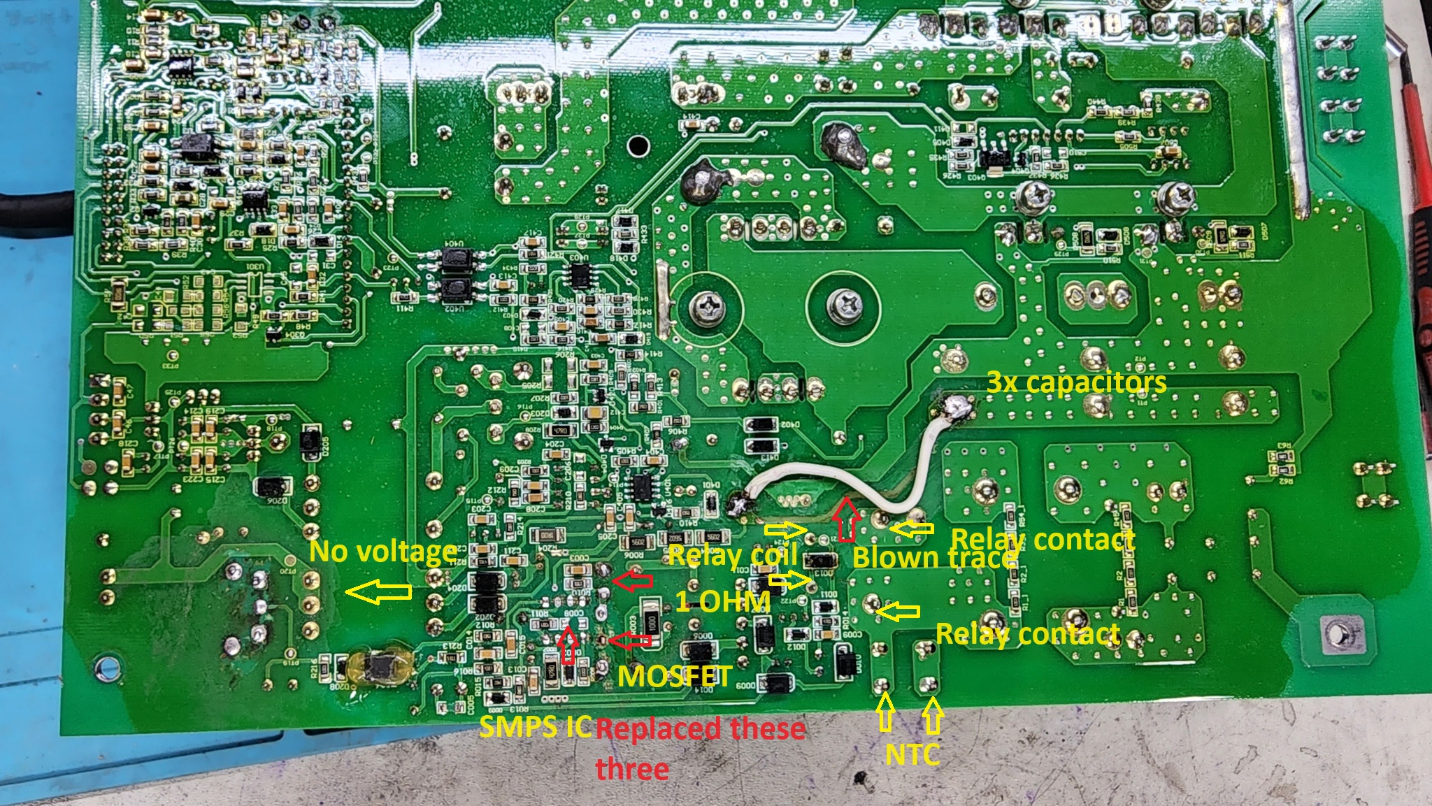

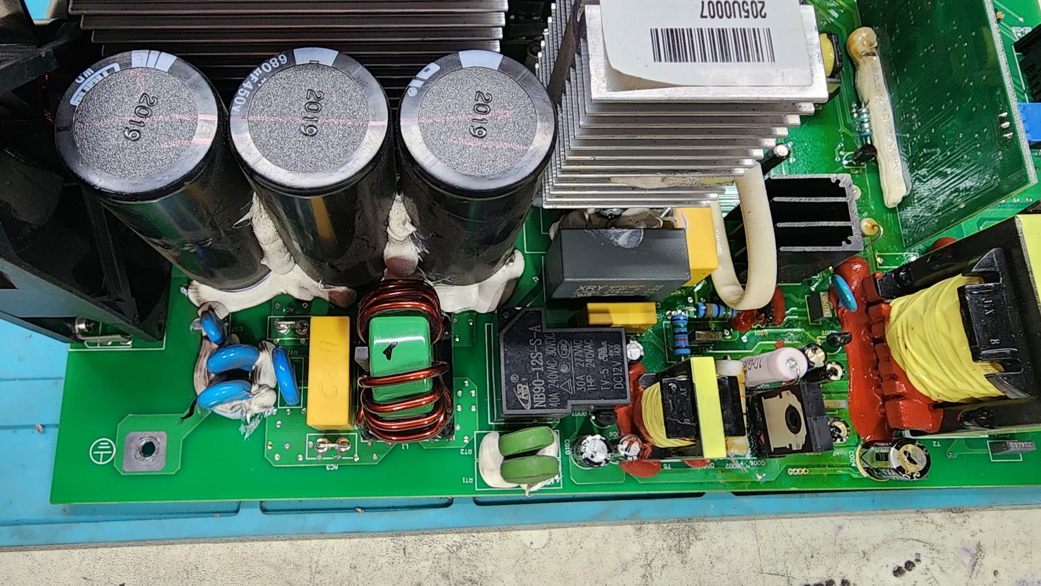

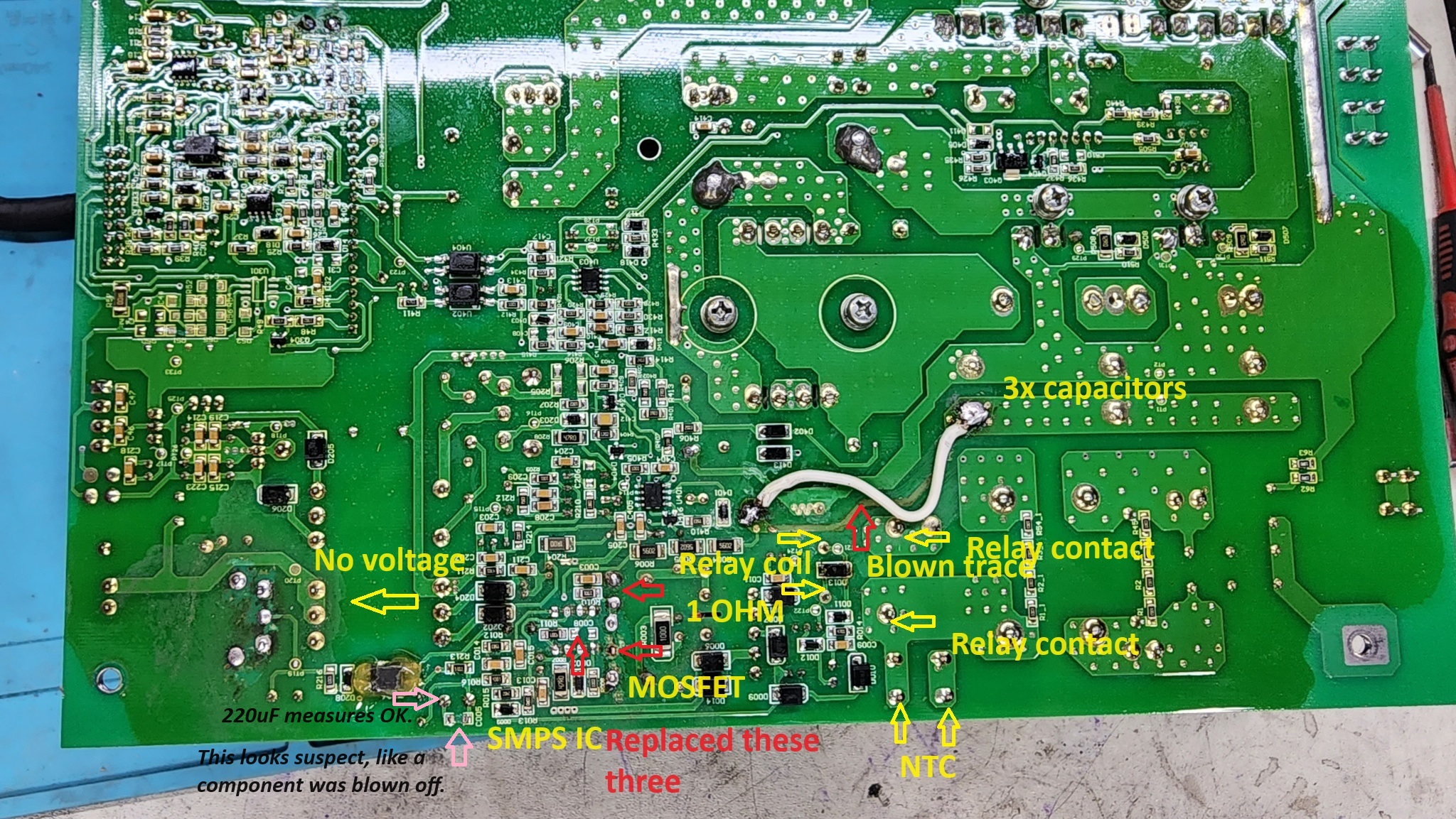

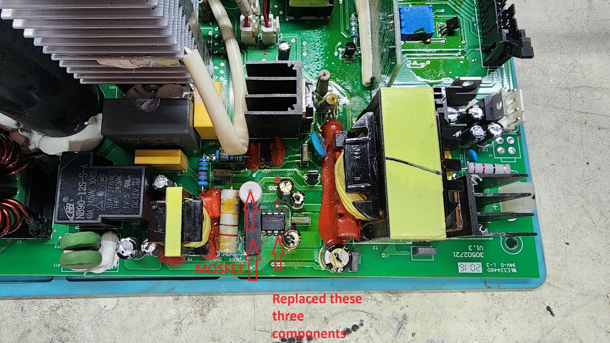

    This is my own welder, that blew up while welding. There is no warranty on it. Purchased it a year ago, sealed box from Craigslist.
    It worked great until now, about a year.

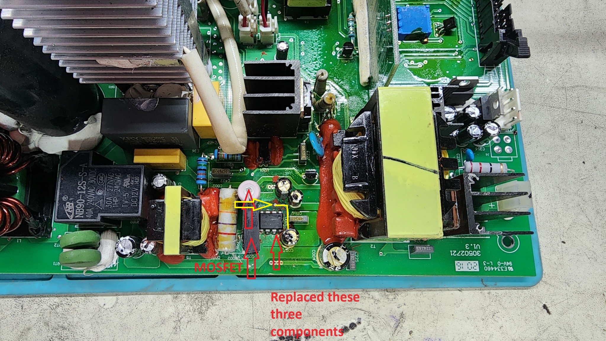

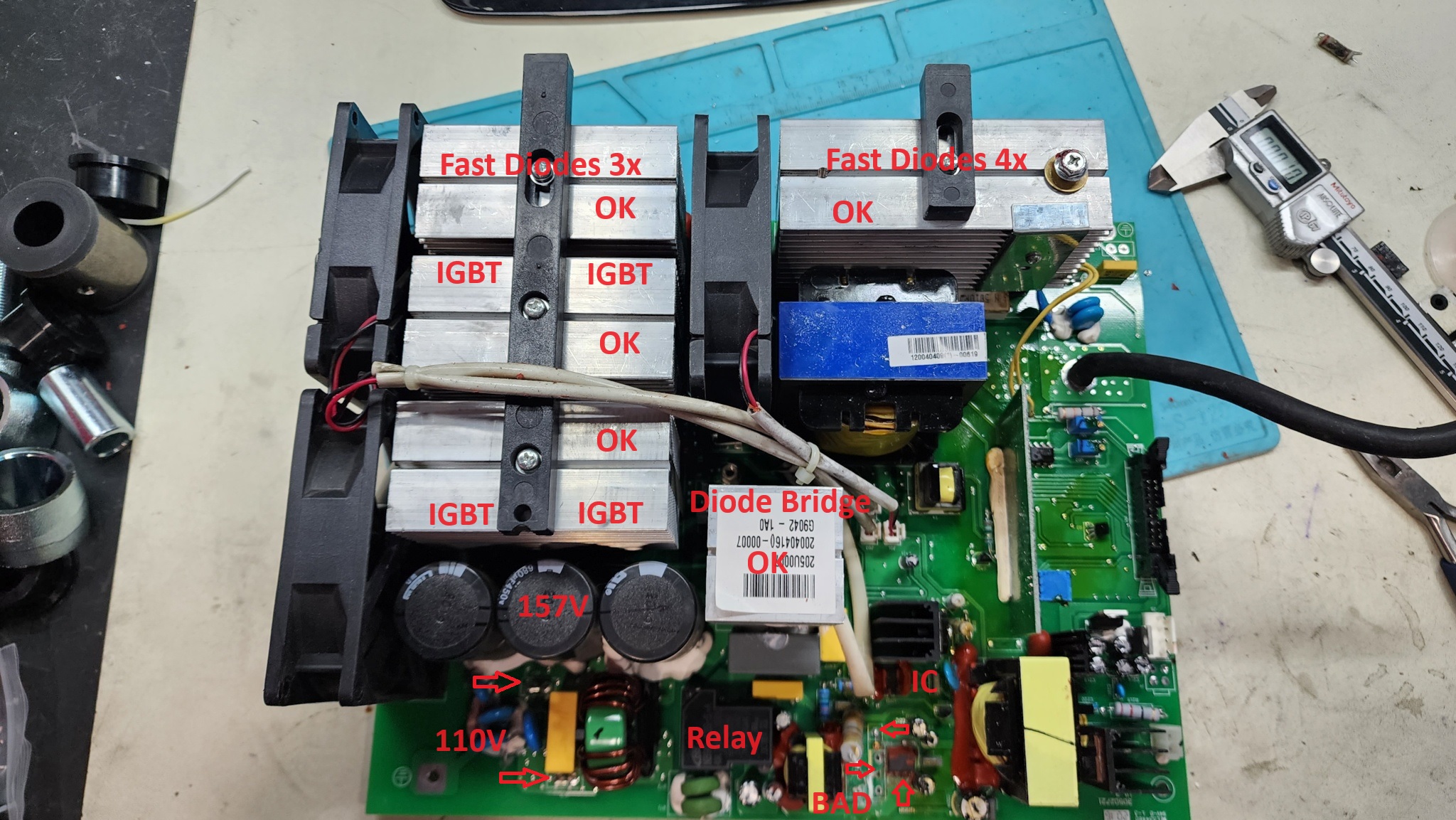

    What I have found is a blown trace next to the main capacitors, it seems like also got damaged the SMPS IC, output MOSFET and a 1 Ohm resistor to the ground from the MOSFET.
    After replacing these components, the relay, fans turn on and it sounds like it's working, but there is no output voltage for the welder, LEDs do not turn on.
    So there are more components that are damaged.
    I'm having a hard time taking measurements, since there are quite a few transformers and I'm not sure from where to get ground at each stage.
    I have never repaired a welder before, only TV/receivers/laptops, etc.
    It seems like the low power supply is working, but nothing after that. Or maybe I still have some bad components in the low power supply.
    The three capacitors next to the blown MOSFET show there value, did not check ESR though.
    Fast diodes on the heatsinks, and IGBTs are not shorted.
    I can't find a service manual either.
    Any help would be appreciated very much.

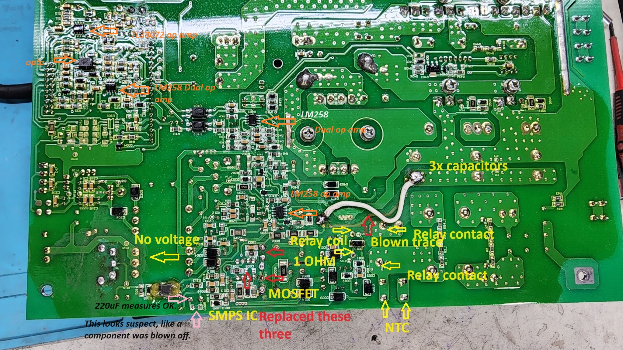

    Re: Lincoln Electric LE31MP welder not turning on
    I can tell you this much that everything is o.k. including the main filter caps. This looks more complicated than one of these Chinese cheap welders. However I'd say they are similar if you compare them. This gives you a little idea on how this thing works.

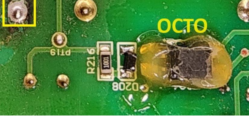

      • petehall347
        • Jan 2015
        • 4451
        • United Kingdom
        d208 dont look happy
        • tibimakai
          • Jan 2012
          • 3680
          I have seen a few this way. It is not from manufacturing?
          I will check it out again, I think that I have checked it out already and it seemed good.

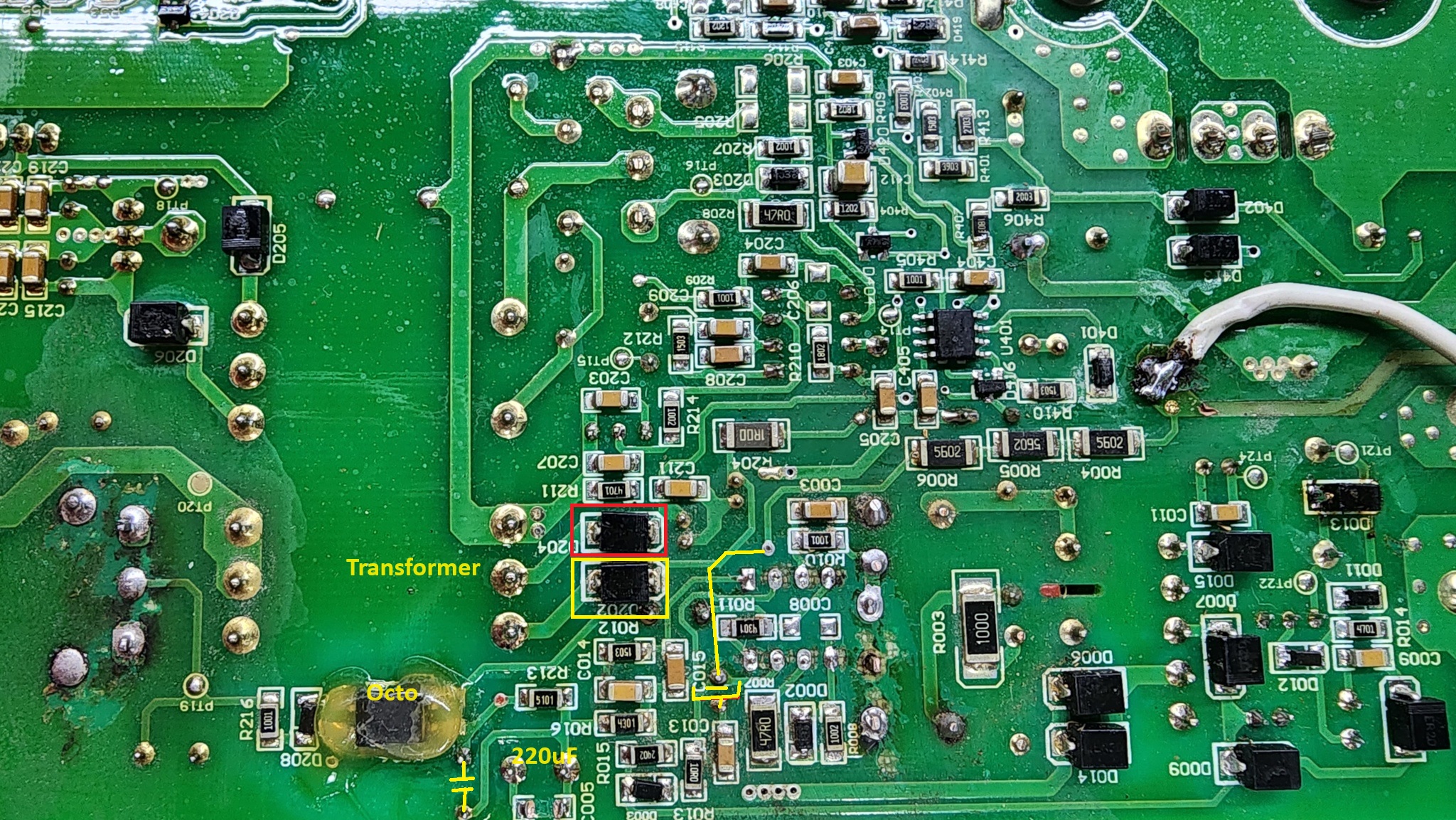

          To me, it seems like I'm not getting the voltage across the transformer. Maybe missing oscillation?

            does the relay bypass the inrush NTC's?
            if it does - is it working?
            • tibimakai
              • Jan 2012
              • 3680
              Yes and yes. I have 14V there for the coil.
              I believe that is all that is working right now, and powering the three fans also.
              I'm not getting the other low voltages, that are powering the "display"(LEDs) and most likely other important sections.

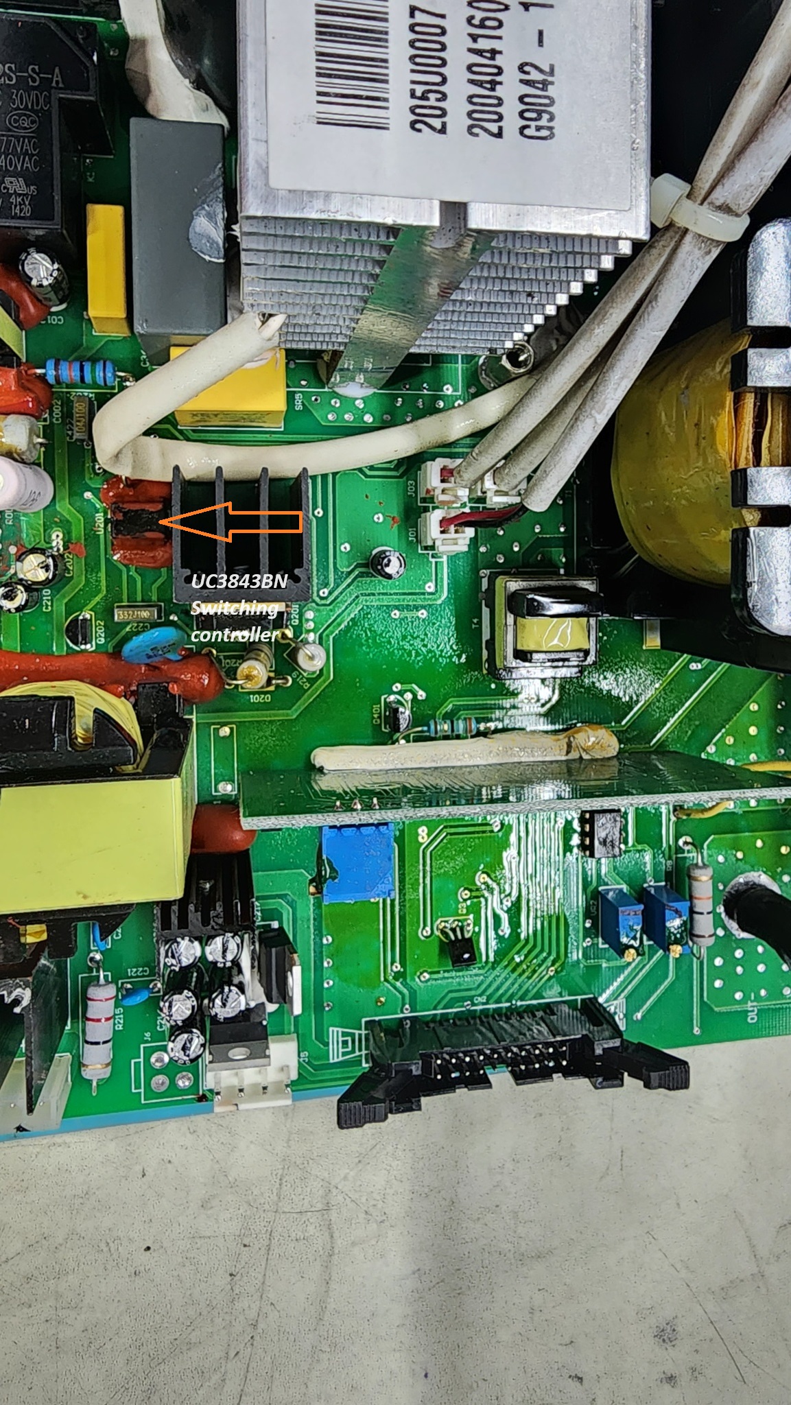

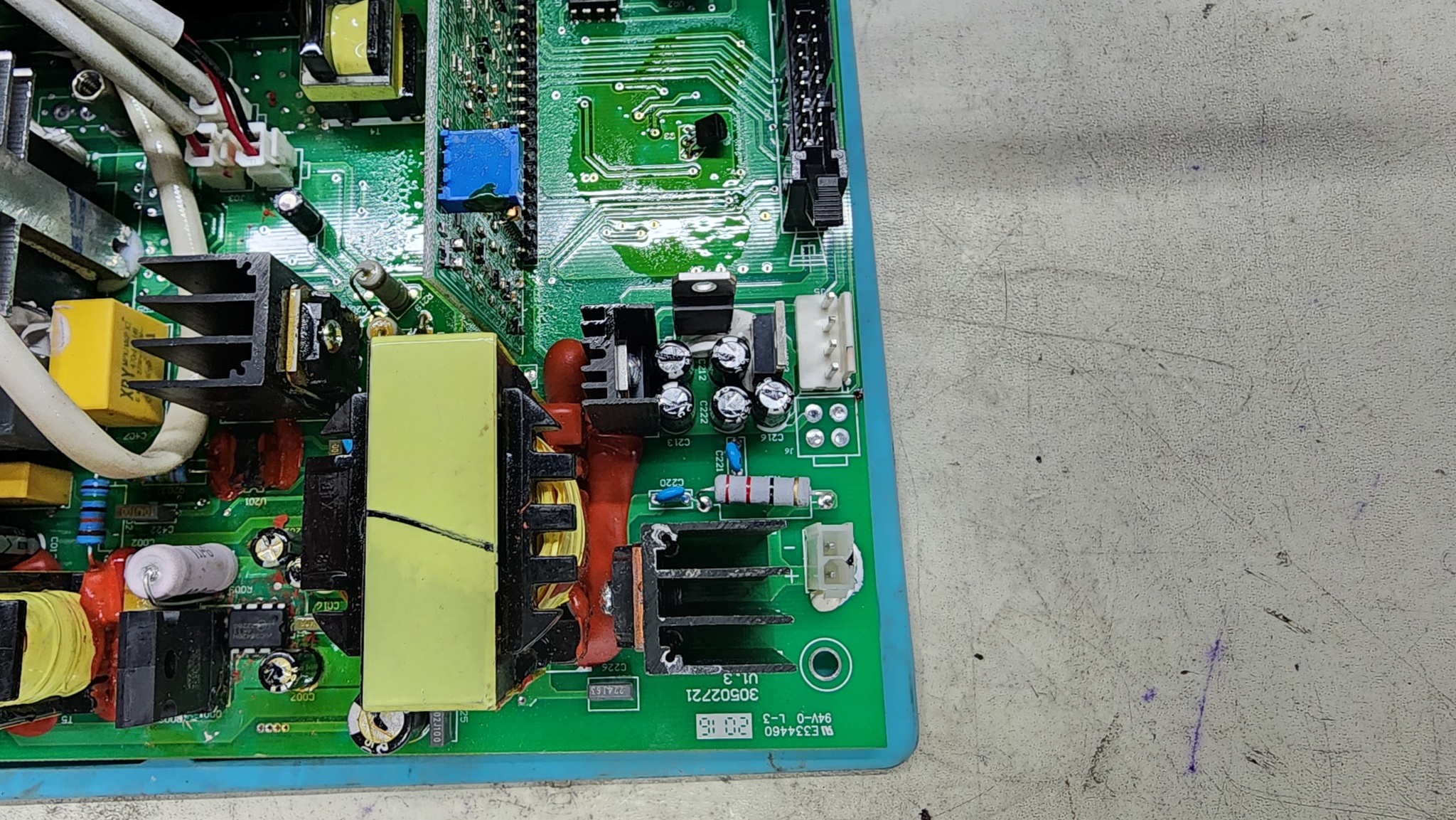

                That diode looks good, it shows 0.7V.

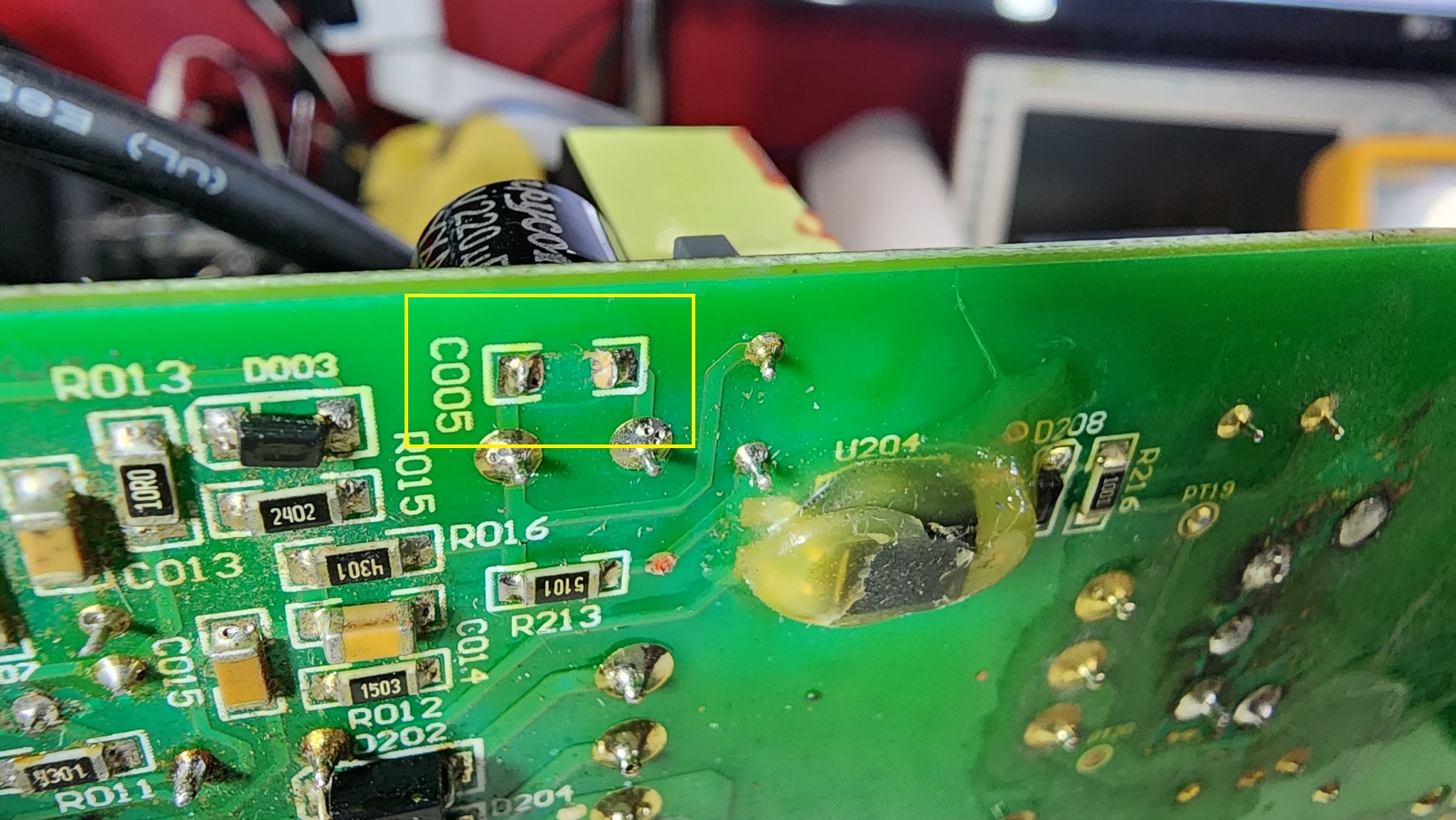

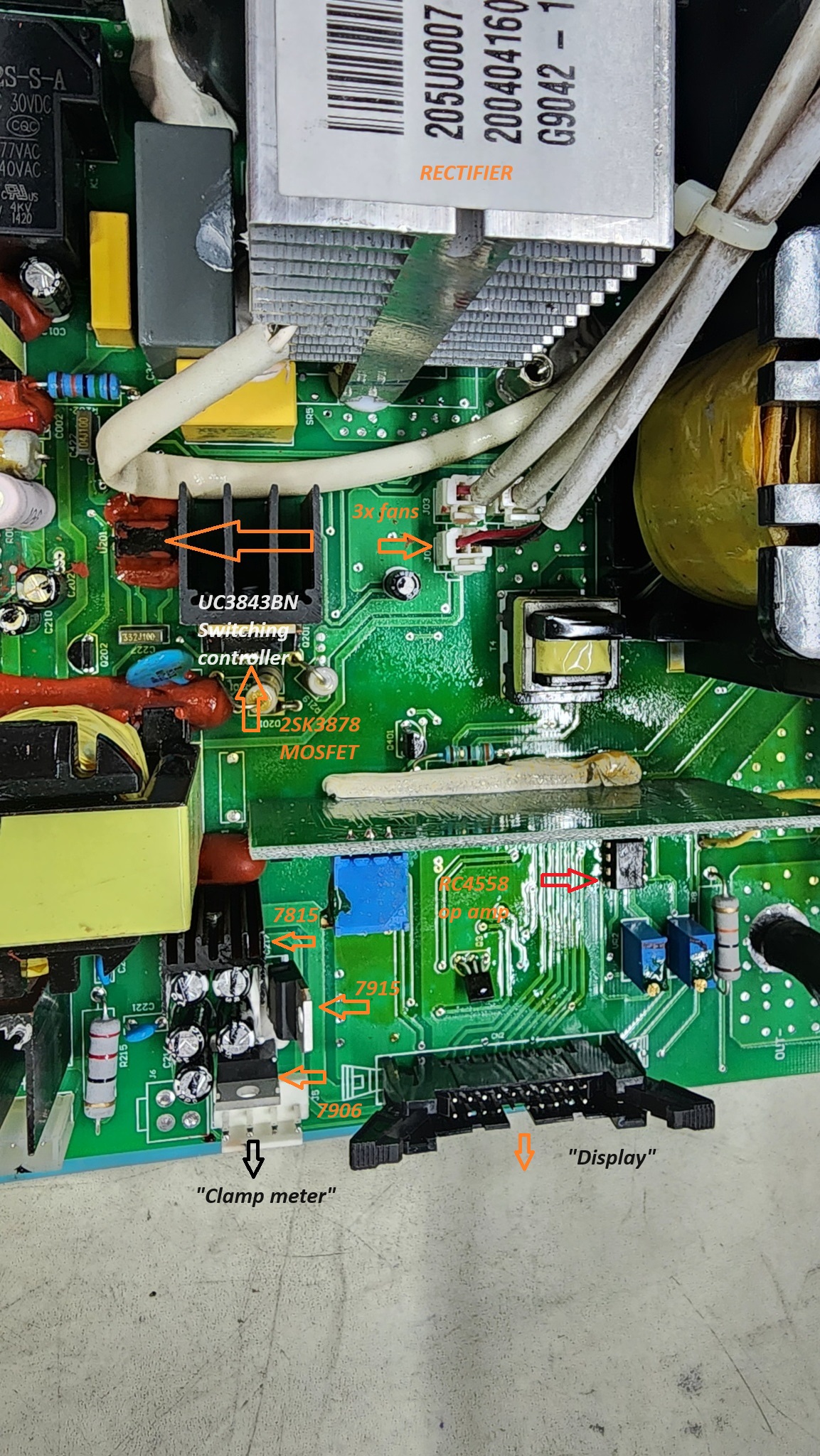

                I have found a component(C005) that seems like it was blown off.
                It could have been a capacitor there?
                U201 next to the black heatsink, is a UN3843BN switching controller.
                By the way, the IC that I have changed, is a UN3842BN it's a DC-DC controller.
                https://www.digikey.com/en/products/...3842BNG/920377

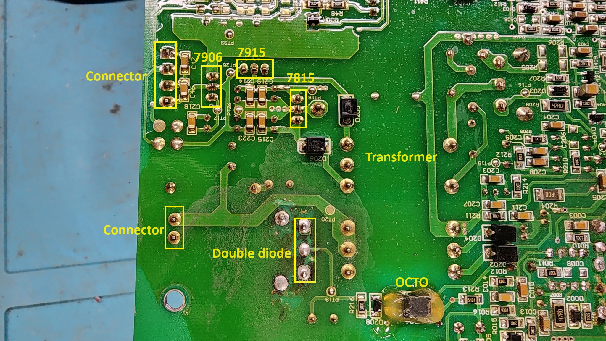

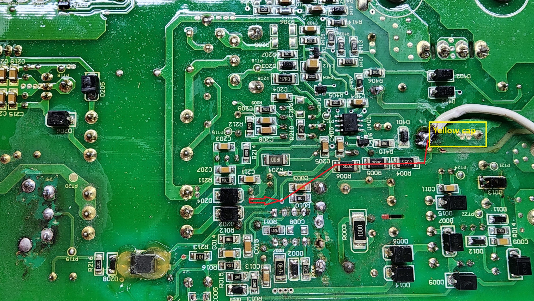

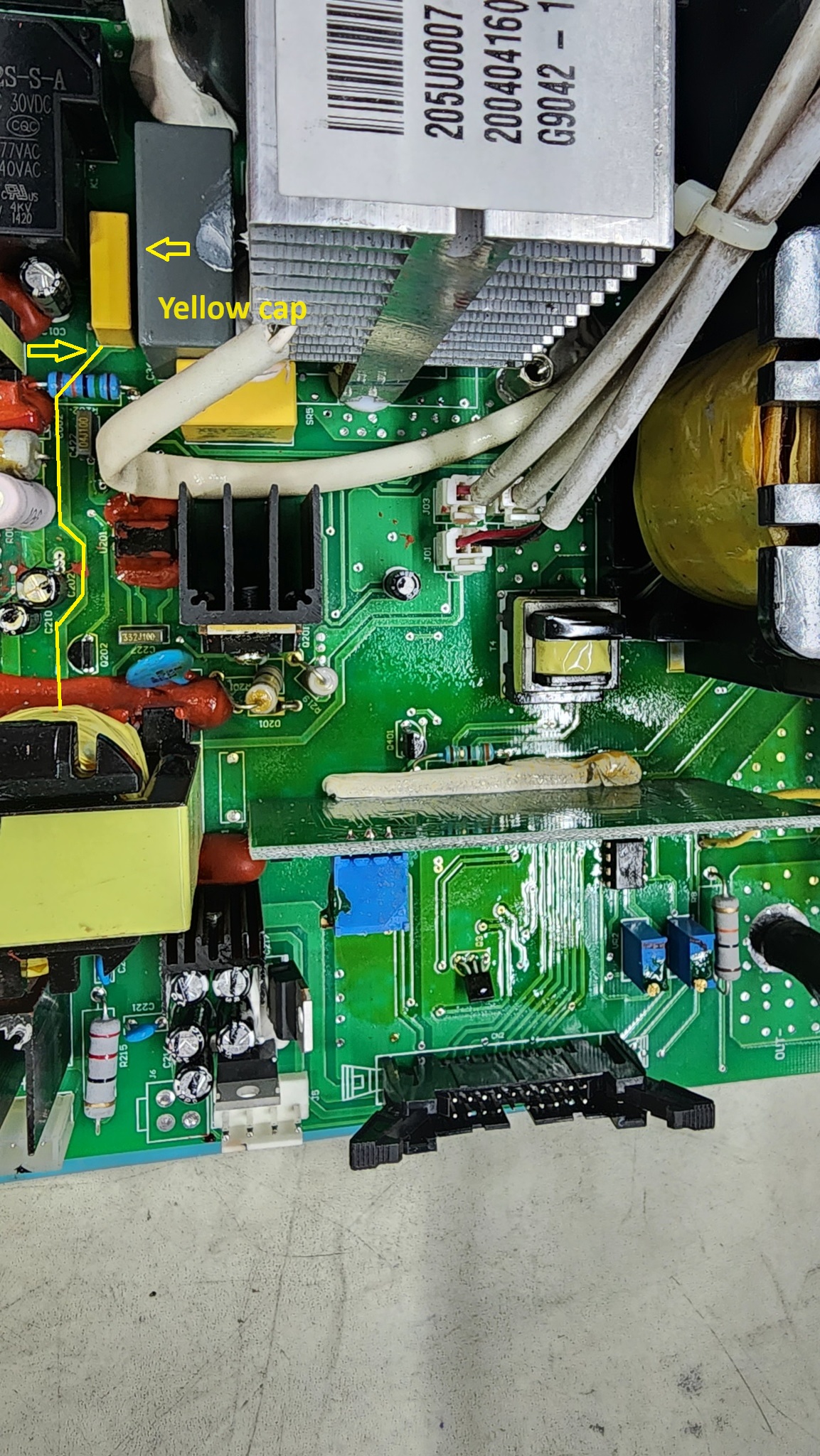

                      That blown trace… one side is rectified mains and where does the other side connect to?
                      • tibimakai
                        • Jan 2012
                        • 3680
                        Here are some pictures to explain where it goes.
                        I'm not in front of the board, so I'm using the pictures and I'm assuming that it goes to the transformer and the other end to that capacitor, goes through a via. Most likely I should replace that, right?
                        • CapLeaker
                          Leaking Member
                          • Dec 2014
                          • 8352
                          Something drew a tremendous current to blow up the trace. I just wanna see what else is on this trace that may be open, the via o.k. etc. kind of odd where the trace blew. On the bottom of that trace are 3 resistors in a row. Are those o.k.? Is there something wrong with the X2 cap above the relay?
                          • tibimakai
                            • Jan 2012
                            • 3680
                            That capacitor is installed in a way that I can't read the value but it measures 2.22mF, the gray one behind it is a 2.22uF and measures 2.22uF, the other big yellow is 470nF and it measures 2uF-that one is weird.
                            The three resistors are ok 3x56k. They are going to the pin #7 of the IC, that I have replaced. That same line goes to C007(right lower corner of the IC.
                            Please check the pictures.
                            Eventually it ends up at the octo at the bottom of the board, after going through the big(220uF) cap.
                            Another thing that I have measured that seems a bit off, is one of the big diodes at the bottom D204, one way measures 0.4V and the other way 0.8V. Maybe it is leaky?
                            The D202(same diode-ER20) measures 0.4V and the other way is 2.2V.
                            I did not have time to remove and measure properly.

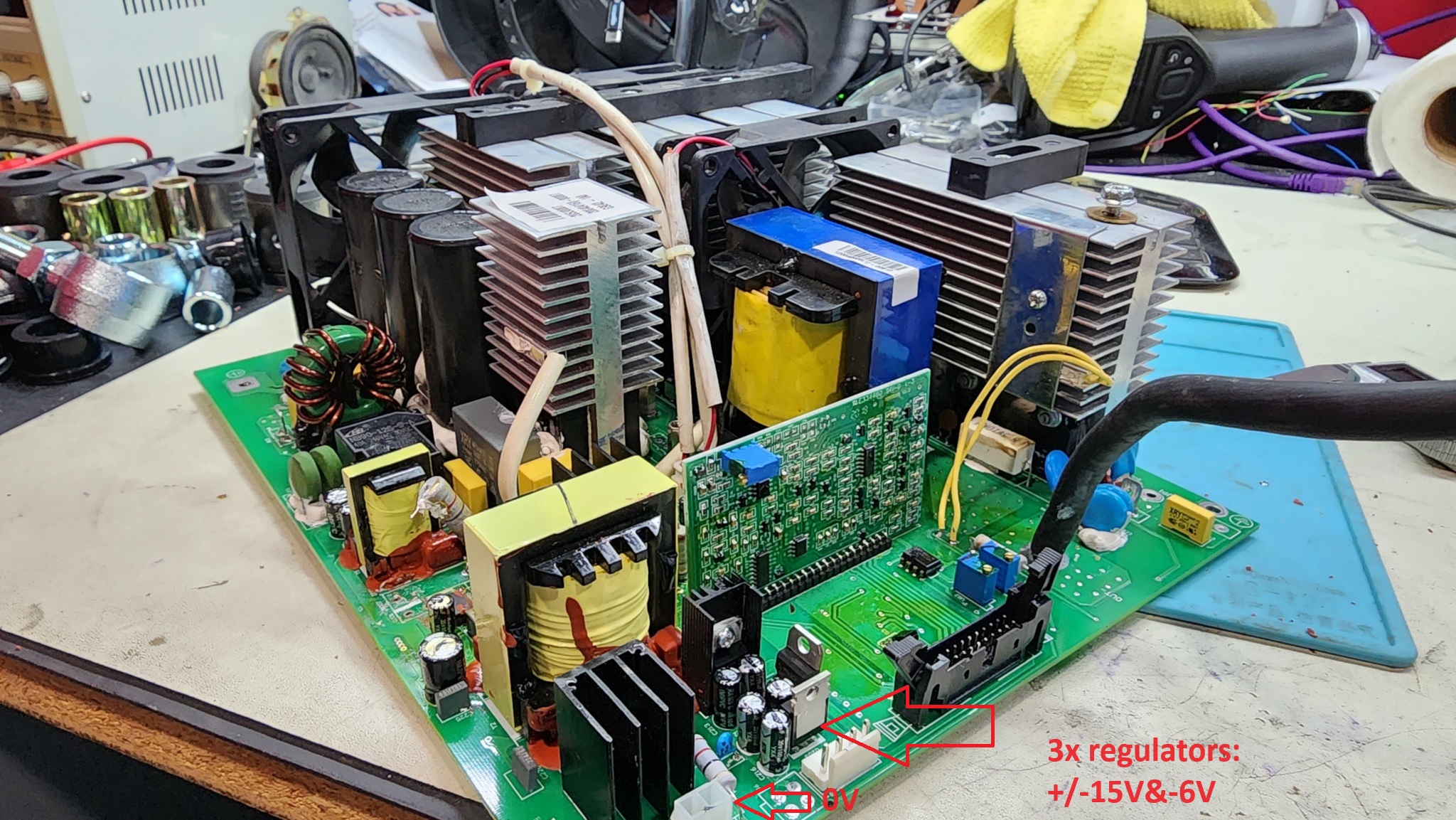

                                I have removed both diodes and the 470nF capacitor, and they are OK.
                                • tibimakai
                                  • Jan 2012
                                  • 3680

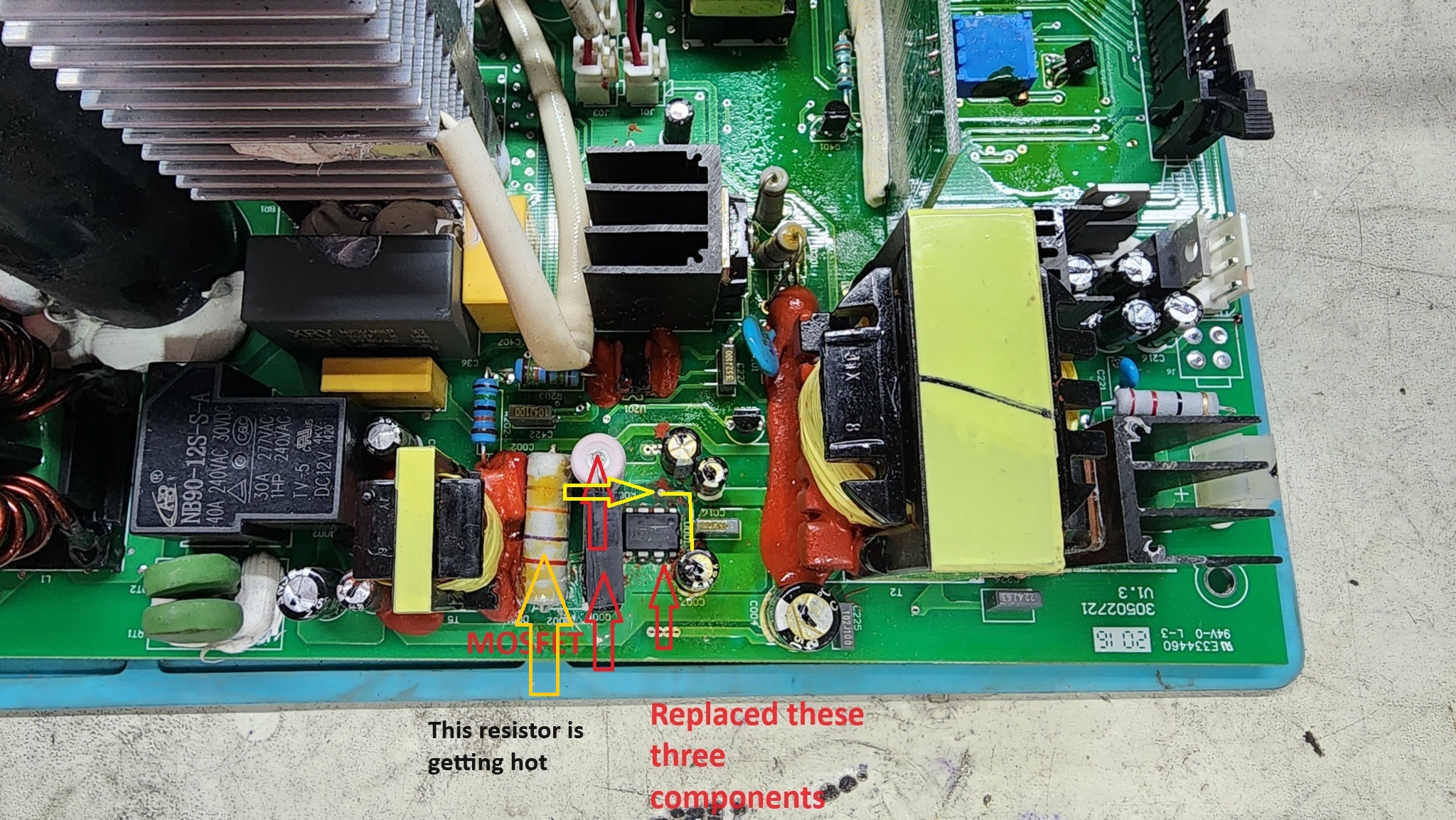

                                  There is another SMPS PWM power supply next to the one that I have repaired, that is not powering up.
                                  I have measured 0V at each IC pin(UC3843).
                                  Needs more time to figure out from where it's getting power, in the weekend I will trace it out.
                                  There is a resistor that is getting quite hot(~86C).
                                  • CapLeaker
                                    Leaking Member
                                    • Dec 2014
                                    • 8352
                                    Lucky U! If it’s gets that hot, there is a short. You should have fairly good going then.
                                    • tibimakai
                                      • Jan 2012
                                      • 3680
                                      I'm checking with the thermal. I may have to pay more attention to that area, maybe there is another part that is hot, but because this resistor creates so much heat signature, maybe I can't "see" with the Flir the offending part.
