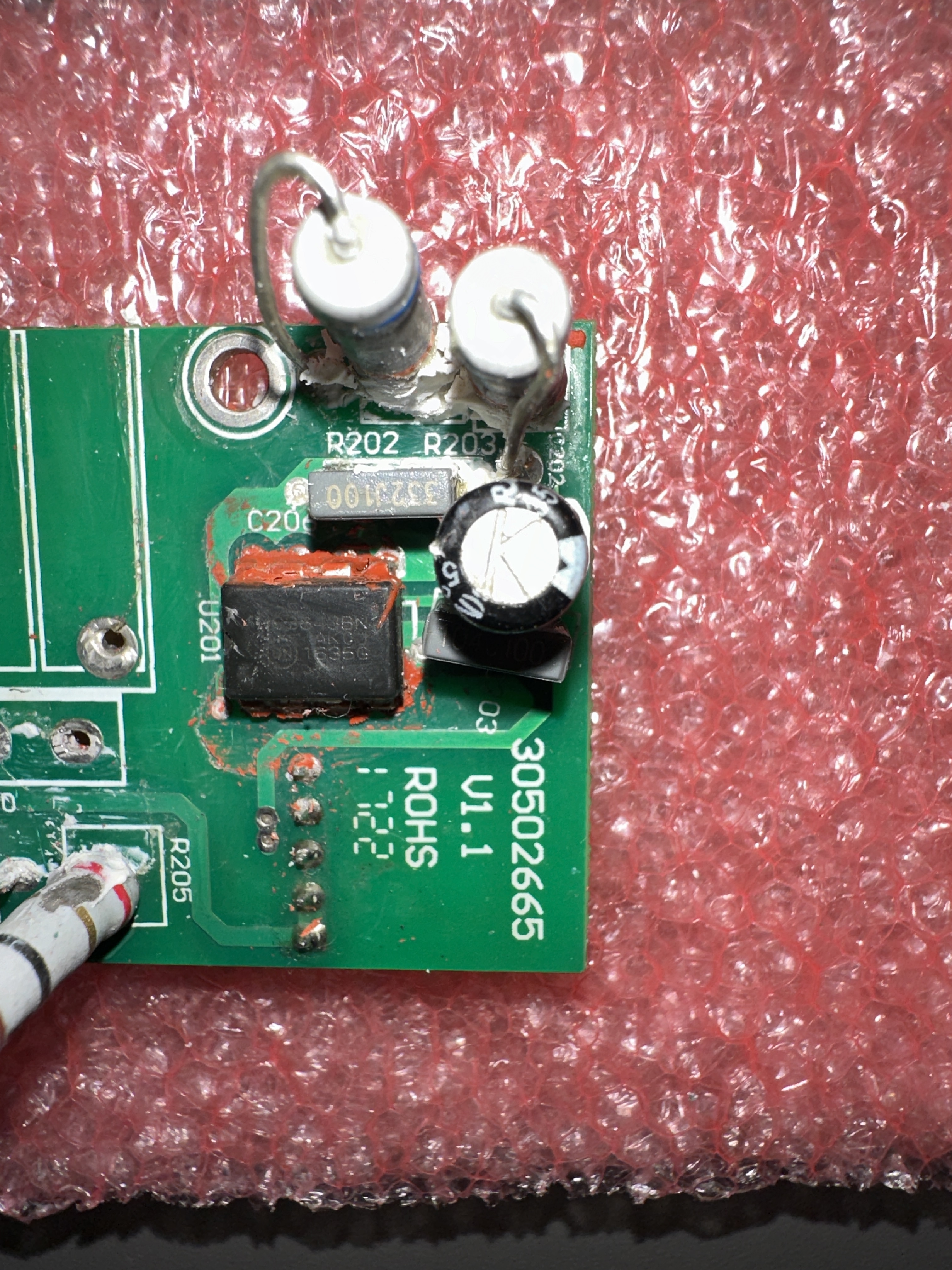

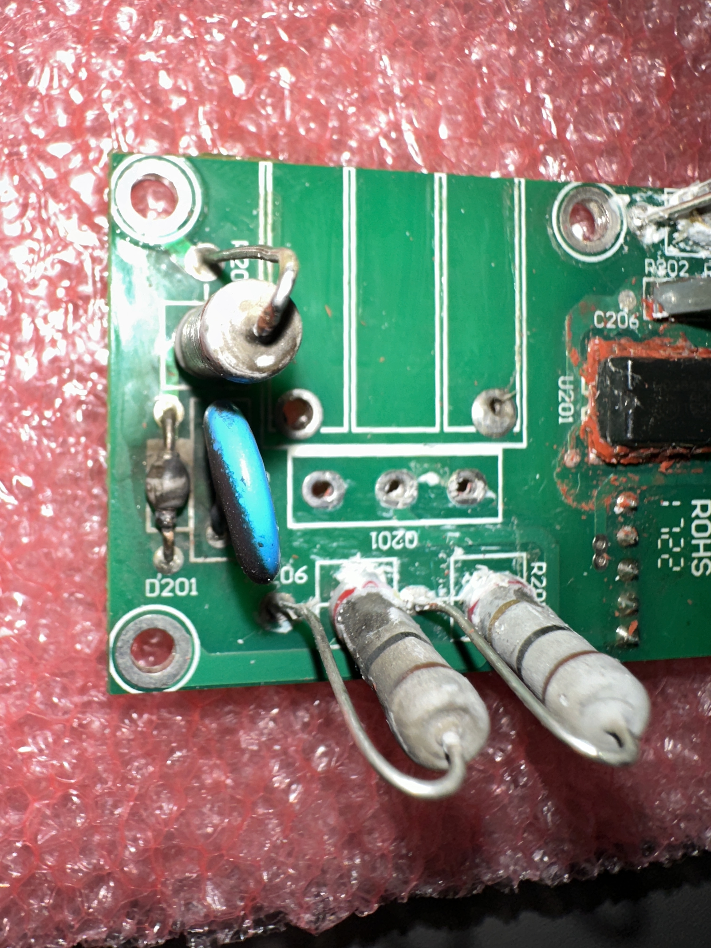

    Hello people. I trying to repair my welding machine oerlikon citomig 180mp hpf and there is a little board with blown stuff.The problem is i cant identify the value of the blown resistor and diode. Any suggestion?
  • CapLeaker
    Leaking Member
    • Dec 2014
    • 8351
    I guess you got 2 choices.
    A: Replace the board as a whole
    B: Maybe you are lucky and find the datasheet from that 8pin DIP IC (gate drive) and see what the example circuit has to offer.
    Chances are you going to need that IC anyway, since the Mosfet blew and shorted to the gate drive.

      The 8pin IC is UC3843BN. And yeah the mosfet is shorted source to gate.​

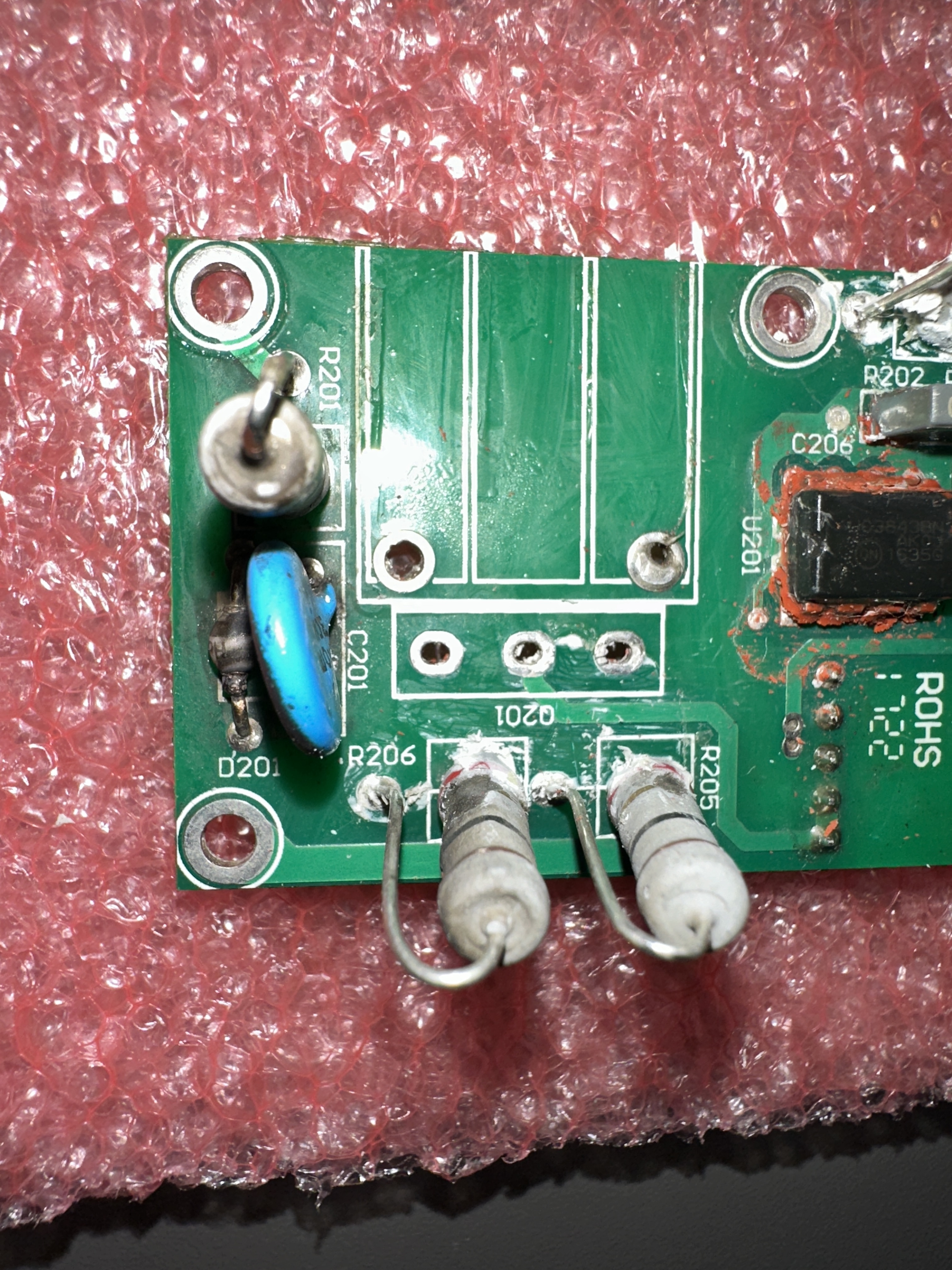

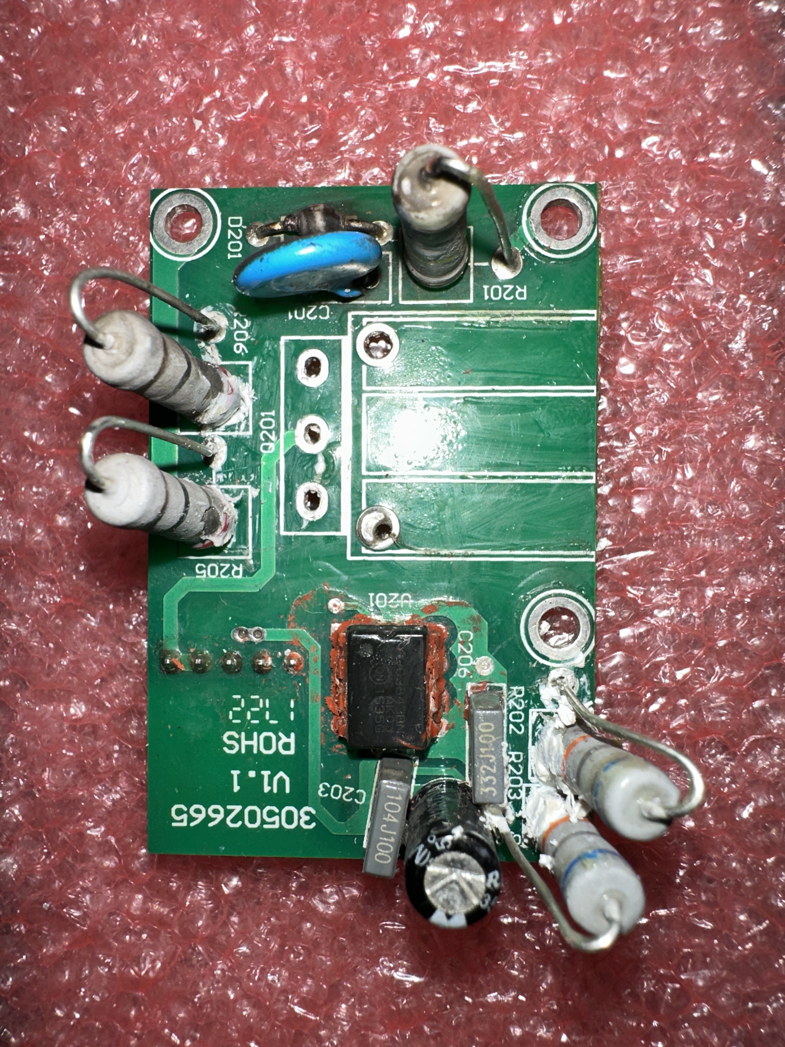

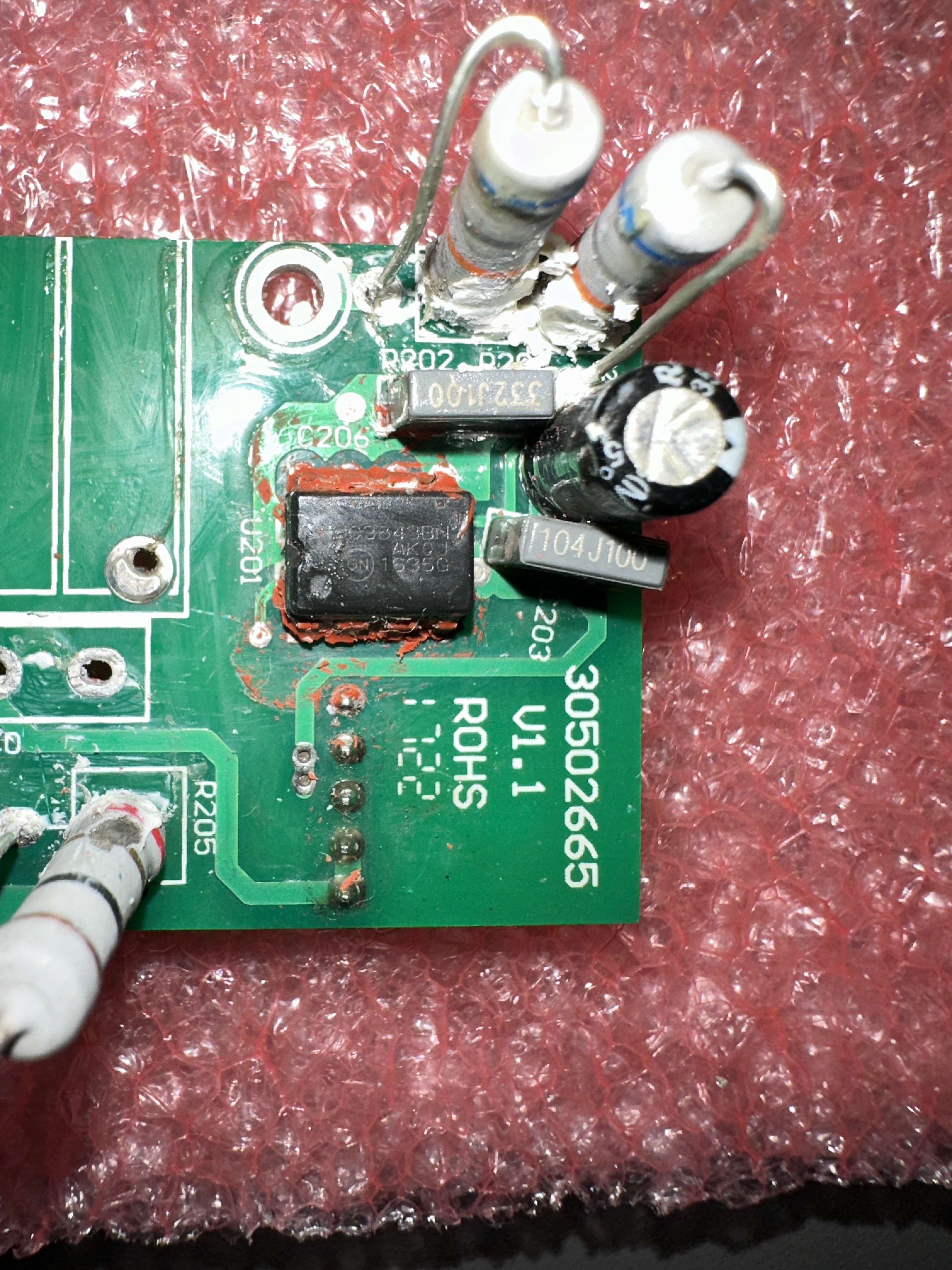

            Pin 6 is VCC so that bigger resistor can’t be that high in value. Pin 7 is the destroyed gate drive with the smaller resistor and diode. The diode isn’t that critical but the gate drive resistor doesn’t have to be bang on, but should be as close as we can get it.
            What was the mosfet? Upload a straight shot picture of the board from top.
            • Olles4
              • Apr 2022
              • 63
              • Slovakia

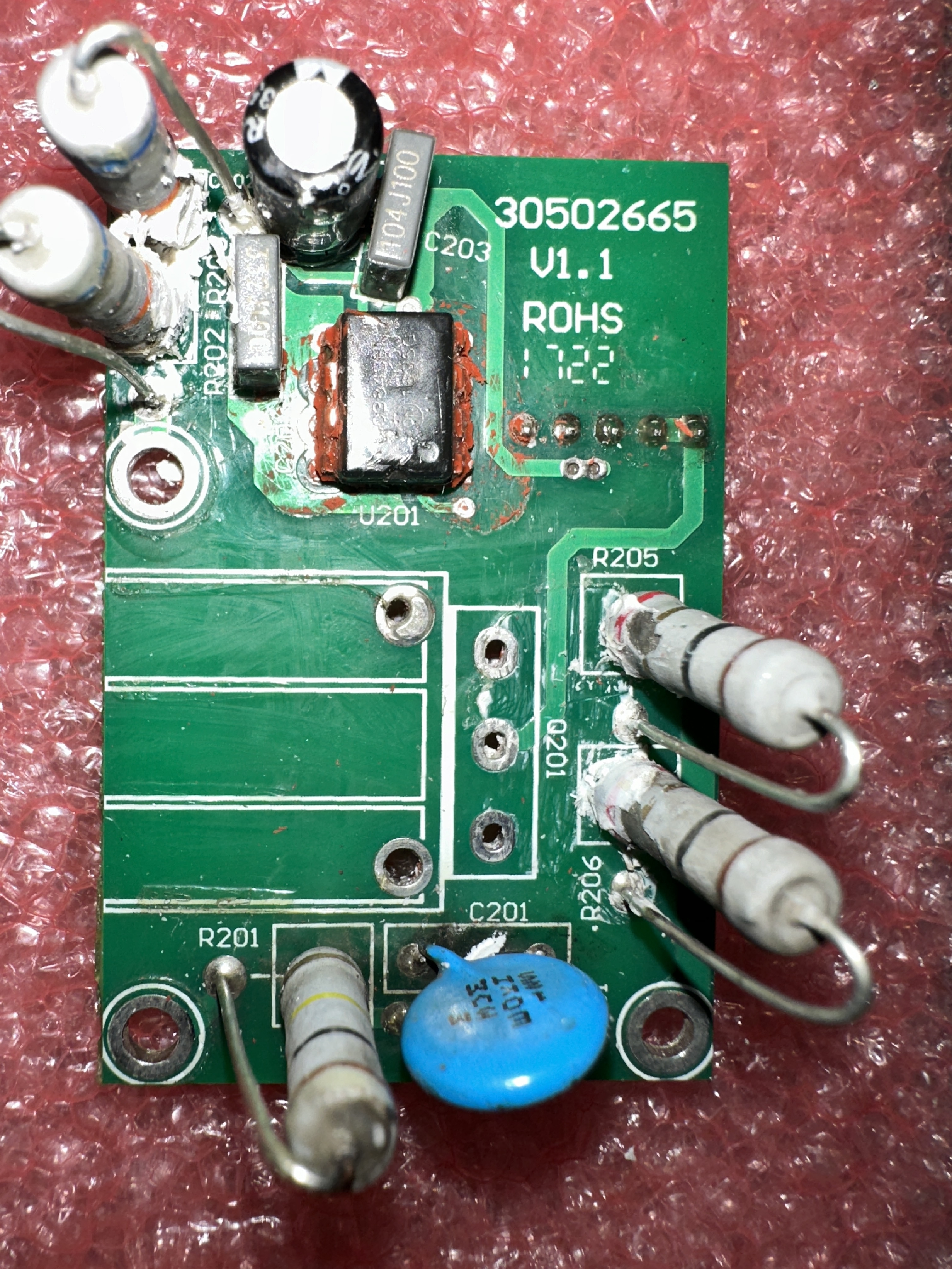

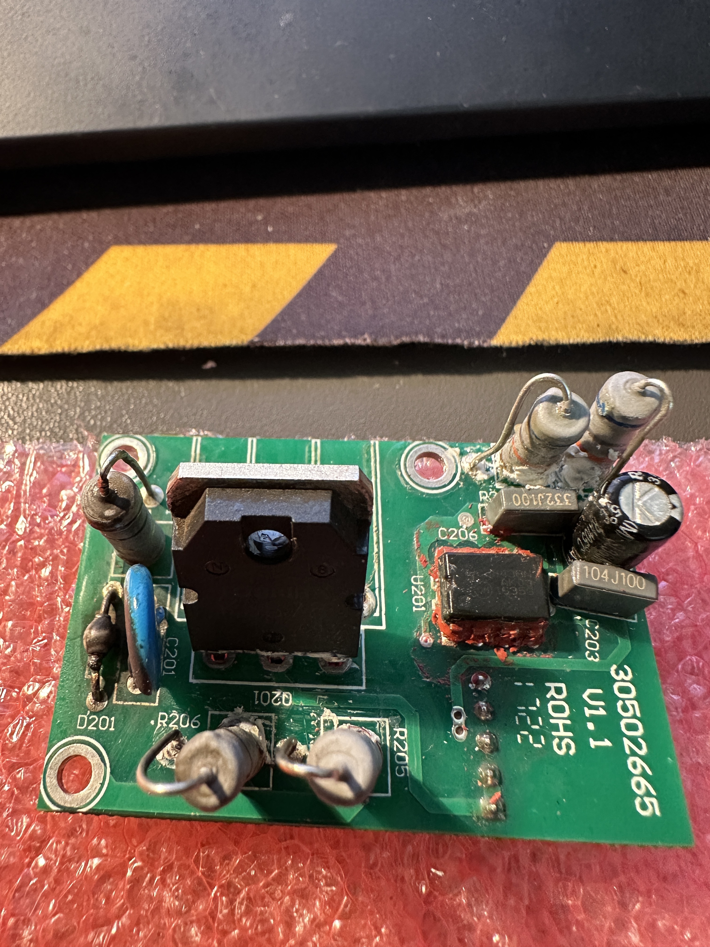

              I removed the heat sink and the mosfet so u can see more and also tried to clear the gunk. I can write a diagram if you want me to.
              Note: D201 is also blown and from bottom side R209 too.

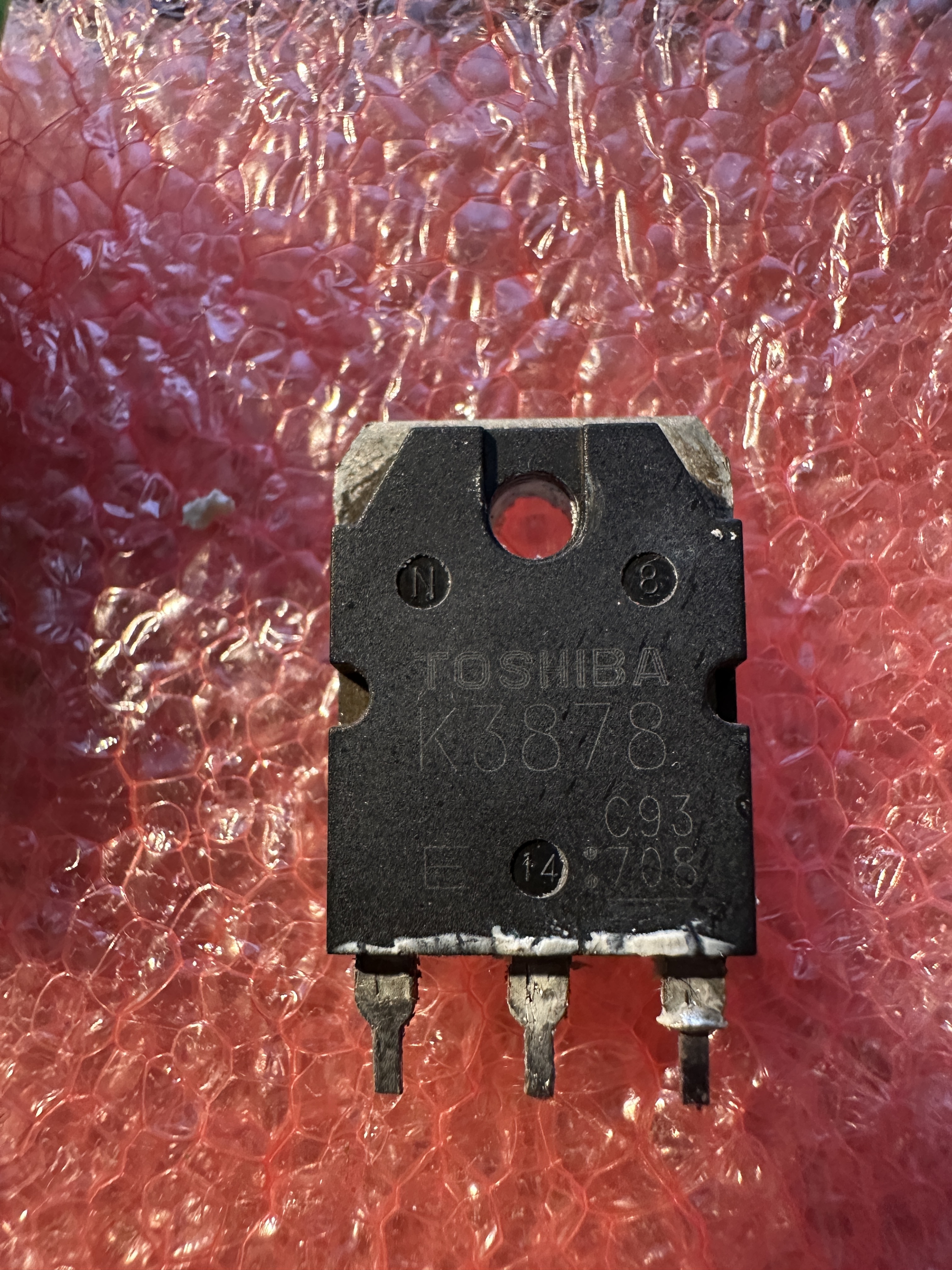

                almost forgot the mosfet is K3878

                  The gate drive resistor is usually something between 0 and 100ohm, the gate drive diode is probably something similar as an RB160L60. The diodes trough hole I'd put something 1A, 600V or better ultra fast in there. The gate resistor and the diode are there to slow the Mosfet down and prevent ringing.
                  As for R209, I am not sure where it goes to what pin in the IC.
                  Drawing a supporting schematic would simplify things for sure.

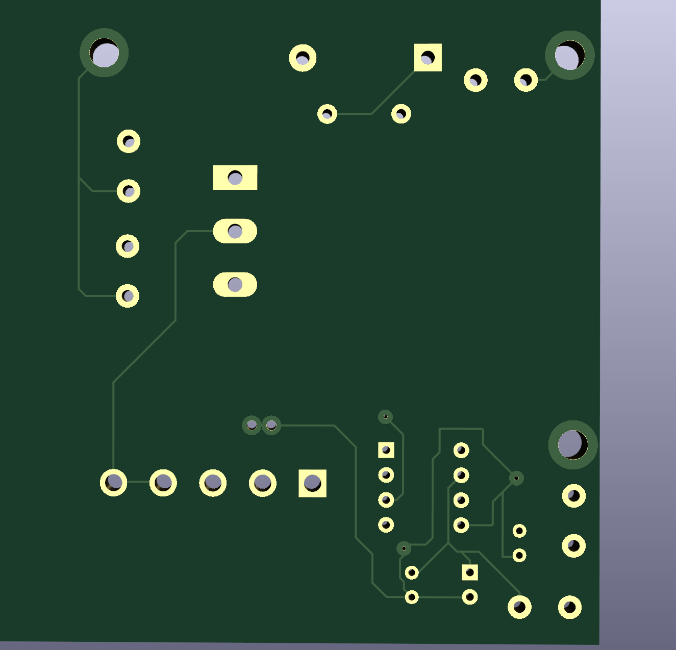

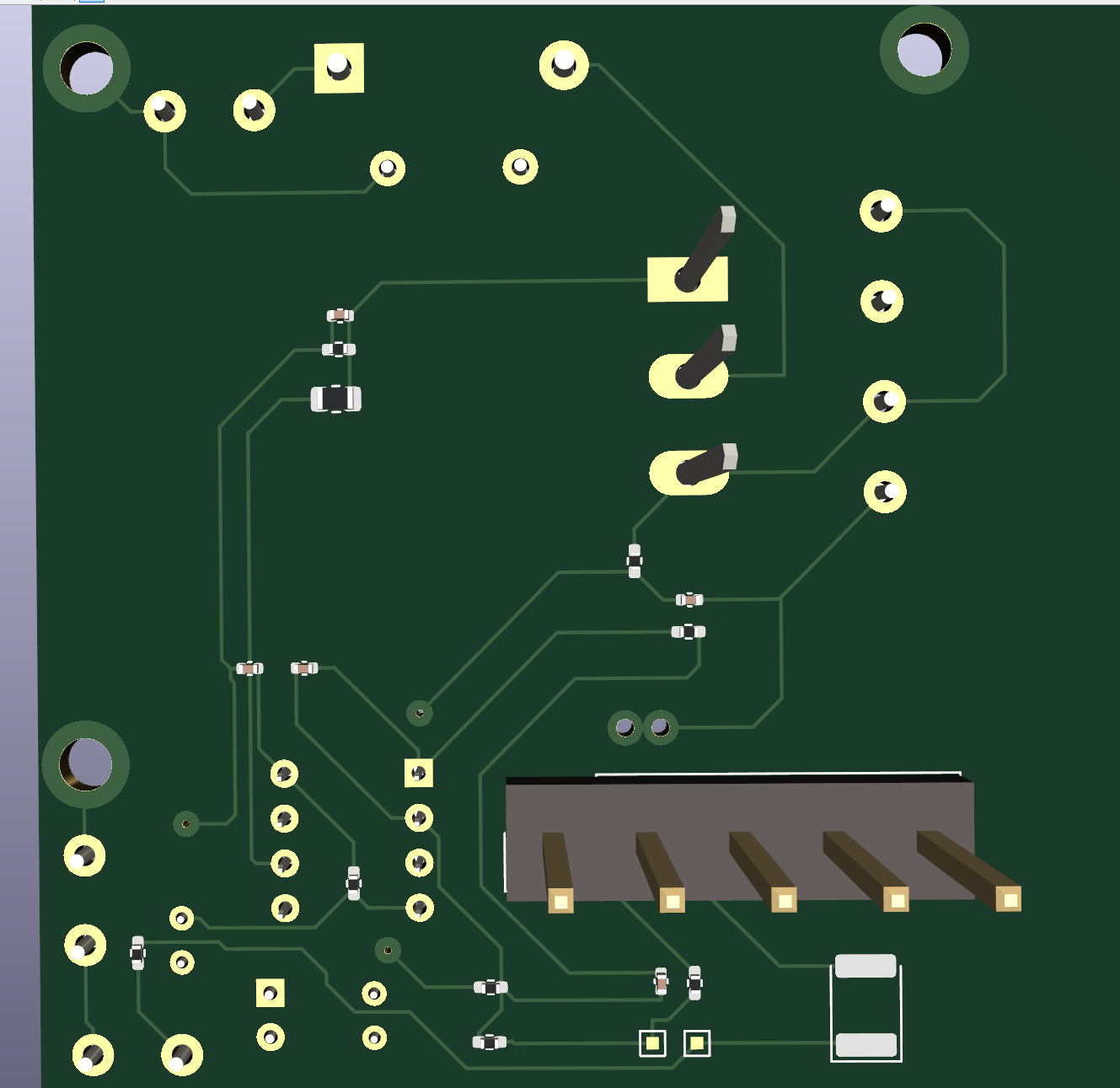

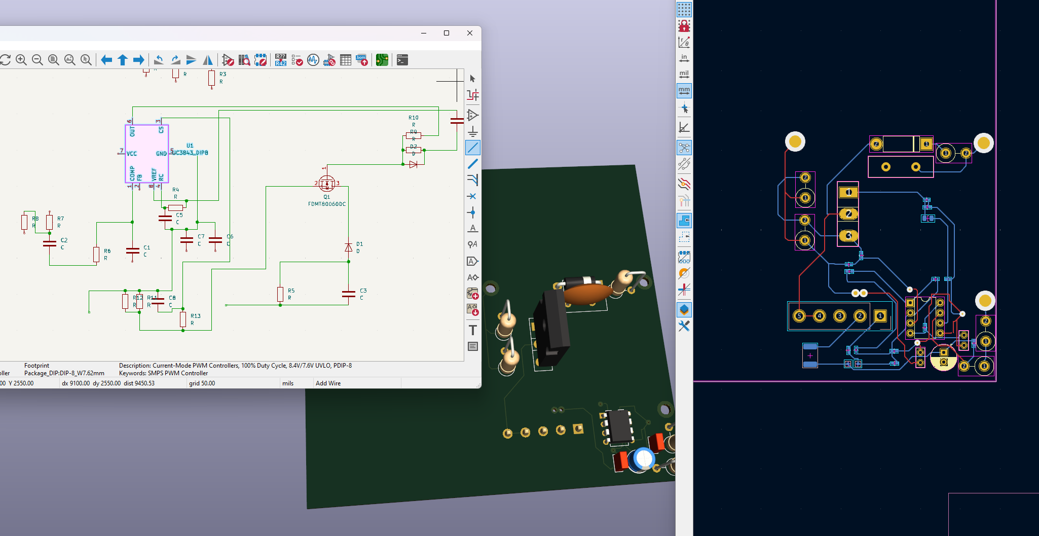

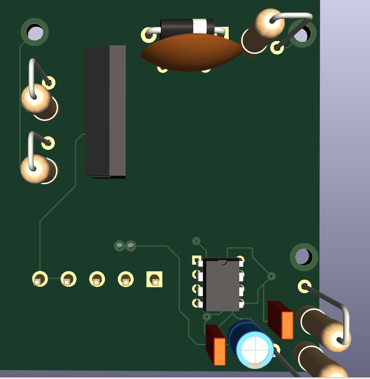

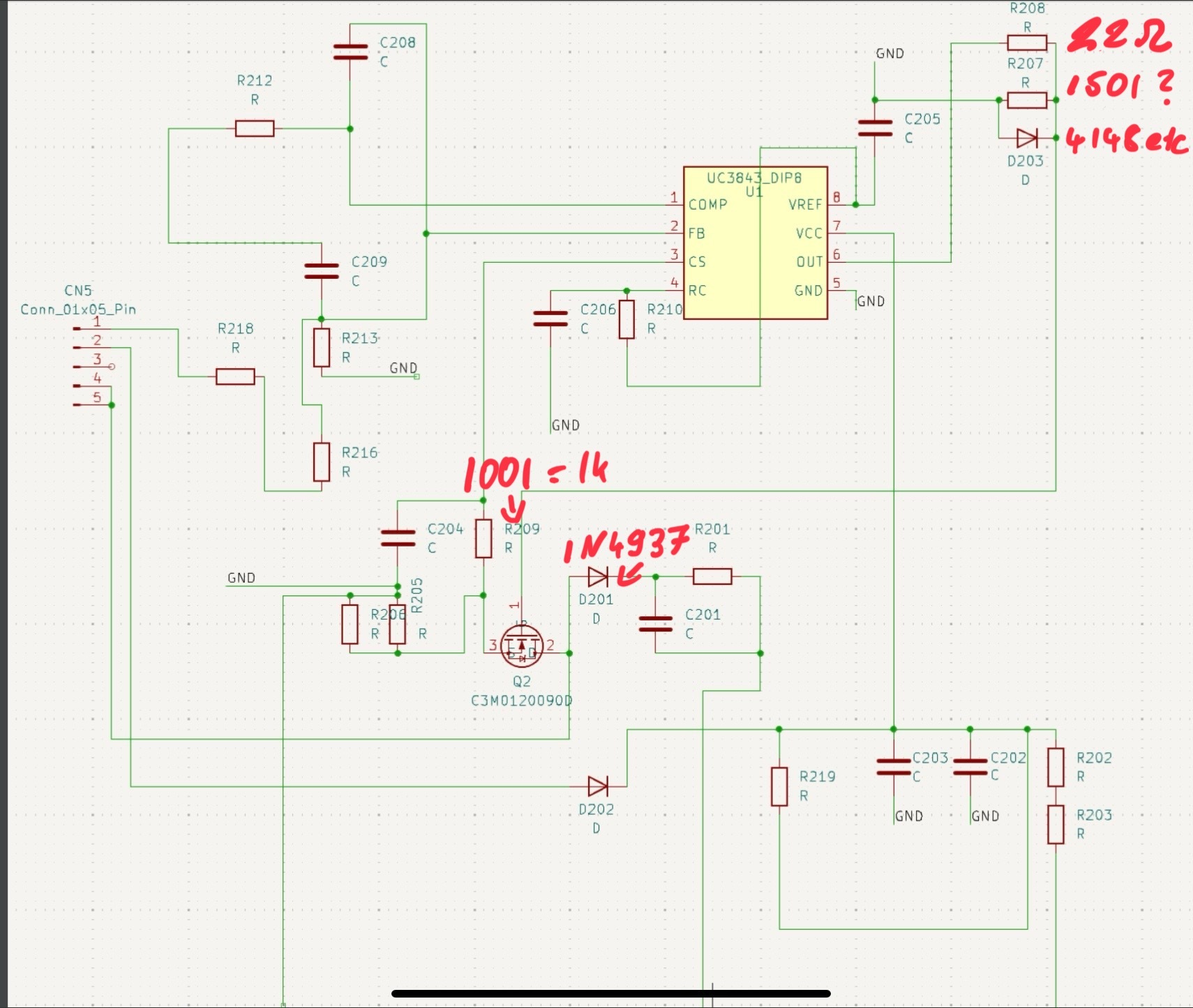

ID:	3273982​i already working on the schematic i need one more day to finish it
                        • CapLeaker
                          Leaking Member
                          • Dec 2014
                          • 8351
                          Very good!
                          • Olles4
                            • Apr 2022
                            • 63
                            • Slovakia
                            • Olles4
                              • Apr 2022
                              • 63
                              • Slovakia
                              • Olles4
                                • Apr 2022
                                • 63
                                • Slovakia
                                • Olles4
                                  • Apr 2022
                                  • 63
                                  • Slovakia
                                  • Olles4
                                    • Apr 2022
                                    • 63
                                    • Slovakia
                                    Let me know please if its readable. Thank you
                                    • Olles4
                                      • Apr 2022
                                      • 63
                                      • Slovakia
                                      I need somehow to guess the values of : R209 , R208 , R207 , D203.
                                      And replacement for : D201 , i found this diode was BYV26E
                                      • CapLeaker
                                        Leaking Member
                                        • Dec 2014
                                        • 8351
                                        It is starting to make a bit of sense now how this works. Good drawing! Here is with what I roughly came up with. I am not sure on the exact value of R209 and R207. The BYV26E is better than the 1n4937 that I guessed on D201.
                                        example circuits show R207 as 10k Ohm… as 10R0?
