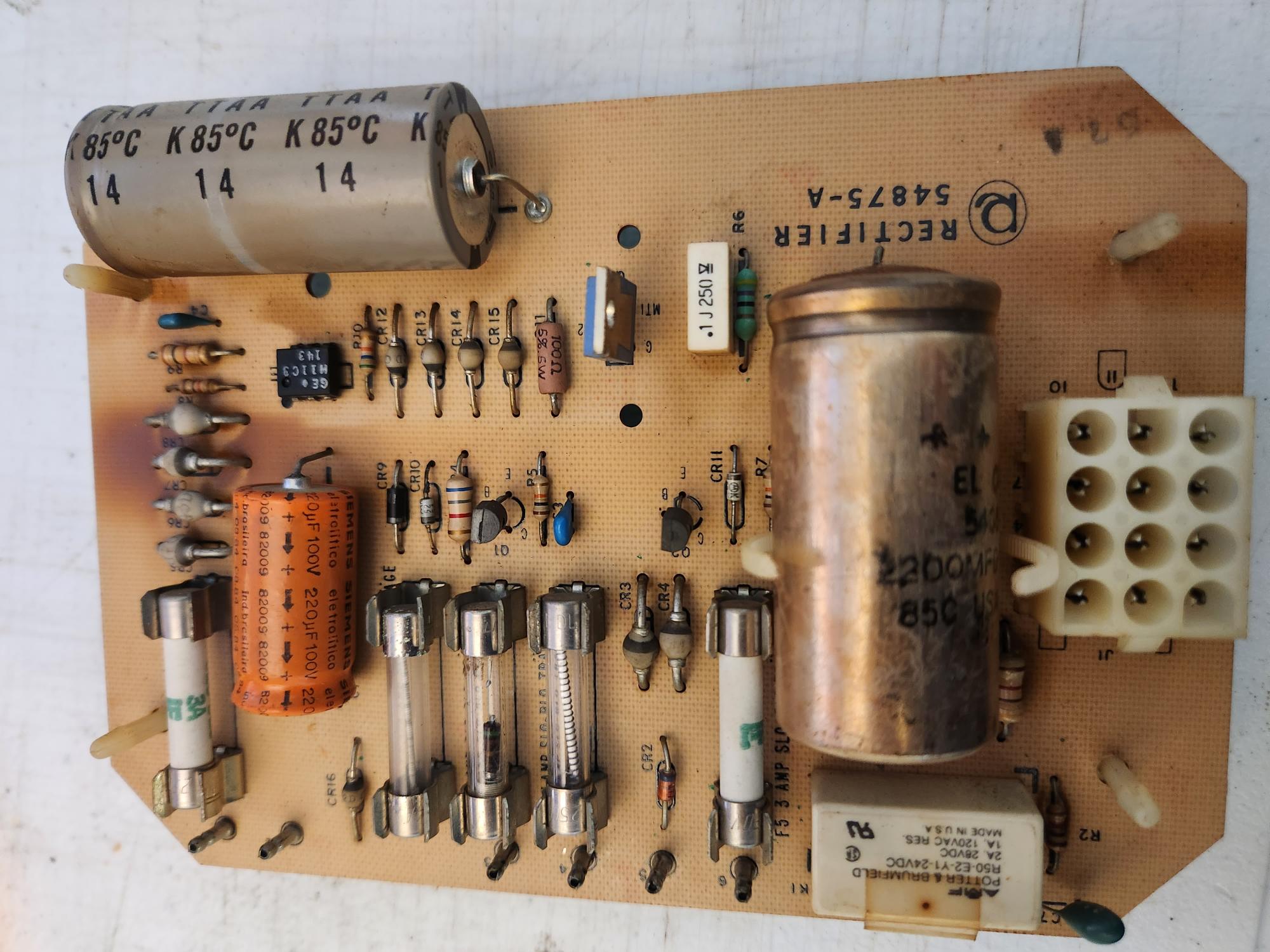

    This is a rectifier board out of a power supply from a vintage 1970s jukebox.
    It is made out of unobtainium, as in extinct.
    F2 and F3 are blown.CR2 is shorted, ITT is all is says on CR2
    Q2 is a known weak point, but tests good, Q3 tests bad, Q1 tests bad
    CR11 reads current flow both directions
    CR5, 6, 7, and 8 have obviously been hot, flow current both directions. thinking I will replace them
    Both large axial caps test good but are gertting replaced anyway.
    Anyone have any experience with these or have any suggections?
    Work on TVs mostly but this was dropped in my lap.
    LJ

    probably be as well to rebuild it all .

      CR2 is a 1N4749, 24v zener, Here this should help, see page 4

        Agreed...time for a rebuild.

          there's nothing on that that isnt still being made - even the connector is a current molex one.
          if they ever became needed, you could make new ones very cheaply using a chinese pcb company for the fiberglass.

                Re: Rectifier Board out of Power Supply
                It doesn't make sense, what is blown unless a gorilla was in trying to repair the jukebox.
                They might have put in really big fuses for a while, or messed up connectors?
                CR11 gets overloaded only if Q2 shorts.
                Q1 triac is for switching on the turntable motor. It's rated 6-10A...
                If F3 blows so does F4.
                All electrolytic and tantalum capacitors need to be replaced due to their age and uh they didn't have vents back then so they blow up nicely.
                    these boards can be damaged by faults downstream.
                    and yes, jukeboxes pinball etc are often bodged by gorilla's on site to avoid having to drag it to a van and take it to the workshop.
                    sometimes you have spare boards to swap out but usually not.
                    incidentally, you need to watch out for faulty led's in the old jukeboxes - sometimes they are used to drop voltage rather than indicate stuff.
                    dead led can cause computers to lock up or voltages to go out of spec.
