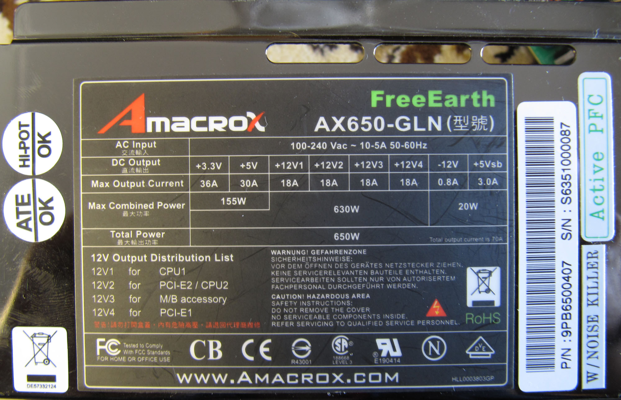

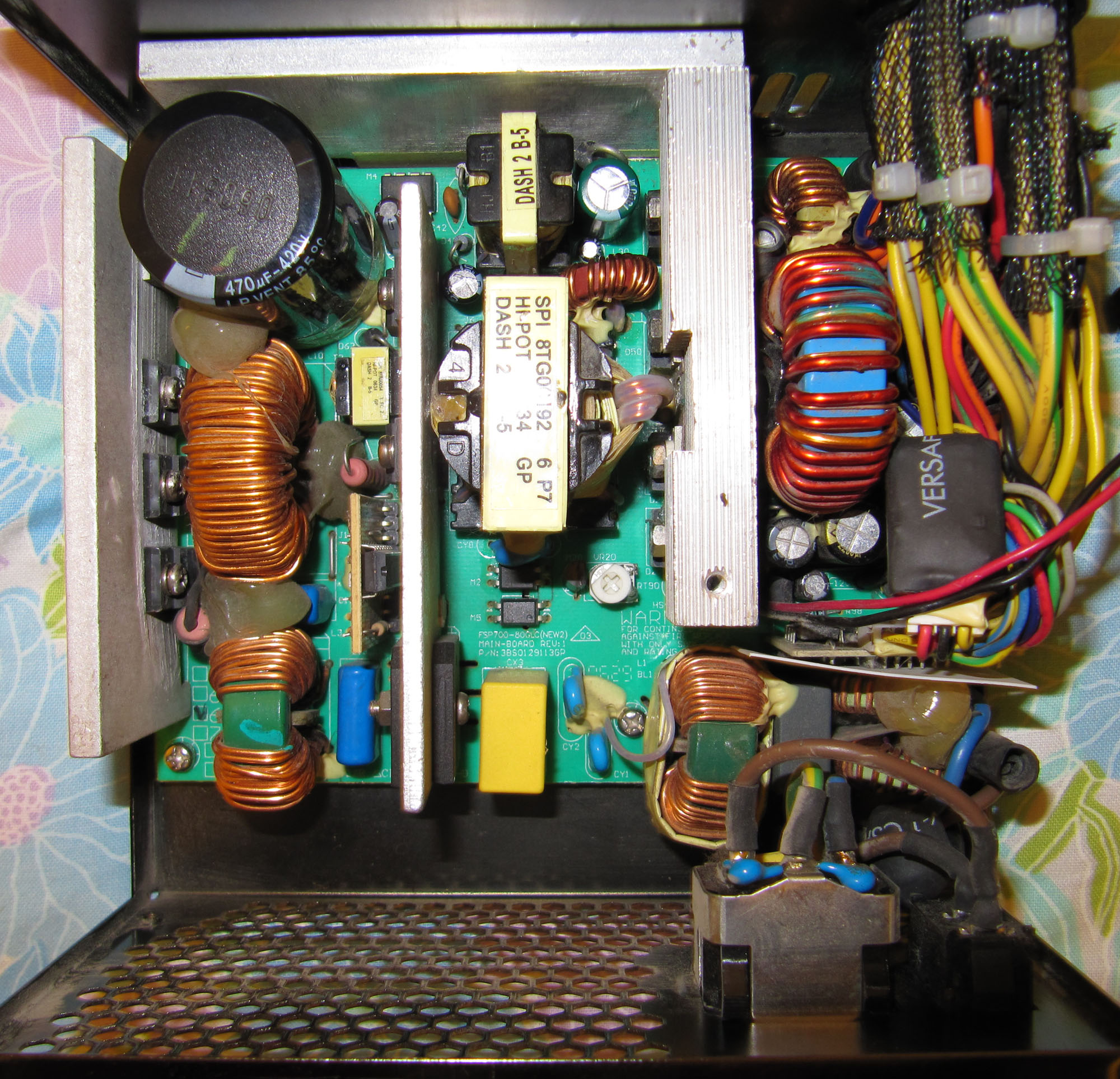

    A very good friend has trouble with his desktop.
    When he presses the button the fans spin but it never boots.
    I checked the voltages with a multimeter and found they were continuously fluctuating, so I tried another power supply and then his computer booted normally.
    The faulty psu is an Amacrox AX650-GLN and the OEM is FSP.

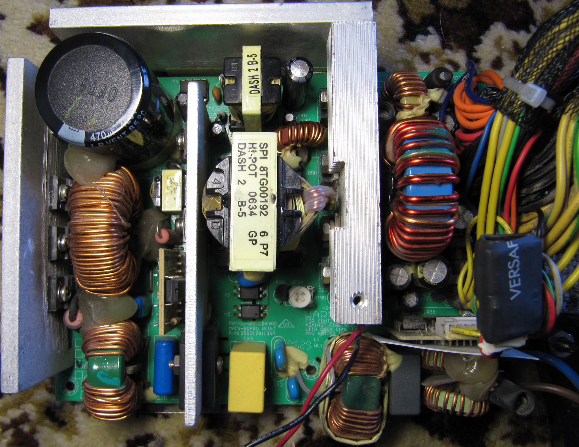

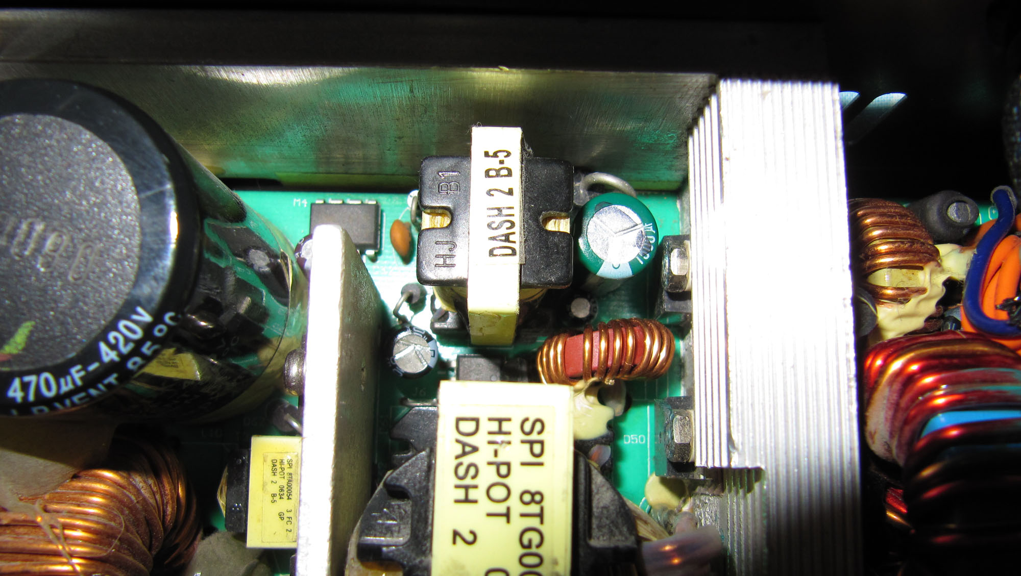

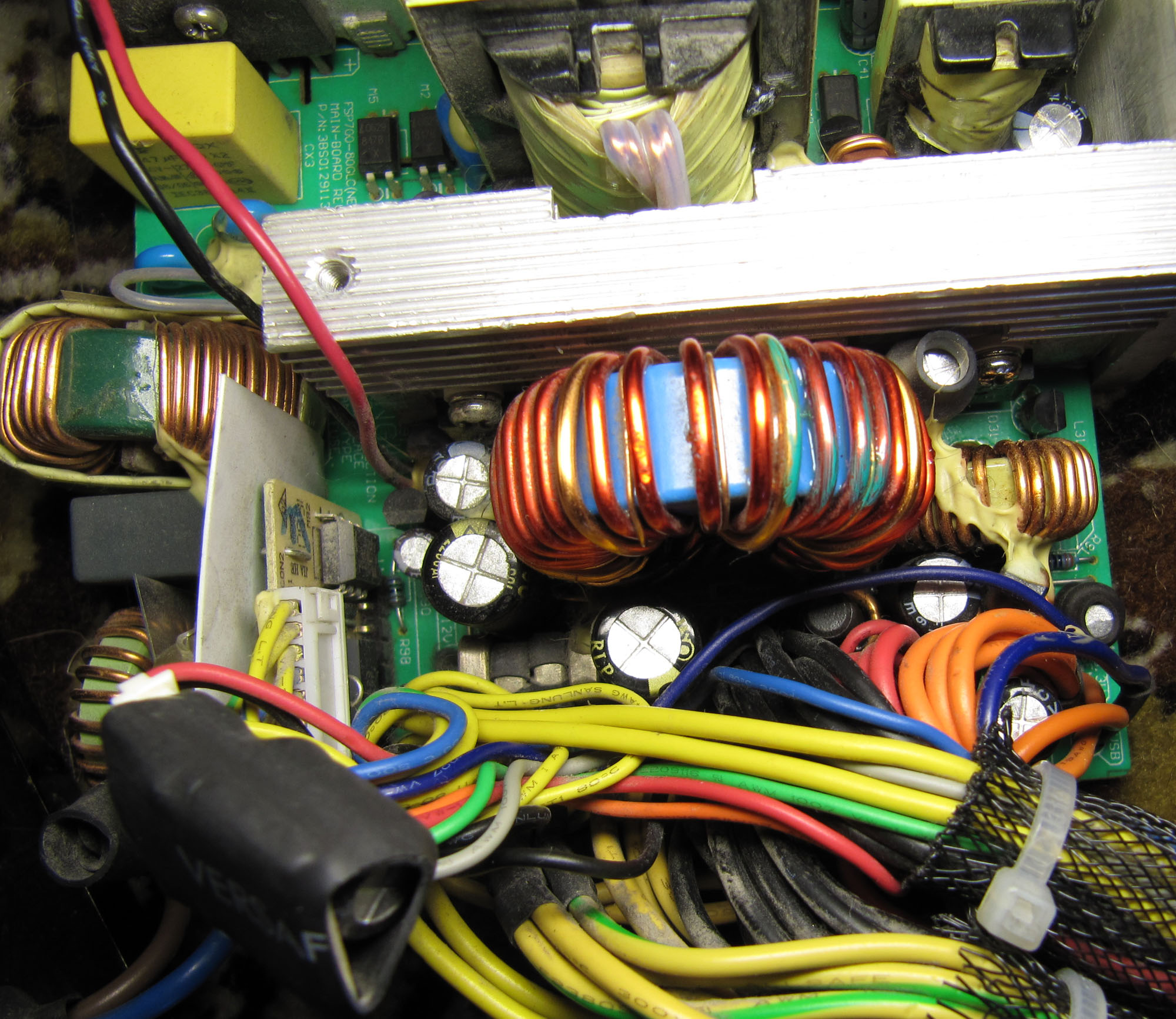

    After I opened it I found 2 bulging capacitors. Here is the capacitor list of the power supply and some photos:
    Capacitor List
    1x470uF 420V Capxon
    1x22uF 50V Teapo
    1x2.2uF 50V Teapo?
    1x100uF 25V Capxon BULGED
    1x47uF 25V Teapo
    5vsb:
    2x2200uF 6.3V Capxon 1 BULGED
    -12V:
    1x1x1000uF 16V Capxon
    3.3V:
    5v:
    2x1000uF 16V Capxon
    12V:
    2X2200uF 16V OST
    1X16V Capxon
    Is that a good psu? Is it able to do 650Watt without ripple going out of specs?
    Do you think the voltage fluctuation is related to the bulging caps?

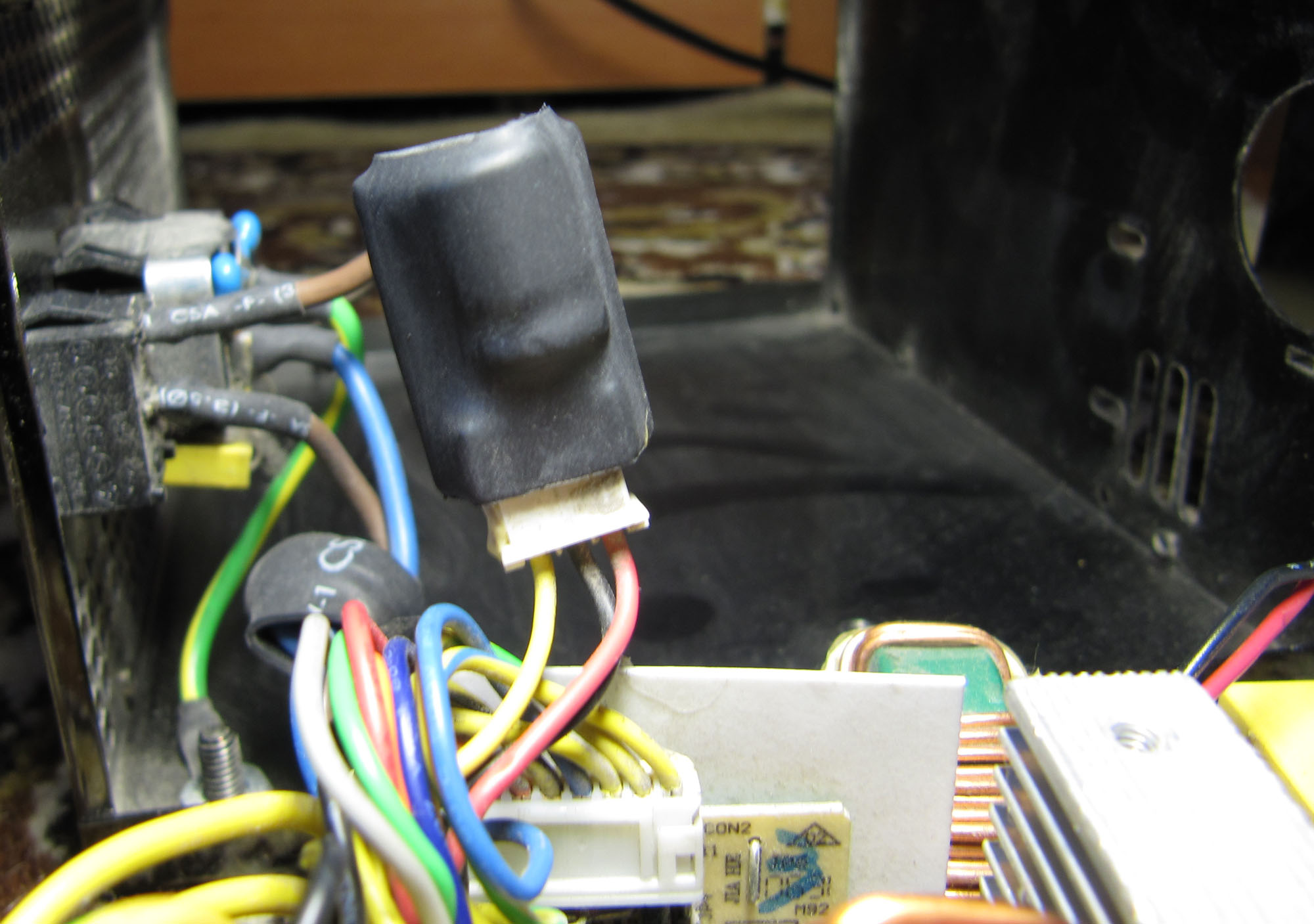

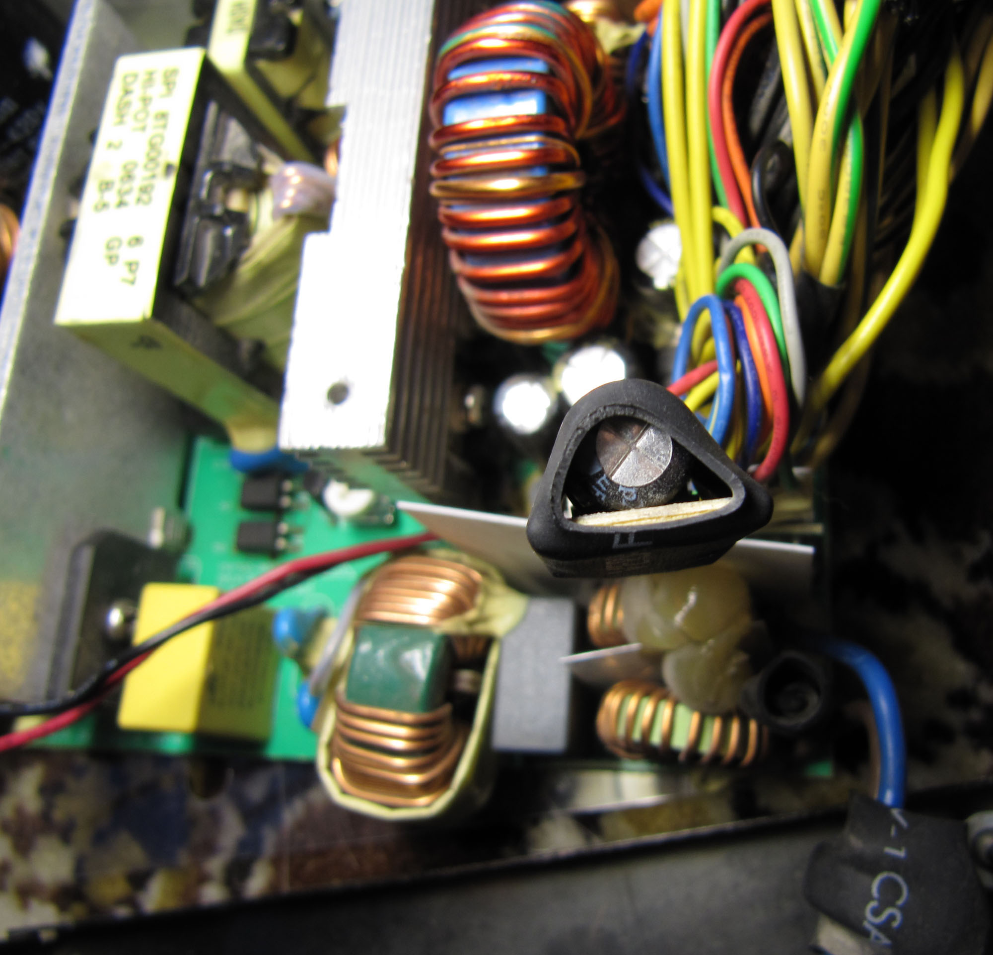

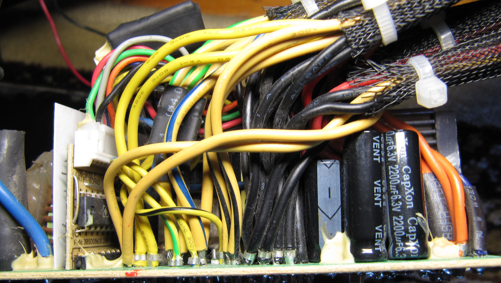

    Btw what is this thing?
    The last capacitor in my list is placed in there.

      Fsp is decent (not great) but they use crap caps. Replace all the capxons and blow it out well with an air compressor. Then it will be a good psu.
      And yes the caps are casuing the voltage fluctuations

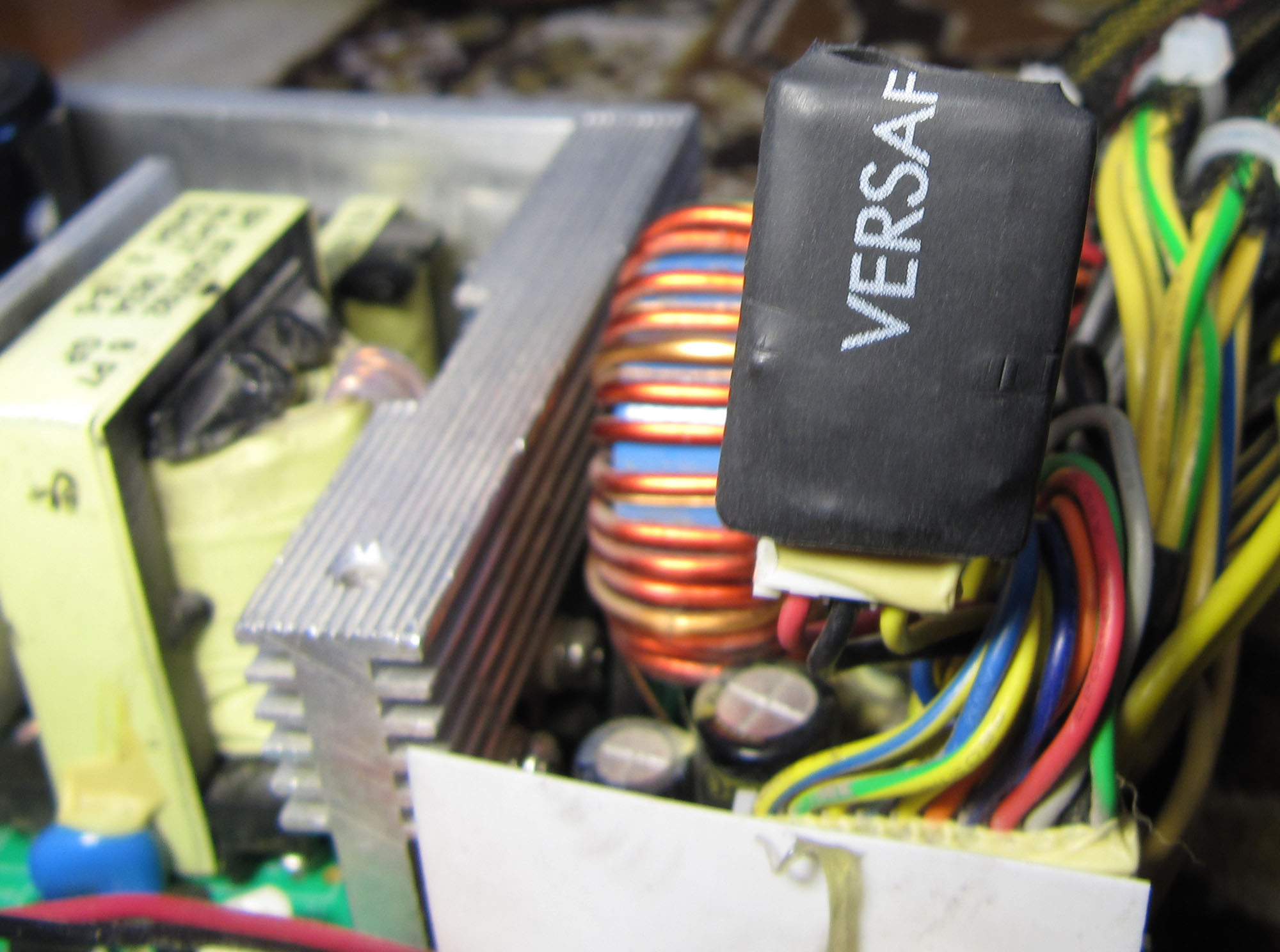

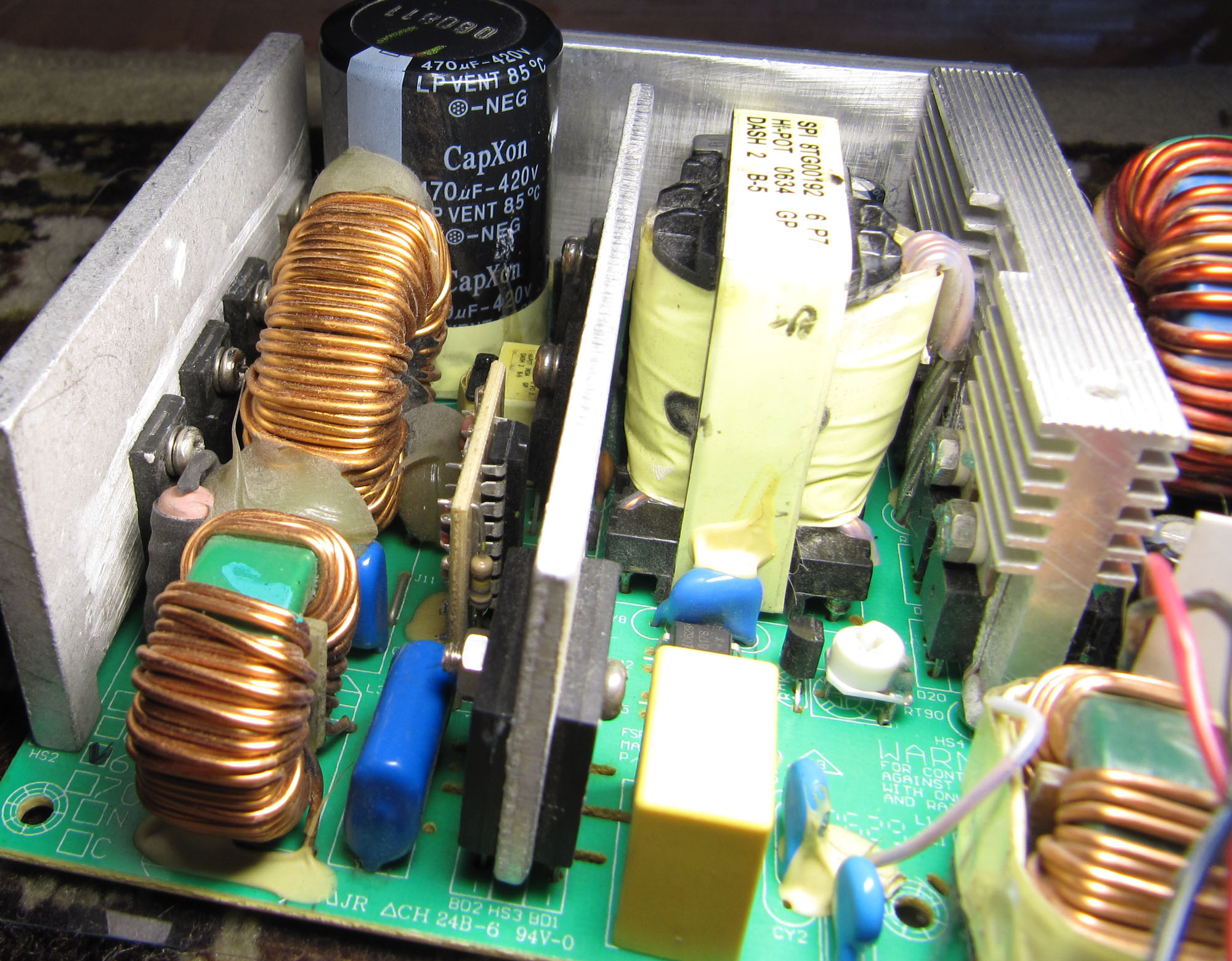

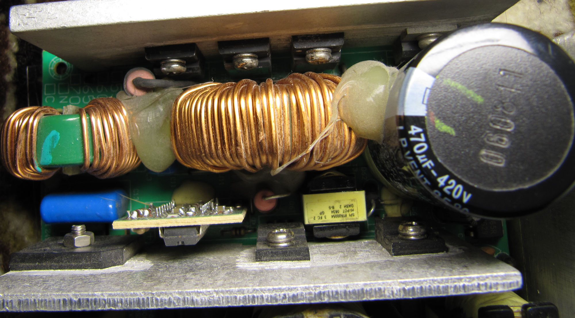

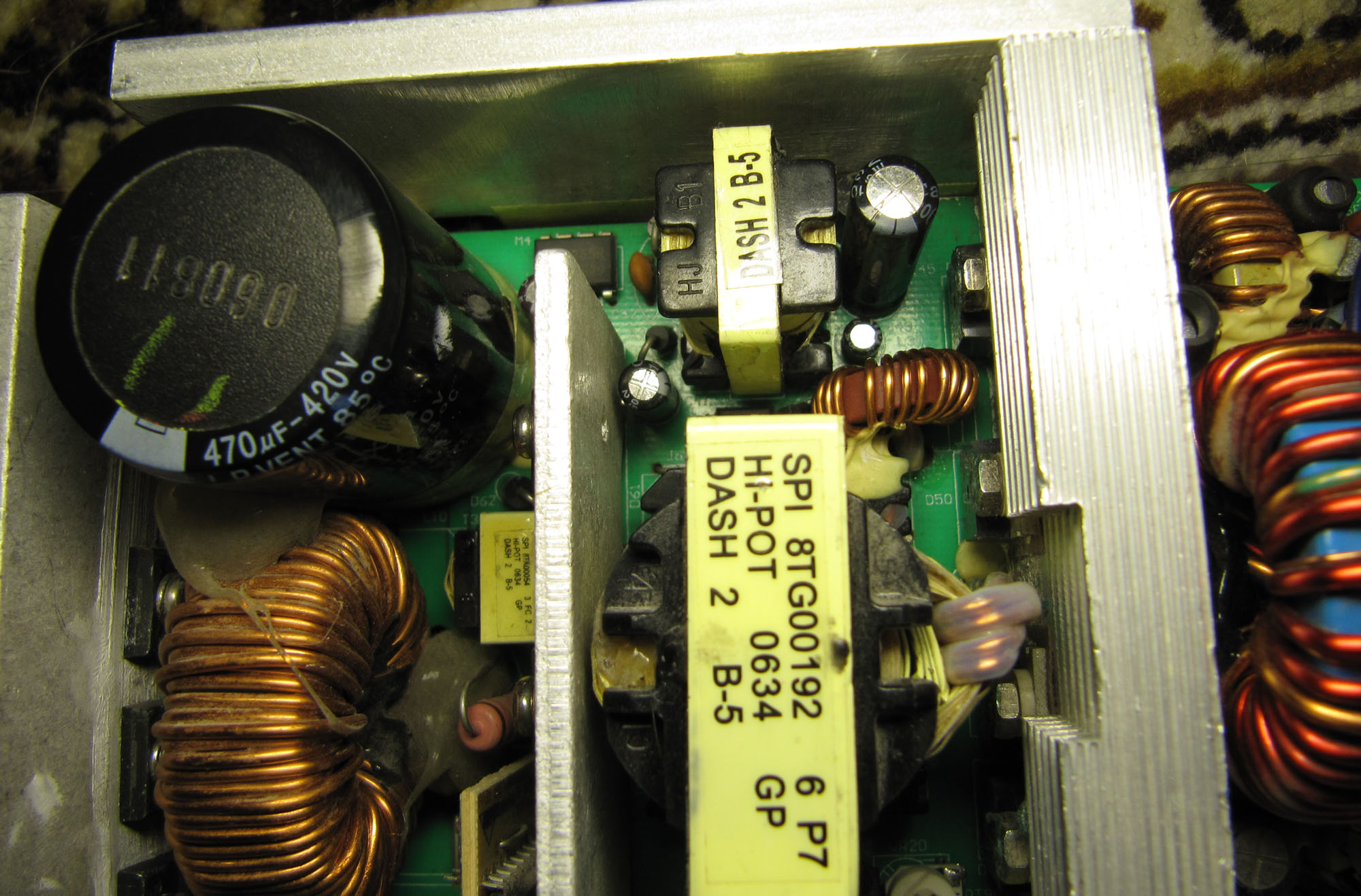

        Look at that tiny primary heatsink. LOL

              Heatsinks appear to be undersized for this wattage, and CapXon and OST electrolytics are known bad units.

                  FSP and Sirtec/Highpower are really good at using undersized heatsinks.

                    that last cap is obviously on a small circuit board when you replace it you should replace the heatshrink sleeve - it may be used as a heat shield.
                    i'v seen fsp put that over caps a few times.

                      Is it reall bad to make the heatsinks so small?
                      • c_hegge
                        • Sep 2009
                        • 5219
                        Re: Amacrox AX650-GLN Free Earth
                        Yes because less surface area means that the fan has to rev like a jet engine to prevent the silicone overheating.

                            Originally posted by goodpsusearch
                            3.3V:
                            5v:
                            2x1000uF 16V Capxon
                            12V:
                            2X2200uF 16V OST
                            Am I the only one who finds these filter caps a little undersized for a 650W psu?

                                  I did a partial recap on that psu:
                                  1x100uF 25V Capxon bulging -> 1x100uF 25V Rubycon YXF
                                  1x2200uF 6.3V Capxon (5vsb) -> 1x1500uF 6.3V Nippon Chemicon KZE (removed from a dead mobo)
                                  My friend wanted to spend no money for that psu to be repaired, so I replaced only the bad caps and used stock caps as replacements.
                                  Voltages after recap:
                                  5vsb: 5.12V stable
                                  -12V: -12.37V - -12.40V
                                  3.3V: 3.36V stable
                                  5V: 5.08V stable
                                  12V: 12.42V - 12.44V
                                  pc config: Athlon 64 X2 5600+, 2x1GB DDR2 667MHZ, MSI K9N Diamond, MSI 8600 GTS, 2x320GB Seagate Sata 7200 HDD, 2xOptiarc DVD-RW, 5xcase fans with leds.

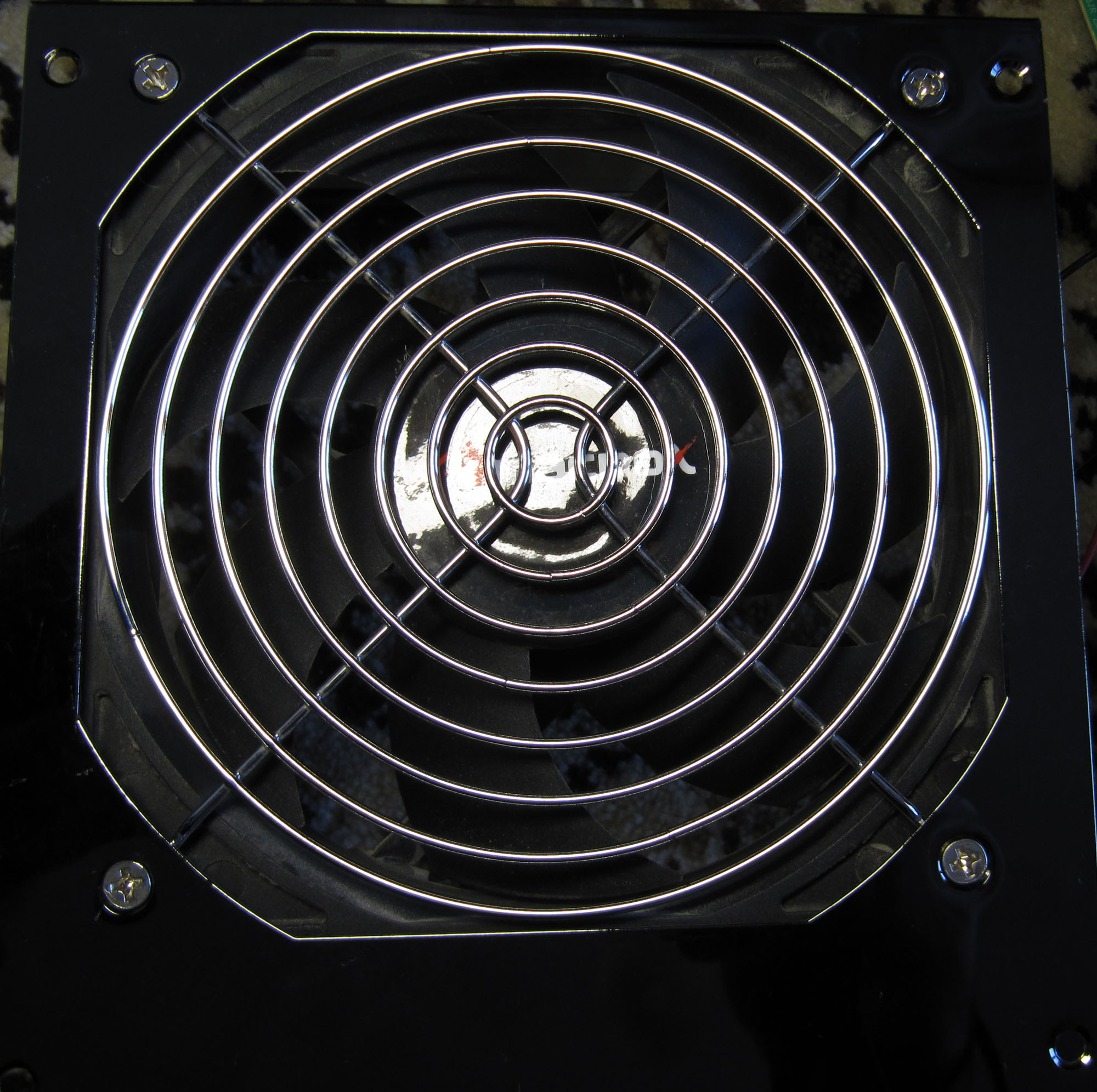

                                  The psu fan is blowing a lot of air outside the power supply. Definitely not a silent psu.
