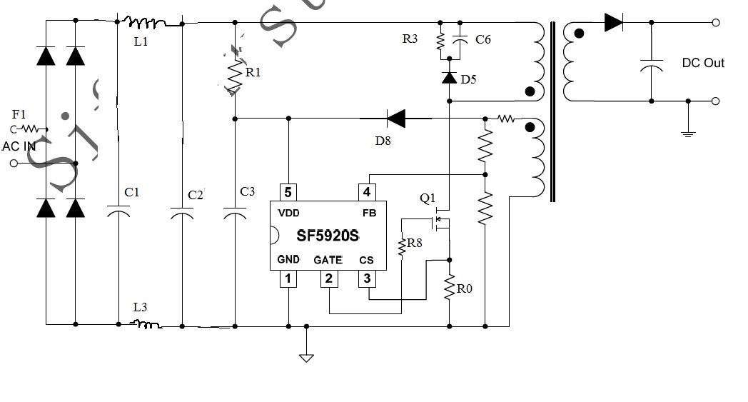

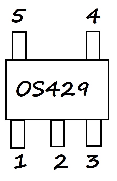

            How much resistance is in a BEEP?
            Pin 1= ground
            Pin2 = gate drive
            Pin3 = Current Sense
            Pin4 = Voltage sense
            Pin 5 = Vcc

              • R_J
                • Jun 2012
                • 9623
                Re: trying to fix a 6V 0.5A T1 (Transformer) AD050120T2 power supply
                You are not measuring the ic, you are measuring the external resistors, for example Pin1 is hot ground, pin3 is the current sense pin, and R0 2.7Ω is across those pins, R0 is the source resistor for the mosfet.
                Are you sure pin 4 to 1 is 42.8Ω and not 42.8KΩ
                  0S429 - 0Sxxx - SF5920S

                    I checked the resistance on the continuity/200 ohm setting and yes that is the value.
                    Thanks for the data sheet. I see there are other pathways from the wires and that's where the readings are from.
                        Can you check the resistor R0 2.7Ω current-sense is not open-circuit. It looks a bit dodgy.
                        I don't think I've ever encountered a small TO-92 HV mosfet before. What is it's part number?
                        Also, note this PSU does not have an opto-coupler so it must be using the aux winding for voltage feedback.
                        • R_J
                          • Jun 2012
                          • 9623
                          #32
                          Based on post #26 I suspect the R0 resistor is ok. The mosfet is a 1N65T
                          C1 and C2 must be the two 4.7µf/400v capacitors, What is the voltage across each of them? (it should be around 300vdc). What is the voltage across C3 (it should be around 20vdc) and the voltage across C3 is important as it will tell us the state of the ic.
                          Best I can do with Paint
                          • redwire
                            • Dec 2010
                            • 3912
                            #33
                            The fusible resistor blew due to a short or overload on the primary side.
                            That would be a bad rectifier diode, or shorted mosfet and that fault current ends up going through the sense resistor who usually loses.
                            So far I don't see the cause of the overload, although OP slipped with probes and shorted something out.
                            Rectifiers test OK, mosfet tests OK- so something isn't making sense here.

                                #35
                                So far only the fusible resistor was bad, everything else you have checked is OK. Seems a bit odd. To me that happens when I've glossed over and missed testing a part, or I tested it wrong etc. so I will back up and recheck the top suspects.
                                Can you measure (carefully without slipping with the probes and shorting things) the voltage across C3 (same as empty "C1" on the board's backside). That is power for the IC. It might be pulsing or hiccuping. RJ also asked for this.
                                The SF5920S IC needs over ~15.5VDC to startup, ~9.5V it goes to UVLO shutdown, and ~33V is OVP shutdown.
                                  i would start with q1 voltages and see what's not right there . then go backwards towards the beginning .
                                    if you cant see anything wrong, check R1 and replace c3 with something decent
