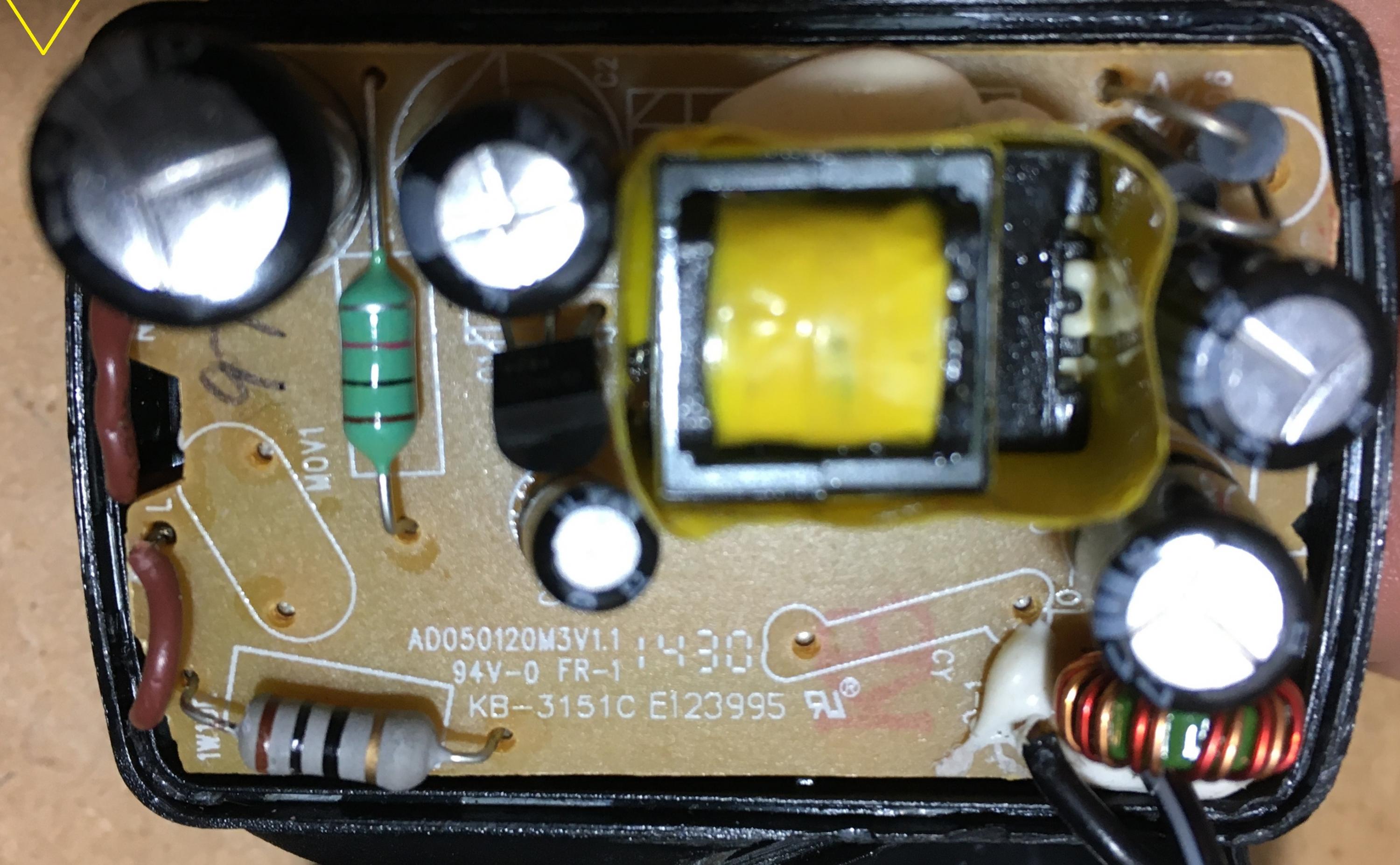

    Hi. I am trying to fix a 6V 5A power supply that would was used a lot.
    I want to fix it partly for learning, and part because I don't want to buy a new one.
    It has distinctive smell of burning but not seen obvious burned components yet. I'm not sure where the fuse is.

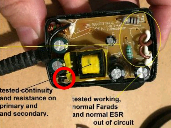

    I tested the only slightly bulged capactitor (out of circuit) and it measured normal capacitance and ESR.
    Everything else was tested in circuit with a multimeter.

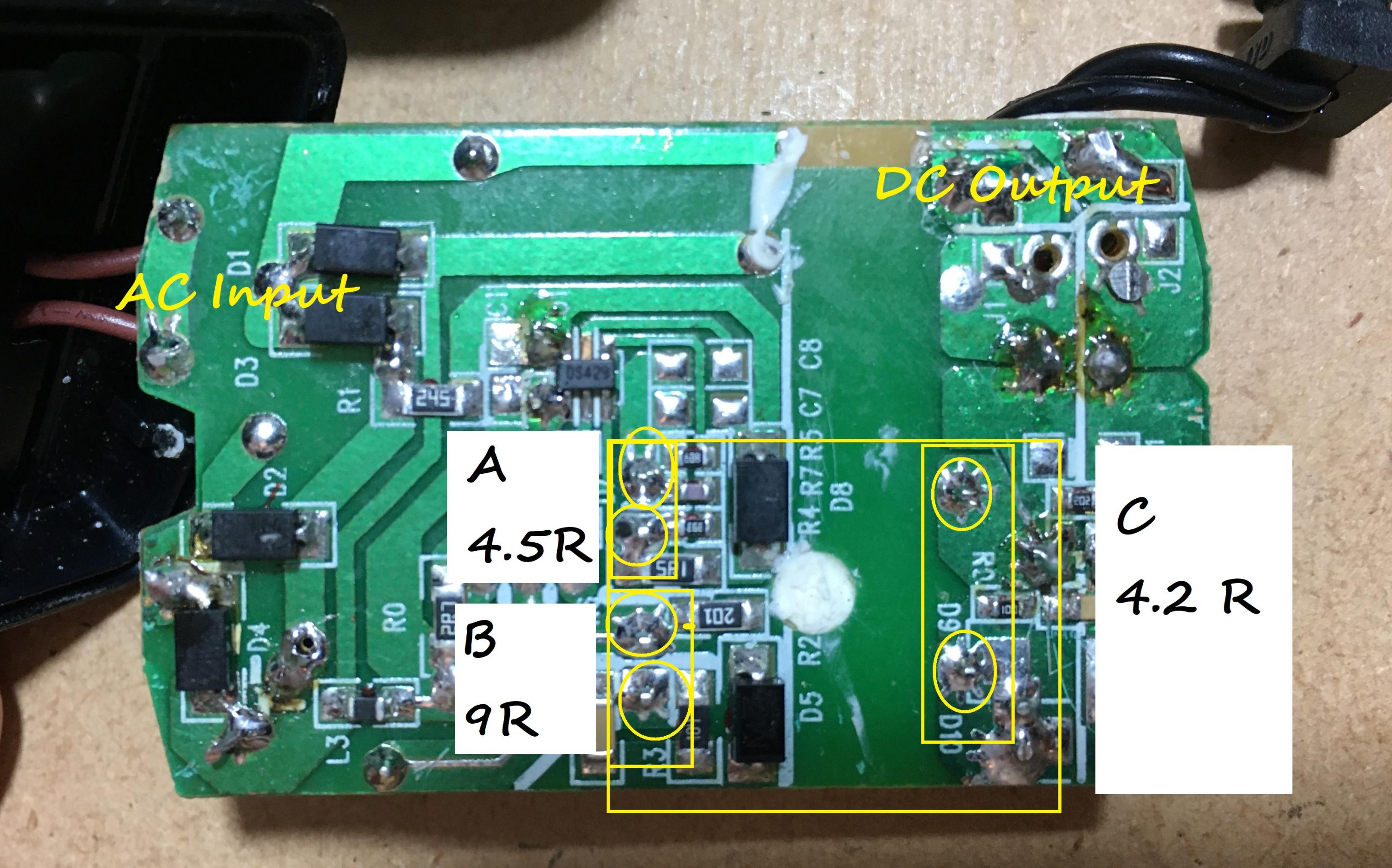

    In circuit tests
    I tested the large diodes underside and they seem fine.
    I tested the transformer in circuit for continuity and resistance using a multimeter, but not sure the readings are correct because other circuitry is nearby.
    primary pins 1 and 2 showed resistance and continuity in circuit.
    secondary pins 3 and 4 showed resistance and continuity in circuit.
    secondary pins 5 and 6 showed resistance and continuity in circuit.
    But secondary pin 3 to 6, 3 to 5; 6 to 3 and 6 to 4 showed no continuity.
    I watched a video about testing transformers out of circuit and it showed
    continuity from one of the outer pins to all the other 3 like they
    were tapped on a coil.
    I am not sure the tranformer is working but I am hesitant to believe
    it's blown since some people online say tranformer's don't burn out much.
    I have not tested the surface mount components apart from the large diodes.
    I have attached some images with component values and notes in the .pdf.
    Does anyone have an idea how I should approach this repair? Any common faults of this? Any advice is appreciated.

    The most common failure points on those power supplies, are failing/failed electrolytic capacitors. If the unit has been in use for a long time, like you say, and there was nothing else that would have caused it to fail, like a power surge of some type, I would check each one of those caps out of circuit. You said you tested one out of circuit and got an ESR Reading, so I am guessing you have an ESR Meter of some type. Have you tested the others in circuit with that meter? In-circuit testing of e-caps for farad value, is not reliable. They have to be removed. At least one leg anyway. Not so with an ESR Meter.
    You say there was a "bulging" one that tested fine. If it is bulging, it needs to be replaced no matter how it tests out.
    Those caps are cheap. I only see five total. Order new ones of each and replace them all while you are in there. My bet is on the two green ones at the output.

      Thank you.
      It looked like it was bulging compared to the other. But I think it was just the crease and the angle I was looking at it. I have seen bulged capacitors before and this doesn't match those.
      It was either C1 or C2. They have the same value.
      I only tested that one out of circuit with a cheap component tester (LCR 4T).
      The measured capacitance matched the label (~4.7 uF) and it was about 4.5 Ohms ESR. The ESR table says highest ESR for that is around 5 Ohms for a 400V. That's why I thought it was ok.
      I will test all of the capacitors out of circuit next time I do some practical work on it. I think I will do that before testing the other parts in circuit.
      I think I will go and test everything in circuit when I get the chance. And maybe try to find a short using a milli ohm meter.

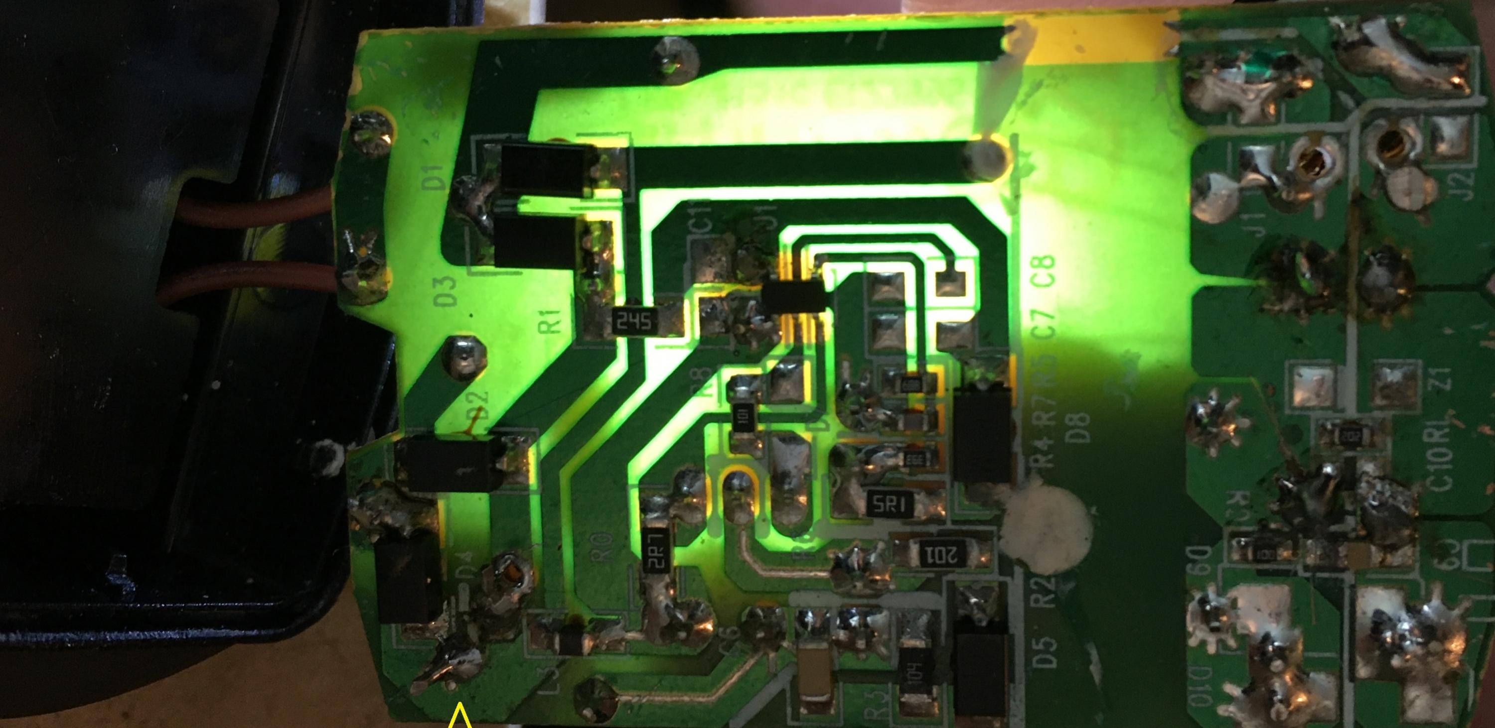

        Hi. I have replaced all of the electrolytic capacitors but it doesn't work. I haven't tested any voltages yet.
        There is a smell like a burned semi-conductor.

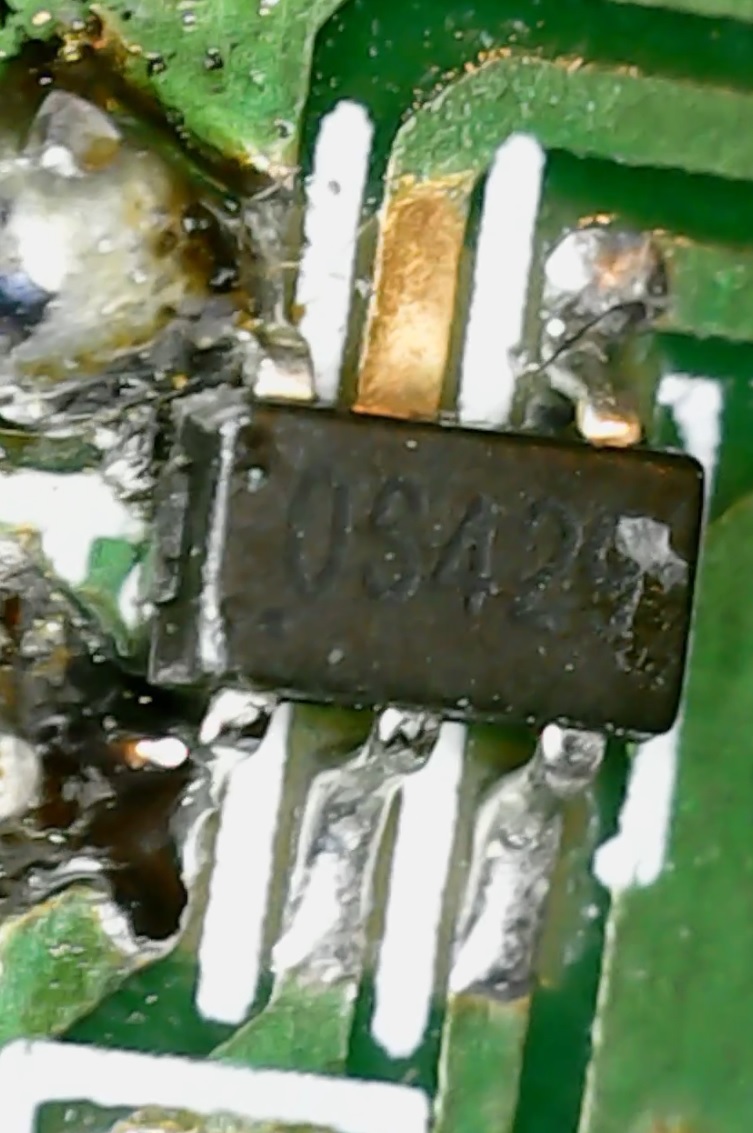

        There is an IC on the underside but I cannot find a datasheet form the number.
        The adaptor is a UK AC to 6V 0.5 A adaptor.
        The IC has 5 wires, and the top marking is:
        0S429. I think the last digit is 9.
        On the other side of the board is a mosfet: 1N65T 1424.
        I assume the IC is controlling it.
        I have attached close ups.
        Can anyone tell me where I can get a data sheet and where to buy a new one?

          Correction, I think the IC marking is OS429 starting with the letter O, because most components start with 2 letters. I could be wrong.

            Did you check the resistance of F1 resistor? looks like a 10Ω 1w, Have you checked that the output leads are not shorted or broken (open)

              However, just previous to that, I tested the voltages of the primary and secondary windings with the power on, and made a small spark when one of the probes shorted on the primary underside with maybe a SMD resistor. I am not sure if this caused F1 and MOV1 to break.
              When I measured the transformer windings, They measured primary 9R 0V, 4.7 R 0V, secondary 4.2 R 0V.

                What I will sometimes when working on primary of a switching power supply and the traces are very small and very close to each other
                I will sometimes solder very thin wire to where I want to check the voltage so I do not slip with the meter leads that just what I do sometimes

                  I see two holes for the MOV1 but I don't see it in place, are you sure you are looking at the correct component? That component is likely a coil
                  It is likely going to be more time and money to repair this than it is worth

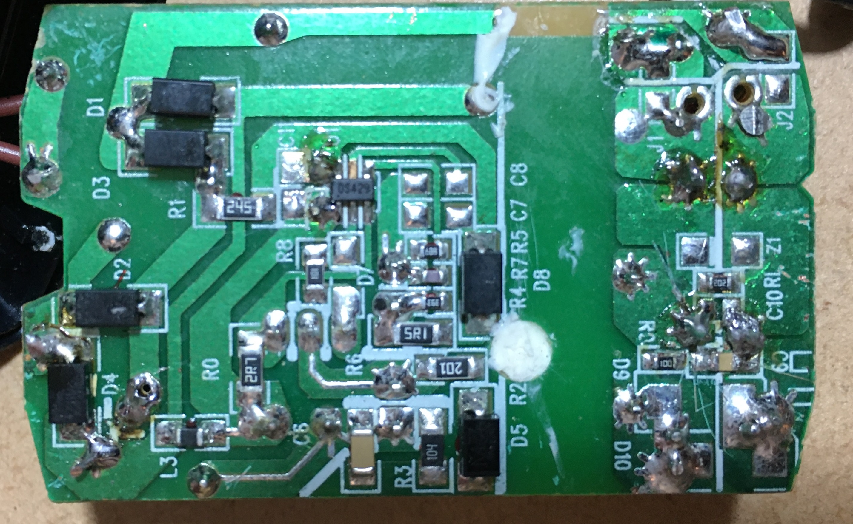

                    NHF, but I dont get it what is purpose of pdf content, many questions, notes about nothing and you have big effort on that, but it is confusing if you feel ready to that repair? I do not understand your approach to repair psu, and not clear what is the base of your knowledge... but ok...
                    I assume that you know how to do measurement, in which mode and all needed precaution.
                    So, look "D6" and near D? (on your sketch D5 and D4 THT) in diode mode, what is voltage drop?
                    Also check again resistance of "F1", it is not clear what you mean "it measures open circuit and 0 Ohms"... and check resistance of inductor L1 (big green THT) and L3 (little SMD).

                        The F1 resistor is supposed to read 10 ohms. The DMM on continuity is no beep. On 200 ohms setting it read 0 ohms.
                        The F1 have one end open to main socket, so you can not trust your multimeter anymore if it measure 0 ohms and not beeping.
                        When you test such small device who work with mains, use a 60w bulb in series like current limiter when connecting it in mains. That prevent some major damage, mistakes, and inform you in real time.

                                • 31182
                                Re: trying to fix a 6V 0.5A T1 (Transformer) AD050120T2 power supply
                                the fuseable resistor is open circuit - so you have a short on the primary side.
                                usually the rectifier or mosfet circuits.
                                you dont have a mov fitted - if you did it wouldnt have coloured stripes anyway.

                                  I just hope it isn't the IC, since I don't know where to get that.
                                  Do you mean the diodes in the bridge rectifier?
                                  The legend says it's MOV1 and the component has colour code brown, black, violet, silver. There are Jpeg's I attached. I checked and there is no other legend near that component.
                                  I have changed things since then. The large cap on the left was one I replaced and the one next to it has now been replaced too. 4.7 uF 400V.
                                  In the 3rd photo, the bridge rectifier is on the underside, left hand side.
                                  In the 1st photo, there are two diodes on the top rhs and they are in series cathode to anode.
                                  I measured the mosfet on the top side in circuit and could see the junctions of BCE and they measured ok in circuit, with BC ~ 0.5V and BE ~0.7V, but from watching videos, it could fail at higher temperatures.
                                  The mosfet is Q1 3 wires 1N65T 1424 1.2A, 650V n-channel power mosfet.
                                  Are you sure that I mistook an inductor for an MOV?
                                  It looks like there is legend for a MOV but it's not fitted. I don't suppose it would be on the underside.
                                  Ok, I checked again, the L1 legend is under the inductor wire. So, yes, it's an inductor. It measured 14R when set on 200 R and I was expecting 100 mega ohms.

                                    mov1 is the empty outline
                                    d1,2,3,4 form a bridge rectifier circuit - check none are shorted.

                                      I previously performed a test on the transformer with the power on, and I got a result I wonder if you could explain.
                                      It involves getting a 5 V reading when placing only one probe onto one of the transformer wires and leaving the 2nd probe unattached. The multi-meter is a RS Beckman T100B and it is battery powered with no connection to anything else, including earth.
                                      The transformer and meter were on a rubber mat and insulated from each other.
                                      Also, the image was not the one I tested. I tested the adaptor with all of the components connected.
                                      I have attached a Jpeg with windings A, B and C labelled. I also included the resistance of each winding.
                                      Results
                                      Transformer Winding A:
                                      AC: With one probe about 5V
                                      but both probes: 0.23 V negligible.
                                      DC: 0V.
                                      Transformer Winding B:
                                      AC multi-meter setting: With one probe about 5V
                                      DC multi-meter setting: 0V.
                                      Transformer winding C:
                                      I checked voltage across the two 4.7uF 400V capacitors on the input and there was no voltage on them. 0V. So they had not charged.
                                      Note: I wrote negligible voltage meaning 0V but there was some fluctuation in the voltage reading even without connecting the meter.
                                      My question is how am I reading 5V AC when only one probe is connected?
                                      I was guessing that electrons went up the probe and registered on the meter, but I don't really have a proper explanation for that. I thought there had to be a circuit with a potential difference between the two probes to get a reading, but this gave a reading similar to the way a grounded oscilloscope does with only one probe and no earth connected.
                                      How is there 5V AC on only one probe?
